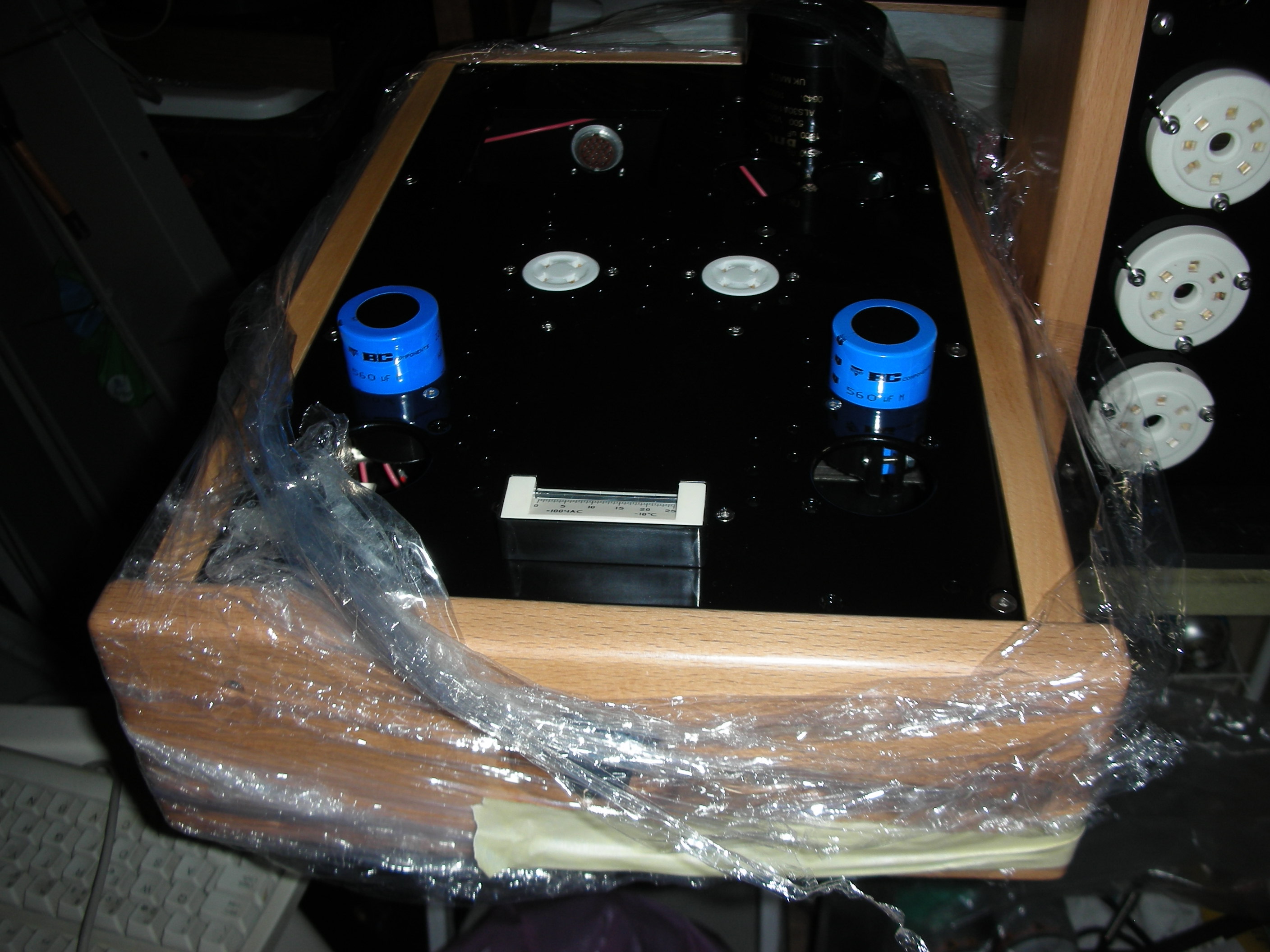

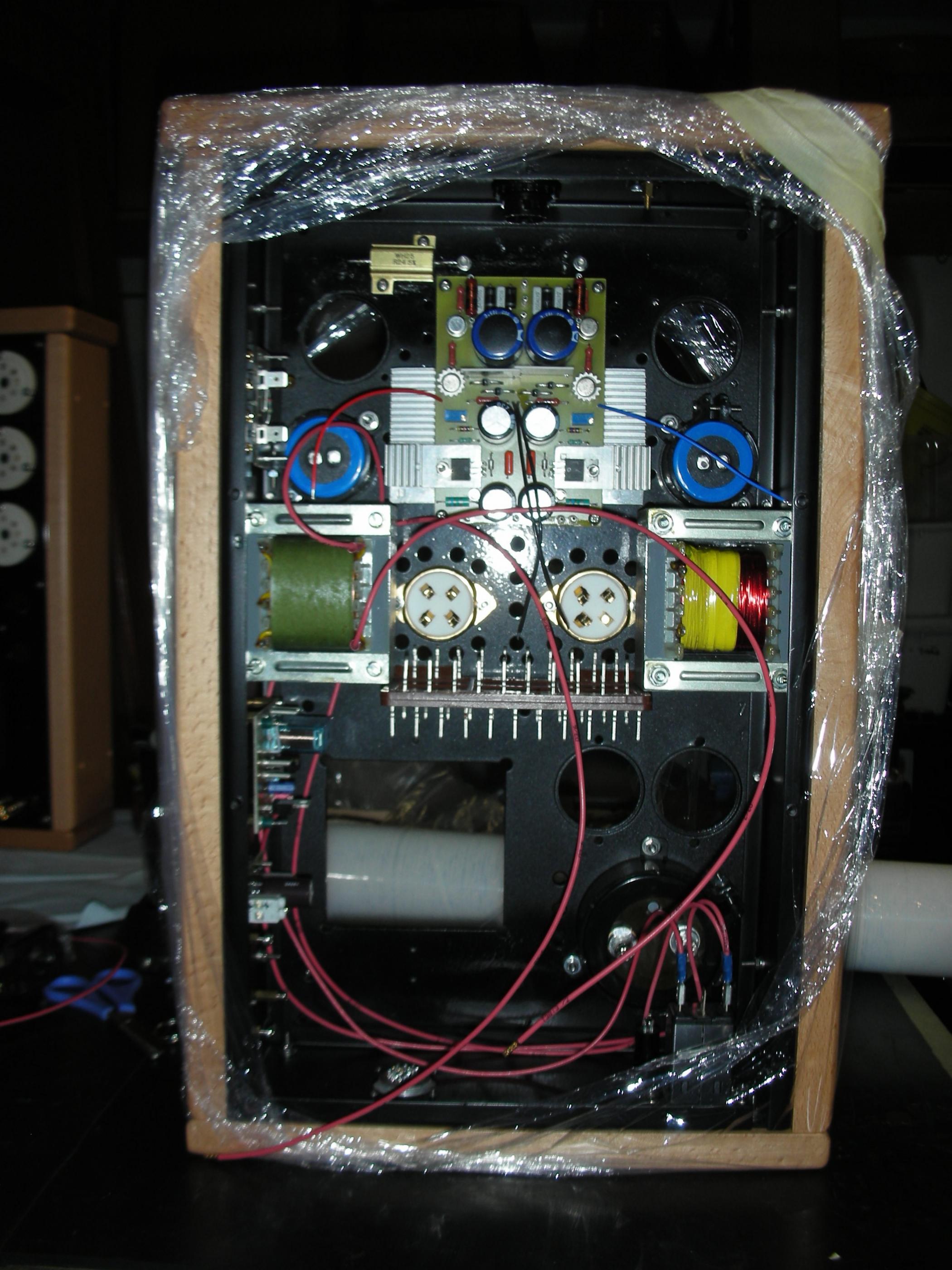

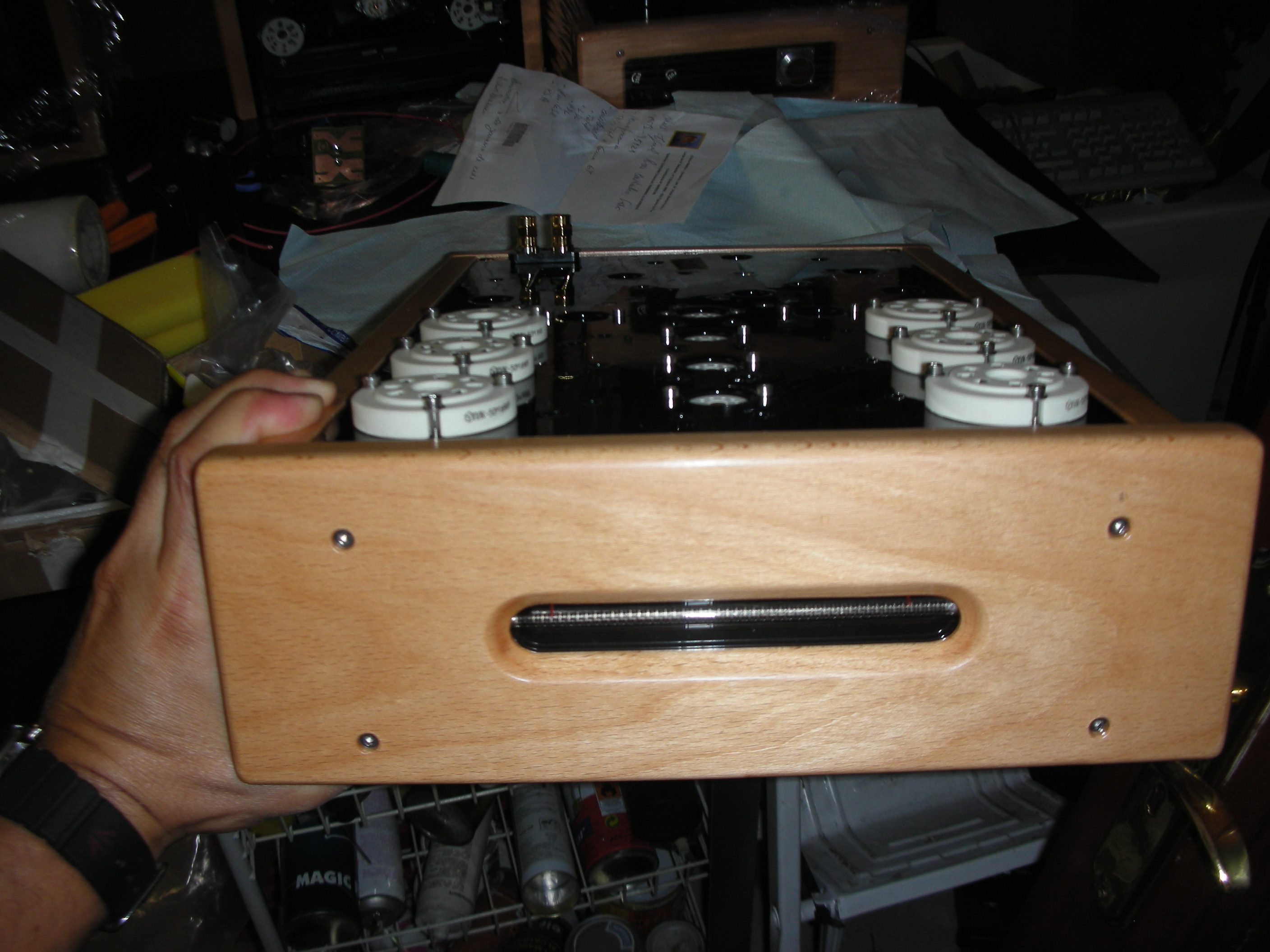

Hi Guys,
Sorry for delay but I have been very busy, the output trafo isa vanderveen toric version with cathode feedback. I am planning to finish the project until end of the current year, will see and then will post all the information. here some pics.🙂
