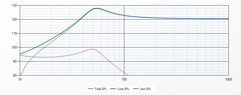

It looks like something got entered incorrectly into WinISD, or else WinISD is predicting the wrong response for this set of parameters. I used a different modeler, based on Jeff Bagby's WBCD spreadsheet, and it predicts a peak around 54Hz. I tried playing with the parameters to replicate your 29Hz peak but couldn't get that same result.

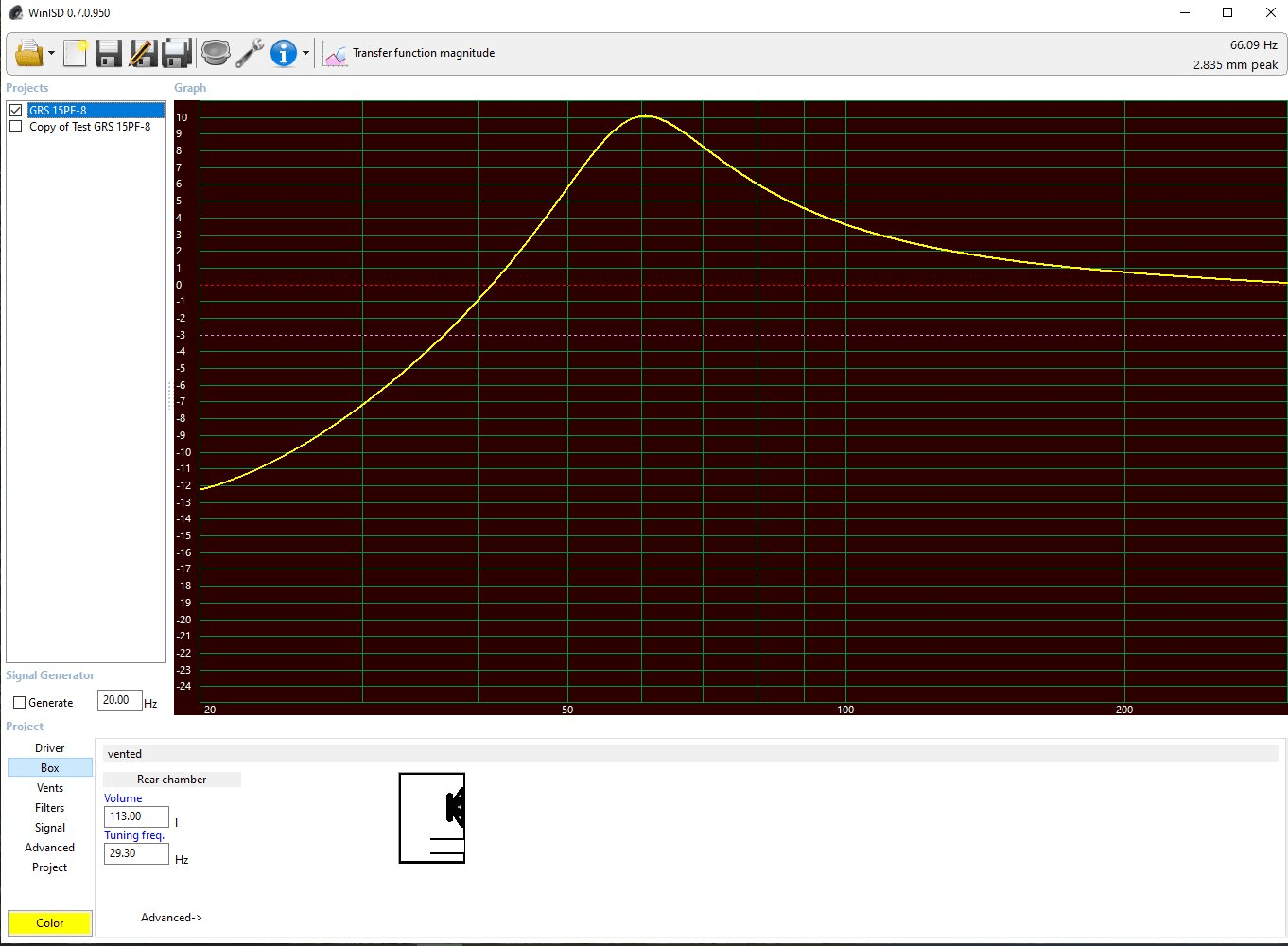

This is the most accurate responce so farIt looks like something got entered incorrectly into WinISD, or else WinISD is predicting the wrong response for this set of parameters. I used a different modeler, based on Jeff Bagby's WBCD spreadsheet, and it predicts a peak around 54Hz. I tried playing with the parameters to replicate your 29Hz peak but couldn't get that same result.

The only thing you seem to have done wrong is the data entry issue mentioned by Davor D, kouiky, Turbowatch2 & Neil Davis.
Here is the response of the driver, using exactly the parameters from the soundimports page you linked to in 113l (ie 4 cu ft) tuned with the stated port, and WinISD's default assumption of Box Ql = 10.
Note how similar the frequency and magnitude of the peak are to Davor D's hornresp sims from page 1.

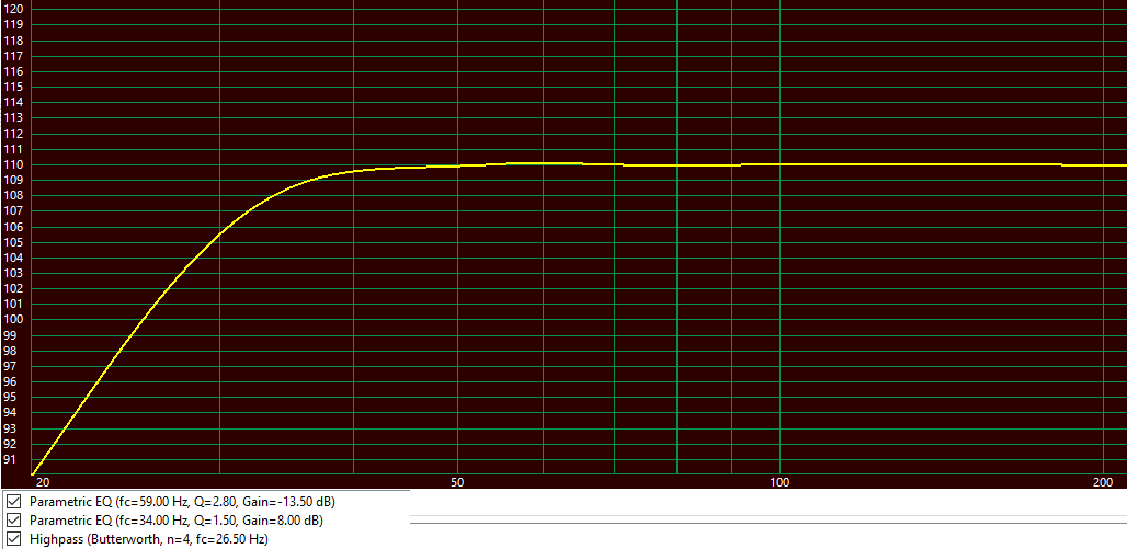

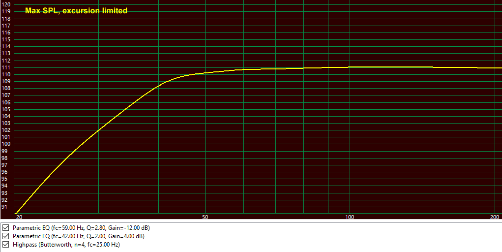

I'll also attach a zip with the WinISD driver and project file - I've thrown a little bit of EQ at it to see what it might be capable of here too:
Depending on your priorities, you might go even more aggressive with the EQ, trading off a bit more SPL for more extension:

Then it isn't surprising it doesn't sound like a subwoofer. The driver is trying to play the whole frequency range, and not just the part it is supposed to do..Its just the amp and the woofer

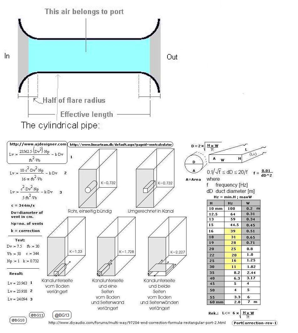

Sorry, just realised one more thing I should have added before - your port is probably tuned lower than predicted by WinISD due to the end correction factor mentioned by Davor D.
WinISD assumes that the internal end of your port is at least one port diameter away from the sides and back of the box. A slot port like you have built does not meet this criteria, and the extra extension of 3 out of the 4 port walls essentially means it will tune lower. The common way to deal with this is to manually calculate the correct port length using a different end correction factor. Former forum member Bjorno gave this graphic with the equations and factors to use:
So, your port is likely tuned around 25Hz, which very slightly reduces the height and frequency of the peak compared to my earlier post - sorry for missing that out before.
D.
D.

Nice post.Sorry, just realised one more thing I should have added before - your port is probably tuned lower than predicted by WinISD due to the end correction factor mentioned by Davor D.
D.
FWIW, it might be tuned even lower than that, as apparently using that vent length calculation could lead to calculated vent lengths that are too long anyway. See http://troelsgravesen.dk/vent_tuning.htm
