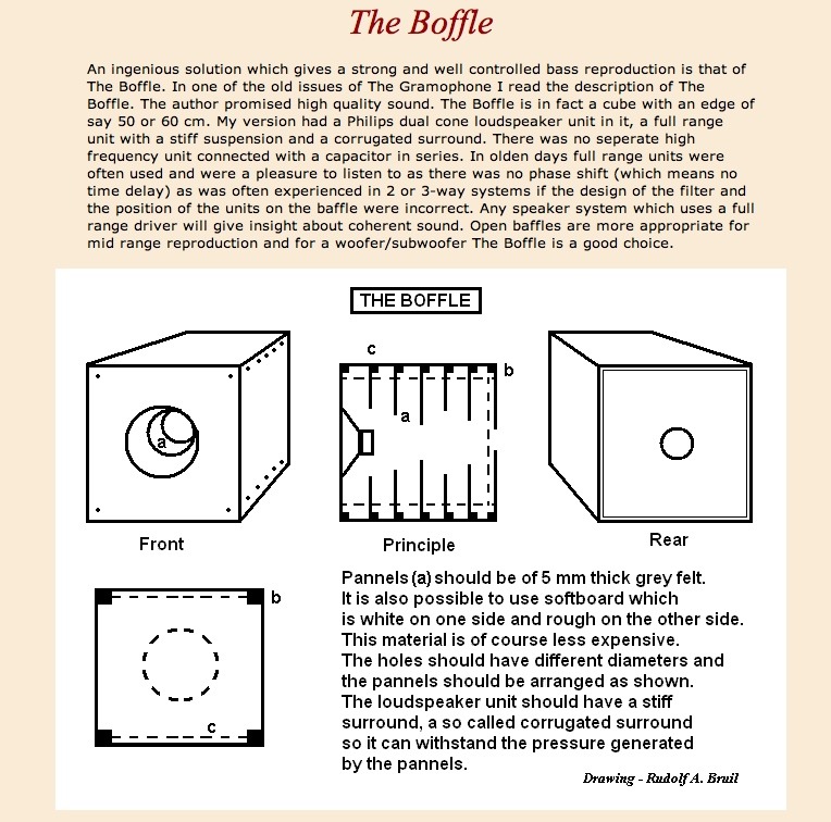

Your box has suitable dimensions to convert it to Hartley's Boffle. Its open-back box with several layers of felt curtains to absorb the back wave. So it works well with high Qts drivers like GRS.
It won't go very deep 40-50Hz maybe, but at least you'll get well balanced response without one-note bump.
For full instructions, download the zip file!
  • diy_Boffle.zip

See this thread, Boffle is also mentioned.
https://www.diyaudio.com/community/...ject-with-existing-parts.401772/#post-7417363
I dont know about Boffle system Q though.
Felt curtains have some flexibility, they move a bit under sound pressure. So its combined effect of acoustic resistance and mass/spring damping. Not possible to correctly simulate in Hornresp or similar tools.
