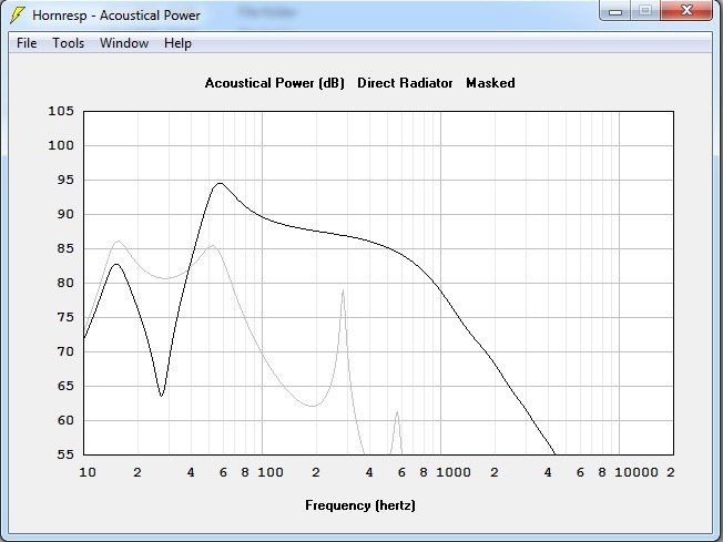

I simulated your box in Hornresp as chambered TL and unfortunately it shows what you can hear. Big bump 50-60Hz.
Than I made second simulation as vented box and results below 200Hz are very similar. Again big bump 50-60Hz.
Long vent dont have big effect below 200Hz so my quick explanation about chambered TL isnt correct in this case. The bump is drivers high-Q resonance in the box. I can post the sims if you want.

These are Hornresp sims. They show the same.
1. Black line as vented box, gray line as chambered TL.
Almost identical below 200Hz. So, my first assumption was wrong. Long vent isnt the cause for 60Hz bump.

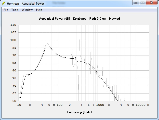

2. As vented box.
Black is driver output, gray is vent output.
Dip in driver response shows tuning frequency. Its 27Hz beacuse vent effective lenght is longer due "end correction".
Peak in drivers output at 50-60Hz is clearly visible and thats the main problem.
I tried to replicate the result from your simulation in #1. The box has to be at least 10 times bigger, 1250 Liters and more.
