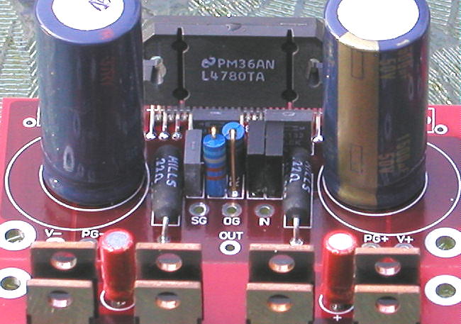

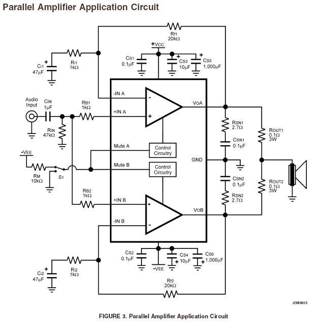

Brian,
Received my LM 4780 pc boards yesterday. They look great!
Is there a schematic I can use to determine which components go where on the pcb?
Thank you
Jim
Thank you
Jim
When looking an that pic, two power resistors are from the outputs (0.1R). Two horizontal resistors, closest to the chip, are 20k(or22k) feedback. Between power resistors, from left to right: 20k (input to ground), 2 x 1K (or 680 for more gain), and 2 x 1k (or 220R) series input resistors.
Peter
