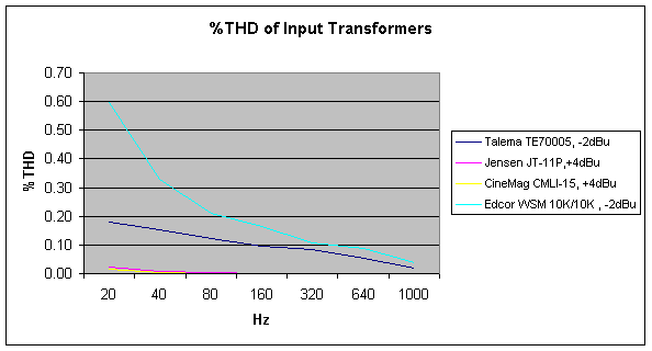

The bridging board is definitely in the plans, but I didn't have much time recently to play with it. I received today a transformer that could be used for splitting single ended signal into balanced and will see how this works: http://www.edcorusa.com/transformers/audio/wsm/wsm10k-10k.htm

I am afraid that the Edcor transformers are, well, not very exciting. Note however that only the Talema and Edcor results are from my testing; the Cinemag and Jensen are from the datasheets. But I will probably buy some Cinemags in the near future.
As you can see I had significantly better LF performance from the Talema at roughly the same cost.
