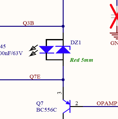

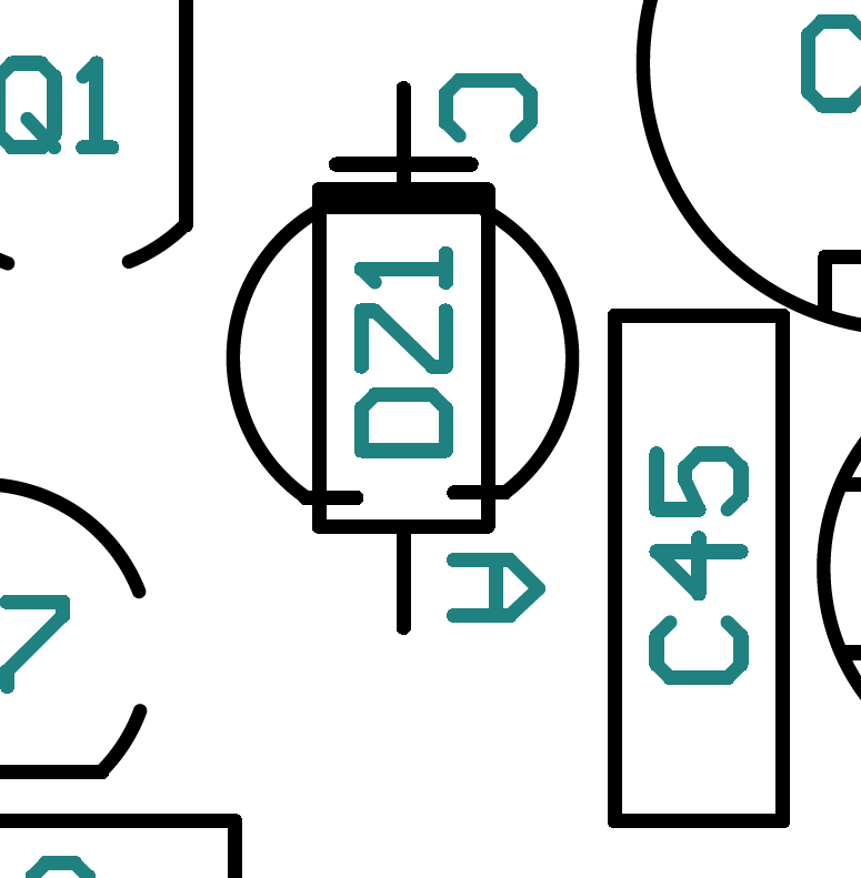

The zeners for DZ1 and DZ2...
I want to mount LED's but on the board, polarity isn't indicated...
I've also gone thru the schematics but can find this location...?
You have to look a bit closer... 🙂 The polarity is also indicated. C and A stands for Cathode and Anode for the zener and the plus sign is for the LED. You can also compare this in the schematic.
Thanks again...
My board doesn't have the c or a on it...but now I see the + and -
I thought the line on the + might of been the blocking line on a diode schematic...
Have to wait for a few parts to show up still, but it's 95% finished. Exciting!!

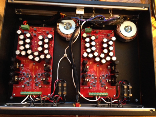

Hi Peraneders,
I'm putting 2 boards in one cabinet and would like to go with a star ground.
One board will be powering 2 Linkwitz LX521 ASP's and the other board will be powering an additional LX521 ASP plus another 2 ASP's for sub woofers. I run balanced interconnects in and out of the ASP's but wish to minimize any potential ground loops by using a star ground arrangement with the 2 SSR03 boards.

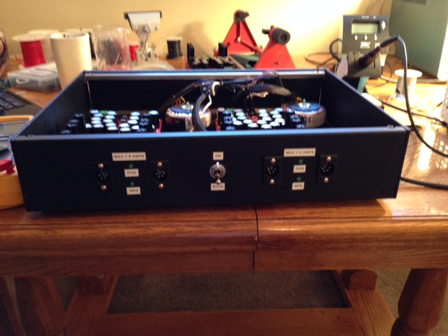

Peranders,
SSR03 up and running powering my ASP's for Linkwitz LX521 ASP's and subwoofer ASP's. Only problem was a "bad" resistor value from digikey, labeled as 56Kohm, actual 3.8Kohm, changed out for correct value and everything OK.
Sound is definitely cleaner versus the simple 78xx circuits I had before.
