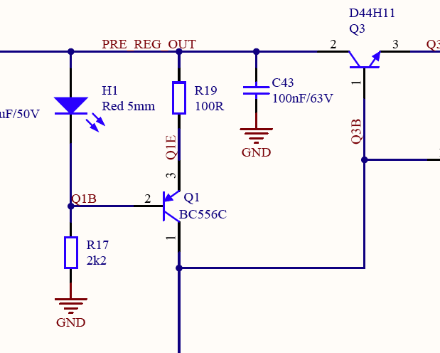

Edit: Damn...I have bigger issues. Regulator isn't working! I have to go thru and check everything, one component at a time...
The only thing that jumps out at me is DZ1/DZ2 components...I substituted blue LED's for these, instead of zeners...

Notice that blue LED's increases the the idle current and also increases the dropout voltage. It's possible that you must do some adjustments if you use LM317/337. There drawbacks to use blue or white LED's. I'll recommend red LED's.
That is what I am seeing in my setup...a slightly higher idle V.
What do you mean by dropout voltage?
I was under the impression the LED's were simply passive components, used to indicate V+ and V- operation.
I think I have some red LEDs laying around...

Dropout voltage is the minimum voltage across the regulator in order to work properly. Is is defined as VbeQ3 + Vled- VbeQ1 You see that choice of LED will have a directly influence of dropout voltage.
The LED serves as a low voltage zener setting the bias for the Q1. IQ1 = (Vled-VbeQ1)/R19
Thanks for the explanation PA.
Will it be okay to use until I get the proper LEDs installed, despite the slightly higher idle V?
