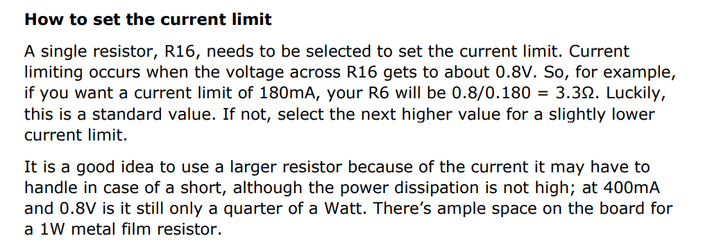

my stage should run at 45V and 9mA approximately. the suggestion that I was given is to supply a current x5 compared to what the stage will work teally, so I would like 50 mA. how do i get 50 mA from my boards? ie what is the value you want for r16 in order to get 50 mA? thank you

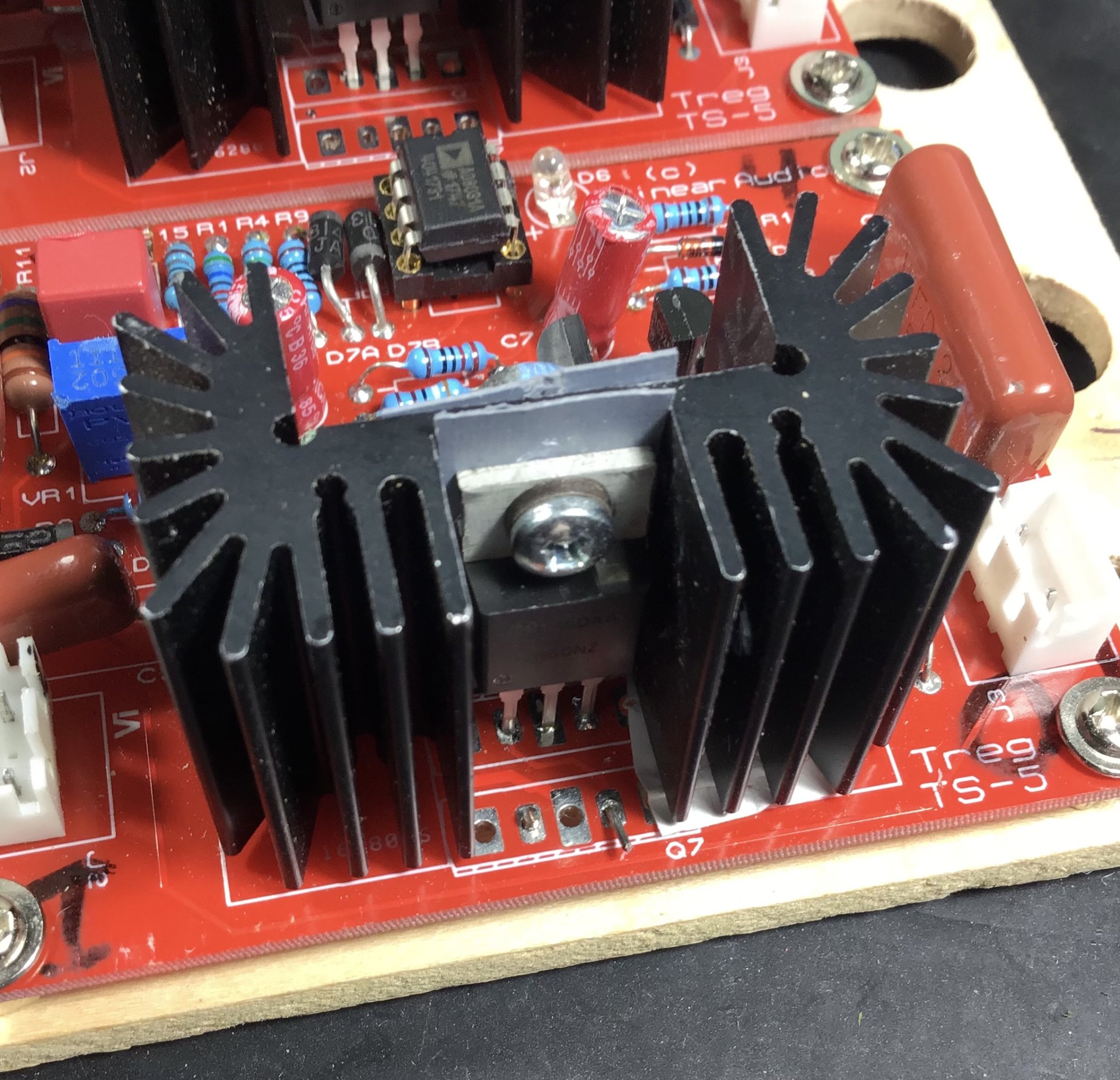

Update. Doing some routine maintenance on my amplifier, I decided that I wasn't all that thrilled with the heat sink being at 420 volts so I harvested some silicon heat sink insulation from an old computer power supply and installed it behind Q1 and Q7. Now there's less chance of getting zapped if my hand slips while poking around in there.
