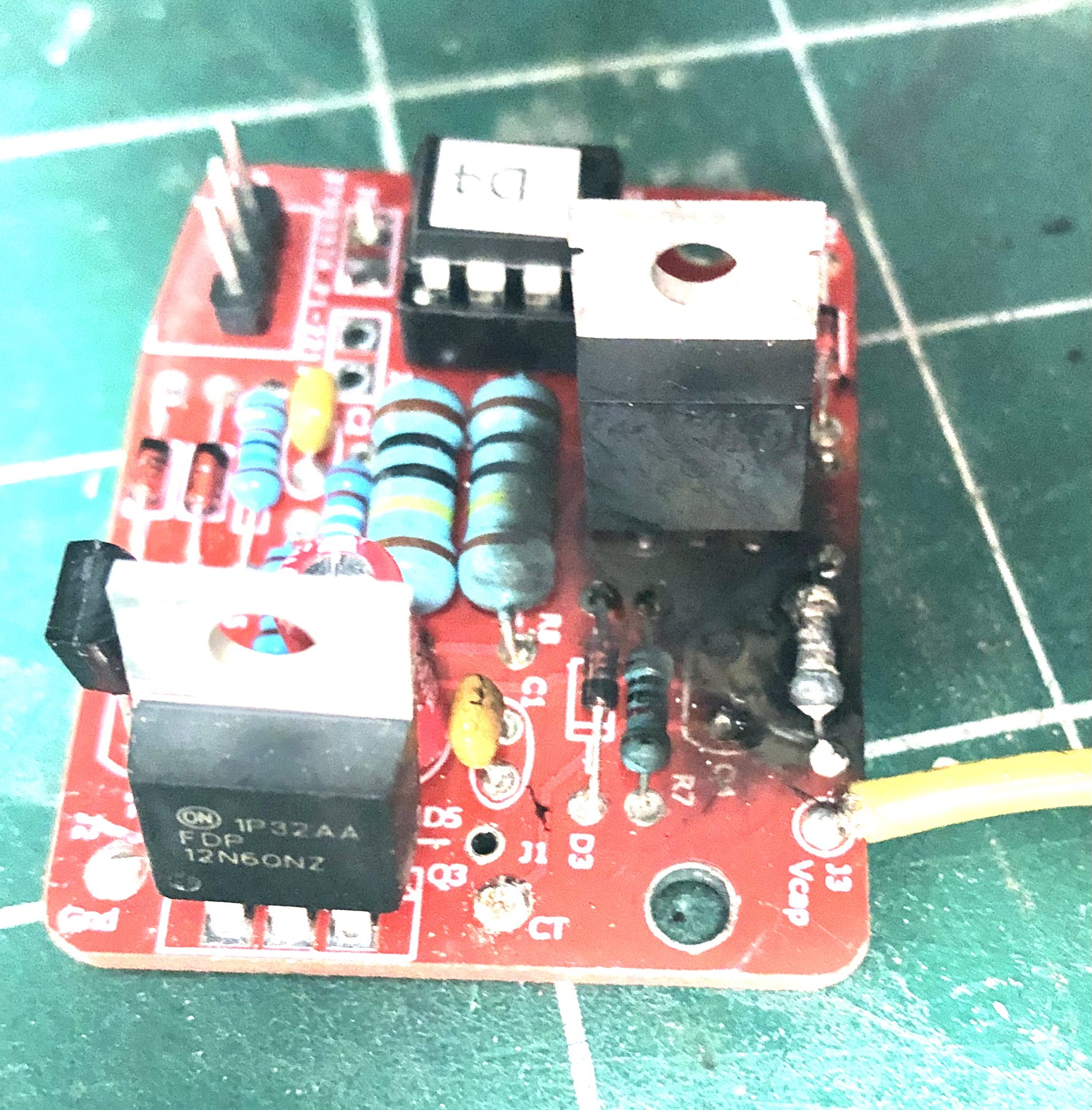

Zoof! A vaporized BJT transistor makes an interesting splatter of carbon on a pricy piece of silicon. But hey, the upside is another recyclable bunch of resources for the junk box.
A fastener that I'd thought had rolled off the bench and onto the floor and gotten lost had instead lodged itself under the HV delay PCB, causing a short to the chassis.

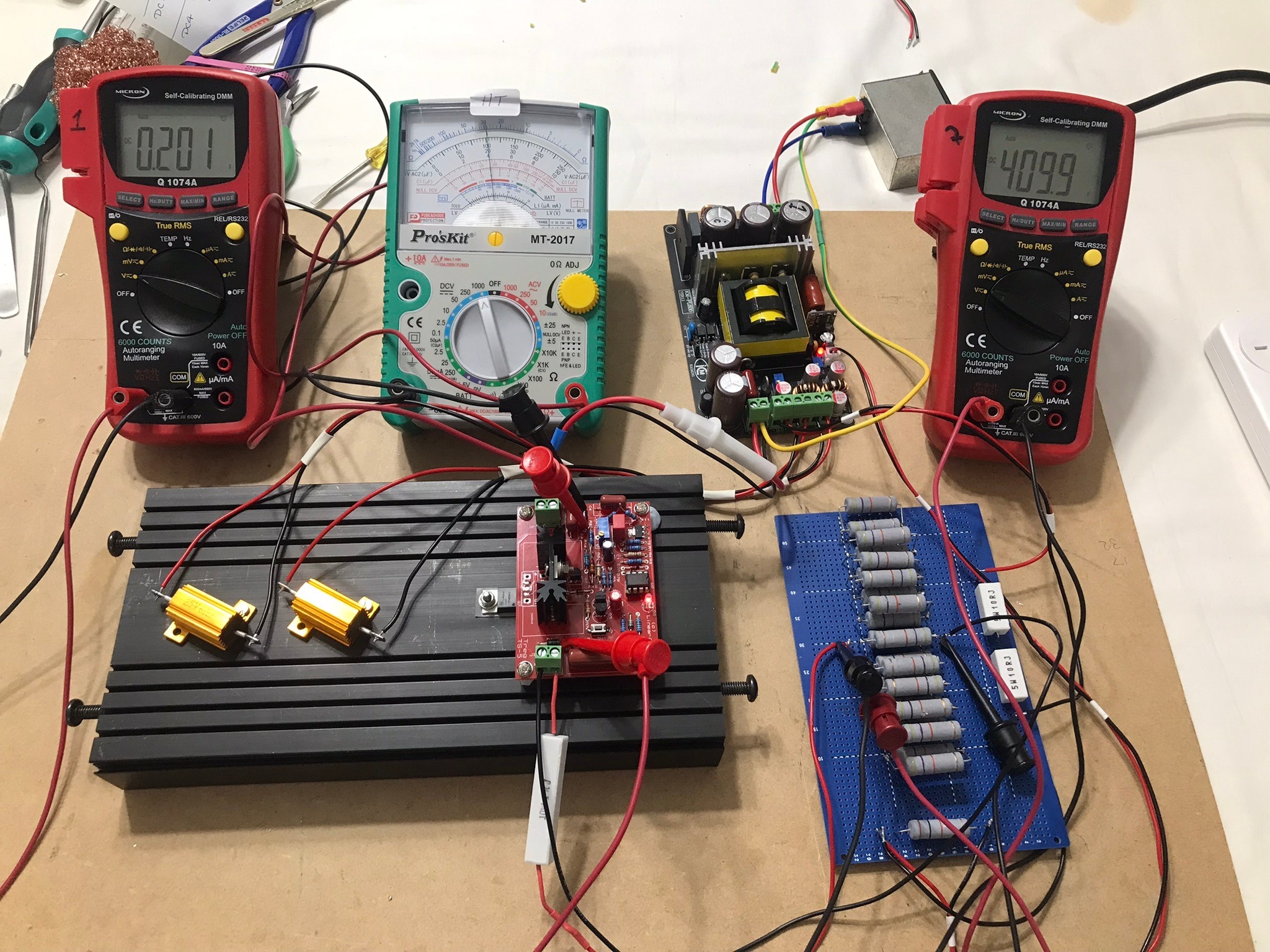

My T-reg TS-5 is setup for 400V and a current limit of 300mA (R16 = 2R7). It regulates just fine.
However, it's current limiting at around 120mA. I measured the voltage across R16 and it's limiting with ~0.3V across R16 rather than at 0.8V.
I wasn't able to get either a BC556B or BC560C for Q5 and used a BC557 available locally. The only significant difference I can see is in hfe. BC557 is only rated as >110. BC556B is 180 and BC560C is 380. Could the BC557 be the problem?
If not, any other suggestions please?
I see that BAT42s are no longer recommended for D7A and D7B and will order some SB140Ts.

Lower Hfe would increase the limiting value, not lower it.
Since you measured the actual limiting value (0.3V) the resistor values are not the cause.
Can you verify the Q2 orientation?
I've seen some with different pinout from different manufacturers but with the same typenumber.
Can you verify, if you short R16, can you get up to 300mA?
Another test is to disconnect R7 from R6 and connect that end of R7 to Vout.
That disables the shutdown.
BTW Do you see just limiting or shutdown?

Hi Jan. Thanks for the reply.
I see limiting (400V down to around 200V) followed by shutdown after 2 or 3 seconds which is as-designed I think.
Q2, Q3 and Q5 are oriented as per the silk-screening on the PCB. Q2 and Q3 are onsemi BC550Cs so they should be standard pinout. Q5 is a BC557 of unknown brand. My metre reckons it's a standard pinout with an hfe of around 400.
I shorted R16 and the regulator doesn't limit at 200mA which is all my test setup (400V across 22 47k 5W resistors in parallel) can do. I'll add another 14 47k resistors to try it at 300mA and let you know how it goes.
BTW, thanks very much for the regulator. I'm using it to clean up the HT from a cheap (relatively) LLC resonant supply in a 300B stereo amp I'm building.
Dave.

Dave, it looks that you supply T-reg from a switching supply.
Any chance that it's that supply that limits Iout?
Have you tested it on itself?
Jan

Thanks Jan. The switching supply is supposed to be good for 300W. I've been using it @ 200mA in the test bed and ~180mA in the 300B amp I'm building for a few weeks without a problem. Definitely the T-Reg that's limiting.
I'll increase the current to 300mA tomorrow.
Dave.

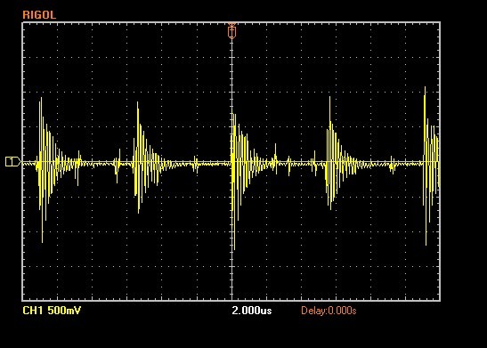

Hi Jan.
I'm very puzzled! My T-Reg doesn't limit on the bench. I don't think it's current limiting is the problem.
I'm investigating lots of possibilities. The problem may well be in the amp itself. It runs OK straight from the SMPS but there's a lot of 100Hz, 200Hz, 300Hz etc noise in the output coming from somewhere. There's a problem there that I'm yet to track down. Maybe there is sudden current spike over 300mA that my metre isn't fast enough to pick up that's causing the current limit to trigger.
Can you answer some questions for me please?
Could MHz region switching noise or residual ~100kHz ripple from the SMPS cause problems for T-Reg? I've attached a screenshot from my oscilloscope.
What would you expect T-Reg to do if the input voltage drops below the set output voltage? One theory I'm investigating is the regulation of the SMPS. Mains here can go from 222VAC up to 247VAC depending on whether the sun is shining; day night but also whether a cloud blocks the sun for a few seconds. Maybe as the mains voltage drops if the SMPS regulation isn't very good, it's output voltage drops as well.
How long would you expect T-Reg to take to settle down to steady output voltage? When I turn it on the output voltage slowly increases by 2 to 3 volts over a few minutes before settling down.
Have you experienced any hysteresis around the trimpot set-point? As I adjust the trimpot approaching my desired voltage of 400V, I get to about 395V and a fraction of a turn later the voltage jumps up to 412V. Then when I wind the trimpot back nothing happens for 2 or 3 turns before it suddenly decreases to 370V-380V. I thought there might be something wrong with the trimpot and took it out and tested it but it was fine. Maybe it's C4 charging and discharging.
When I find out what the problem actually is, I'll let you know.
Thanks and regards, Dave.
