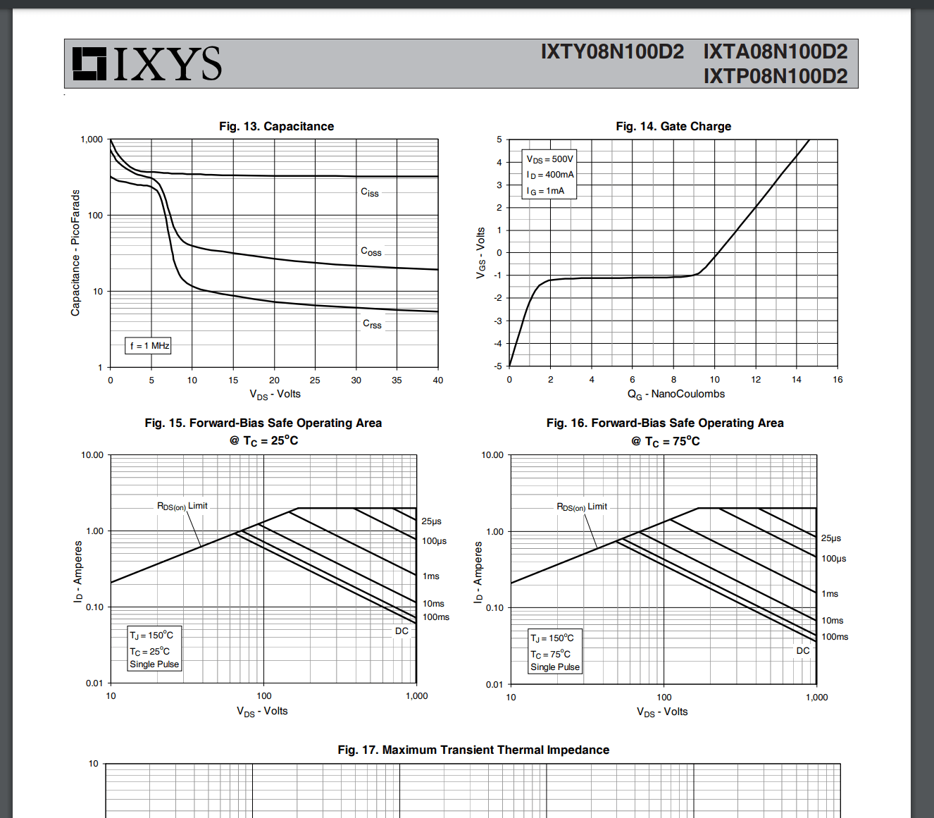

It all depends on the current draw. The 12N60 can source 400mA and still be short-circuit proof with its large SOA.
The IXTP08N100P will be limited to 100mA at 25C heatsink, and only half that at 75C. (see fig 15 and 16 of the data sheet).
Is that within the intended envelope?

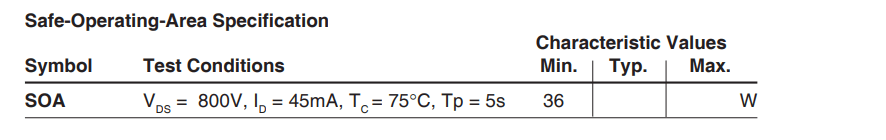

That's funny, I found it in the attached.Jan,
I can't find the SOA figures 15 & 16 of IXTP08N100P in datasheet that you just mentioned. Attached is the datasheet.
Edit: it's gone now that I attach it! Weird. I added a screenshot.
There's also a one-line spec in the datasheet, attached.
Jan
Jan,
There are two different datasheet for IXTP08N100P (Enhancement) and IXTP08N100D2 (Depletion). IXTP08N100P does not have figures for SOA. However, I assumed that we can use the same SOA from IXTP08N100D2. Now I can see your point. In my situation for normal operation with 50-60V across Vds I think it will be OK but not look good for 200Vds. It's definitely not short proof.

OK, yes I missed that difference. But you get it.
I have spend countless hours searching datasheets for a good HV FET with a wide SOA, they are rarer than hen's teeth.
Nobody is using FETs in linear mode except those funny audio guys 😎 .
The 12N60 is being obsoleted as well.

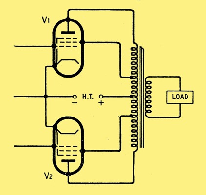

On another subject I plan to connect your regulator to the B+ of my KT88 pushpull amp with an Ultralinear output transformer, do you see any issue with this or what other recommendation you would recommend to do before connect it to the B+ (H.T)?

I don't see any problems in your use case. I have been in a discussion with someone who had problems with a choke loaded single ended amp.
But that didn't get resolved whether it was a supply issue or whether there was another issue with the amp.
