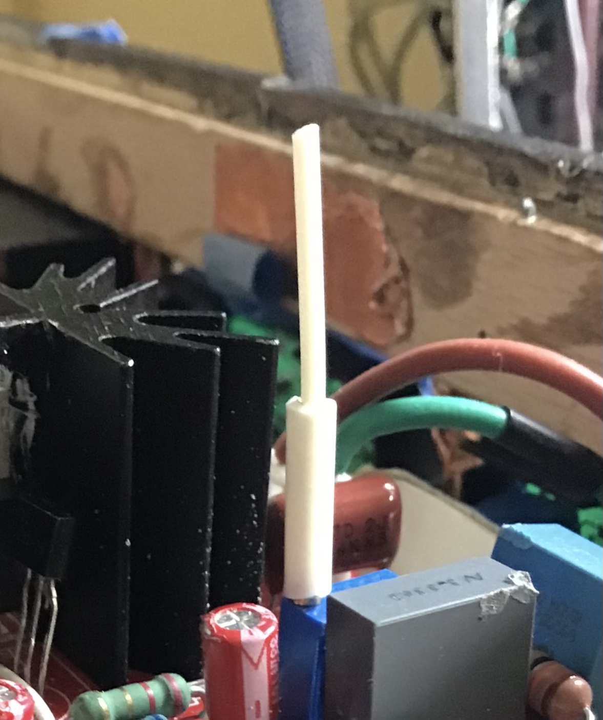

One thing that’s been bugging me, I can’t find my trimpot tool with the recessed blade for those Bourns trimpots with the tiny slotted adjusting screw. I took a piece of 3mm hollow plastic tubing, reamed out the inner diameter to fit over the screw snugly and fastened it with CA glue (aka crazy glue), being careful to not let the glue run onto the screw and trimpot body. I can now more easily adjust those 25-turn trimpots by turning the plastic rod instead of a flat blade adjustment tool that keeps slipping off, a bit hazardous if you use metal screwdriver (which I do not recommend) that could cause a short circuit. That’s particularly helpful with that heat sink at 434V so nearby.
That is a good solution. My solution is a bit different: I kept on buying (and losing) cheap insulated trim screwdrivers until I started to find them again because there are so many floating around. It's a small amount that can be used to pad a Mouser order to get over $50 for free delivery. Probably half a dozen ;-)
Jan

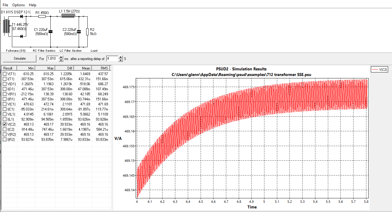

I'm trying to figure out how to use PSU designer II to design a PSU that would set the correct voltage coming into the Voltage Regulator. The last component (R2) is meant to represent the T-Reg voltage regulator. I have a couple of questions about that.
  • Should the load representing the T-Reg be resistive or a constant current load?
  • And what would be the appropriate values (either resistive or constant current) to most accurately represent the T-Reg?
Thanks,
Glenn
