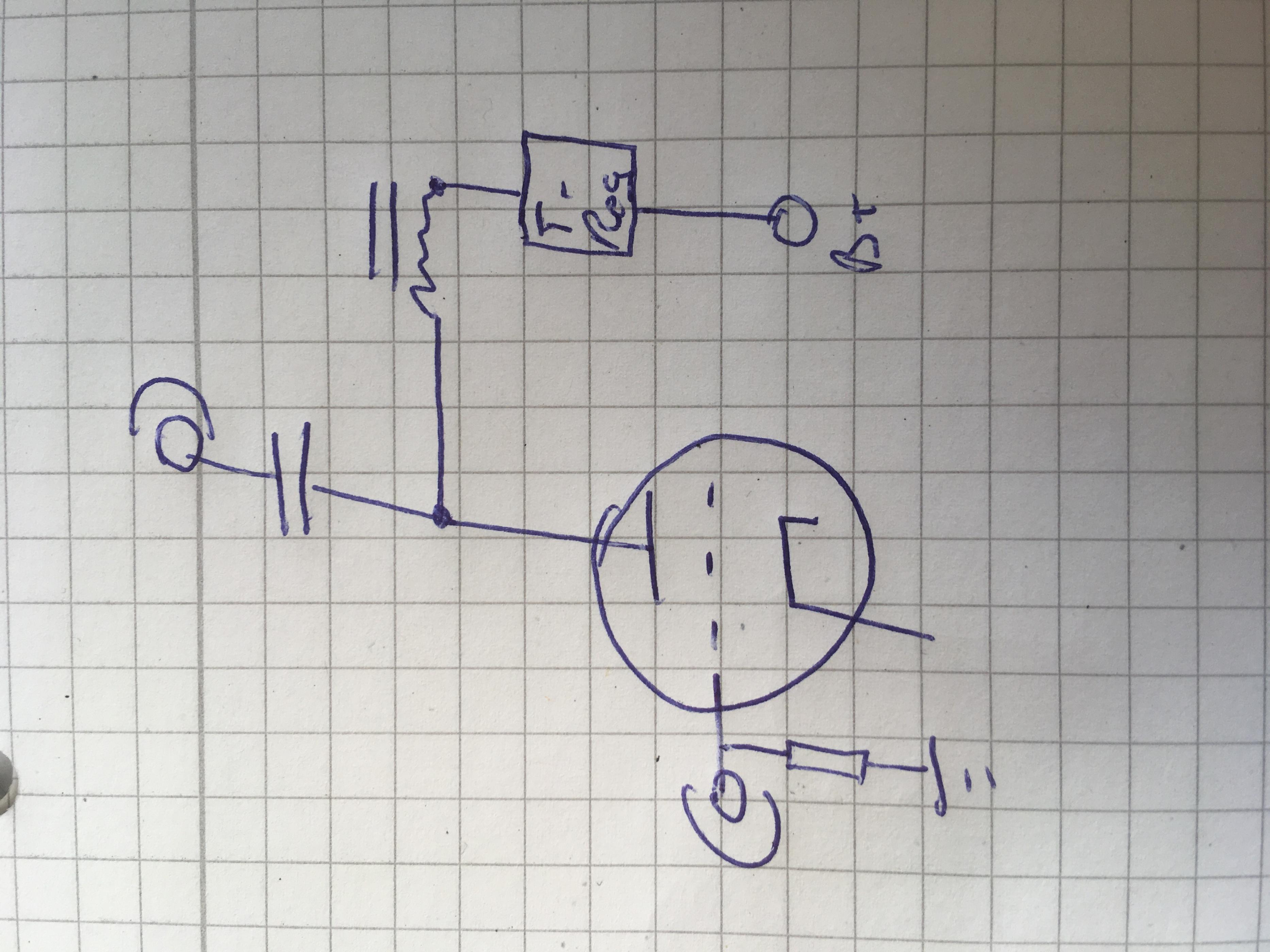

I'm a bit confused about the intended use of this regulator. It makes sense that everything following after the regulator compromises it's performance so it should be connected close to it's load. It seems that different users had problems connecting it to interstage or output transformers directly and that the regulator is unstable with an inductive load?
That leaves a use in single stage buffers ("line stages") with anode resistors as loads.
Is that correct?

Ahh yes, but you have to discern between a series choke after the T-reg, or the load presented by an (interstage) transformer.
A series choke may be troublesome, but it should be noted that using a series choke after a regulator doesn't make any sense anyway. It's a waste of money and space. If you are religious about chokes, put it before the regulator, that can make sense.
An (interstage) transformer should be no problem as it isn't an inductor but reflects the secondary load to the primary and the regulator and that load is normally not inductive.
In the previous pages there are some reports with successful use of T-reg and a transformer.
Jan
"A series choke may be troublesome, but it should be noted that using a series choke after a regulator doesn't make any sense anyway. It's a waste of money and space. If you are religious about chokes, put it before the regulator, that can make sense."
How does it make sense to take the high Z anode load and replace it with a low Z regulator and then put that high Z inductor before the regulator???
This all remains very confusing.

"Should be no problem" and "some reports with successsful use" still make it sound as if something like the attached schematic might or might not work...
