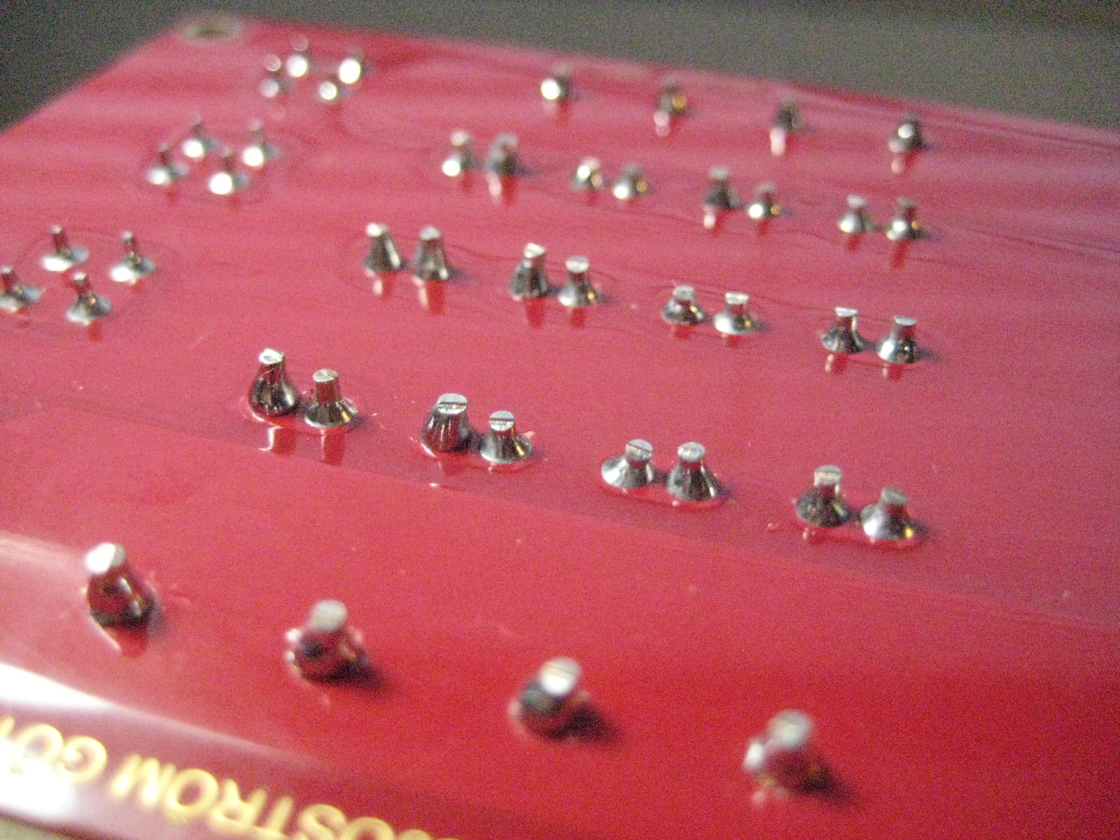

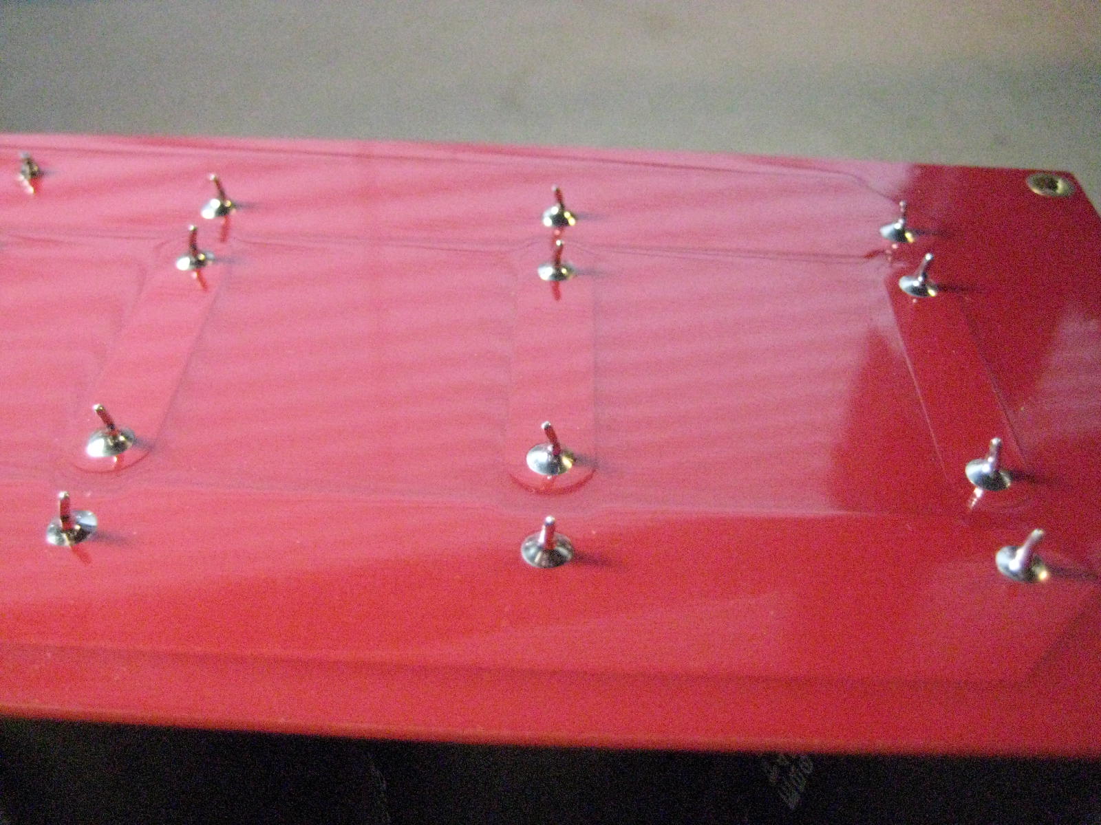

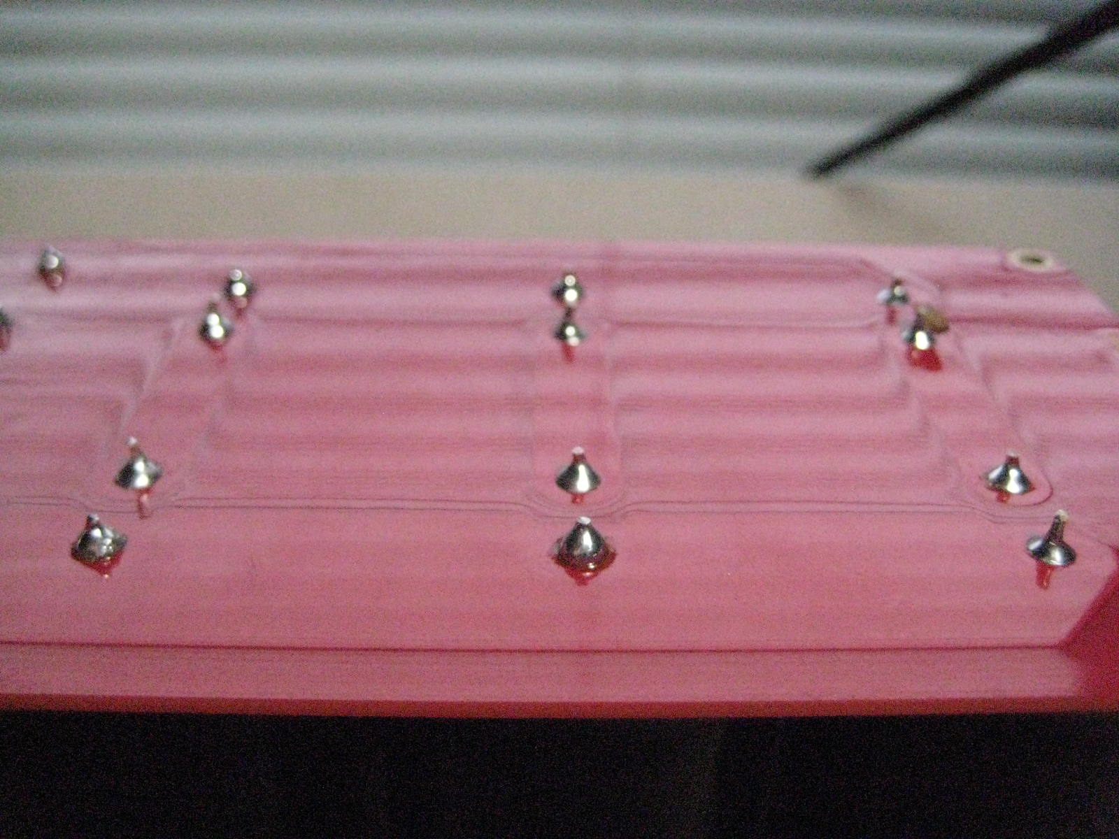

It's correct that you'll need a lot of heat to solder 105 um copper and rather big parts. Personally I use a 135 W iron turned up to 400 deg C.

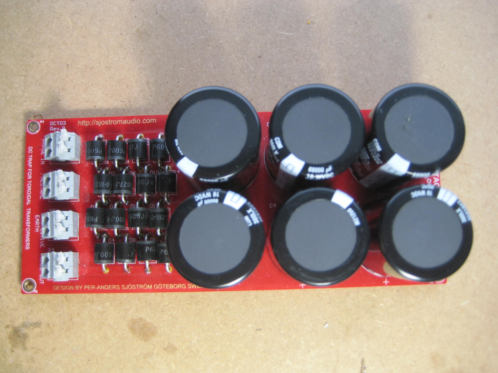

AmpUtator, if you take a good picture of your DCT03 (both sides) I can tell you with rather high certainty that it will work.

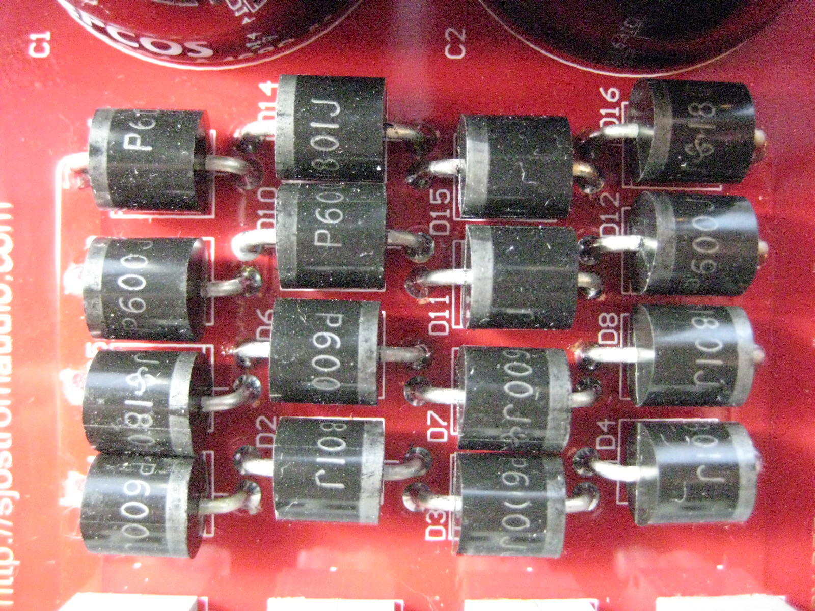

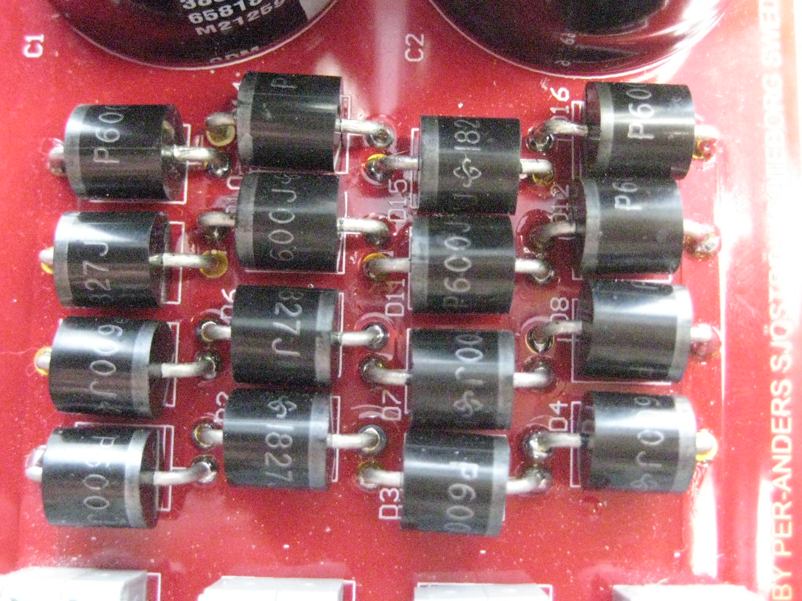

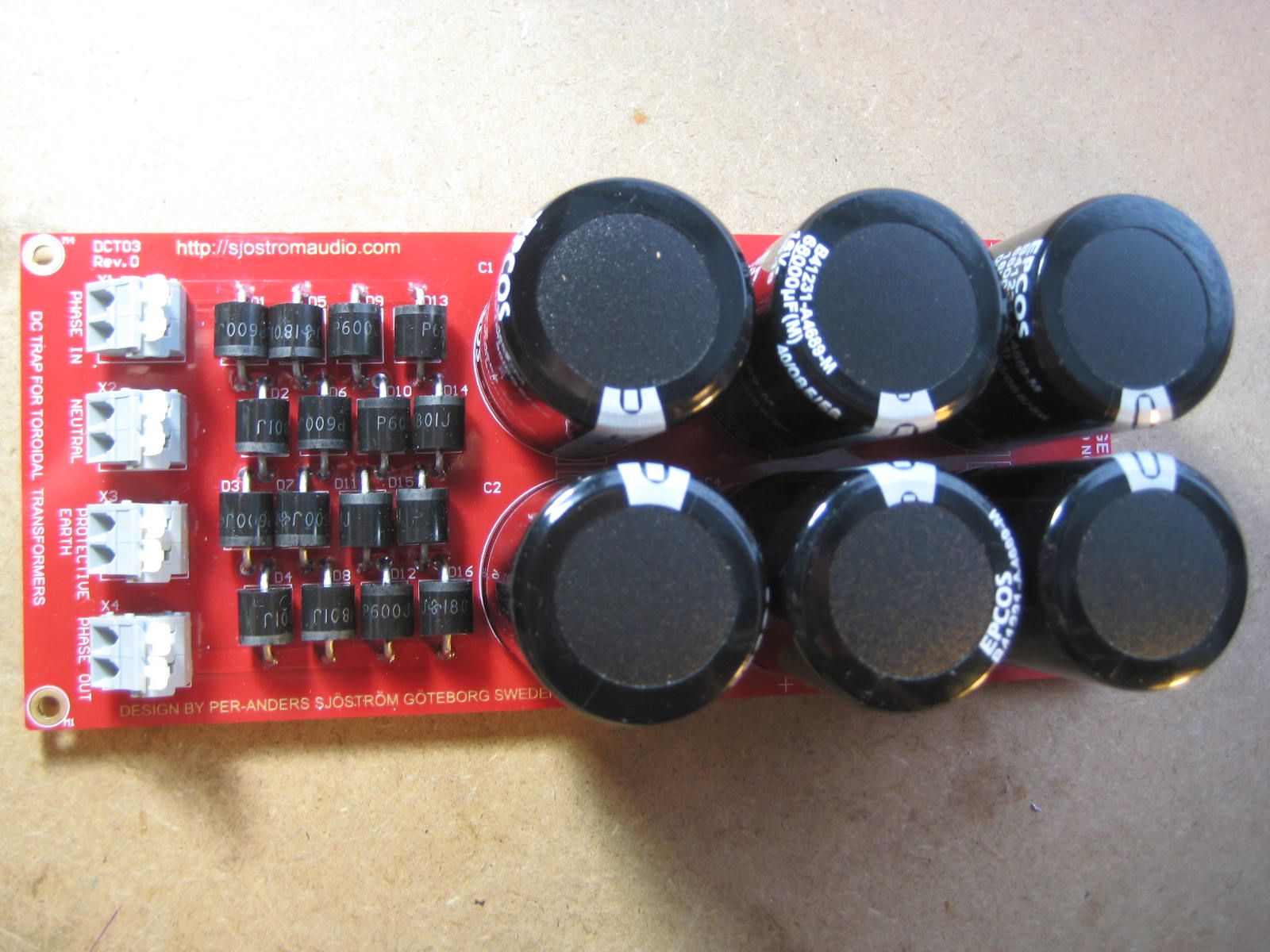

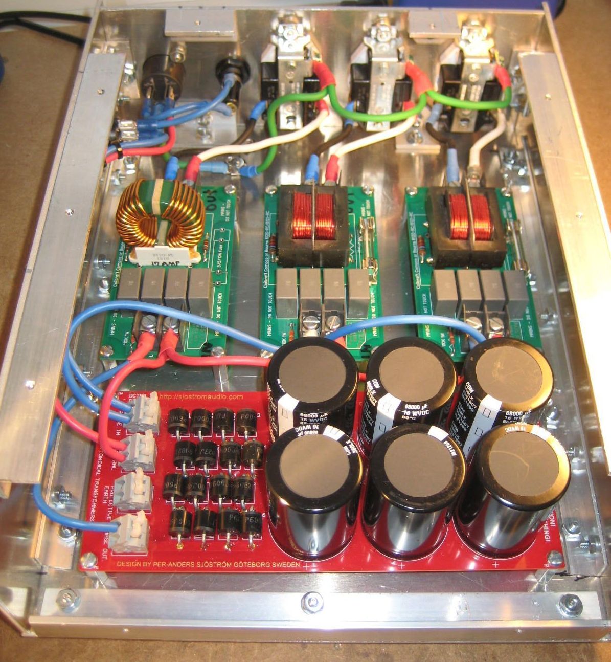

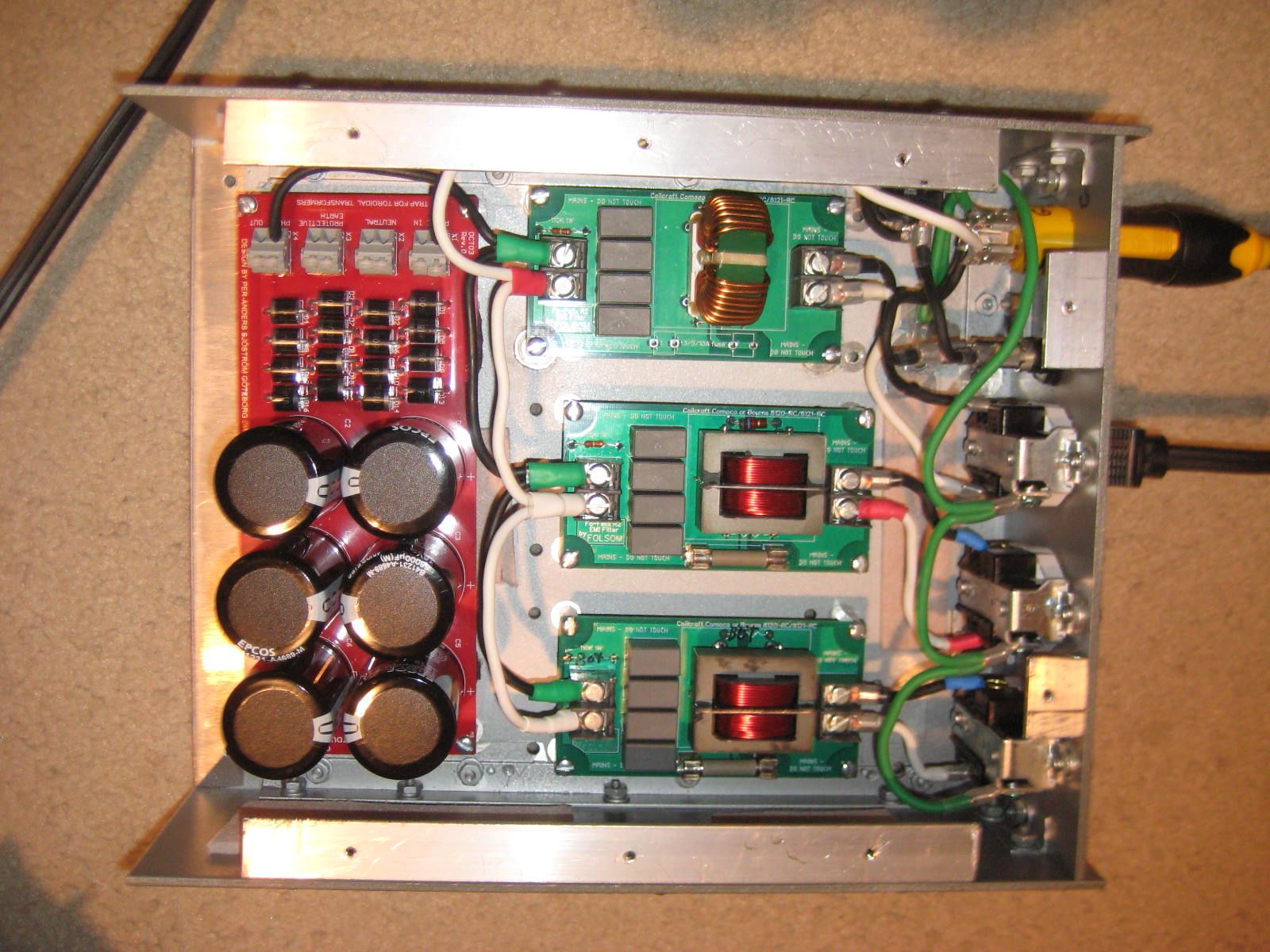

Hi Per-Anders,
I built two DCT03's. The first unit uses CDE 380LX caps, (TDK's were out of stock) I hope the 380's are okay to use?
I briefly tested my DCT03/Fo-Felix build using an old receiver and didn't notice any problem.
Take a look at the photos and see if you think it looks okay.
After my enclosures are painted I'll test them both and see if I notice any sparks as mentioned by shattered_dream.
I did do a better soldering job on my second unit. I'll upload those photos later.
Thanks,
It looks OK. 🙂
Awesome. How about the second DCT03 with the TDK caps?
No problem with sparks?

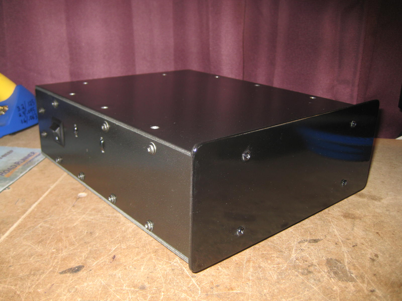

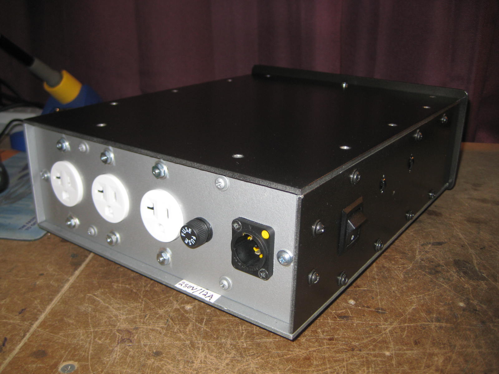

shattered_dream.
Sorry it took me so long to get back to your question. I finally finished the paint job on my Fo-Felix / DCT03 build and re-assemble the unit. I hooked up 3 components to the outputs of the Fo-Felix / DCT03, turned out all the lights, fired everything up and no sparks at all. It appears to be working as it should, no problems so far.
I'm very proud of this project especially since it's my first DIY project dealing with 120vac. Many thanks to Per-Anders and Folsom for the awesome pcb's and instructions. I'll be building one more of these in the near future. Next up for me is the Mesmerized DCB1 preamp. I don't have the skills yet to build the BA-3 preamp but it will come in time. Many thanks to everyone.
