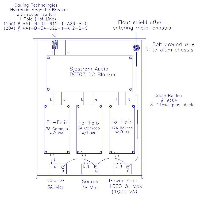

Per-Anders,
I have your DCT03 that I'm planning on installing inside an aluminum enclosure along with three Fo-Felix AC conditioners. My power amp transformers do not hum or buzz.
Would it still be beneficial to include the DCT03 with my Fo-Felix.
Thanks for any advice. This is my first mains project.
Attached is a draft photo of the project.

You don't need to fix a problem you don't have. The DC filter will only remove DC, nothing more. If you feel better adding this filter, why not add it?
I do feel a little better about adding the DCT03 but only because builders of the original Felix conditioners added a blocker but just a couple caps and a 35A bridge rectifier. I already have the parts to build the DCT03.

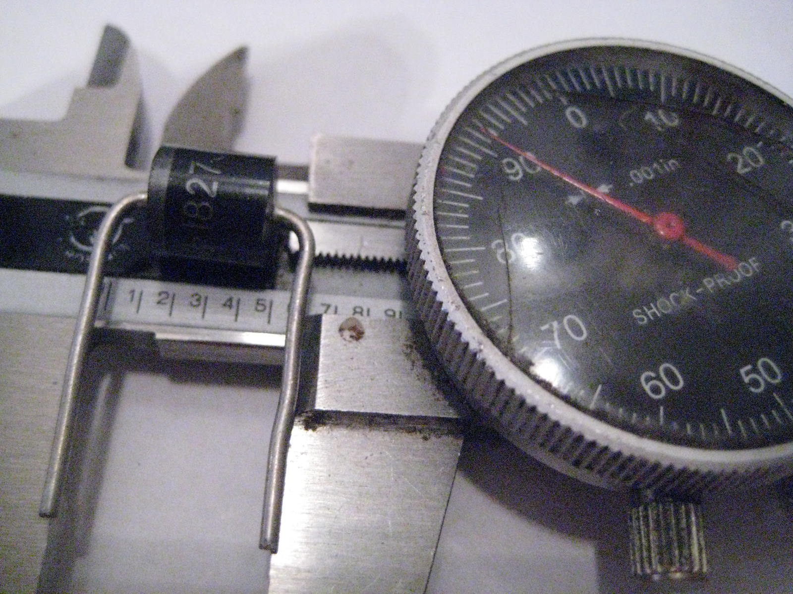

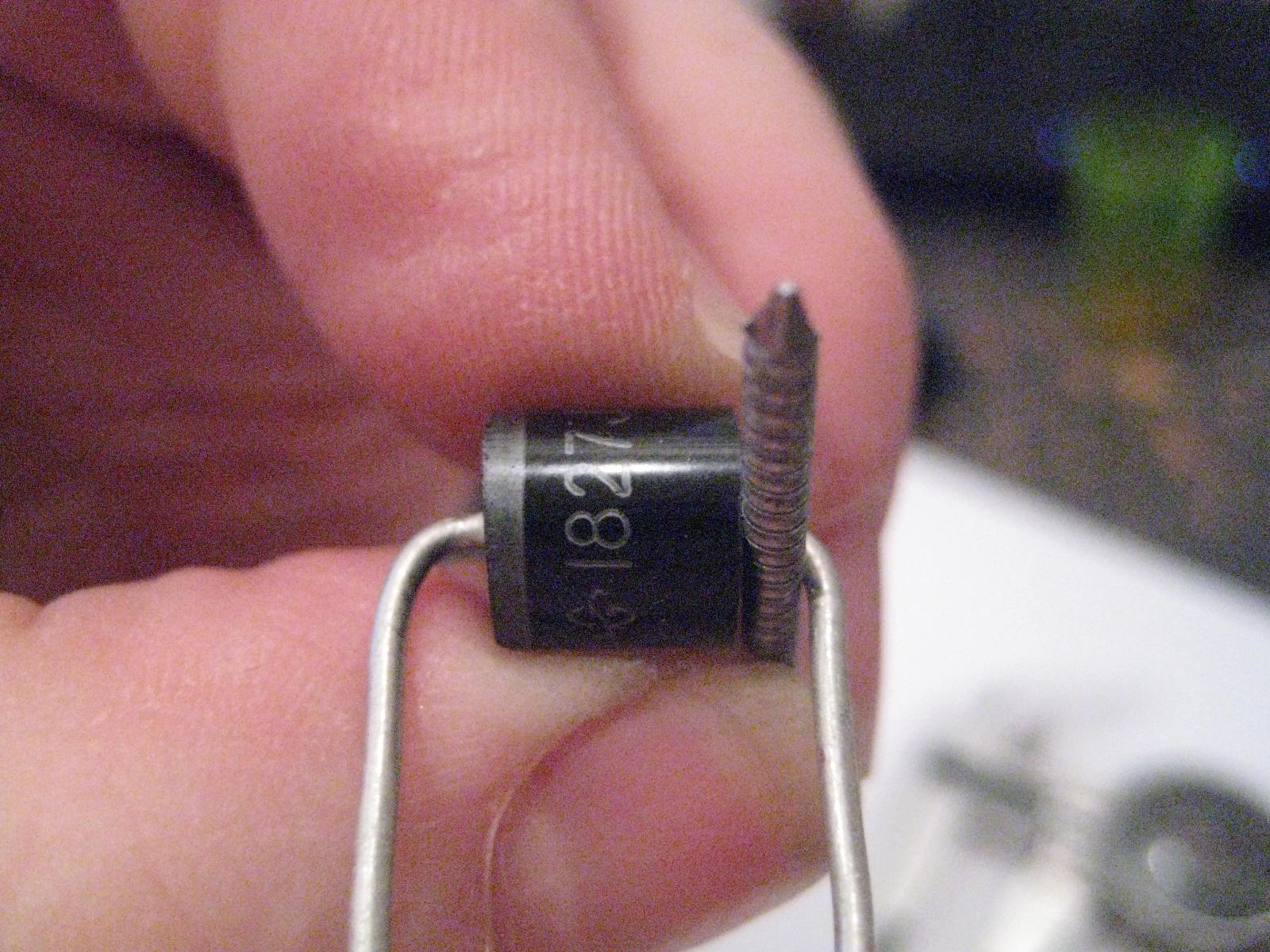

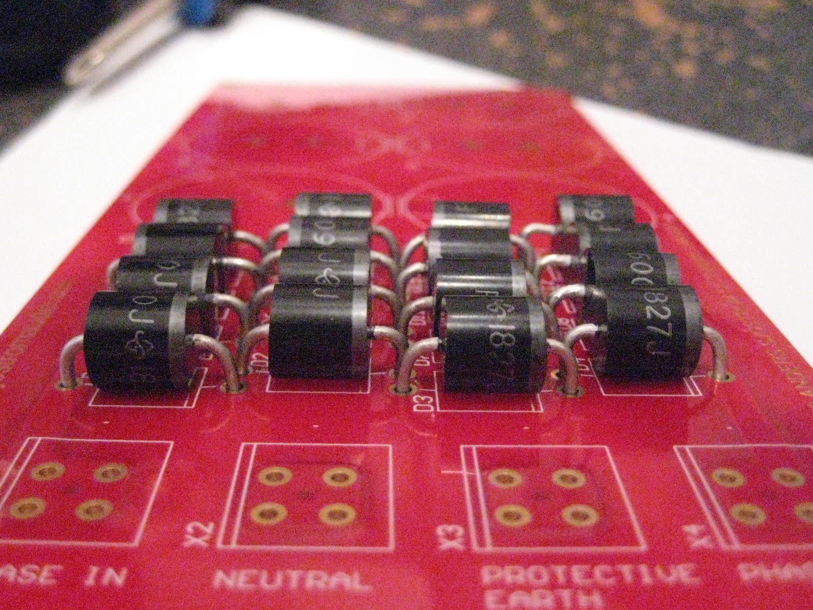

I'm making progress with my first build.
At first glance those Vishay Rectifiers look intimidating, at least to me, plus the big .050 diameter leads.
After some trial and error bending the leads around a .080 diameter nail worked pretty good giving a spacing of 15mm almost every time.
Crude but it works.
To solder them using my Hakko 888D I'm thinking 700F with Kester 44, 63/37 or 60/40. I have both in 0.5mm and 1.0mm diameters plus some liquid flux.
It must take some HEAT to solder those Rectifiers.

I use a bending plier like this:

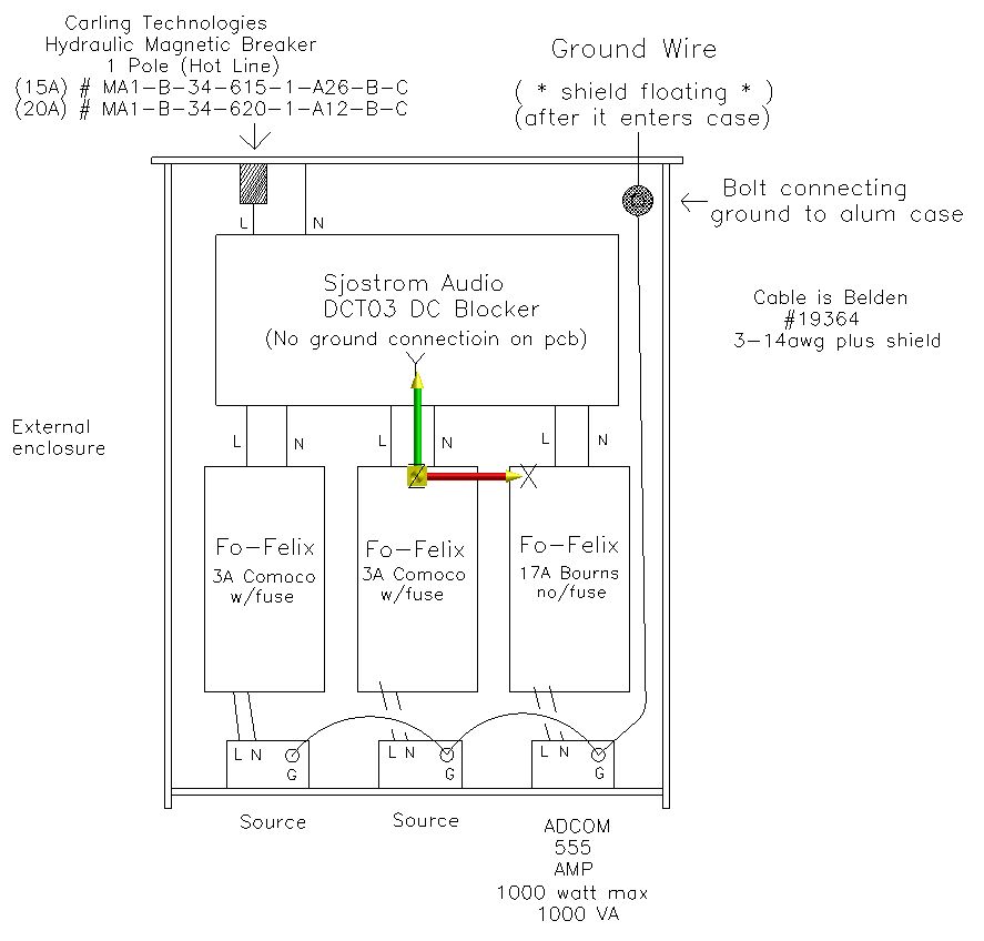

Not really good idea... I had the Folsom behind the DC trap... When switching on there was sometimes a spark at the Folsom PCB and only on the one behind the DC trap...Per-Anders,

Could that be before Folsom suggested to use nylon washers above and below the PCB stand-offs?
I have the Folsom's as well and have been planning on putting (2) 3 amp Comoco's and (1) 17 or 20 amp Bourns behind the DCT-03.
On my construction everything regarding this is made of plastic... Destroyer OS told me in advance
Spark, that sounds not good. Has the pcb approved creapage distances? Where do you have sparks, can you show me?Not really good idea... I had the Folsom behind the DC trap... When switching on there was sometimes a spark at the Folsom PCB and only on the one behind the DC trap...
