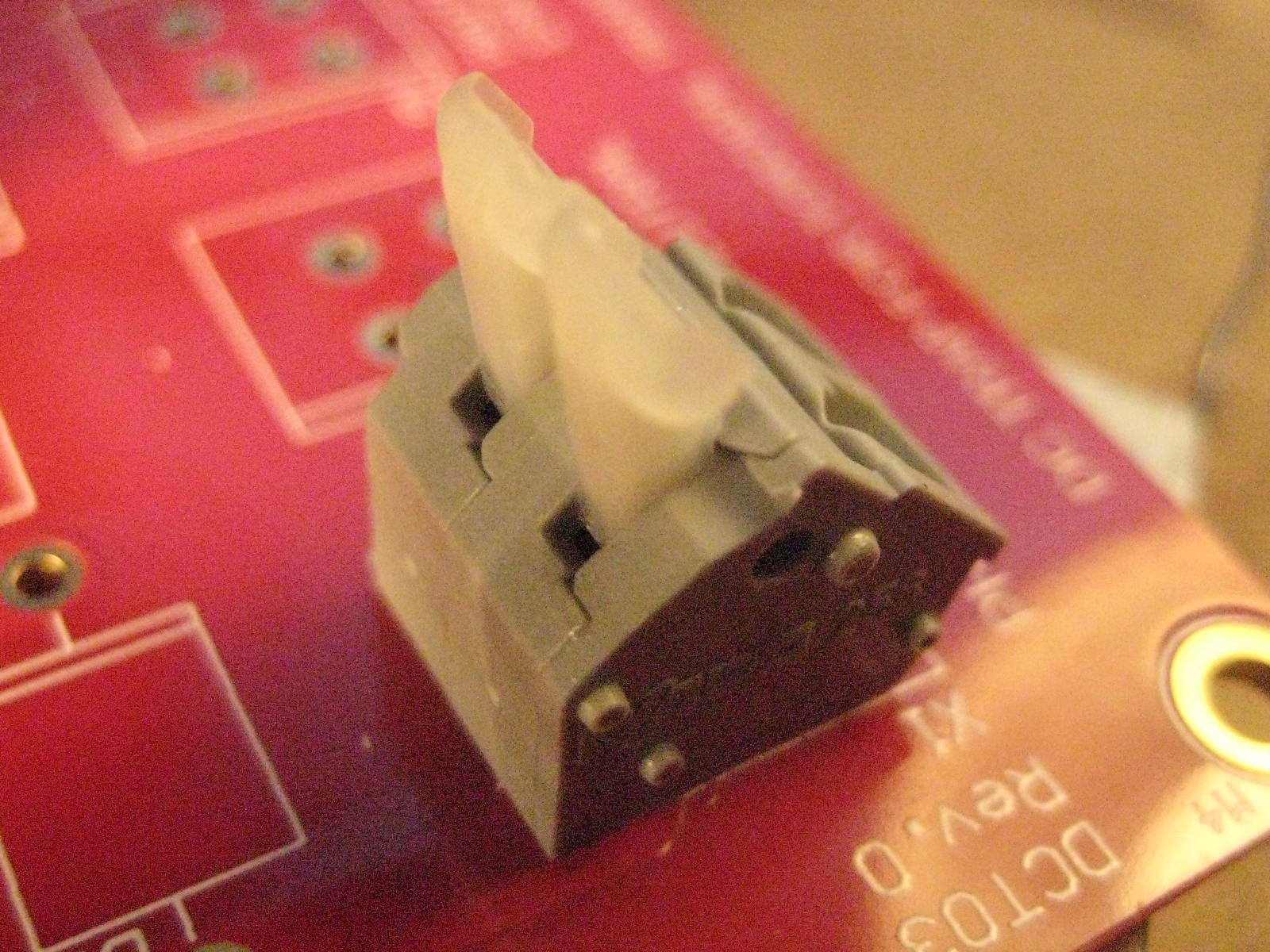

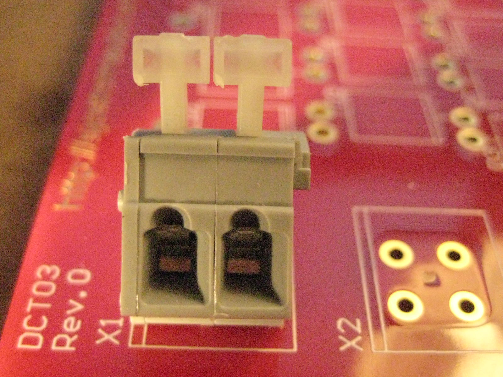

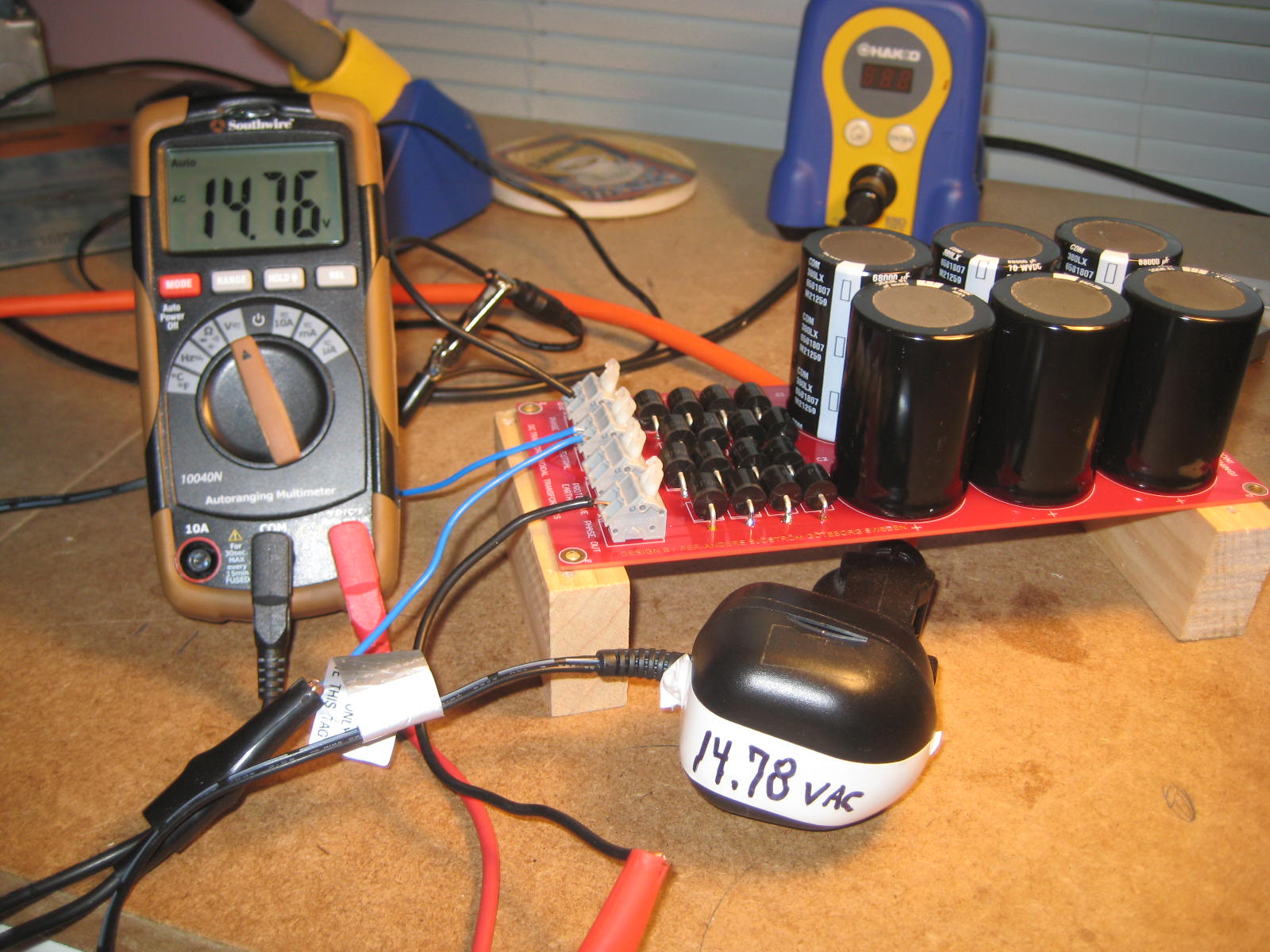

You push the lever with a finger or a screwdriver and the you insert the wire.There must be a trick to using the Wago connectors.
I can push on the levers until they break and they won't budge.
What am I missing?

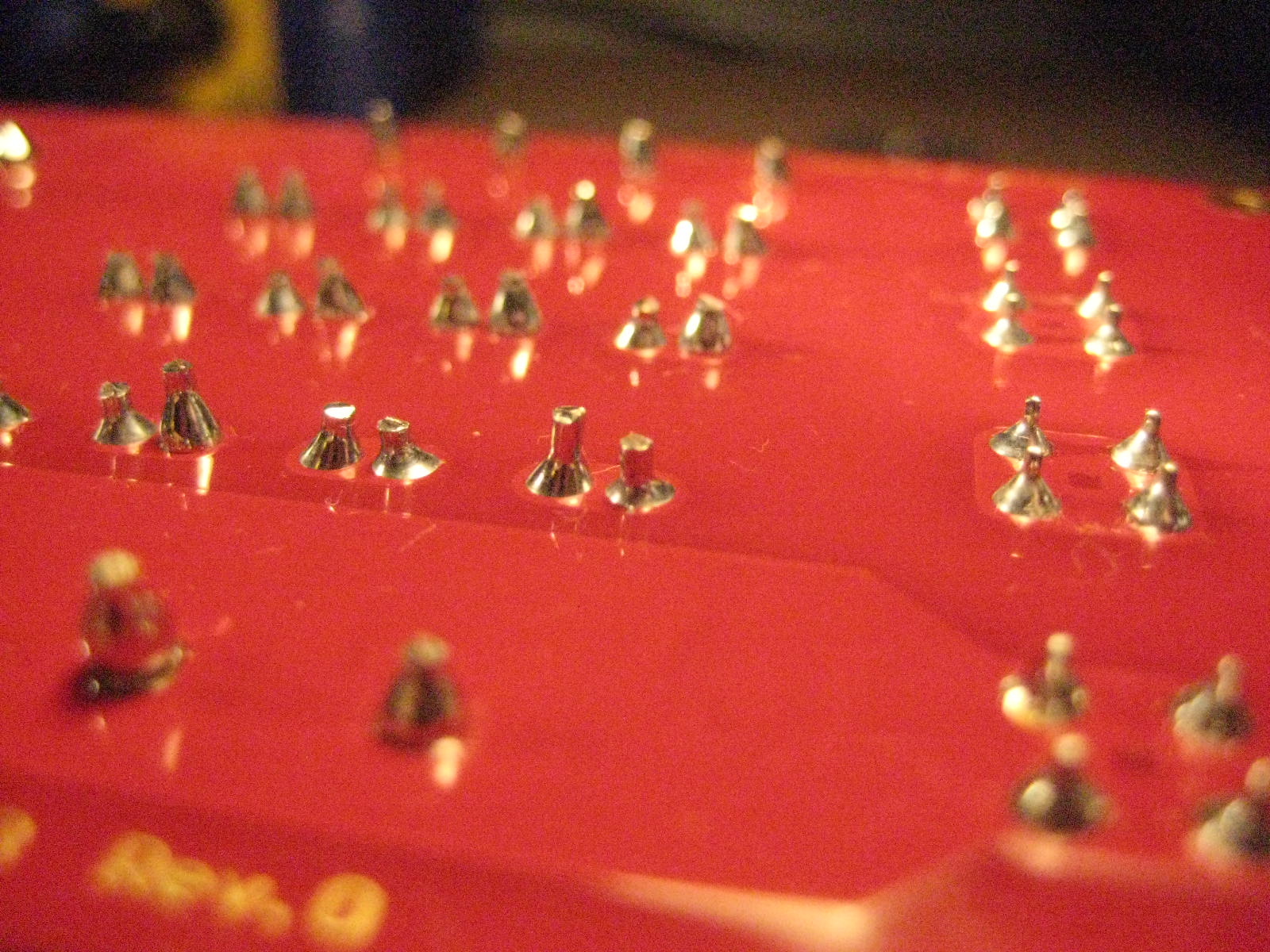

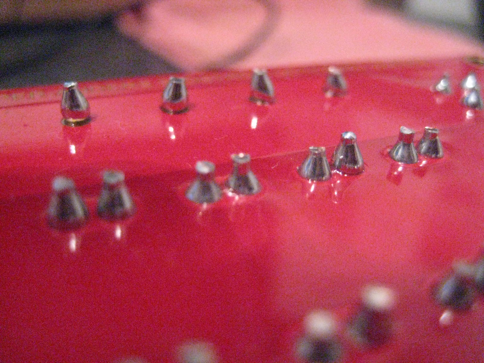

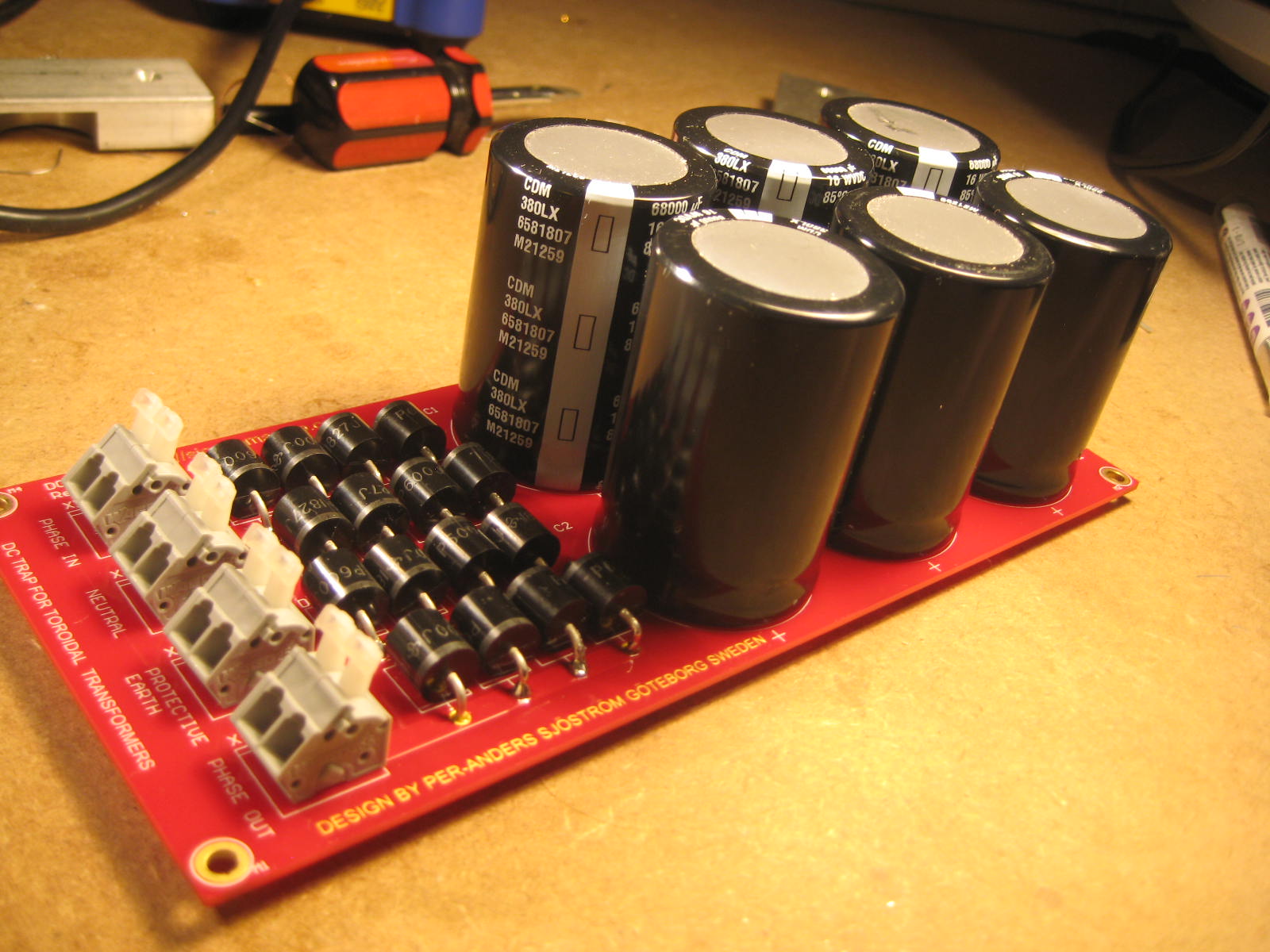

1 of 2 finished. I hope my solder joints look okay. I can't alway's get the solder to flow from the bottom to the top of the pcb. Not sure if that's an issue or not. All the joints are solid but some look dull to me.
I see some bad joints in the second picture. Don't be afraid to heat up the soldering points. Use two soldering irons if you have. Personally I use a 135 W iron.
Thanks, I thought so. The joints closest to the edge. I'll redo them.
If you use a 135w iron then I should be able to crank up my Hakko station to 750F.
I've been worried about frying parts with it that high. On some of the rectifiers I tried using an alligator clip/solder braid as a heat sink on the top side of the pcb.

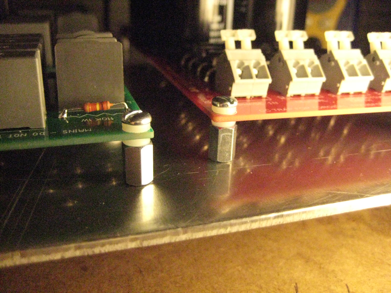

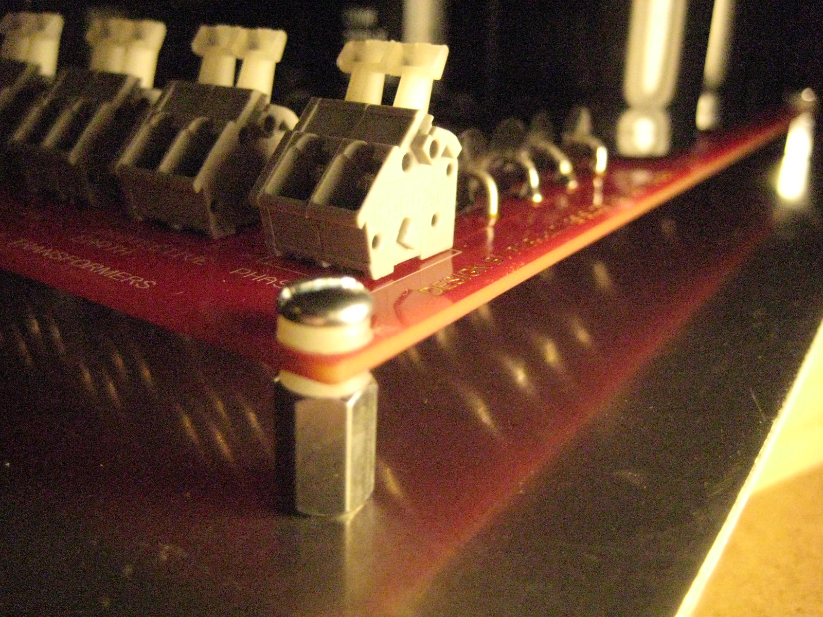

DCT-03 feeding 3 - Fo-Felix power conditioners.
Since the Fo-Felix need nylon washers above and below the pcb I did the same with the DCT03.
If this doesn't look right please let me know.
The DCT03 pcb doesn't need any insulation washers so you can use metal screws and spacers only. Why does the green board need nylon washers? Too small creapage distances?
Thanks, I'll remove the washers on the DCT03.
On the Fo-Felix pcb's (Rev #1) there was not enough clearance around the mounting holes so it was suggested to use nylon washers above and below the pcb.
I have several Rev #1 pcb's.
That has been fixed in Fo-Felix Rev #2.

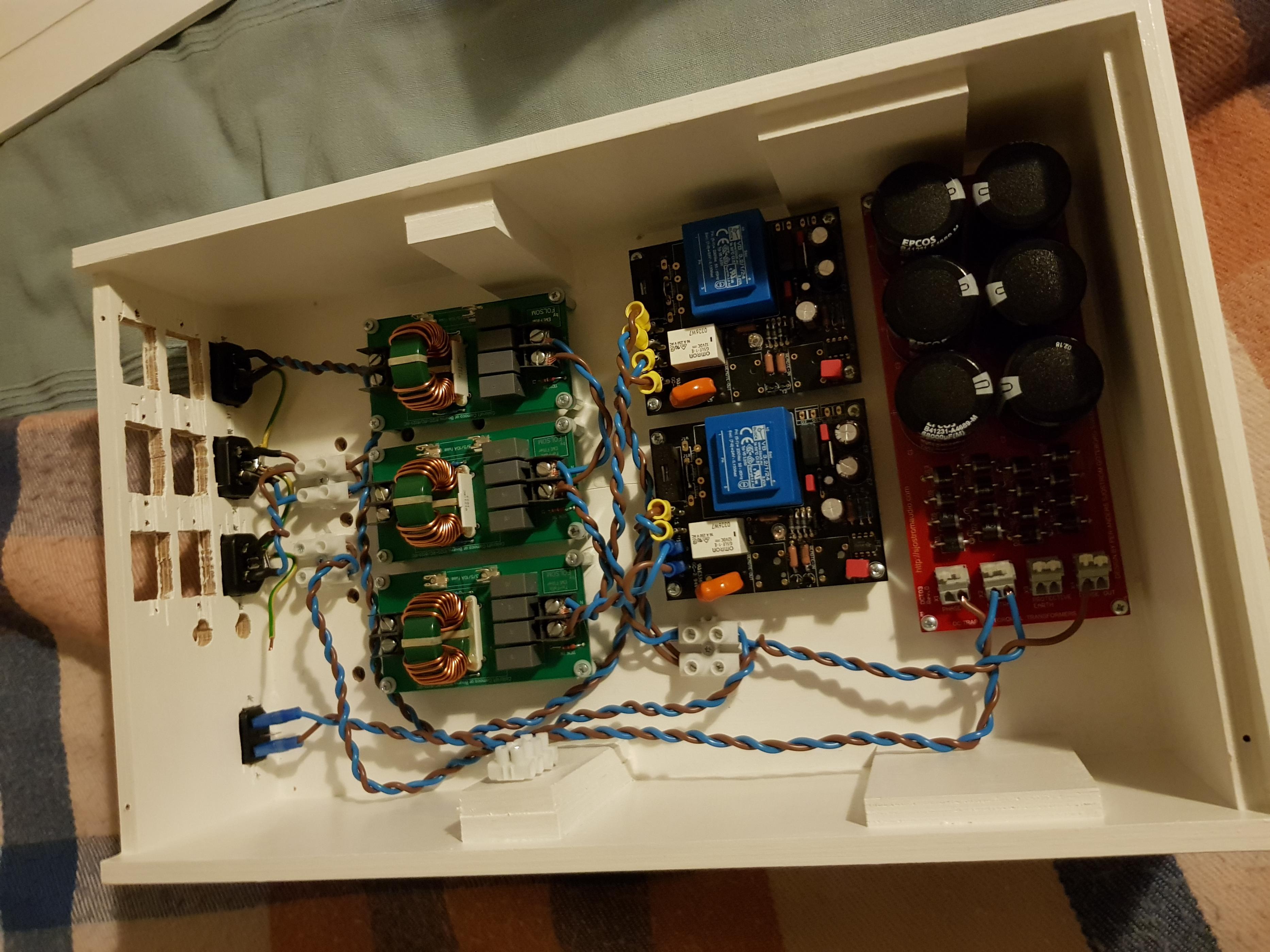

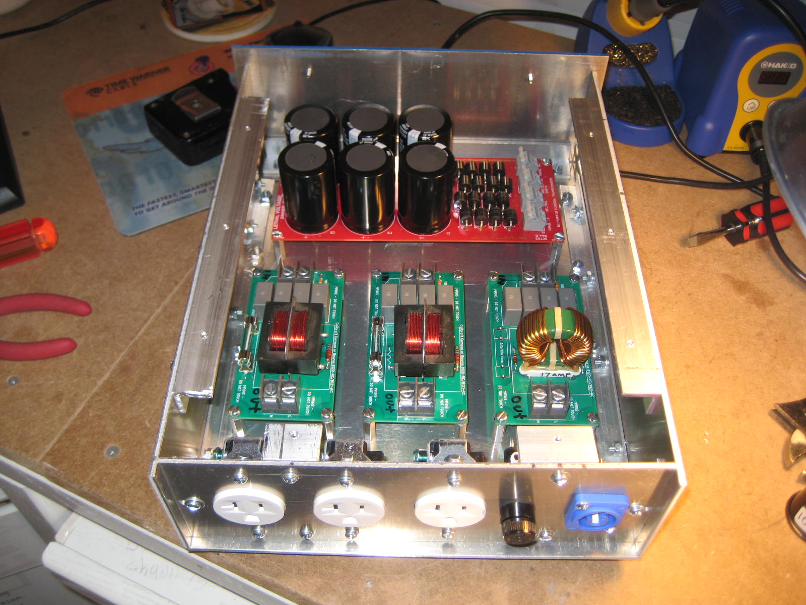

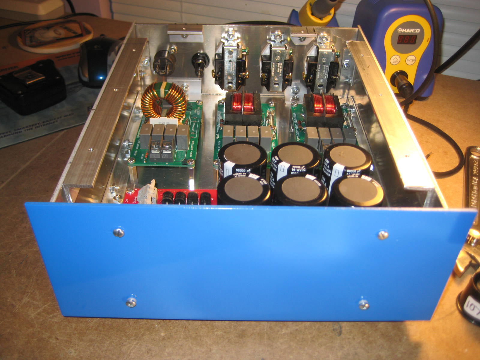

Almost finished with my first DIY build. Just need to connect everything up.
DCT03 and Fo-Felix EMI filters.
Looking good!
I did almost the same thing=)
Hi torb,
That looks great. Glad you posted a photo. Did you hook up the DCT03 to all 3 Fo-Felix boards?
I'm not sure if I should hook my DCT03 up to all 3 Fo-Felix boards or just the one that has the 17amp bourns coil that drives my power amp.
What are the other 2 boards in your build?
