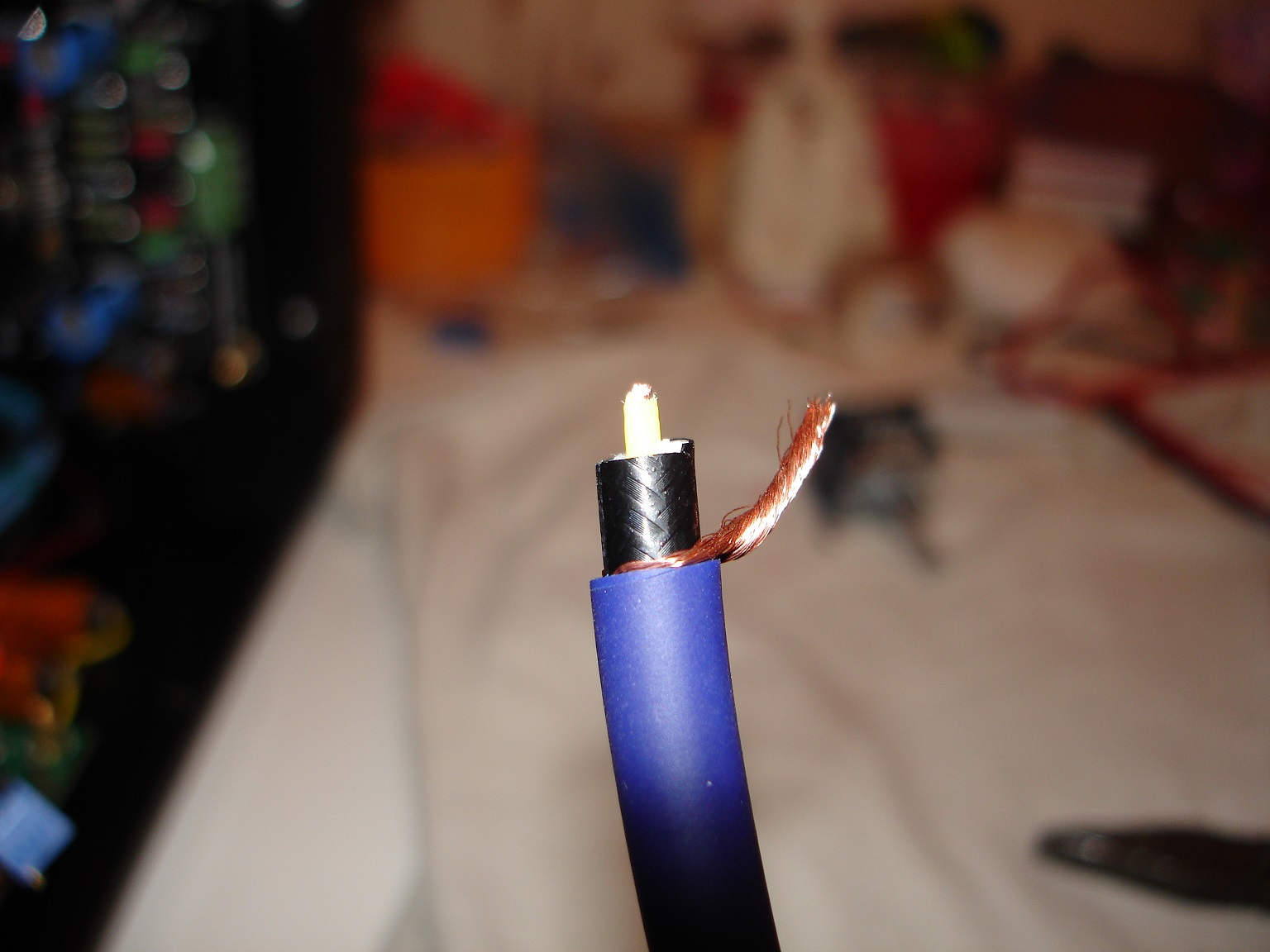

My amp has LME49830 input chips with 2 possible ground connections and independent from the rest of the amp. I'm also using the cable shield to provide ground to the LME circuit.
Though they occupy a lot of space, I chose a really good shielded wire. The wires you're using are more prone to noise pickup.
If you can, re arrange the components location inside the enclosure to a more suitable one. The transformer and rectifiers at the back, and the boards at the front near the pot.

Hey man, first of all thanks a lot - I wouldn't have had the idea of such a consequent star grounding scheme.
That cable really does look pretty awesome/expensive, what brand/kind is it? I'll see if I can get some really good stuff at my electronics store, but even if I can't, I'm pretty sure I can get it to be quiet by positioning the cables right.
About redoing the component placement: The thing is that I've already done that once (obviously that was work I did for nothing - I don't know what the hell I was thinking when I came up with the current layout, although I didn't change the position of the amps so I didn't really have much choice) and don't feel so much like doing it again if I can get it to be quiet without going there. I was thinking about just moving the capacitor bank and rectifier to the area between the large transformer and the Wire PSU, do you think that would be of any use/consequence?

The cable I'm using is Neotech's.
:::NEOTECH::: Professional Cable for Perfect Audios
