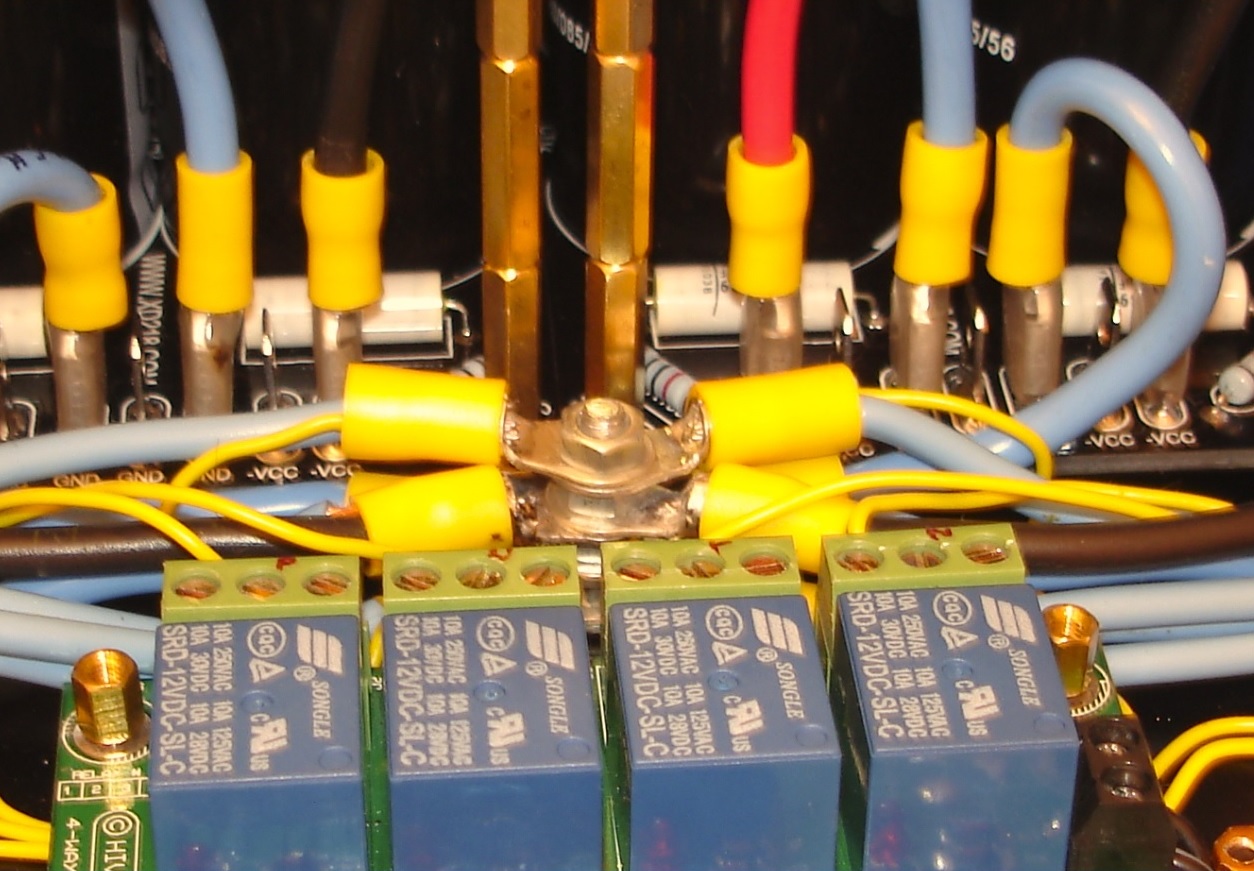

Ground connections always have to be good and firm otherwise there'd be issues.
Regarding the star, use 1 long bolt firmly attached to chassis (remove the chassis anodizing right around the bolt or it will NOT make a good contact), then use 1 nut and washer per not more than 2 ring style wire connectors.
Also, use nylon or fiber washers to isolate the pot from the chassis. Tape will probably fail under pressure upon time and make a short to chassis.
The level of white noise depends on the amplifier design and components chosen to build it. It's unrelated to the ground scheme.
Regarding the voltage regulator problem I don't think it's about static discharge. Check out the power dissipation and keep below the maximum ratings stated in its datasheet.

The grounding is already pretty much the way you described it, although I'm not using so many washers and nuts yet because it gets annoying when you have to redo the connections - when (if) I ever solve the buzz problem or just decide that it's at a tolerable level (I'm guessing that's the only choice I've got at this point) I'll do it properly though.
Also, I've noticed that separating preamp and P101 grounds helps a tiny bit with the buzzing, but nothing major. It's already pretty quiet now so I might just leave it at this.

Do not use a wire to interconnect 2 ground points in the board. As I stated way above run 2 separate wires to the star.
Also, even though is extra work re arrange the star connections in the way described. This is like what was first, the chicken or the egg; proper star ground connections will keep noises to the lowest level. Just 1 bad ground connection and all the effort would be futile.
