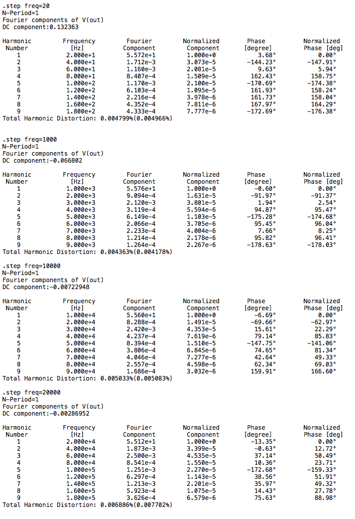

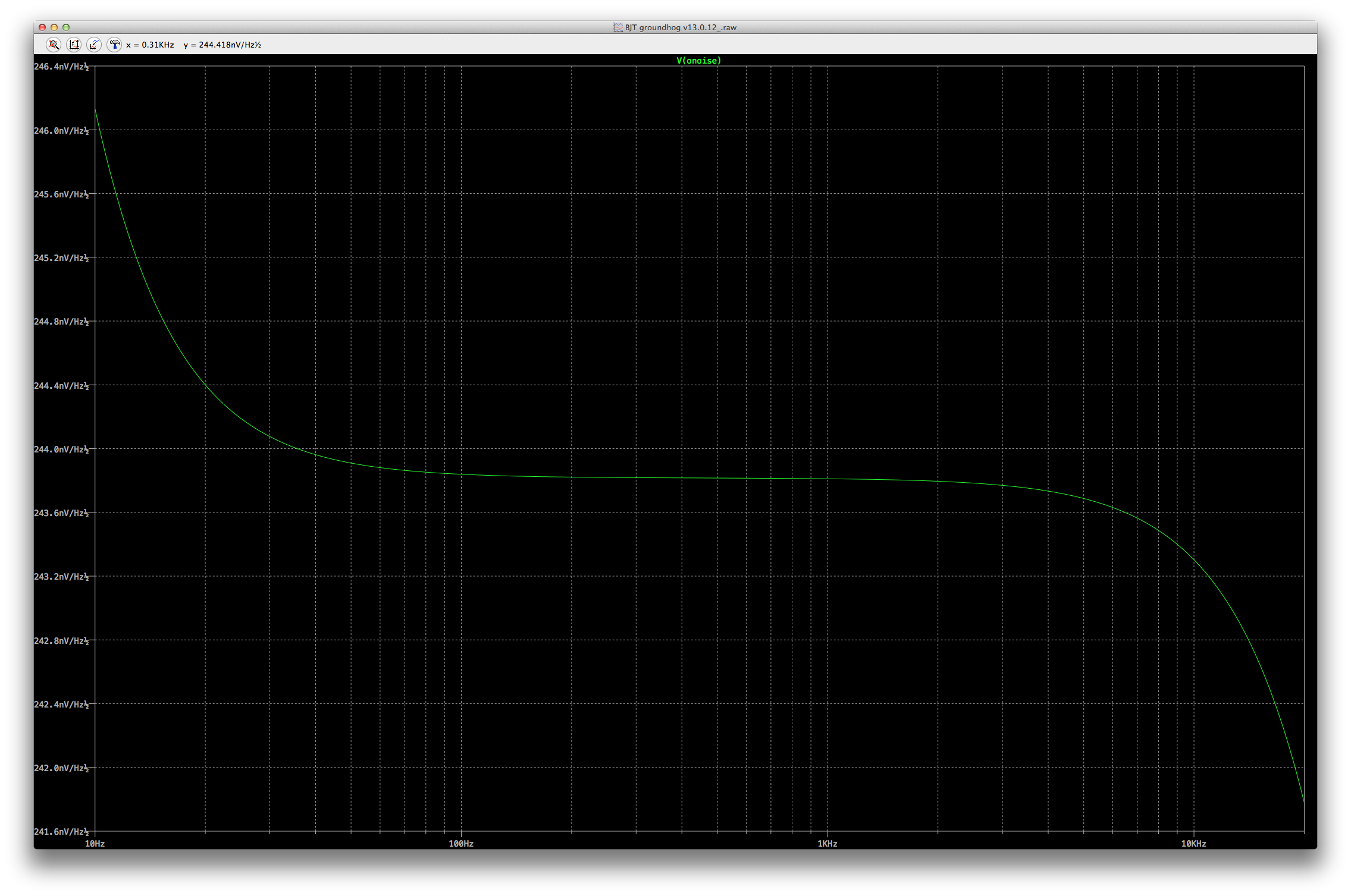

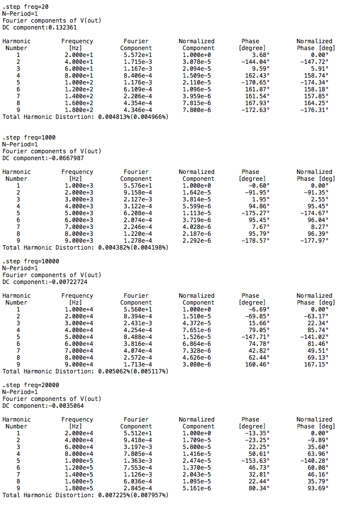

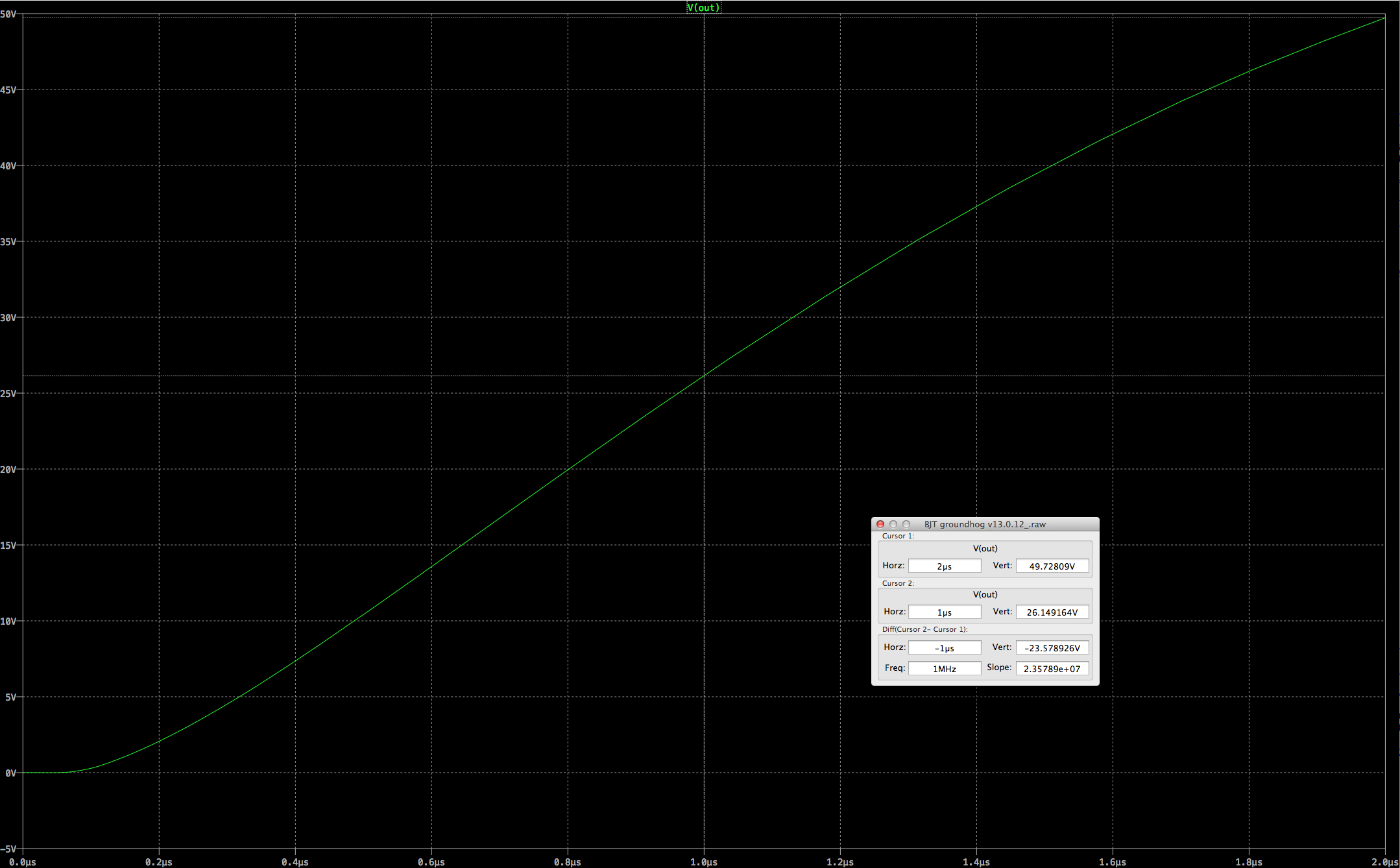

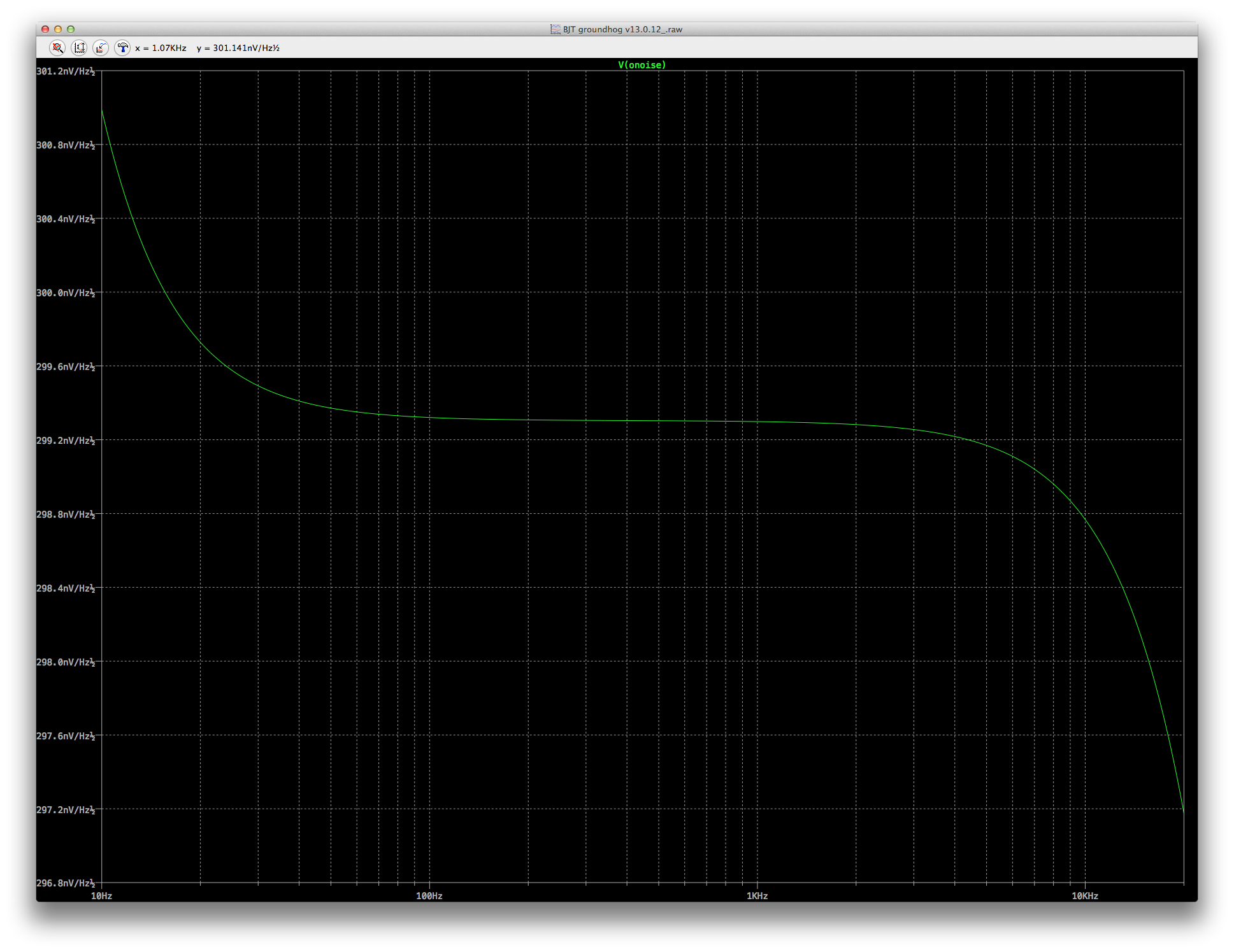

Regarding CM noise, increasing the emitter resistors reduces it. I picked 100 ohm, but higher values give lower noise. Side effect, the DC level to the VAS increases, so we'd have to watch that. Try 470 ohm? Just a thought.
There is one drawback to increasing those res too much, it's a slew rate killer.
How much can we expect to gain anyway?
Changing those requires changing something at the vas as well, as it changes the operating point.
I can try it out and we'll see.

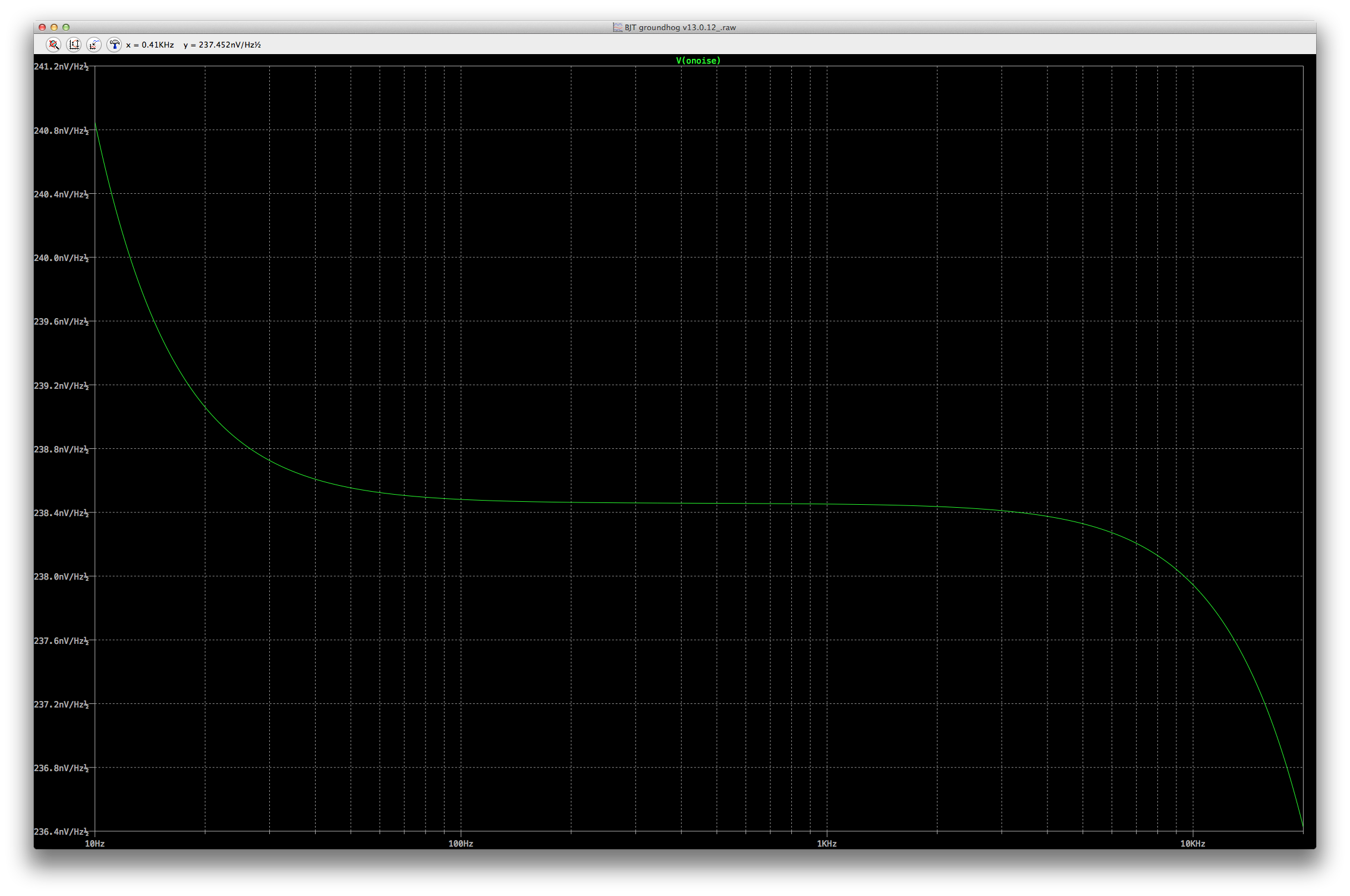

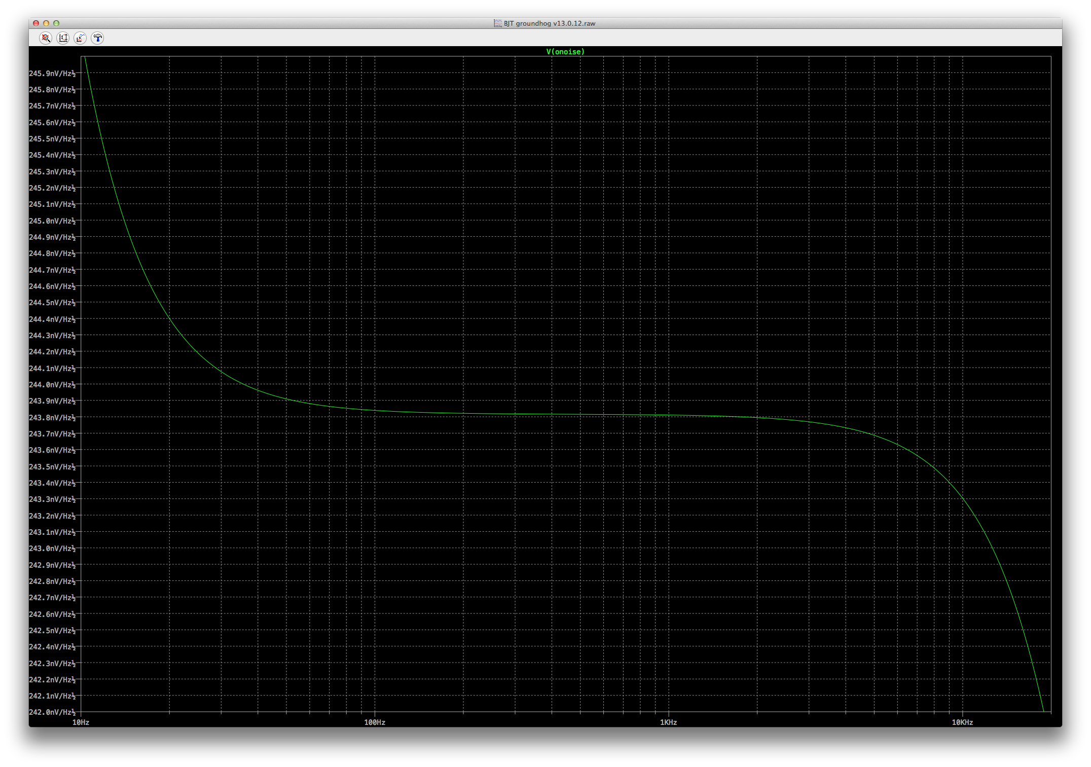

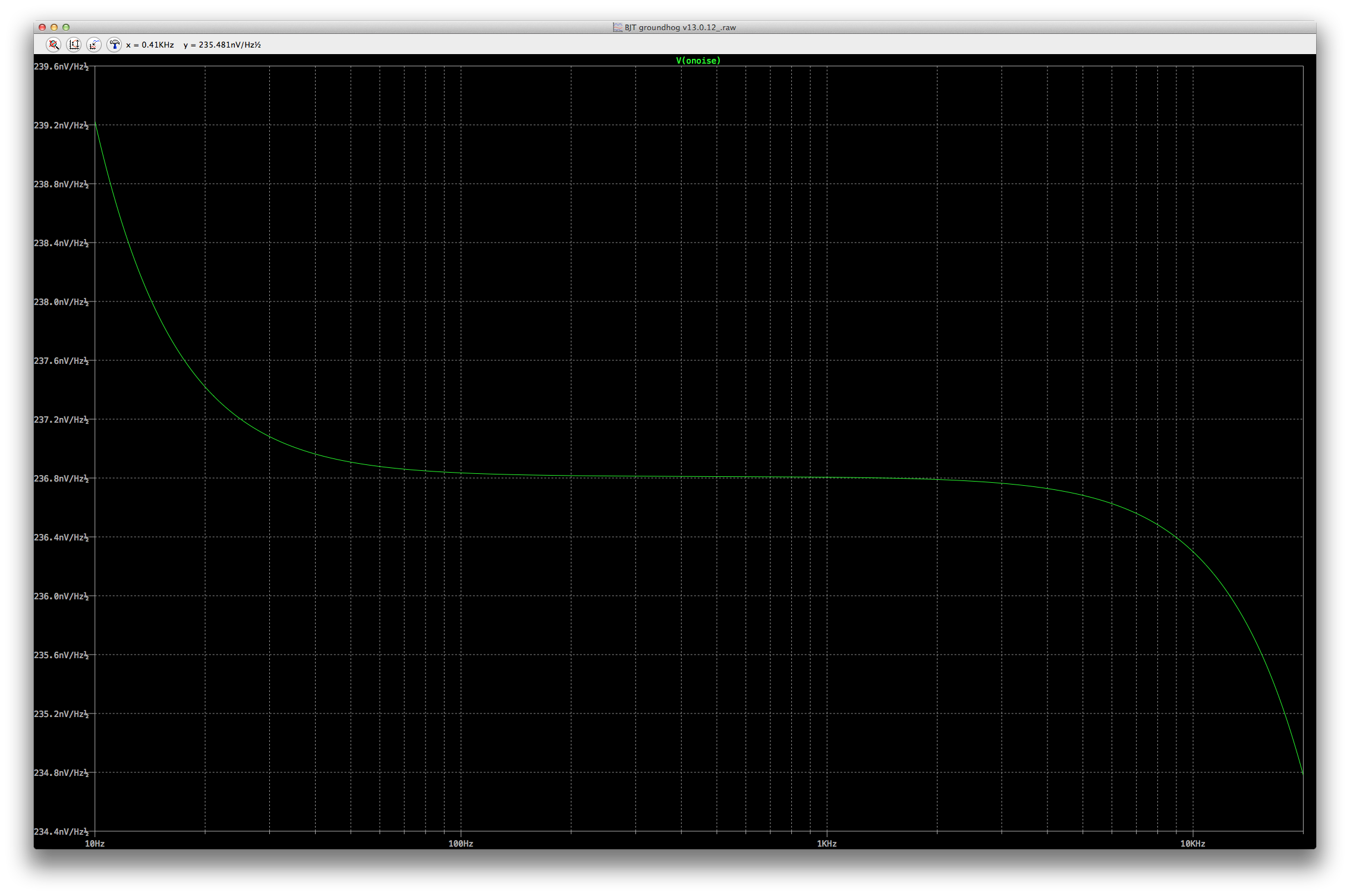

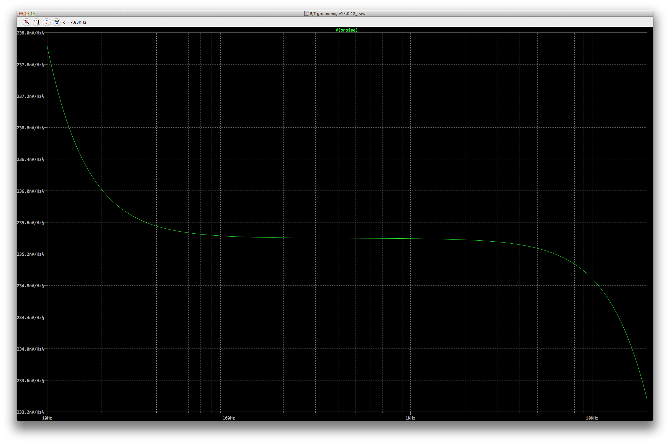

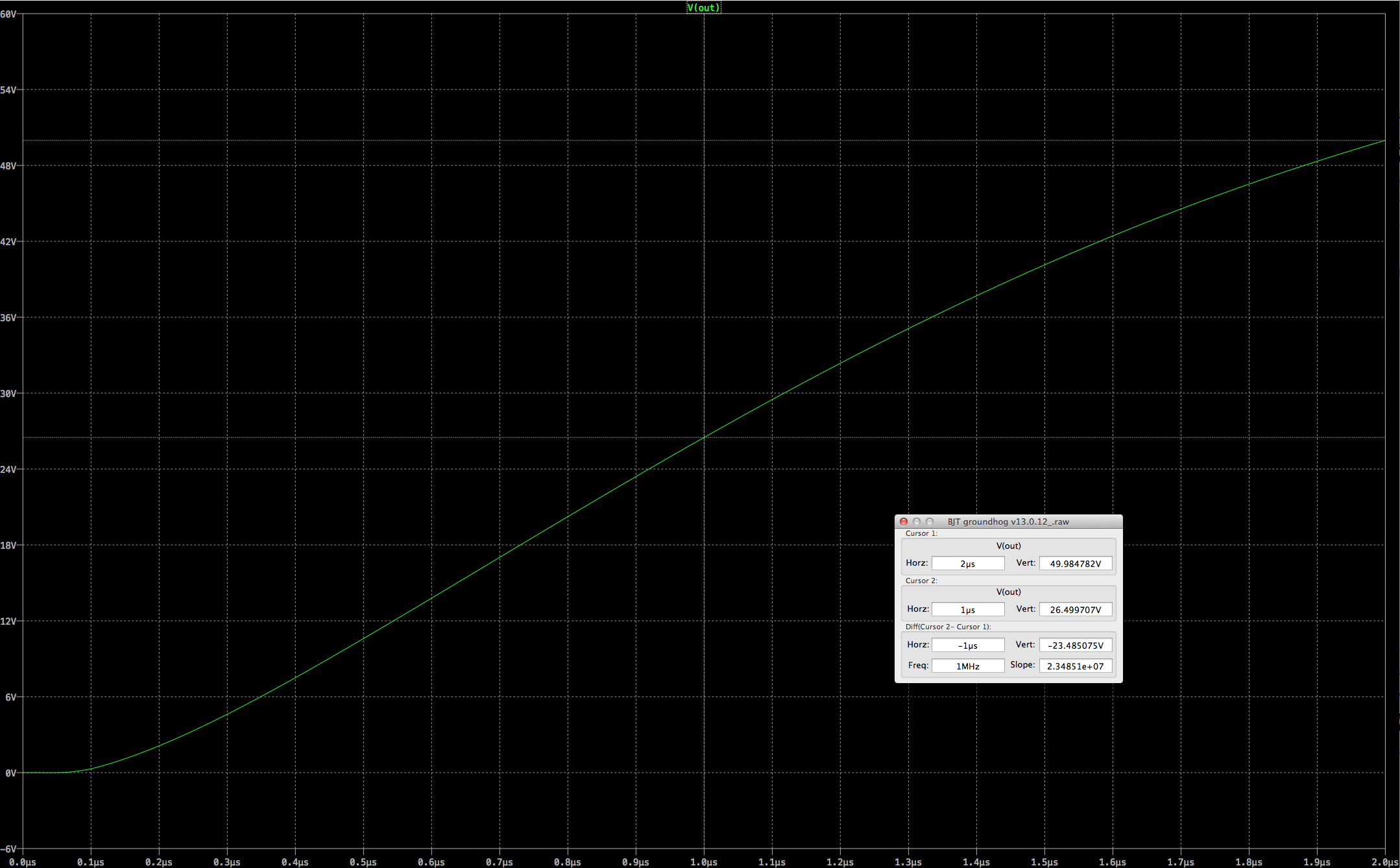

How about that?
Going up to 470 instead of 100 for the mirror degen res, didn't force changing other values, and we do have a bit higher bias current in the vas, and the rail centering offset is a little higher, nothing much, but it is.
And the surprising thing is, instead of reducing noise, it goes up.
There must be some point where we have diminishing return.

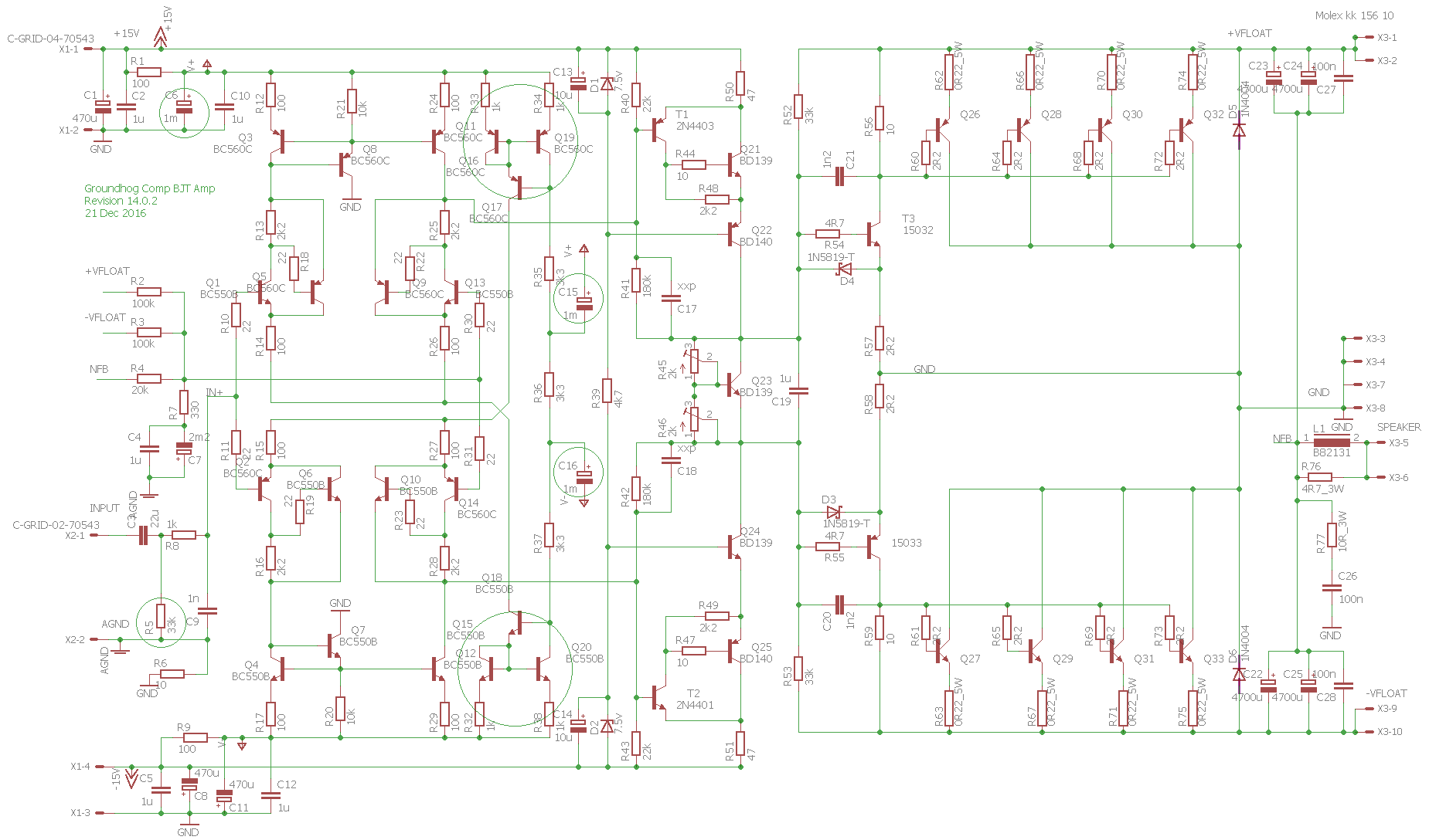

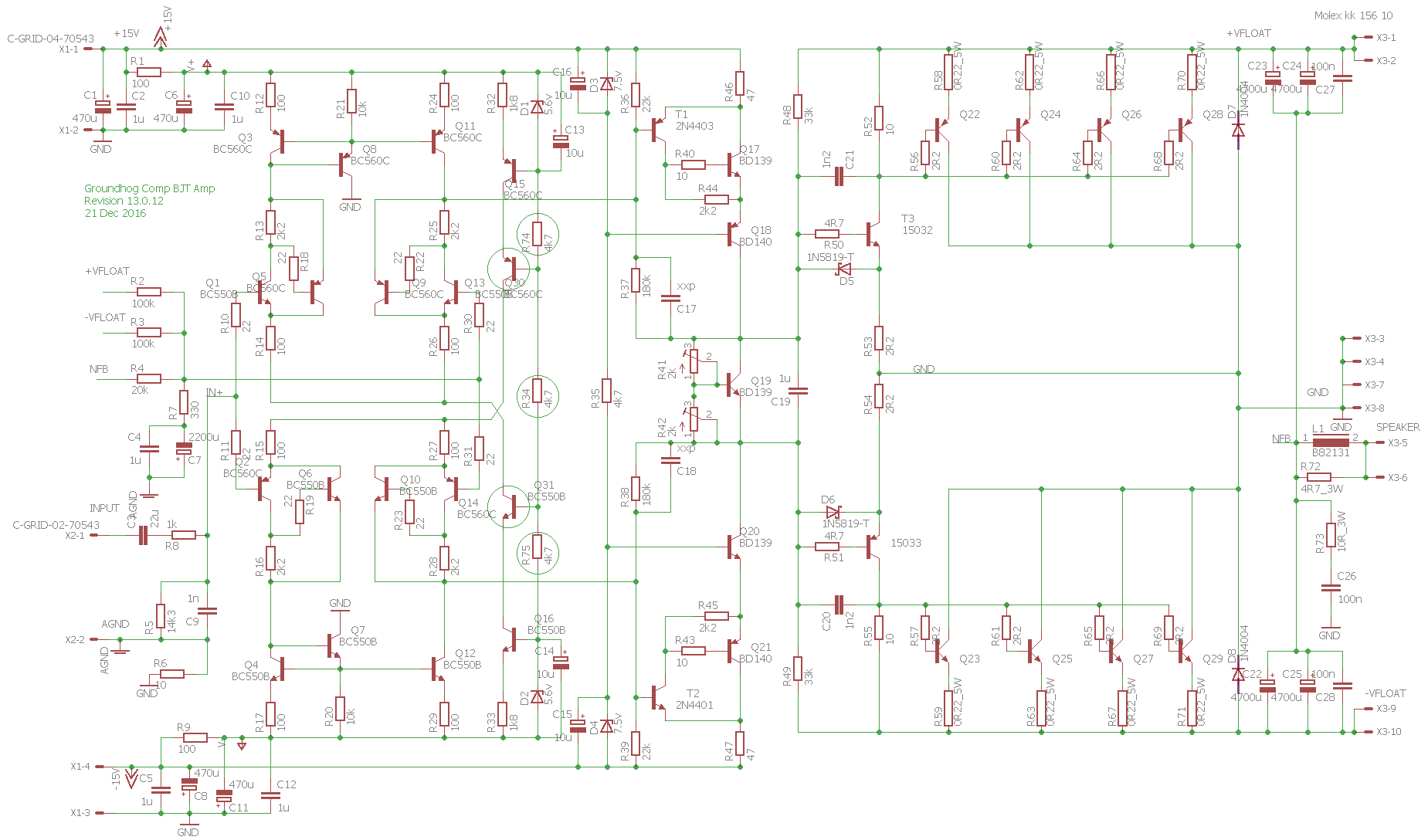

Looking at the exact match of tail current, This CS works rather well. I'm wondering if much of the difference is due to slightly increased tail current, up from 2.7 to 3.15, or of taking out the cascode.
I'll try to equalize. I can reduce the tail current so we have can compare a more similar design. It's a matter of changing the 1.5k resistor to something higher, say 1.8k, and adding back the cascode.

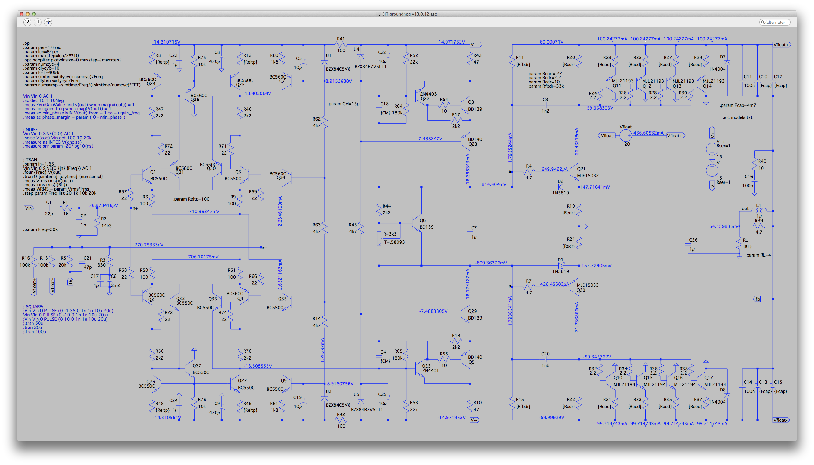

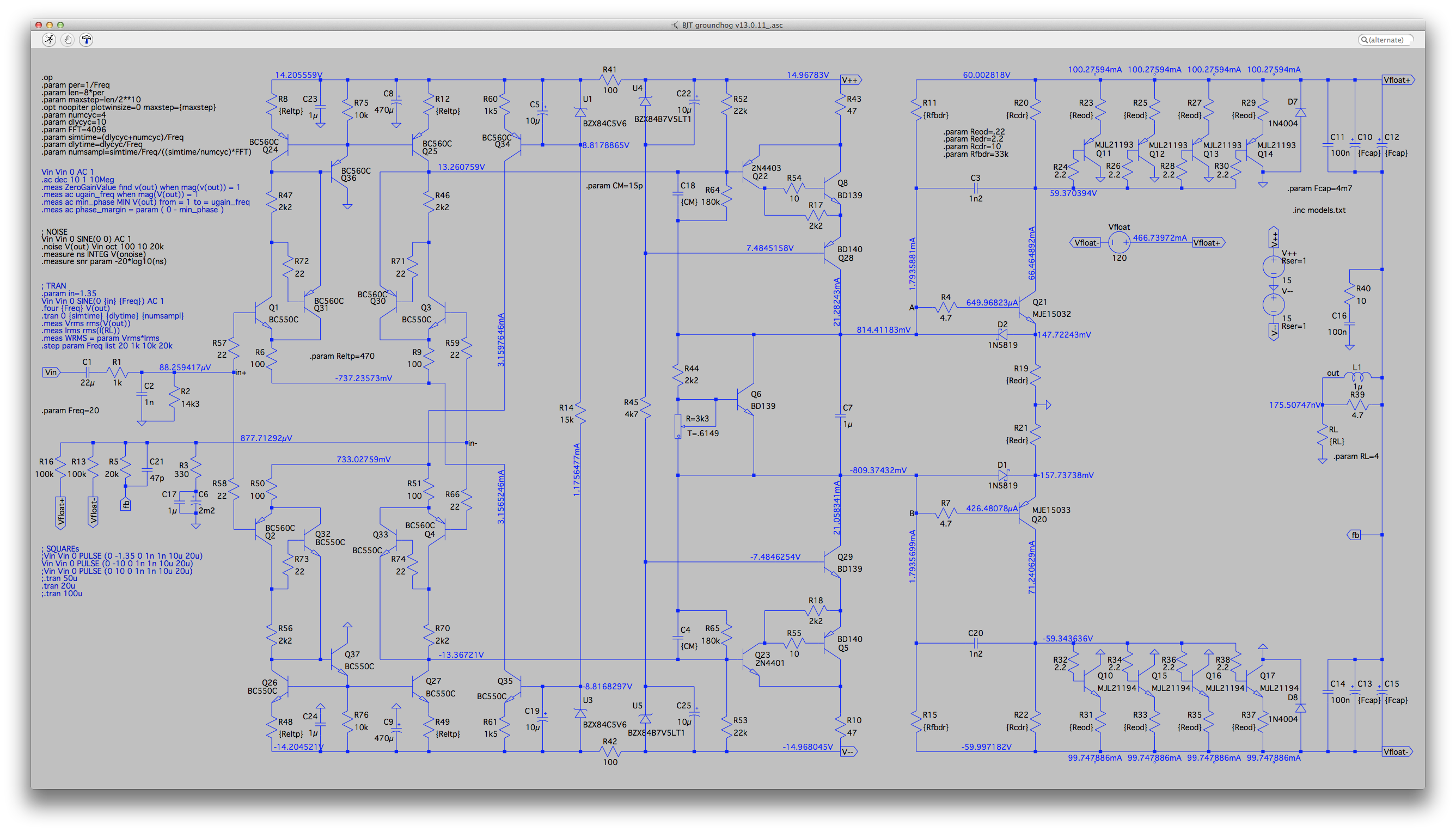

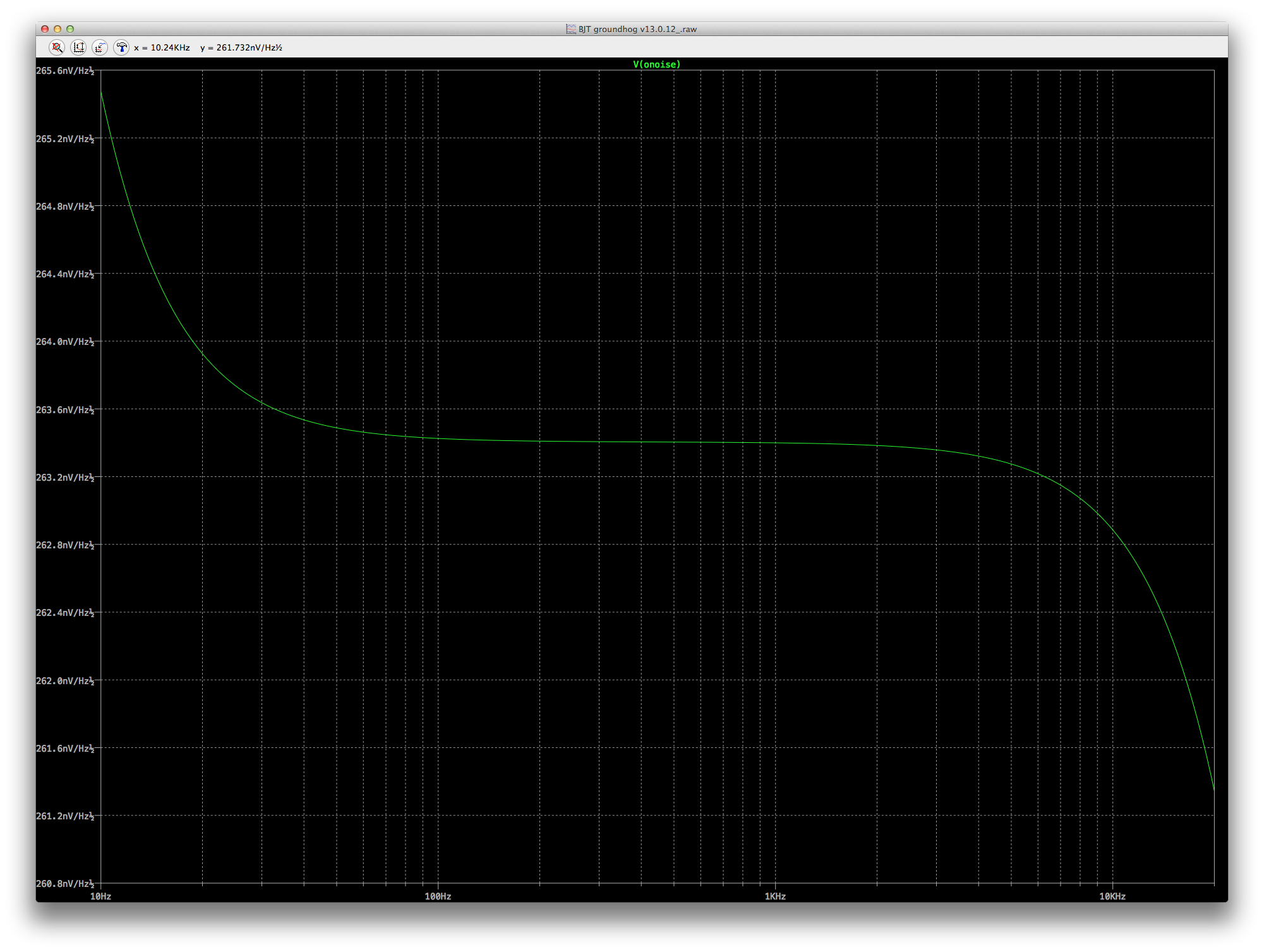

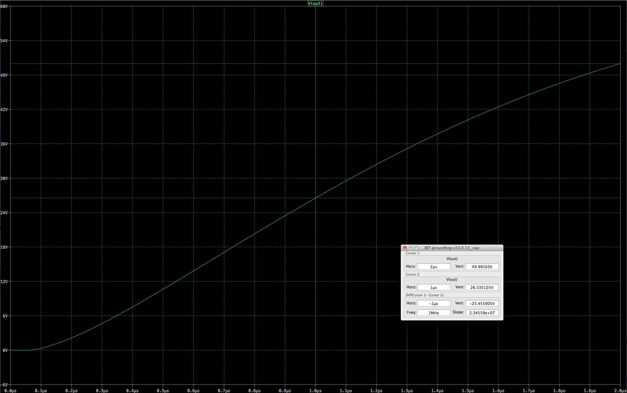

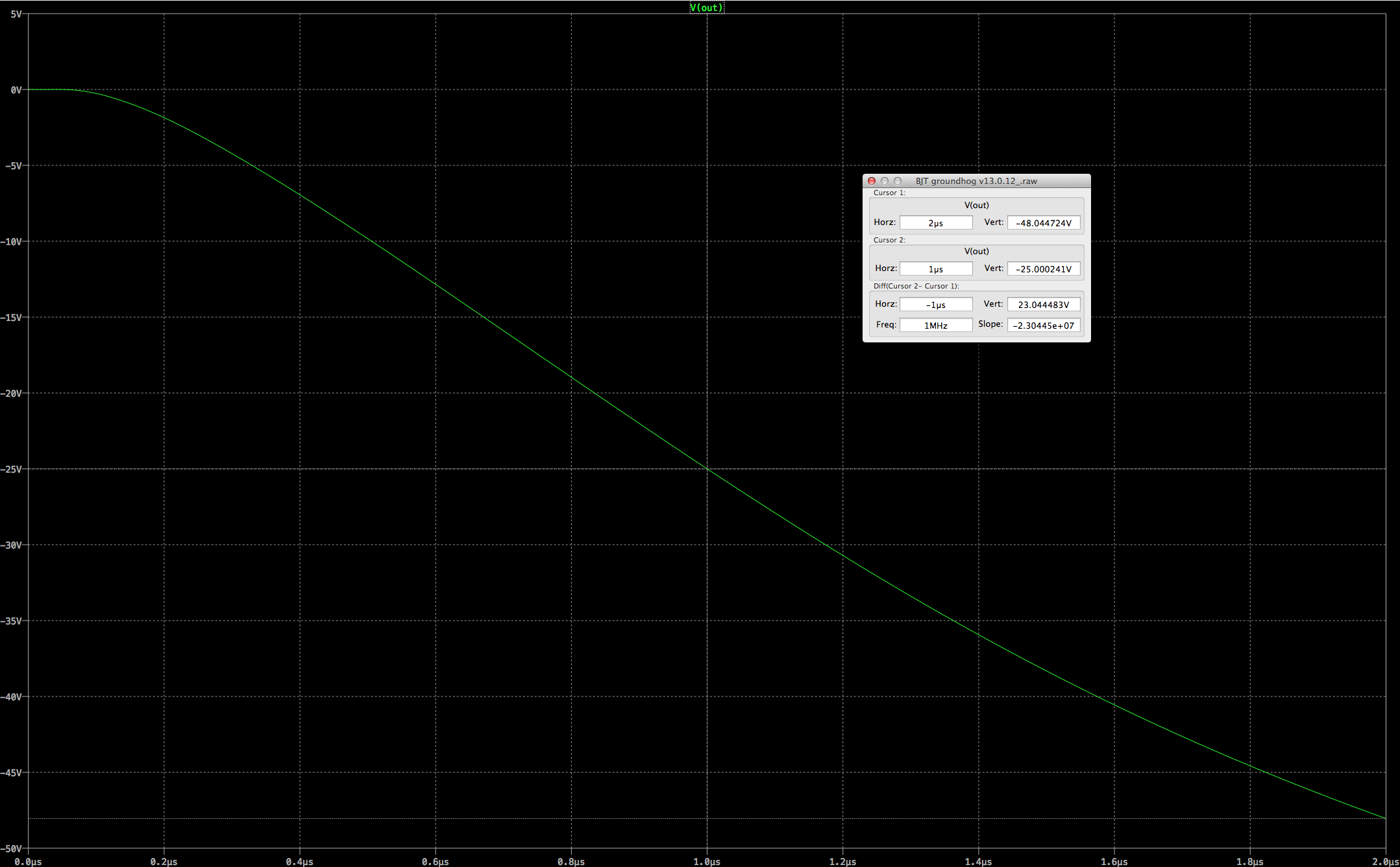

This is similar to our .8 recent version, but with a slight improvement in noise, and although thd is roughly the same as well, it has slightly improved at the high end.
The high end improvement is very significant. I think it's due to the cascoded current source.

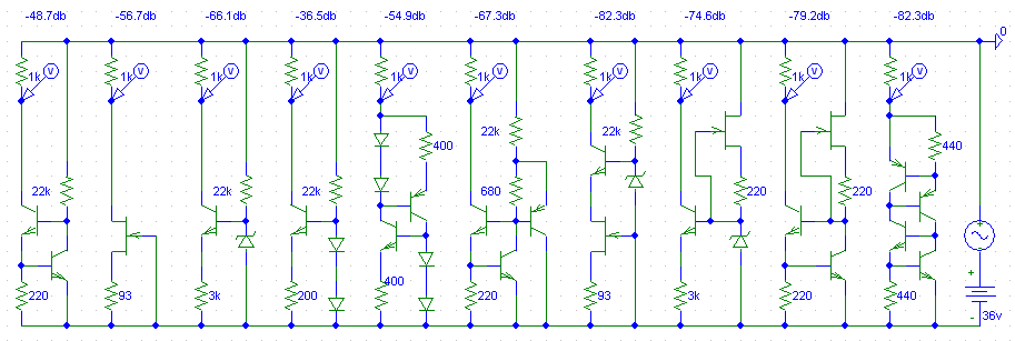

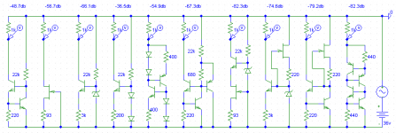

By the way, I chose that current source based on an earlier discussion here on DiyAudio. It's not the best for ripple rejection, but almost, and low parts count.
http://www.diyaudio.com/forums/solid-state/86626-searching-best-ccs.html
Below is the summary graphic.

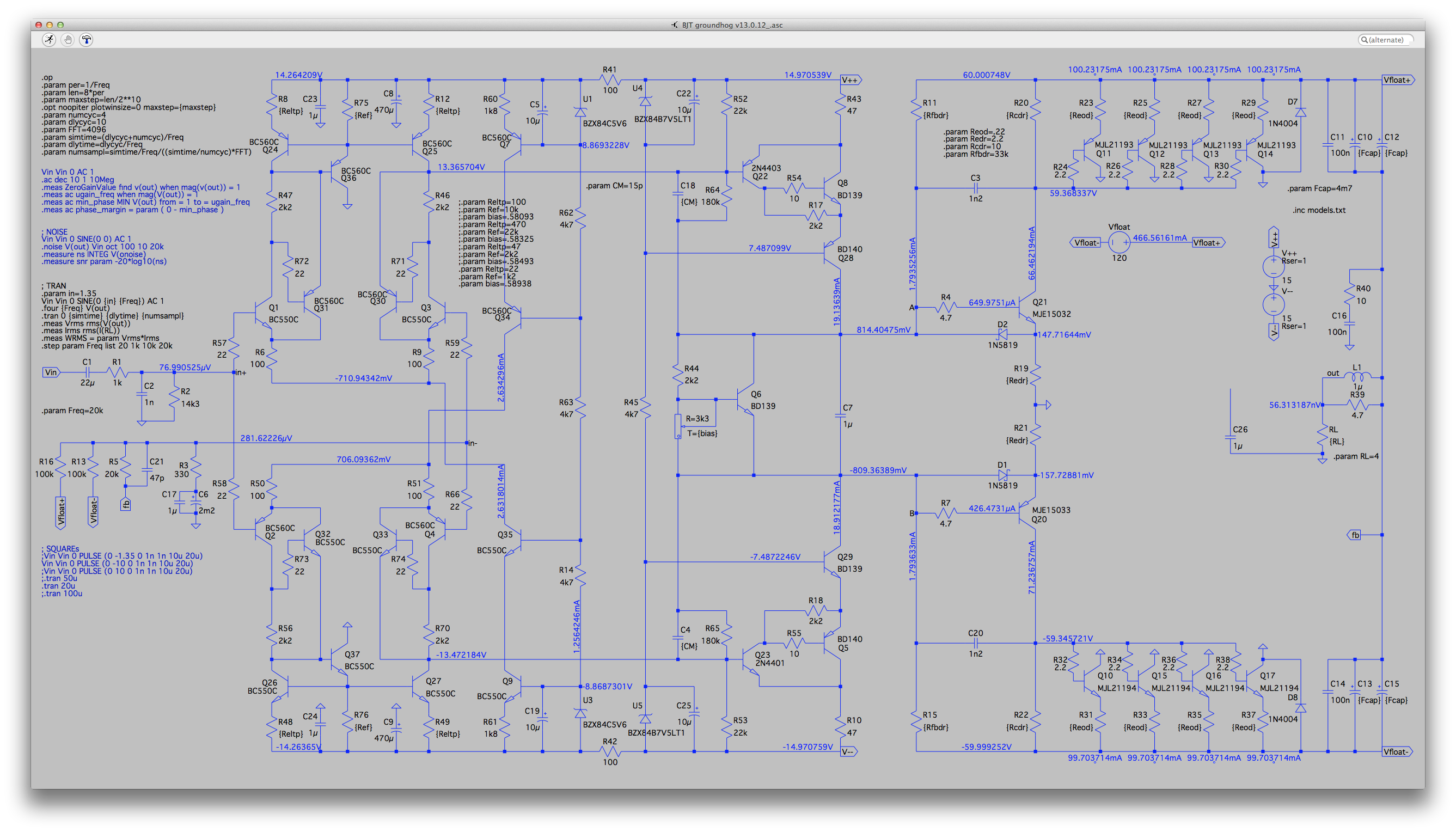

I reviewed the performance of our latest version, with zener CS, against an earlier version using mirror current sources. Actually, the mirror was better. So I refined it a bit to have a more constant current. This is an unconventional use of the mirror, but I'm keeping an open mind depending on performance.

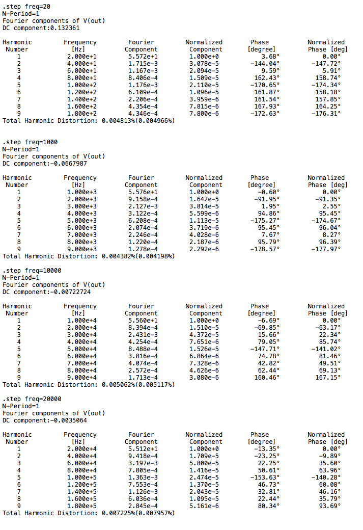

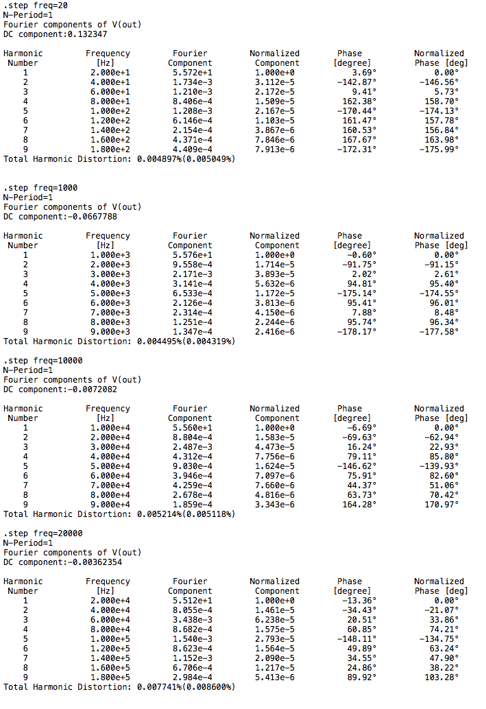

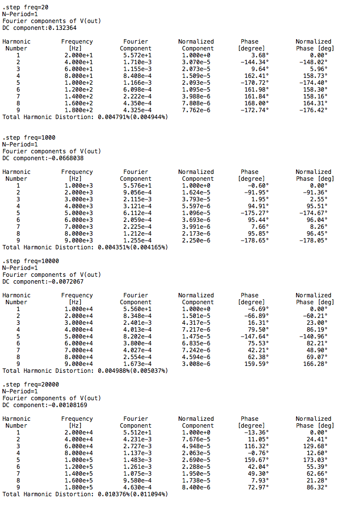

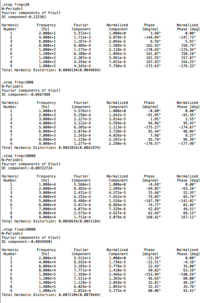

Ok, so to make things easier and have datasets with meaningful info for proper comparison, I'm putting values into variables to easily switch from one to the next and I will put out for each set of values the same info, thd, noise and slew rate.
Quite a bit of info, so I'm keeping it to what's most useful and I'll post each set separately.

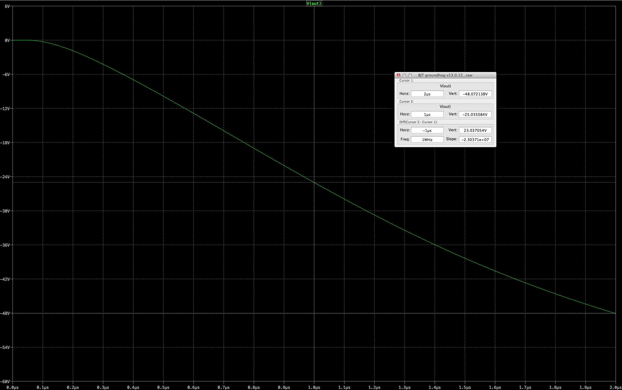

Starting with the mirror degen res at 22, and the EF emitter res 1k2 for that config.
With 22ohms, I tought the slew rate would be a little higher, but it's roughly the same. I take this as we have quite sufficient oomph in the ltp to drive the miller caps.
Noise goes up as expected, and thd is a little higher.
Using the recent results with 100ohms as being the reference.
I will re-post the data for 100ohms as well later on with the same info for best comparison.
So far, having seen 100, 470 (with the wrong EF res value) and now 22, I suspect we might be able to go a little above 100 to improve noise a little, if we don't go too far above that, so we stop before getting the diminishing return.
Seems like 100 might not be the optimal compromise, and perhaps we can edge towards 470 but without going too far.

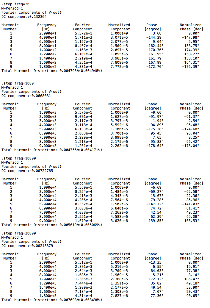

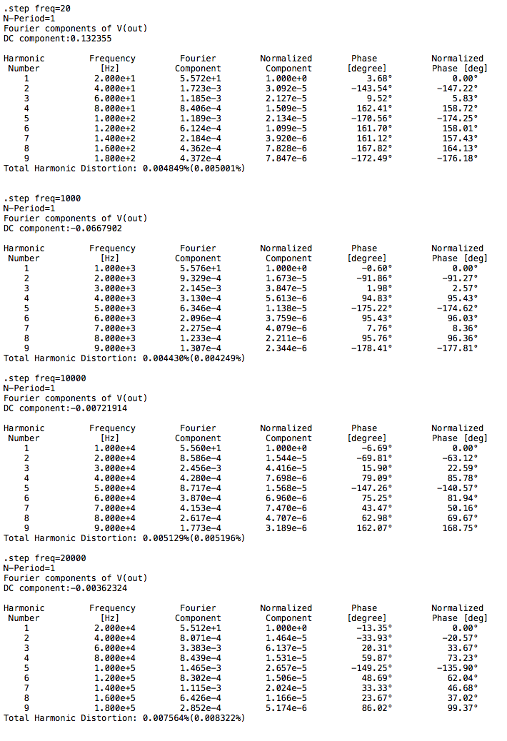

From 22 to 47, I can't say I see much difference.

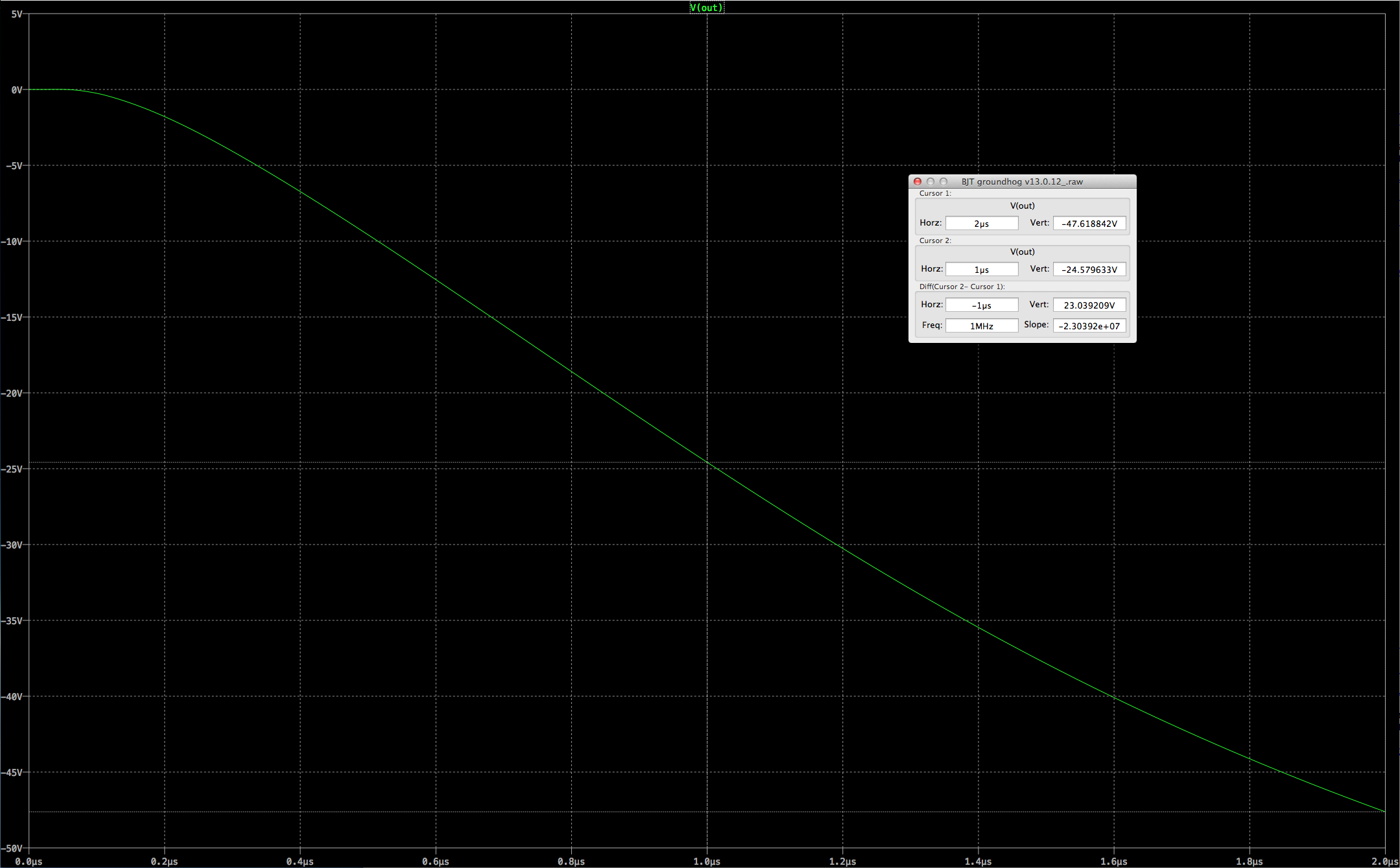

This serves as our reference for comparison. (100 & 10k. I left the 10k as we had before)
The slew rate hasn't been affected that much.
We should explore more values between 100 and 470. We may find a more optimal value that way. If slew rate remains roughly the same, we get lower noise and thd doesn't rise, we're in business.

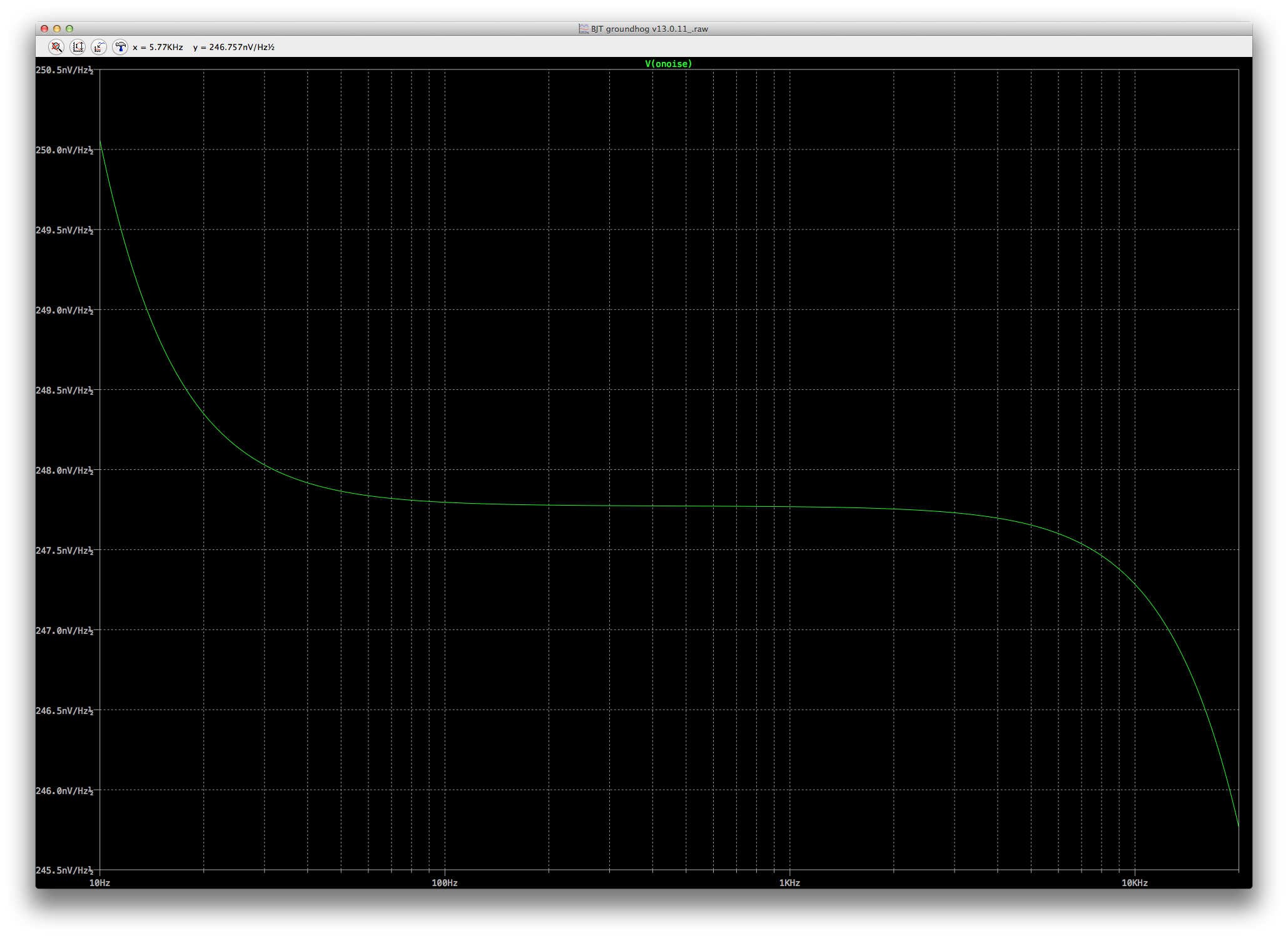

Here we're at 180 & 10k.
I was hoping to be able to continue gaining a little more with higher values, but it seems now although the noise gets a bit better, thd at hf starts getting worse.

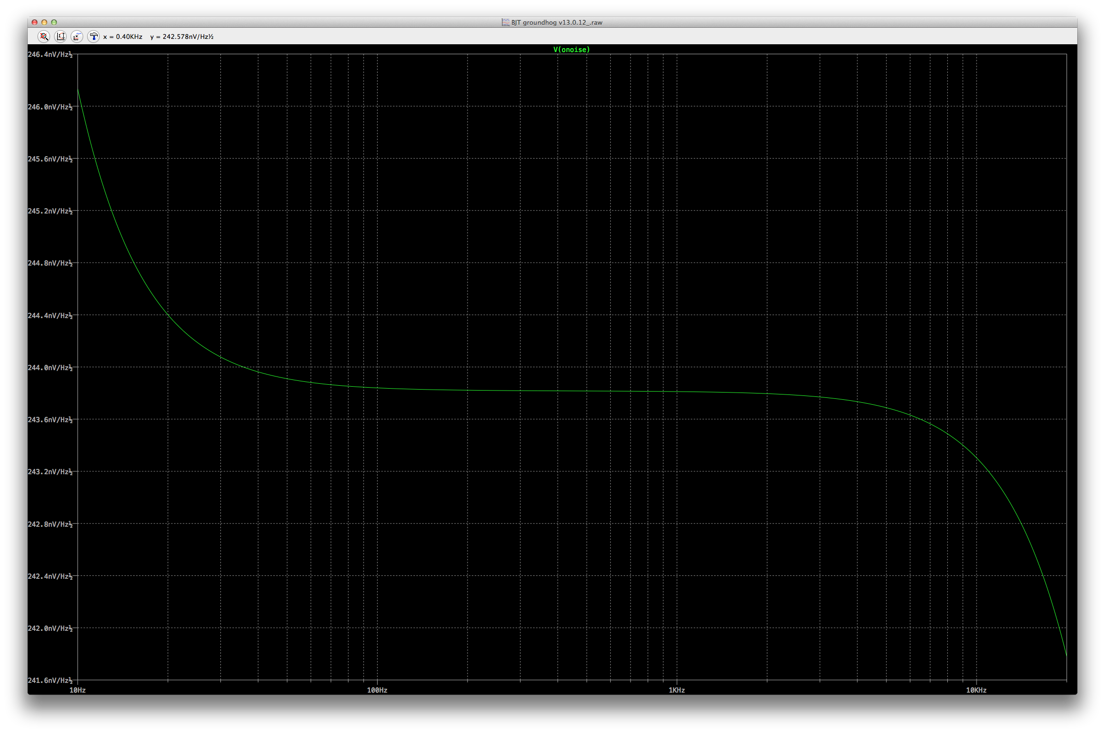

Here with 220 & 12k, the trend continues.
No need to bother looking at the slew rate, as it remains largely unaffected.
The noise continues dropping, and thd drops a little as well but not at hf, as it's rising instead.
So I consider this rather a diminishing return, if we gain a little with lower noise, lower thd at the lower frequencies is nice but at the highest end it's the opposite, so I don't see a good reason to try any higher values.
Unless we have something else along with it to try that would counteract on the hf thd rise...
The gain in lower noise is slim, and not really worth it, especially at the expense of hf thd rising.

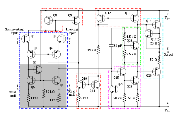

For what it's worth, the venerable 741 op amp used 1k. It also used mirror current source for the LTP, I just noticed. Not such a new idea...
Very cool, we're not reinventing the wheel. Why not go with what works and is proven?
Makes me think there could be such ideas to draw from newer opamps...

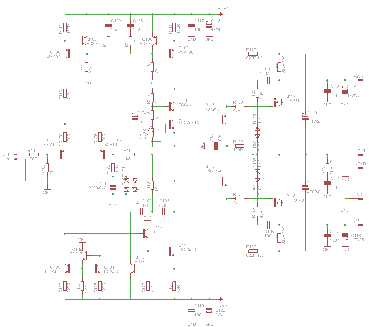

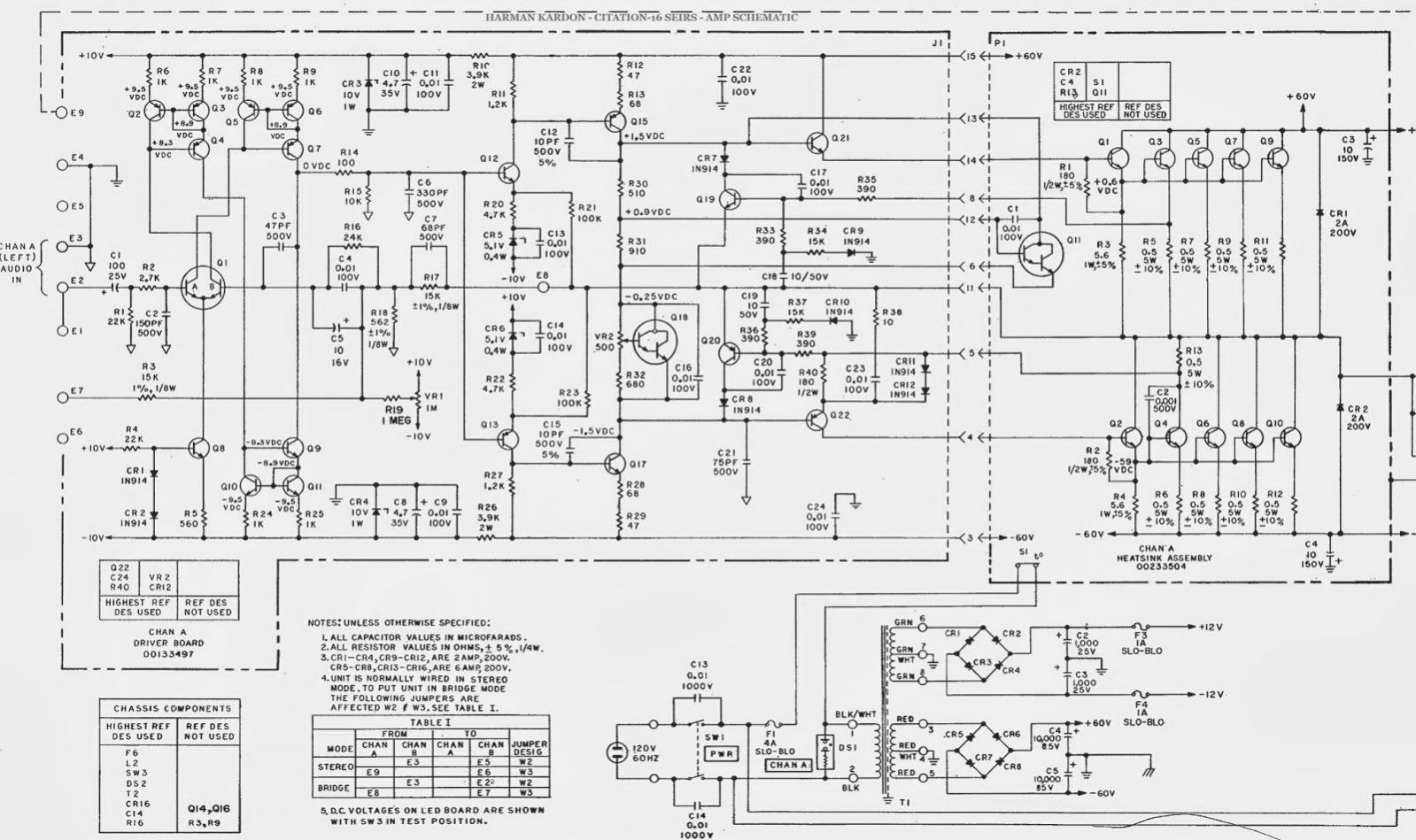

There is another design here with similar mirror. He's using 220/2k (10x). My impression is he did not do a lot of simulation, due to limited expertise with sim, but he proto'd it. Could be wrong. But the 10x ratio is interesting, and the 220.

I think a plot is best too. Use your judgement. I generally look at the frequency and composite THD mostly, since I'm not sure what the harmonics mean. The gurus seem to know that for example a particular stage kicks out only odd harmonics or only even, by experience or analysis, which would be good to know.
I'm curious if the latest version with the mirror CS has value. I admit I am skeptical, but very curious. It's an odd use for mirrors, no? But as I just realized they are workhorses in Op Amps. That 741 used 3 types of mirror, the EF, basic, and Widlar. Just for laughs here is a classic audio amp (HK Citation 16) that uses 3 Wilson mirrors cleverly in the front end; I think the designer was an IC designer first.
You'll know very shortly. Working on it right now.
Whatever works. And in opamps they tend to use things we don't or rarely use.
