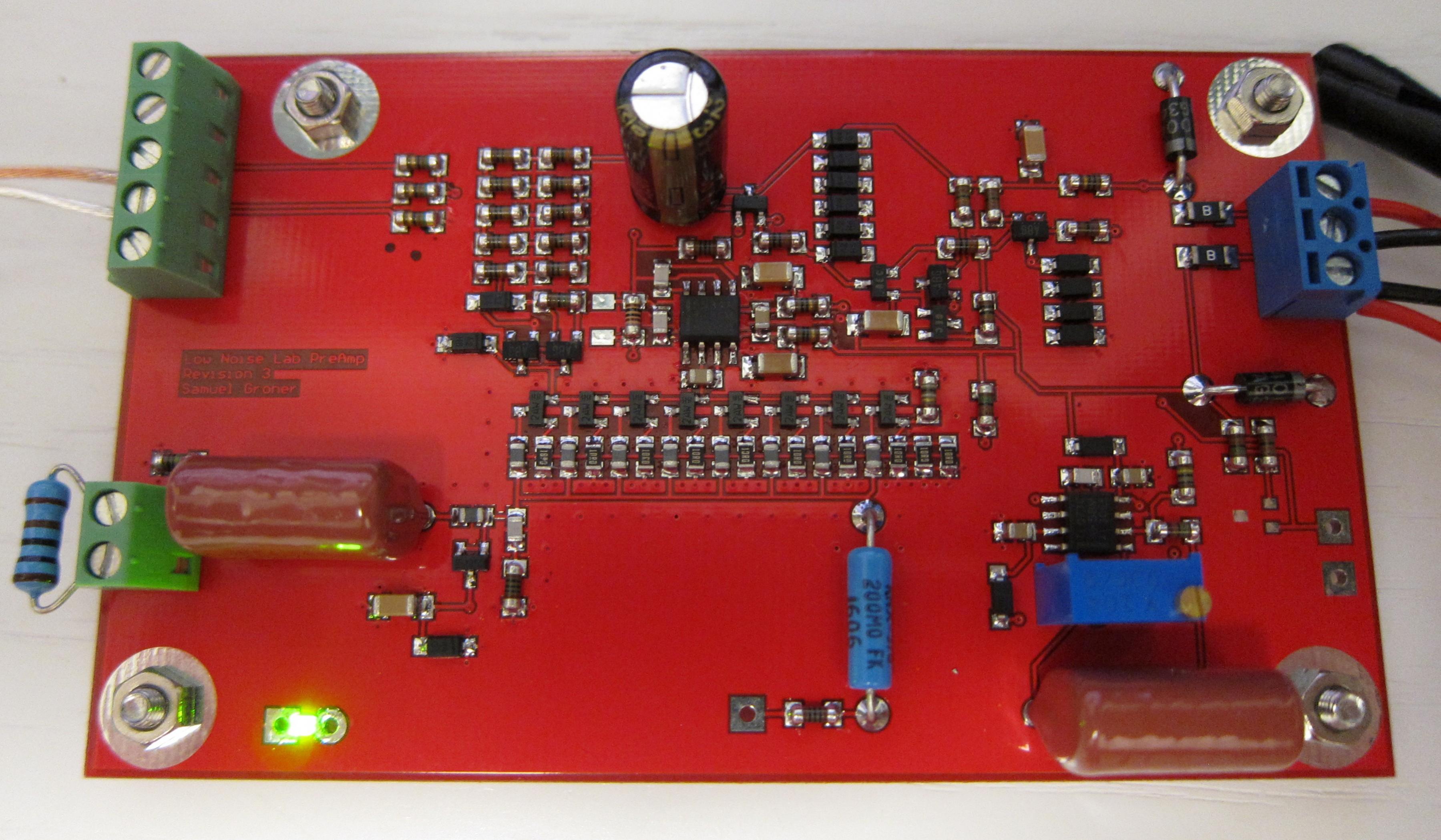

Another build

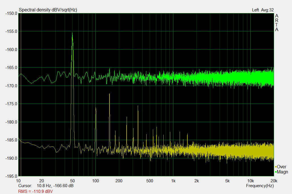

There was some discussion as to whether the performance specified in the Linear Audio article was realistic. I'm curious to know also, so I guess the best way is to build one and see for myself.
Attached an ARTA measurement of the noise level, the green one was noise measurement of a 1k resistor, the yellow one was for an shorted input. I've yet to find a metal chassis for it so there is some 50Hz pickup (despite I already tried to cover it with a metal lid).
Ignoring the 50Hz hum and it's harmonics, I think the result are pretty close to what's indicated on Fig.14 of the article

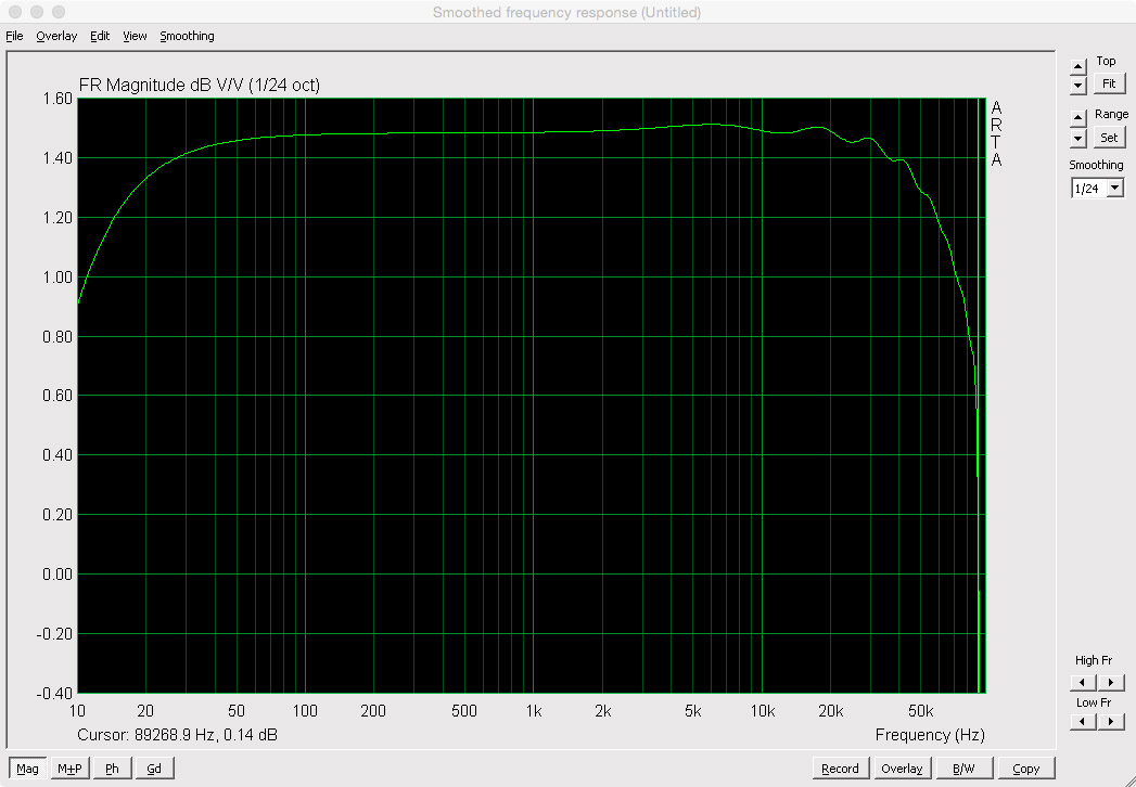

I wanted to check the preamp gain. I purchased some 0.1% tolerance resistors, 200k Ohms and 20 Ohms, and constructed a simple 80db attenuator. My signal generator has a stated amplitude accuracy of +-2% of set value +- 2mV (1kHz sine wave). I calculated that with an input stimulus from the signal generator of 1dBV (3.174Vpp) this should give me an accuracy of +-2.3% or so. I could lower the accuracy range by increasing the level and thereby reducing the impact of the fixed +-2mV but this is good enough for me. Of course my sound card's frequency response is also a variable but likely rounding error for most frequencies (attached).
I took 28 measurement readings in ARTA with stimulus frequencies of 50Hz, 100, 200, 300, 400, 500, 600, 700, 800, 900, 1k, 2k, 3k, 4k, 5k, 6k, 7k, 8k, 9k, 10k, 20k, 30k, 40k, 50k, 60k, 70k, 80k, 90kHz. I set ARTA's spectrum analyser to display dBV/SQRT(HZ) with the FFT settings of Fs=192kHz, FFT=131072, Window=uniform (which gave the narrowest peak).
The lowest result was -84.41dBV @ 8kHz while the highest was -80.76 @ 400Hz. The average was -82.00 dBV.
I conclude from this that the gain of my preamp is closer to 58dB and not 60dB, a voltage ratio of 794 rather than 1,000.

Can you repeat that with a 60 Ohm resistor (2*120 par)? = 1nV/rtHz
It irritates me that there is absolutely no 1/f noise visible. The shorted trace
should rise below 500 to 1500 Hz and the 1K trace should rise below
the frequency where it is hit by the "shorted" trace.
These here are 16 BF862 @ 44mA total:
< https://www.flickr.com/photos/137684711@N07/29965414644/in/album-72157662535945536/ >
The shorted trace is 10 dB below 1 nV or +/- 330 pV/rtHz
There is an artificial high pass at 30 Hz.
The 1/f corner is a property of the transistor, there is not much one can do
against it.
regards, Gerhard
This preamp is using negative feedback, and the gain is governed by the resistor ratios of R105 and parallel combination of R107-R117.
With 0.1% resistors, if your gain is off by 20%, I would wonder if 2 of your 10R resistors are problematic.
I'll do that in the coming weekend (it's 2:00am in where I live now)Can you repeat that with a 60 Ohm resistor (2*120 par)? = 1nV/rtHz
You'll have to ask Samuel on how he overcomes this, it's beyond my level to answer, but the exceptional 1/f corner frequency of less than 10Hz is highlighted in section 11 of his article.The 1/f corner is a property of the transistor, there is not much one can do against it.

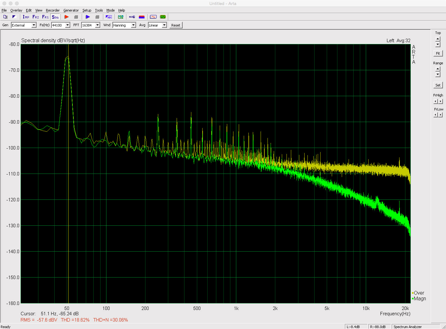

I have also encountered another oddity while using the preamp as discussed in the split thread "measuring PSRR". I've been using it to try to evaluate the PSRR of a regulator circuit I've been working on and in so doing have also tested the PSRR of an LM317. Where one would expect to see a 20dB per decade reduction in PSRR from about 10kHz onwards, the measurements do not show this. Furthermore, at one stage I coupled the preamp to the output of an amp build I have been working on which had its input shorted with 100R. Curiously, the noise measurement spectrum showed a 20dB / decade rolloff from circa 10kHz onwards whereas when I took exactly the same measurement without the preamp (just using a direct coupling of the amp output to my sound card) there was no such rolloff in noise. (Ignore for the moment the overall bad noise and focus on the relative profiles of the noise spectrum.)
The two completely different situations lead to the same suggestion that if the DUT is loaded somehow it causes a severe discrepancy in the frequency response of the preamp. I'm still trying to figure out why. I don't recall this being the case when the amp was simply dead shorted but I would have to check again to be sure.
