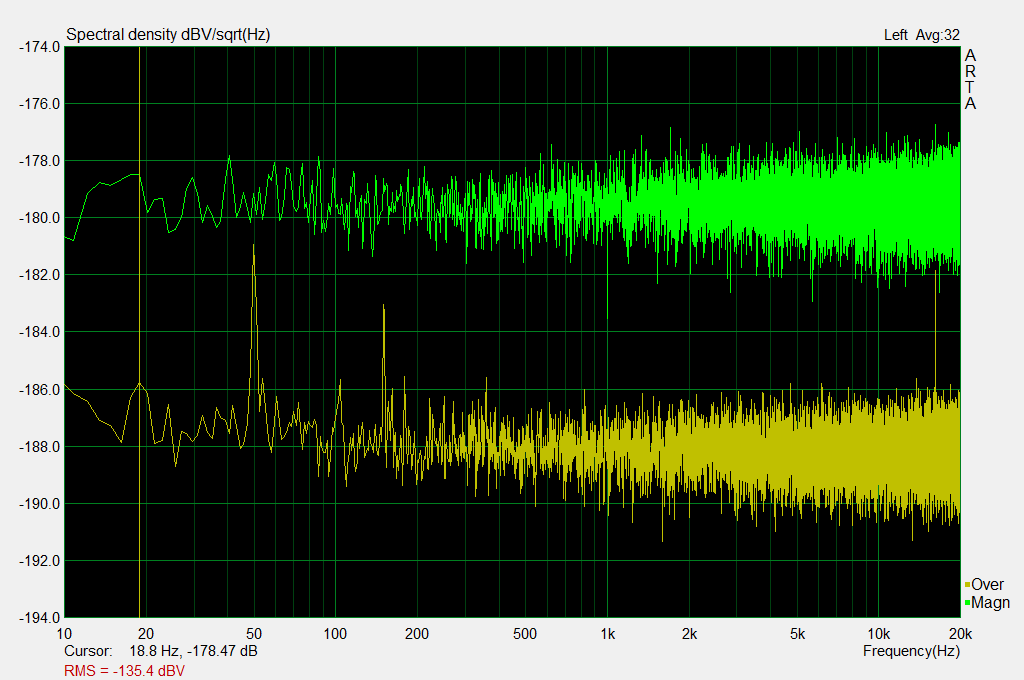

Can you repeat that with a 60 Ohm resistor (2*120 par)? = 1nV/rtHz
Attached, yellow is when input was shorted, green is when connected to a pair of 120R resistor (that measured 59R8 combined). The LNA is still not in a chassis, but I put the whole stuff in a grounded cookie can so there is less 50Hz pickup this time.
What I said myself in this thread and elsewhere... 10Hz corner frequency is out of this world.
Probably a typo in the article. Anyway, what concerns me most is the noise I measured - 390pV/rtHz at high frequency, 500pV/rtHz at 10Hz, which is the same as what's shown on Fig.14 🙂

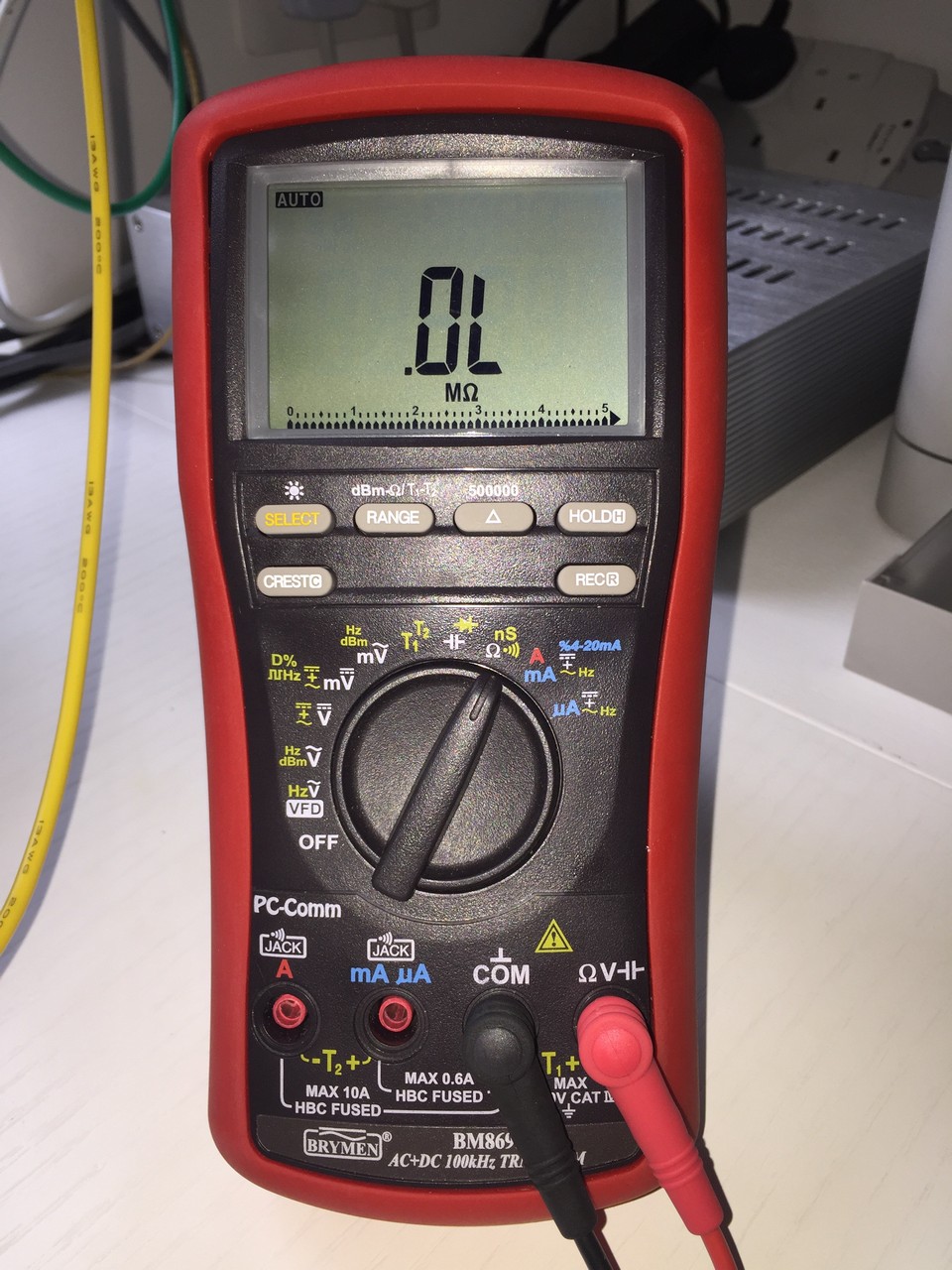

(Recommendations on quality DMMs that don't cost the earth appreciated.)
I have been using the Brymen BM869s (that Mark ordered) and I like it very much, despite having a more expensive bench top DMM, I always prefer the Brymen unless I have to do 4-wire resistor measurement.
One thing to note is that the battery drains relatively fast, in around 2 years of use I had to replace it twice already, and the fuse is a little hard to find when you burn it (I learnt it the hard way).
And, if I may, what noise do you measure with the input to the preamp open circuit?
I'm not sure what's the meaning of this measurement, but this is what I got.

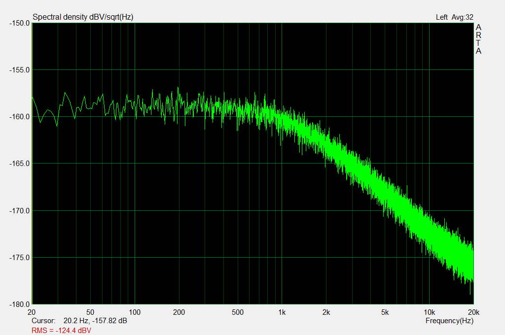

Not dissimilar at LF to what I got.
According to Waly here
I haven't seen the schematic, but something is fishy here. If the open input noise is -160dB (at LF), it means that the input impedance (creating that noise at LF) is about 6500 ohm (10nV/rtHz).
But an input impedance of just 6.5kR doesn't gel with the schematic or spec of the preamp.

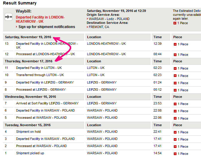

Argh, Brymen multimeter is stuck in UK bureaucracy it seems. 3 days to meander from one London airport to another.
That's to be expected, Luton airport is for to/from Europe destinations, Heathrow is the hub for flights over the pond. And don't count Sat as a day, processing was done on Fri.
