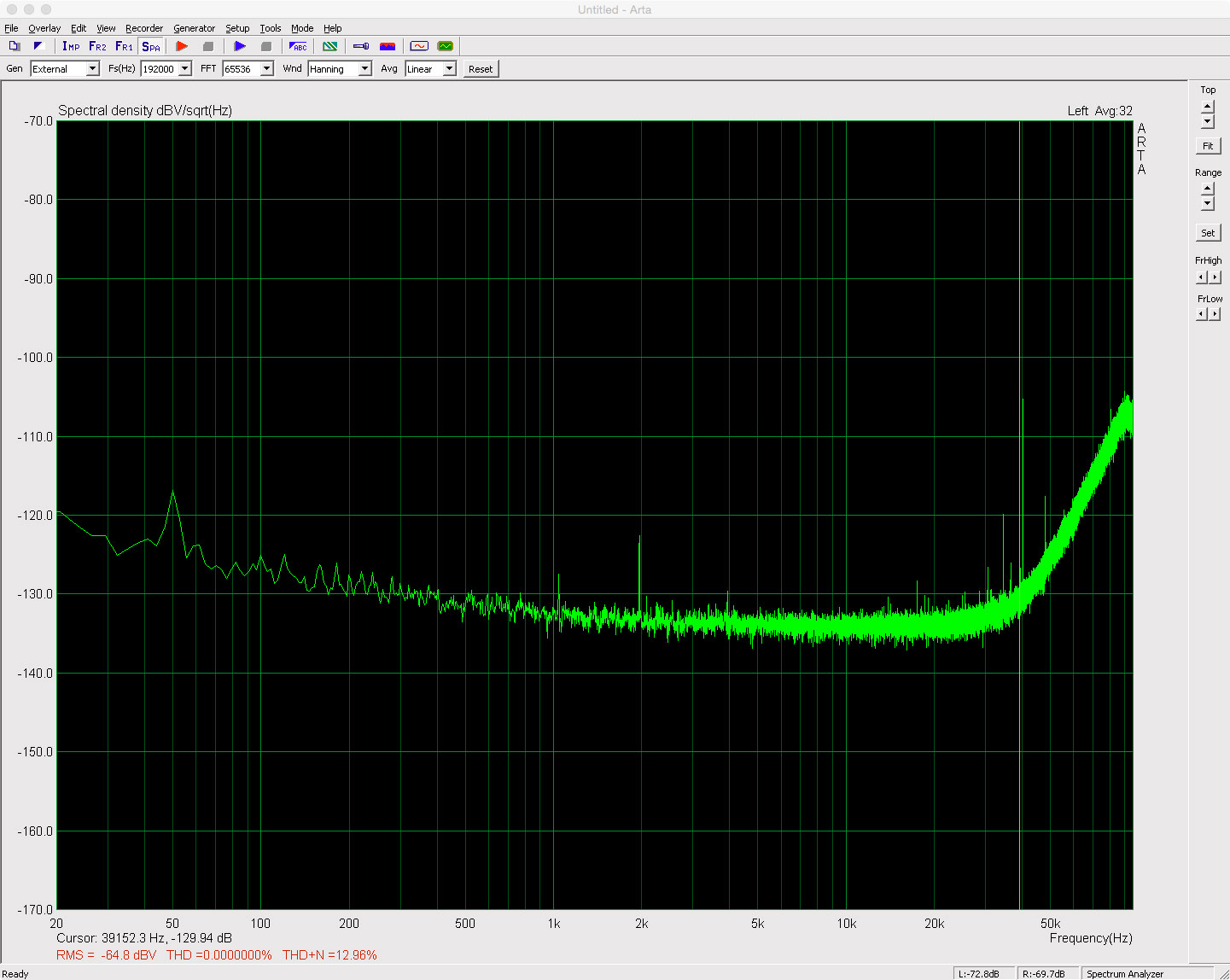

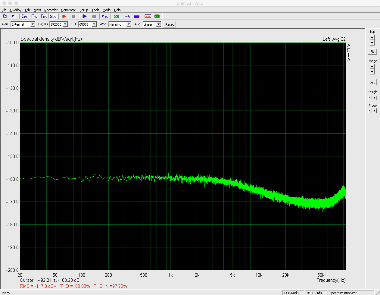

I understood the target input impedance of the preamp ("LNA") to be >100k Ohms. Here Waly asked that I measure the open input noise of the LNA to provide an estimate of input impedance. When I made the measurement then I got a LF noise level of circa -160 dBV. I just redid this test and got similar results. He suggested that a LF noise level of -160dBV (10nV/rtHz) meant an input impedance closer to 6500R i.e. way off. (I calculated closer to 6k but whatever.) [Note we see that roll-off again.] 1audio, I'm afraid I don't think I follow your suggested test of input impedance.

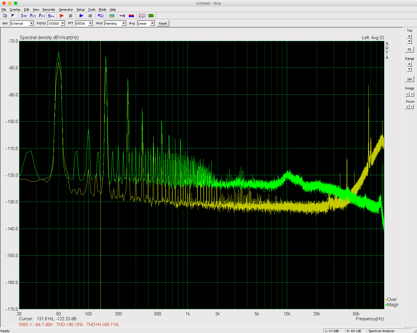

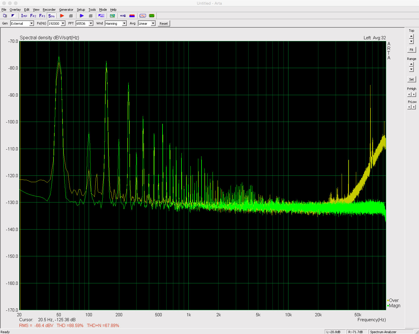

Hmm. I might just have found a possible source of the roll-off - although I don't understand it (nothing new there).
I coupled the preamp to the output of the amp build sitting on my desk. The first pic is how I had coupled it before. I am using balanced TRS connections on my Juli@. At the preamp output I have an XLR with pin 2 wired to preamp J102 3 and pin 3 wired to preamp J102 4. Pin 1 is wired to preamp enclosure. (Yes, I realise the preamp is single-ended and I could redo my cabling and reverse the board on the Juli@ to single-ended RCA output connectors.) Yellow trace is without the preamp. The green trace is with the preamp. (To get the two traces to generally line up in the second pic (see below) I had to change the gain in ARTA from a nominal 1000 to my calculated 794.
The preamp is powered by a bank of 9V batteries for nominal +- 18V. There is no connection from preamp circuit board ground to the preamp enclosure.
For the second pic I connected the preamp enclosure to the amp (DUT) chassis in turn connected to safety earth i.e. I grounded the preamp chassis. No more rolloff in the noise profile.
When I was doing the regulator tests, I placed the regulator DUT, the rail driver, the load and the preamp (within its enclosure) all within a further enclosure. The rail driver was powered by my bench PSU. The output of the reg DUT was connected to the preamp input via coax. I had not connected either of the two enclosures to earth.

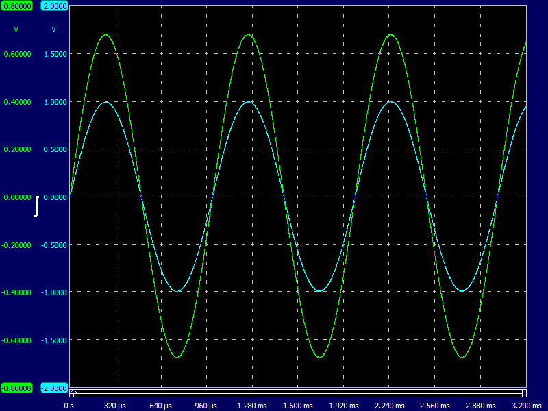

I used a simpler method to check the gain, a voltage divider formed by a 8R2 and 5K6 resistor (just because they lie around my bench, and 1:684 attenuation ratio after measurement of the resistors by a 4-wire DMM).
Then I feed a 684mV input into the divider, send the attenuated 1mV signal into the LNA, and measure the input/output with a scope -> and I get 1V at the LNA output. So I suppose my gain is around 1000. I tried that at numerous frequencies from 100Hz to 20kHz and gain is around the same.
