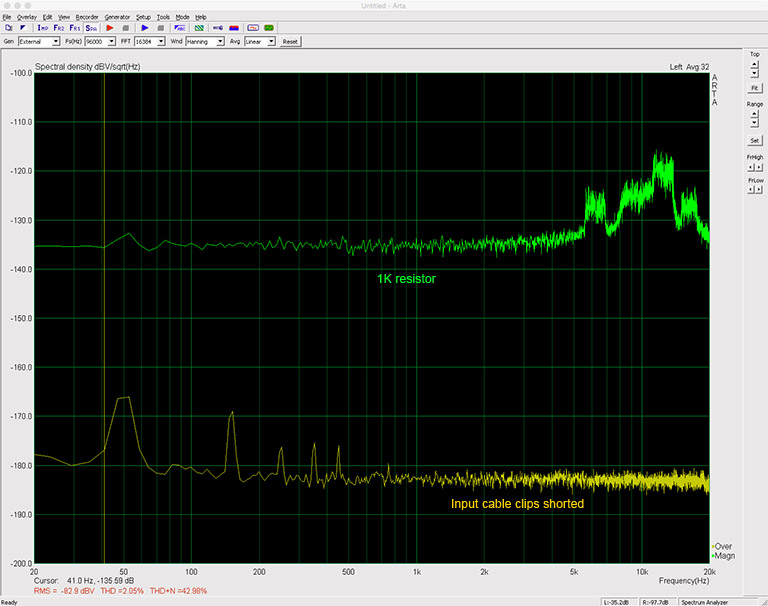

1k resistor (noise floor remeasured as well). FWIW the FFT was very volatile.
Something is not right. Please state how you measured the 1k resistor, 4nV/rtHz should be at -148dB
I presume the yellow trace is the sound card with the input shorted?
Yellow trace is "DUT to pre-amp input cable" alligator clips shorted.
Green is with alligator clips holding 1k resistor. (2% metal film)
I don't follow. What is "DUT to pre-amp input cable"? What are the "alligator clips", the sound card input? If so, are you sure the resistor is 1k (appears as 4.7k from the noise measurement).

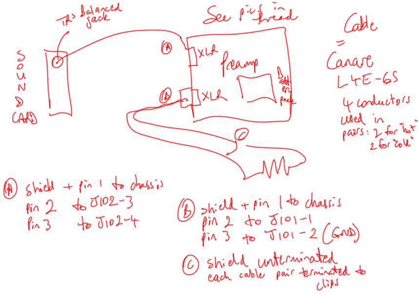

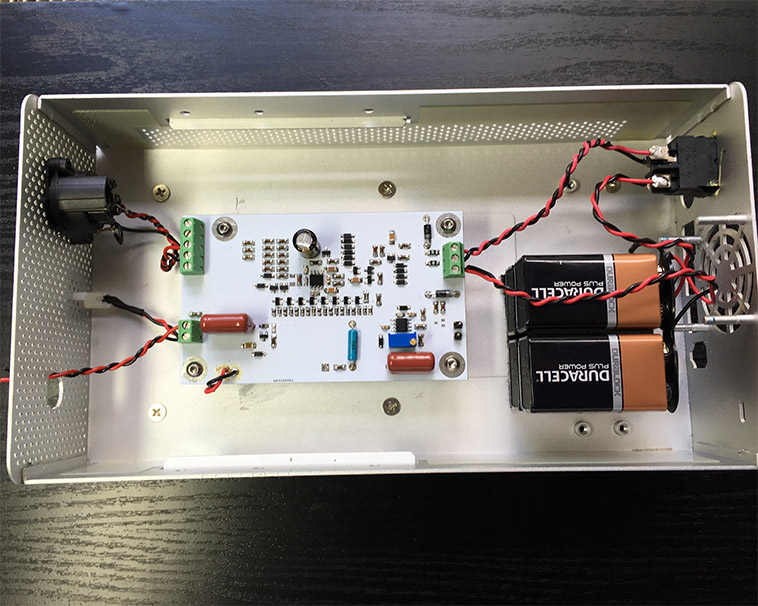

The preamp board and the 9V batteries powering it are now in an enclosure - see previous posts.
This enclosure has two XLR jacks for connection to the outside world. One "output" jack uses a balanced XLR (preamp end) to balanced phono/TRS cable to connect to the Juli@ sound card. The other "input" jack needs to connect to whatever is going to be measured. I have a cable terminated with an XLR connector at the preamp end and clips at the other. (On this cable, the sleeve/shield is only terminated at one end, to the preamp enclosure.)

SGK--even a MS Paint version of what you're describing? I'm not putting it together.

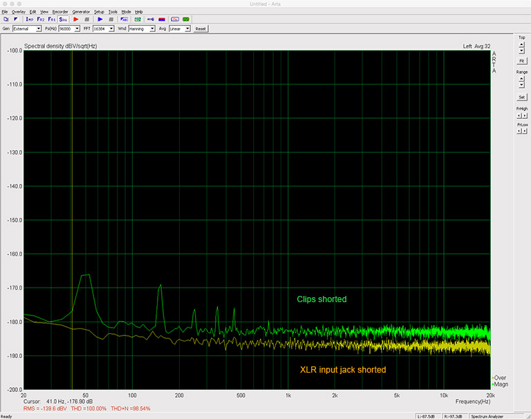

I need to sleep also. In the morning I need to (at least) check my input and jack wiring. If I short connector J101 on the board (within the enclosure) I get the attached. Green = 1k resistor. Yellow = shorted with 1mm copper wire.

I can't find a problem with the wiring of the input XLR jack or cable. This must be environmental pollution or similar. Pic 1 yellow shows the noise floor when I simply short the (input) XLR jack with 1.5mm copper wire from the exterior of the enclosure. Pretty good. Pic 1 green is when I connect the shielded 'input' cable to the XLR jack and simply connect its clips together at the other end. Some 50Hz contamination of the noise floor but not horrific.
Now pic 2 where the yellow is the same the green in pic 1. Green in pic 2 is what I get when I detach the clips from each other and short them with a 1k resistor, now the resistor is suspended in the clips which in turn are resting on the enclosure (as they were when directly shorted). See 3rd pic. Markedly worse and clearly not good enough to measure the noise of the resistor. I'm rather surprised that it is so bad given the shorted clips suggest the general noise floor is low enough.
What am I missing?
I'm not sure you can expect to measure at these levels without proper screening. Capacitive coupling from e.g. fluorescence lamps is significant with a 1k source impedance.

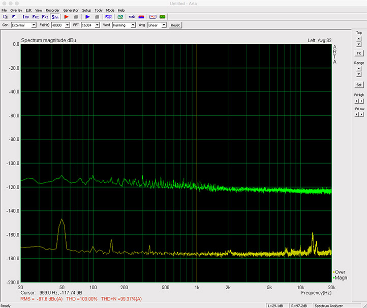

The reason why I selected a scale of dBu is because that is what Self used in his text. He states that he measured his implementation of this circuit at -119.5dBu. I haven't yet figured out how to get a credible single figure measurement, but it would seem to me that I can rely on the scale (knowing that the amp measures a 1K resistor 'well') and that my implementation of this circuit is performing to expectations.

I'm not sure if you're considering the difference between a wideband noise measurement (e.g. 22 Hz to 22 kHz) and a noise spectral density measurement. You need to relate one to the other by means of the measurement bandwidth.
The -119.5 dBu quoted by Self is a wideband noise measurement, presumably in a 22 Hz to 22 kHz bandwidth. This is 820.5 nV or -121.7 dBV. To get a noise spectral density, you divide by the square root of the measurement bandwidth (21.978 kHz). This gives 5.535 nV/rtHz, -162.9 dBu/rtHz or -165.1 dBV/rtHz. These are the figures you should read in ARTA in spectral density mode (again: spectral magnitude is useless for noise measurements).
Note that this assumes pure white noise. As 1/f content etc. is usually modest, this should hold well.
Also the figure quoted by Self might be referred to the input, so you need to consider the gain of the DUT (multiply the 1000x scaling for ARTA with the gain of the DUT).

So I need to look in spectral density mode and ignore dBu scaling? I only switched to this at Waly's request to reexamine the 1k resistor. All I have been doing is eyeballing the FFT in ARTA with scaling set to dBu (because Self reported results in dBu) looking across the spectrum from 20Kz to 20kHz (if the difference between this range and 22-22k is significant I can amend the defaults in ARTA but I presumed it wasn't) and seeing that it is "in the zone".
I was hoping the RMS number would be an average of sorts across the measurement bandwidth and comparable to the single measurement provided by Self, but it seems way off the mark. The ARTA user manual can be found here with the spectrum analyser section beginning on pg 22 and RMS level covered on pg 36. I'm afraid to say that at this point the content goes completely over my head. It doesn't seem to work when the input signal isn't way above the noise floor.

SGK, IMO you are trying to digest more than your stomach can handle. You would need to sit back, then begin reading the ARTA manual and try to understand the features of ARTA and the background of noise and noise measurement.
At this point, IMO your preamp seems to work fine, although you got about 20-30% worse noise performance compared to Mr. Groner's Linear Audio paper (0.45nV/rtHz vs. 0.35nV/rtHz @ 10kHz and 1nV/rtHz vs. 0.7nV/rtHz @ 20Hz).
The artifacts you got when measuring the 1k resistor are likely due to a TV or computer monitor, some of these are radiating at ~16kHz and the cable is picking up the junk. To further advance, you need to re-thing the grounding and shielding of your setup; that's not easy, in particular when you also have to deal with balanced to single ended conversion. I'm sorry I'm unable to help you further, other than reminding you that the best approach is to divide the issue in small chunks that are easy manageable. Grounding is one of those, shielding is another and of course some sort of crash course in noise and noise measurement would help.
