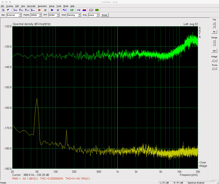

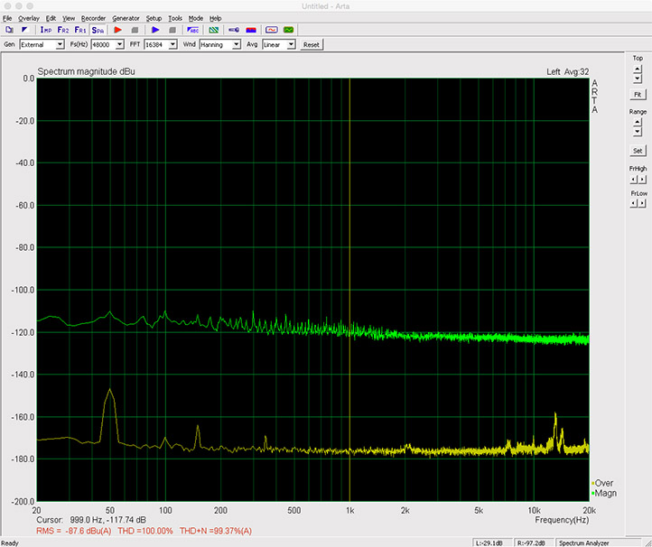

Attached is a measurement of my implementation off Douglas Self's low noise balanced to single-ended input board. The measurement was taken with the input board's inputs directly shorted rather than with a 50 Ohm resistor as Self used in his SSAD 2nd Ed. I will redo the measurement later with the resistor in place.
Are you really saying that little can be gleaned from the vertical scale readings?
If indeed the scale is true it would seem the board is measuring well in accordance with Self's discussion/measurements. (For now I only have the nominal 1000x amplification figure in the ARTA setup.)
I still don't understand ARTA's figures in red - a rough average across the frequency scale would suggest a performance much better than -88dBu

You could use a 1000r as dummy input load as that has roughly the same noise as 4nV/rtHz. (I hope I have the 4nV right).
Then compare 1000r to 0r to see how far the plot moves on that vertical scale.
If I have this about right, then if the 0r goes down by 20dB relative to 1000r, the effective input noise is 20dB below that 4nV reference.
i.e. 0.4nV/rtHz

Yes, 1k is 4nV/rtHz. But the 10kHz noise is more like -17dB lower than the 1k value rendering .6nV/rtHz for the amp, which would make a lot of sense, also the 20Hz noise value would make (following the same logic) a lot of sense, it would be some 2nV/rtHz.
But Mr. Groner was reporting in Linear Audio completely different (much better) numbers for the performance (if memory serves, 0.35nV/rtHz @10kHz and 1nV/rtHz @ 10 Hz (that is about 0.7nV/rtHz @ 20Hz if the LF noise is flicker noise, therefore increasing by 10dB/decade) and I am not the one to prove him right or wrong.
It would so much easy to estimate the performance if SGK would plot his results straight in nV/rtHz on a log-log scale, each and every software can do this. And scale the graphs properly for reading the values, including the noise corner frequency.
I can plot whatever ARTA allows me to. In terms of scaling the options are dB FS, dBu, dBV and PSD.
The bit I am having trouble digesting is the following (I'm a relative newbie so bear with me)...
Apart from selecting the unit of measure as above, the figure placed in the ARTA setup menu (Setup -> Audio Devices) for pre-amp gain sets the scale. (If a power amp is involved this amp's gain needs to be added as well but for these purposes that field is left at 1). While I have for now entered the nominal value of 1000, we can test the pre-amp's gain for any frequency with a signal generator and scope (or true RMS MM). So if we know the amp gain, why is there any uncertainty over the scale?
Re the noise floor, there is of course both the noise of the pre-amp and the sound card.

PSD (Power Spectral Density), that's the right answer. You would also change the Y scale so that the graph fills the screen (like plot between -190dB and -160dB). Connect the 1k resistor to your amp input, not at the sound card input. Given the high gain of the amp (60dB) the sound card noise can easily be ignored.
I'm not sure why you keep mentioning the 1K resistor but of course it would be connected at the input of the measurement amp if I wanted to measure the noise of the resistor. I've not looked at measuring a 1K resistor since placing the preamp in its enclosure and finalising the cabling. If you would like me to measure a 1k resistor with this current test setup I can.
I attach the same measurement as before unchanged except to express the scale in dBV/sqrt(Hz) (by selecting PSD) and changing the range, although I'm not sure how it helps, to tighten it around the measurement of (a) my balanced to single-ended input board with its inputs shorted (green) and (b) the measurement I took of the noise floor of the test setup (yellow) with the input cable connectors shorted together. (b) is higher than recent posts because the alligator clips (and the micro clips I had to attach to them to measure the input board) seemed to pick up more EMI than when I had used a balanced cable and shorted the female end within the XLR connector. (For clarity, the measurement cable set up in use is XLR at the pre-amp end, with shield connected to the pre-amp enclosure etc as discussed above, and alligator clips at the other with an unterminated shield.) The peaks in the test setup noise floor to the far right of the displayed frequency spectrum seemed to be a moving feast - i.e. they came and went.
My ESI Juli@ XTe sound card is 192kHz capable. What FFT settings would you recommend for this sort of work? The variables are Hz (8k to 192k), FFT (4096 to 131,072), Window (Uniform, Hanning, Blackman3, Blackman4, Kaiser5, Kaiser7, FlatTop). I have been using 32 observation linear averaging.
