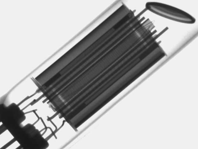

Ty_Bower said:
Not a 6CK5, is it?
Now you are pulling my leg right?
This was supposed to have been the shot,
not to give it away by showing the lid yet...

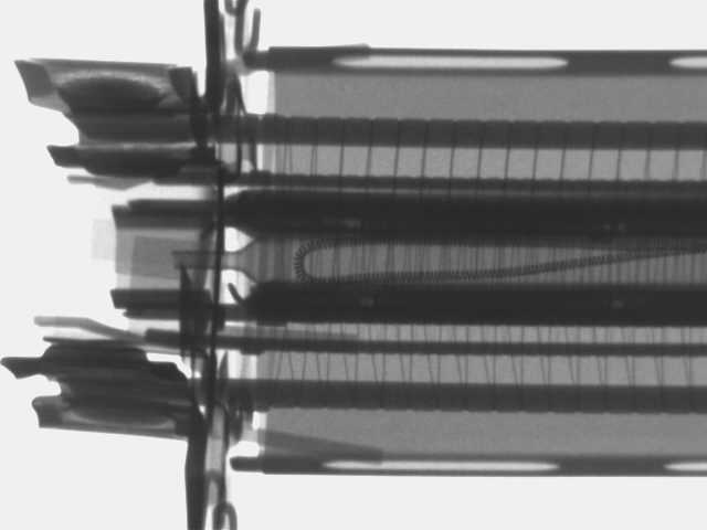

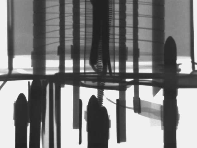

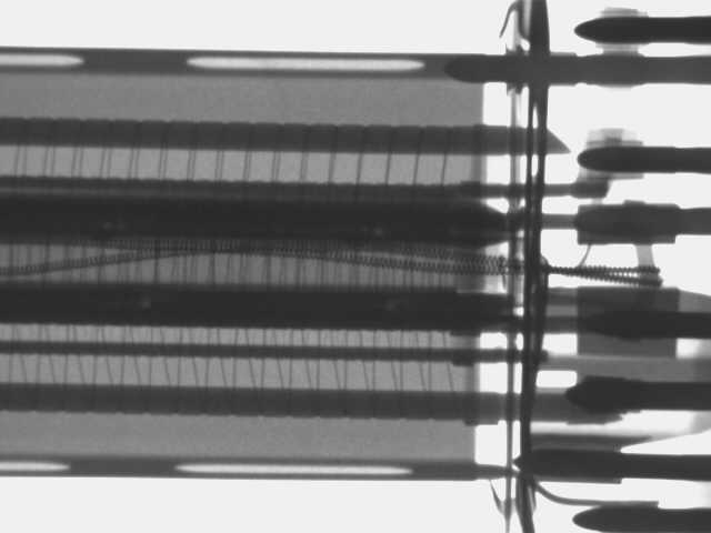

There is however extensive shielding between the plate and
screen connections on one side, G1 and cathode on the other.
That shielding extends (externally) right through to the socket.
Metal partitions separating the relevant areas...
Zobsky's socket looks like it must have come from a tank...
Spring loaded trap door and everything. Simply brutal...
I need to shoot that with a regular camera at some later time.
Or maybe its plate and G3 on one side? I'm not too sure.
No problem the spec sheet can't sort out.

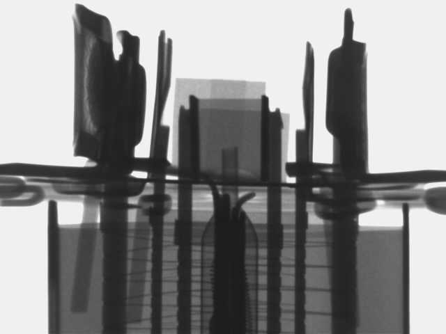

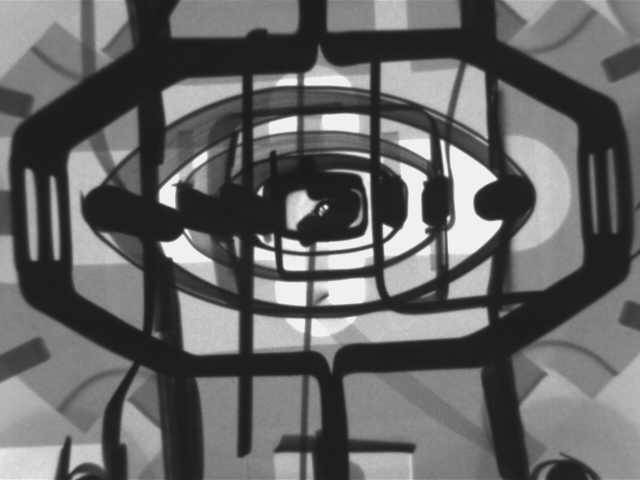

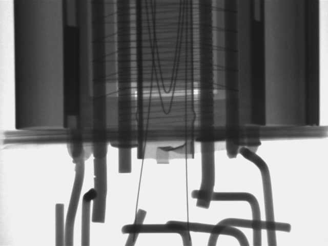

Like the lid, for whatever weird reason, those partitions are invisible.
I probably had the "penetration voltage" cranked about 90KV here.
Thats only a little above midscale...
I hear they used to fit kid's shoes with XRays too.

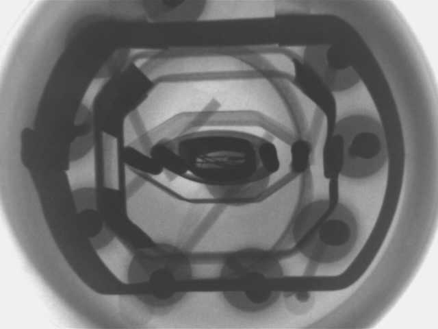

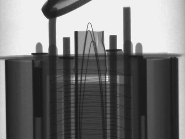

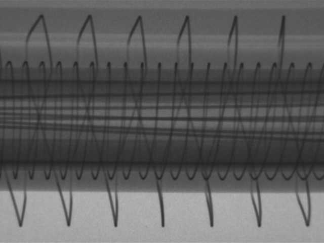

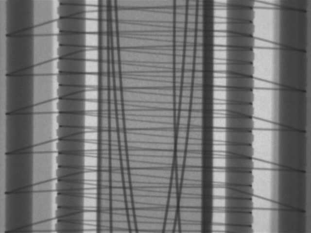

Those wrinkles were probably just to keep the plate from warping out of shape too much when the tube is getting hot.
The fins were partly for heat sinking via radiation, and as a mechanical stiffener.
Noticed that they didn't worry about getting the heater wires evenly spaced inside the cathode. I suppose cathodes were made of metal that was good at thermal conductivity, so the heat would spread evenly.
