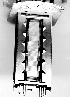

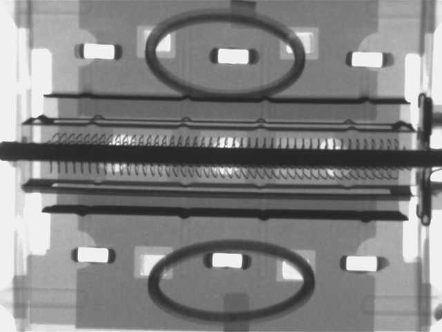

Side view, through the "alignment holes" and beam formers.
The rectangular punched holes seem to be what holds the
plate halves together, and the entire wing some sort of sink.
You may notice the wing intrudes inside, almost up to the
very window of the beam former. This is clearer in another
shot.

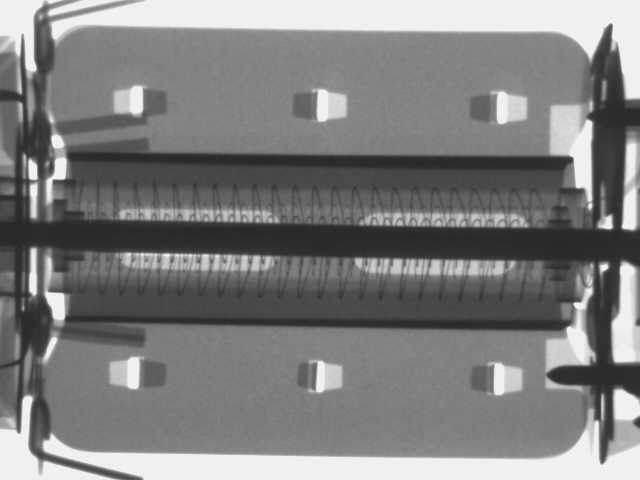

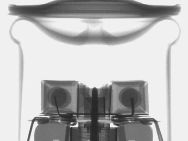

The final pic for this valve... From 45deg off beam.
You can see the "alignment holes" pretty good.
And the filament stands out well in this view too.
The rest of the innards too much in each other's
way to get any clear idea how they might align...

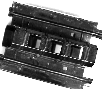

Interesting... I just now notice three rectangular windows
in each beam former. Hold this thing to a light, yep! I can
see right through the other side (no xray needed)...
I still don't know with any certainty what purpose they serve?
And what about that inner ridge down the middle each plate?
Is that one of them mysterious Barkhousen thingamabobbers
I've occasionally heard whispered of in dark corners?

Thanks for the fantastic photos. They're extremely educational. I had been wondering just today about beam power tubes, and why I can see the grids even though I know the beam formers ought to be in the way. I suspected there was some kind of window cut into the beam formers - I hadn't realized the holes were so large, though.

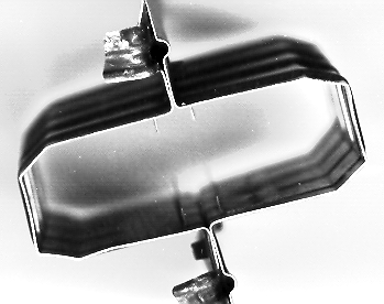

Here's a "pic" (scanner) of a 21JV6,21HB5,17KV6.... plate. The dual internal Barkhausen fins are very obvious on these. Some tubes have small ones as vertical inward wrinkles in the plate sheet metal near the plate supports. Others have spot welded on Bark. fins.

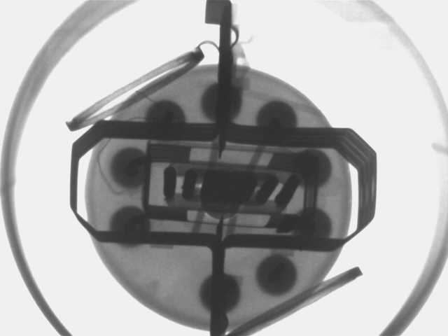

I've been asked to work Saturday, which is usally pretty lax.
So I'll probably bring along more samples to screw with...
I want to compare some pentodes. Identical I think, except
that one type has a sharp cutoff, and the other a remote...
I forget the numbers... If I can't find them, I'll bring a 6BQ5
or whatever jumps out the box at me.
Nope, not EL34... Maybe not even Octal.
6BQ5 type is still on the list for later.

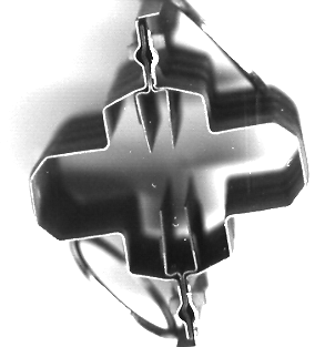

Here they do seem to have aligned G1 with G2, but not G3...
Then again, its kind of odd to find a Pentode with alignment
peepholes. Whatever reason, This one definitely has em...

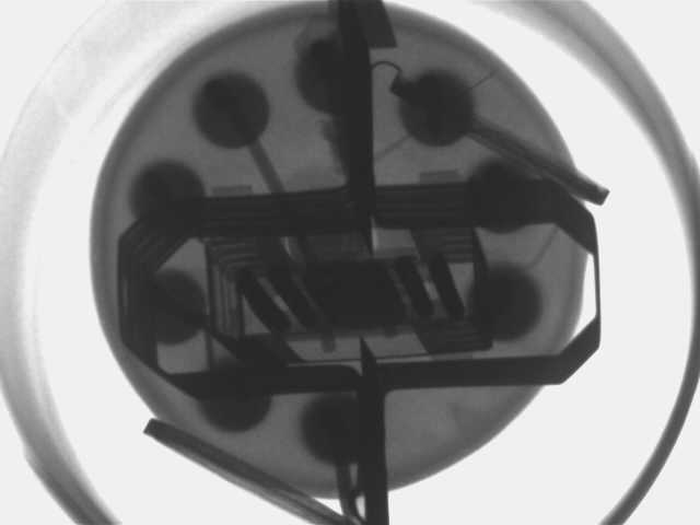

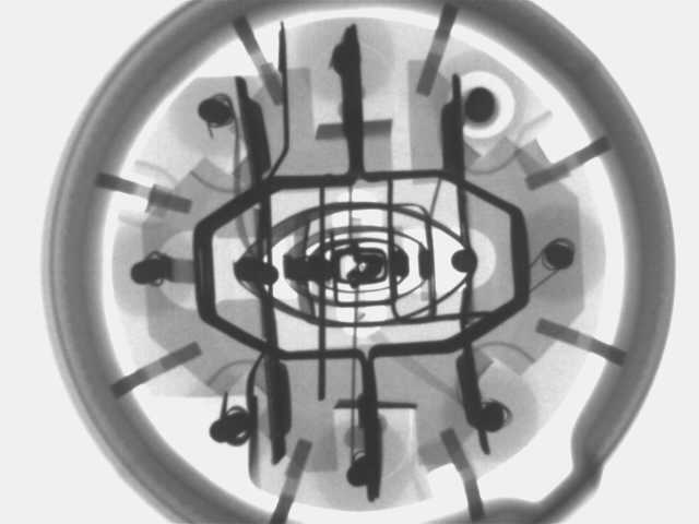

Nope, wouldn't fit in that without breaking something.
Here, business end of the cathode is turned to face.
We are looking in near the top, there are additional
features up here I am deliberately not showing (yet.)
