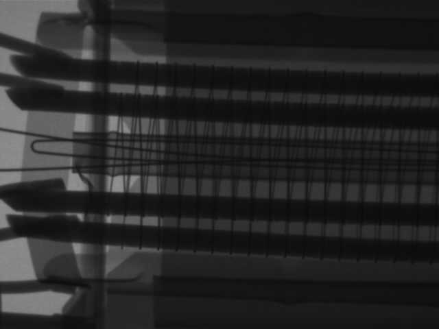

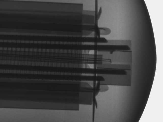

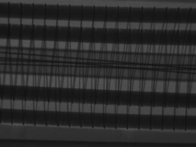

I recently promised someone I'd xray the Chinese 6L6CGR I had.
Don't remember now which thread? Might as well start another...
There are no holes "for screen alignment" in plate of this tube.
Don't know if that is really what typical beam power plate holes
are for, or something else?

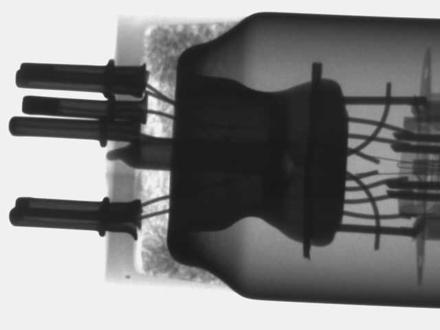

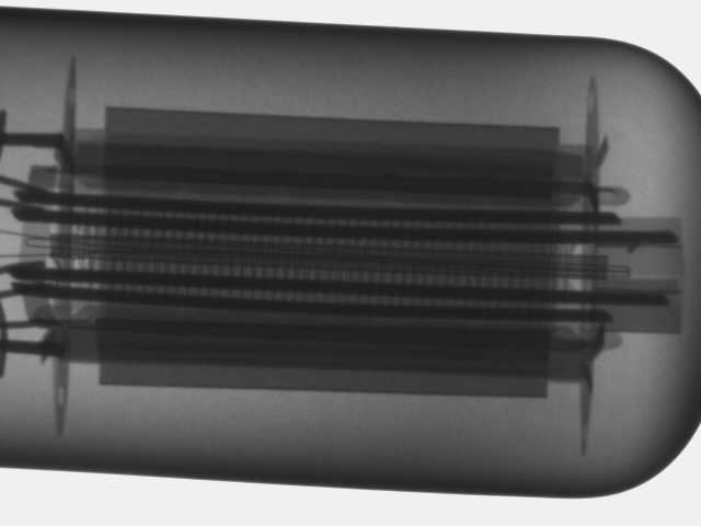

The total diameter across the entire glass envelope,
which also happens to be the same diameter as the
octal base, is only 1.3 inches. Rather small for a 6L6.
Dunno what breed of monster you thought this was?
I think you might have diameter mixed up with radius.
There is simply no way this tube is 3 inches across...
Its probably too late to edit your post now, but you
seem to be hosting the picture elsewhere. I would
assume you still have access to edit the scale?
How does this affect your calculation regarding the
pitch of the grids?
Close, but still not even that big. Measure an ordinary Octal base.
You can see from Pic 2 the glass here is not any bigger than that.
1 and 5/16 maybe??? My ruler has only decimalized inches, and
centimeters on the flipside... 1.3 inches is the closest tick I see.
If the guts then seem even smaller by comparison, they really do
seem kinda small for what its gonna be asked to do. Is this really
the same 6L6CGR as the one that Tubelab said was hard to kill?

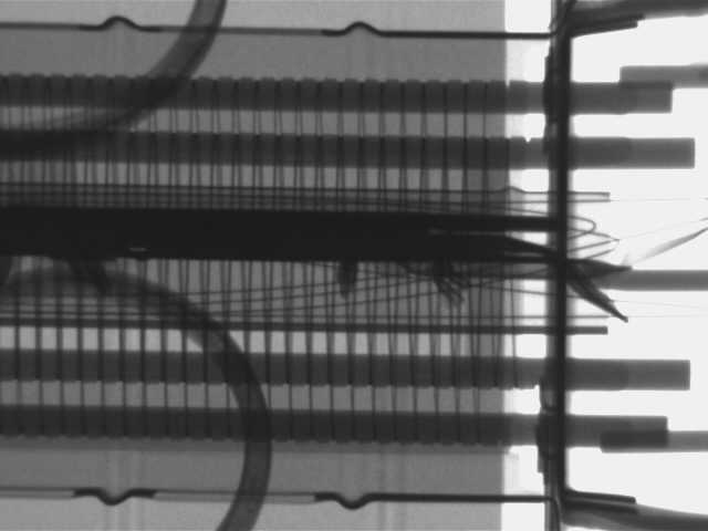

I have very few power tubes at this time except transmitter types.
The closest normal sized beam power tube I have on hand for a
fair comparison is a 6GT5A compactron. And its not really all that
similar...
6GT5A plate is no taller than the Chinese 6L6GCR, yet maybe 15%
wider in the wings where the beams would strike, and with the
"normal" pattern of holes and supporting rods. The glass on the
GE compactron is a MUCH bigger bottle in diameter, though easily
an inch shorter in total height. Nope, its an RCA in a GE box, and
its marked on one end "Low", great....

I'm pretty sure George got his Chinese 6L6 from AES. I'm thinking these tubes can't be the same ones. I've got a bunch similar to the ones in the X-ray (actually slightly larger, as the glass comes out a little just past the base) and I'll agree they are pretty wimpy. 450 volts and 60 mA will get a slight glow started around the plate seams. Perhaps they won't "blow up" but they don't look happy at high wattage. They sound fine, though.
Clearly the exact same thing, only completely different...
There is no doubt they have shared some engineering.
I'm gonna snap some internals of this 6GT5A here in a
few... Next break, or possibly after work if things get
too busy to squeeze into a regular break period.
