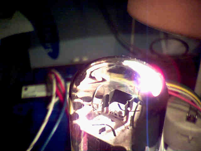

I was PM'd a question relevant to this thread, so I thought I'd bump it to be a bit
easier to find. I was also offered 6P1P for future X-Ray experiments, we shall see...
I've also got JJEL84's working fine in my Fisher X-100-3 (sockets marked 7189).
I have not yet taken the time to peer inside and compare against the originals,
so that tube is also on my short list of sooner rather than laters. Even the Ruskie
6P14's (or was it 15's? I forget) worked without goin' splodie, they just sounded
like they were not biased correctly (not enough quiescent), so I put back the JJs.

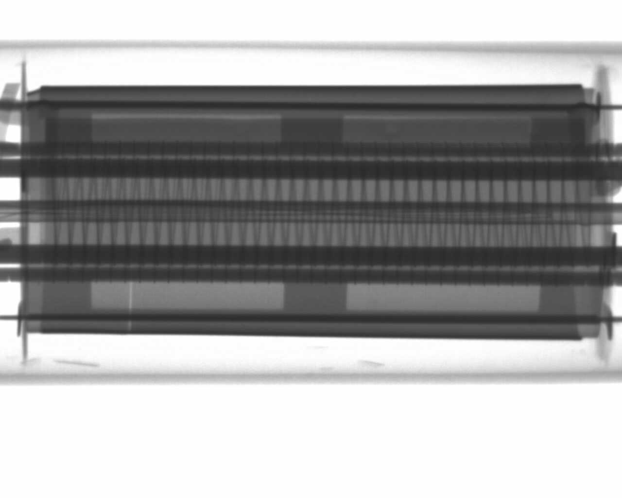

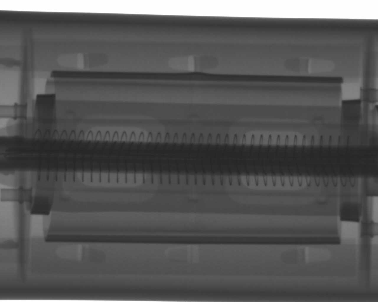

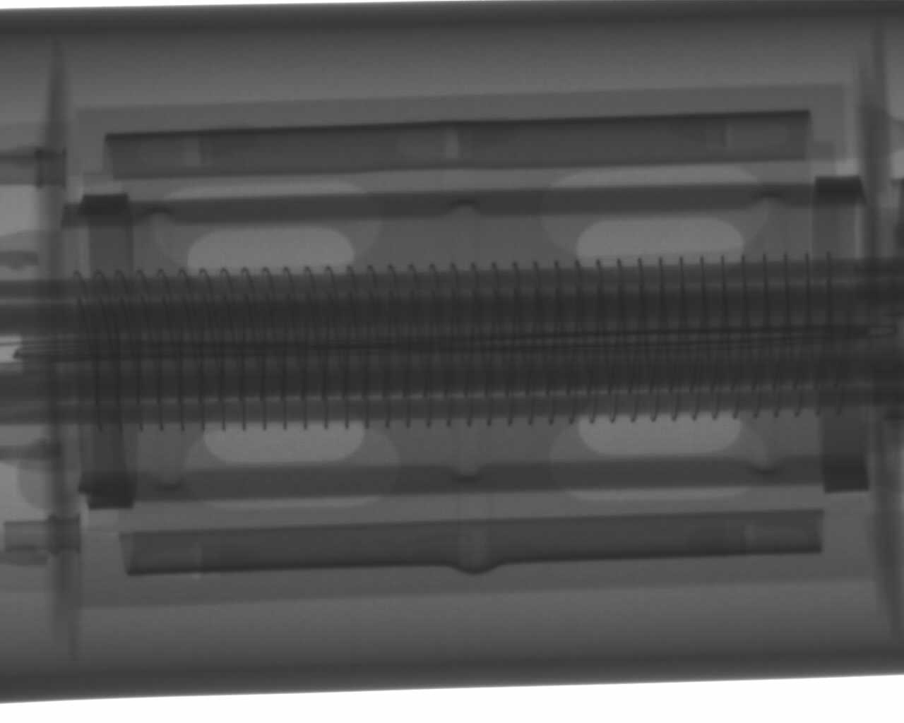

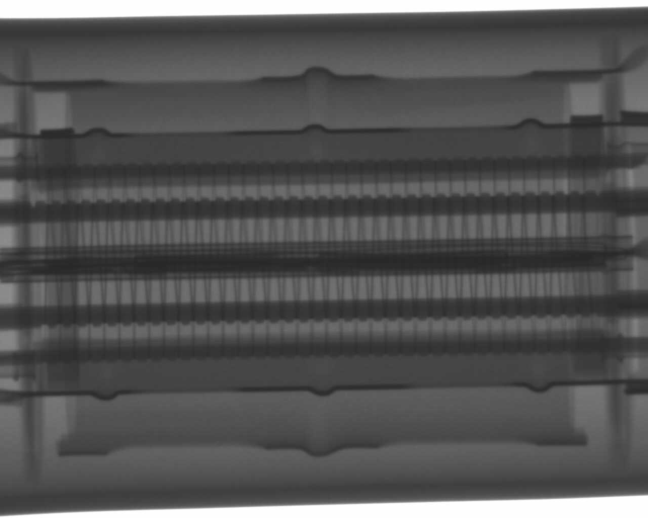

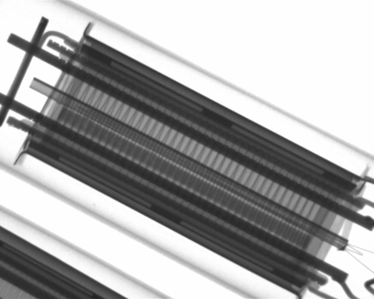

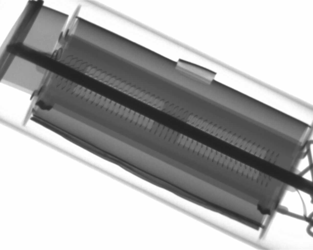

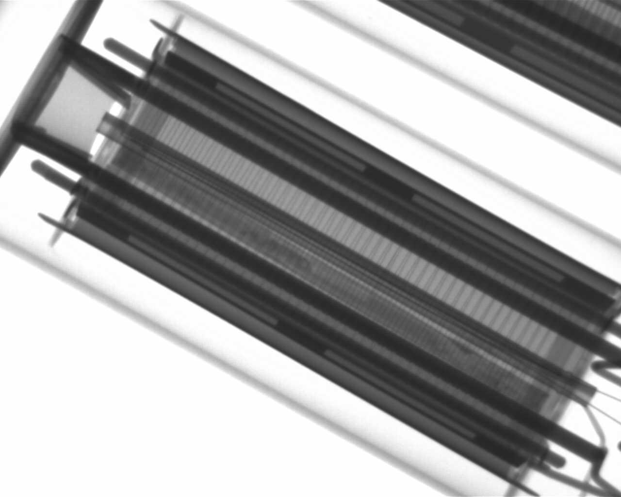

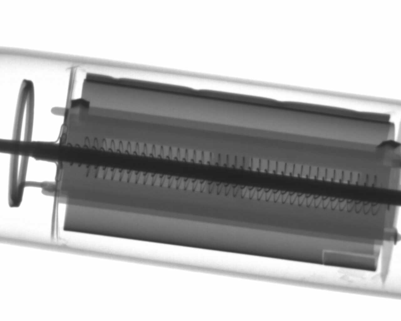

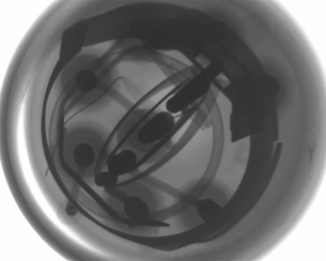

Gimp's 1st 6Π1Π-EB (the one marked with <2> in a diamond)
Yeah, I know the lazy shot off-center, it was a parallax thing.
If I'd shot on-center, you couldn't have made out the filament.
Maybe the tube was leaning slightly or something??? Can't
just stick your hand in there to hold stuff while its turned on...
The last photo (1_1) was unintentional, the tube rolled 45deg...
Also note: This 6P1P was logo'd Winged =(C)=
Other tubes tomorrow... 3 more sets already shot.

I'm surprised at how close the screen is to the grid. From reading older texts on tube construction and the voltages they operated at I expected to see the screen closer to the plate. I also would have expected the seams in the plate halves to have been alligned with the beam forming deflectors, grid posts and screen posts to shadow them. But the seams of the plate are 90 degrees out from what I expected. I would think the seam would effect the plate opertaion, at least to some degree.
This is really interesting.
I think the seams may help radiate heat away from where the beams strike.
Also sometimes a seam may also have a small inward facing edge. I recall
that was explained to me to have something to do with stopping parasitic
oscillations? Barkhausen or something....

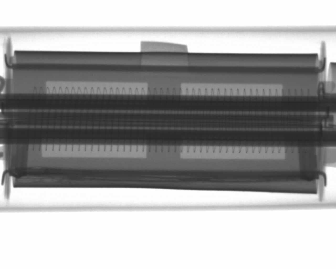

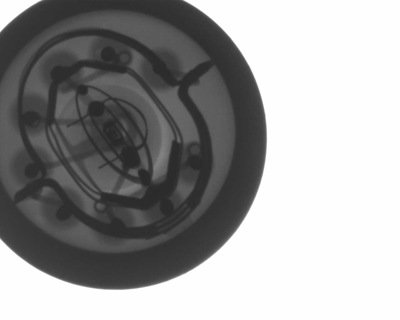

For now, I'll skip ahead to 6AQ5. Gimp's AQ5 pair had some slight internal
differences, or just slight manufacturing variance? You would never guess
any different from the outside view... Or ANY view, except top down...
One AQ5 has grids like a squinty eye. The other (this one) flat, but with
rounded ends where it meets the post... Maybe different tension across
the rods when each was wound?
Interessant, this filament doesn't fill its cathode to the full height of
the grids! And maybe too much sticks out the bottom... Squinty AQ5's
filament doesn't appear to have the same underfill issue. We will see
that in the next update.

Missing here: Some sorta horseshoe shaped
shorting bar in the base, or maybe that was
some part of the getter? The 6P1P had one
too. Why does this AQ5 appear not to have
one, but the underfilled AQ5 clearly did?
I think all three top down views have shown
evidence of a halo for the getter, so I am
sorta doubting thats what the horseshoe was.

There is often a "horsehoe" cooling fin up top, usually for grid 1, on some power tubes. Attached to the grid posts.
Sometimes a couple of fin plates on the grid posts for g2 (6CB5A).

Doh! yeah, so thats what it was...
One AQ5 definately got some shoesink up top.
Squinty, shoeless wonder, nekkid as a jaybird...
6P1P got shoe.
Looks like I got my topdown pics mixed with the wrong sideviews?
You can clearly see which AQ5 sideviews got shoe and which don't.
Means Squinty was also the one with the underfilled cathode.
