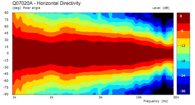

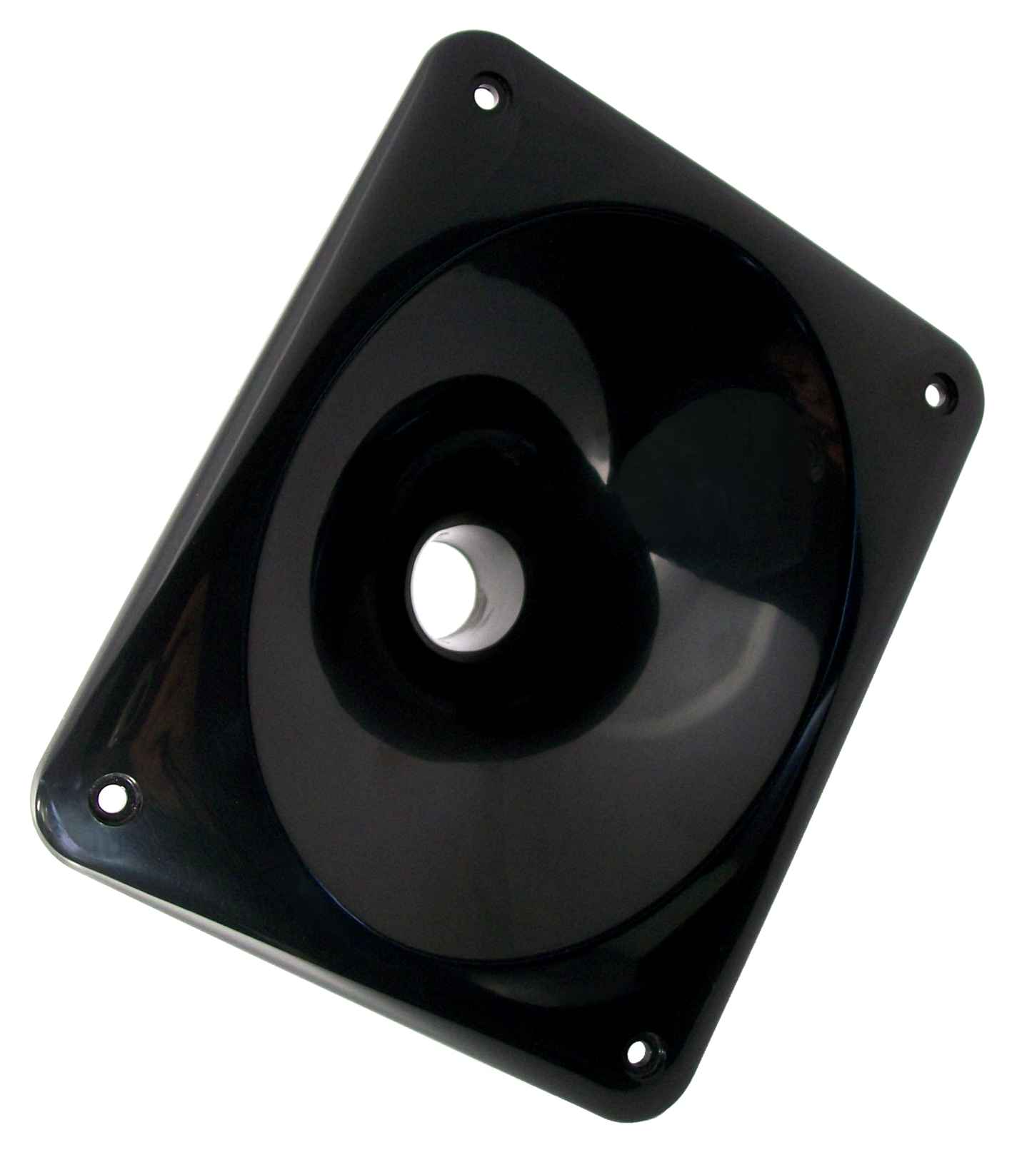

Sica Q07020A
Sica )) loudspeakers
Less than 9 € 🙂
SPECIFICATIONS
Throat Diameter ..................... 25.4 mm (1")
Cutoff Frequency .................... 1.50 kHz
Net Weightl ........................... 0.30 Kg
Horizontal coverage ................. 90°
Vertical coverage .................... 60°
Material............................... Plastic
Shape ................................. Elliptic
MOUNTING INFORMATION
Overall Dimensions ................. 200x160x100 mm
Baffle Cutout Dimensions .......... 167x129 mm
Mounting Holes ...................... 4 holes Φ5.0 mm

US import ban on those Elias. 🙁
Don't look bad at all. Pity they aren't big enough (weak low end @2k) for my needs
Diysoundgroup.com has them, along with a few better WG's.US import ban on those Elias. 🙁
The e jmlc 1000 would be what I'm truely interested in. Major ouch on the price makes that impossible.

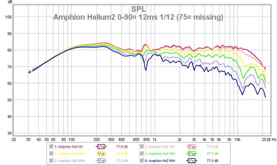

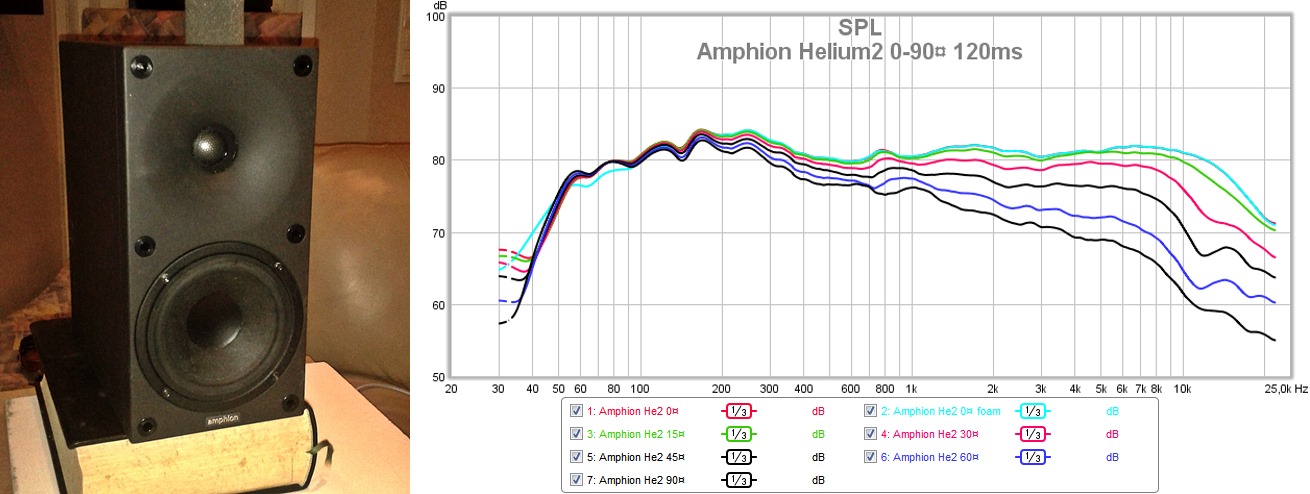

My Amphion Helium2 is performing quite nice, xo 2,2 propably LR2 acoustic.
With shorter 12ms gating and 1/12 smoothing we can see the Peerless HDS134 cone showing it's hickup right at the onset of directiviy
