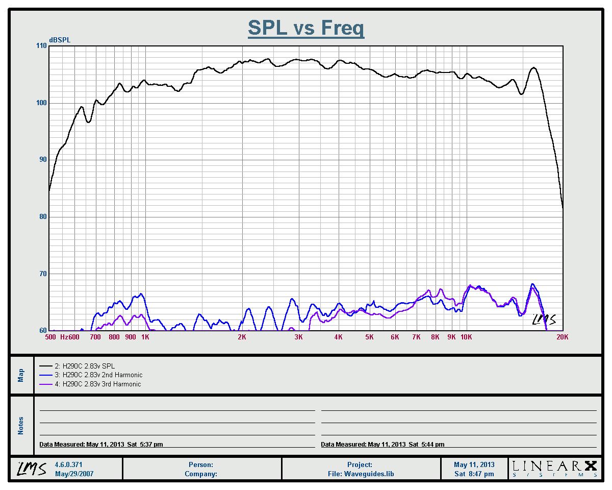

Thought I'd add the H290C to this list:
It's not recent news anymore, since it was introduced last year. And it's based on another (wood) horn/waveguide I made in 2005. But it's still a relative newcomer, and I don't see it mentioned here so I'll add it to the list.
H290C horn/waveguide
Response and distortion using DE250 driver, measured on a baffle outdoors, 2.83v/1M, no crossover or electrical filters
Looks nice, Wayne! Do you also have the directivity plots with a log frequency scale? Makes comparing easier.
The top plot has a log frequency for the horizontal axis.
And log level for the vertical axis.
I was referring to the two graphs below.
