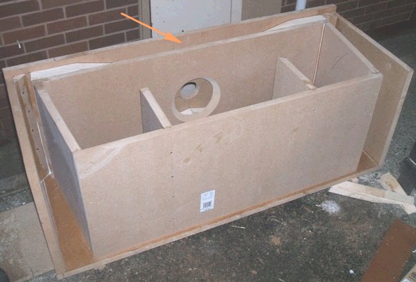

Hi Zero D,@ paulronanqed
Nice to see someone Actually building one 🙂
What driver are you using ?
Earlier on in this thread i posted several things about it. And that i purchased the plans way back when. I seem to recall that this gap was a lot smaller in the plans ?
Have you modified the original design ? or is my memory fading 😀
Looking forward to some test results on this 🙂
Regards
Just spotted the arrow on the picture, the fillets were cut to 1.75" (44.5mm) as per dim's on the table front to back and I left them at CLS width to give them a little more meat and glue surface, might be a bit of an optical illusion with the 25mm upstand at the back and angle the picture was taken at.
Many thanks for the heads up

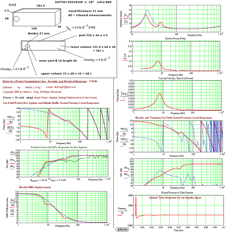

Look at the submitted picture where a 10” Dayton speaker driver Dayton Audio RSS265HF-4 10" Reference HF Subwoofer 4 Ohm 295-460 is modeled in a double bas reflex (BIB?) enclosure, capable in room SPL of more than 90 dB at 8 Hz and low ripple that any room will hide.
Not a Holiman but this less than 1 Litres total stroke-volume (2 x X-max x Sd) 10” based infra DBR driver covers 8 - 80 Hz and will work in any room because of the built in air velocity conversion. J
The size is quite large (427 L), but more than + 8dB is gained at 8 Hz compared to the corresponding IB type and the driver is within linear X-max with a low 16 W RMS input when producing 90 dB SPL at 8 Hz.
With typical + 9dB ‘room gain’ at 10 Hz an f-3dB at 6 Hz can be expected in most living rooms even if doors not are closed.

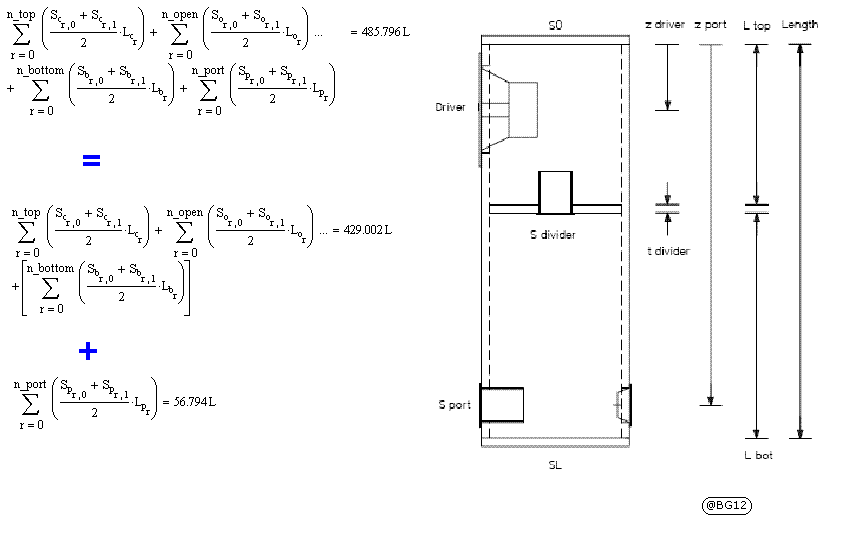

Perhaps the volume calculation is wrong in the proposed enclosure it appears to be 350 Liters to me,but has impressive frequency range, if the sim results are right for the proposed Dayton 10" enclosure then what would be the results for this Peerless India 10" woofer which has comparable specifications and would be a cheap option (i don't know it's price but it's definitely cheap as it is not an imported one ) ? :- Products - PeerlessAudio.com
Hi abhihemu,
I looked up my Dayton DAYTON RSS265HF-4 DBR designs and found the smallest suggestion had a 486L volume but as I recently/presently have had and have computer problems , I could have missed the right sim.
The driver you posted looks good for a large deep FR digging DBR.
Please post a link to the simulation you are referring to and I will recalculate the DBR volume and later(this day or tomorrow) post a sim. using the Peerless India driver instead.

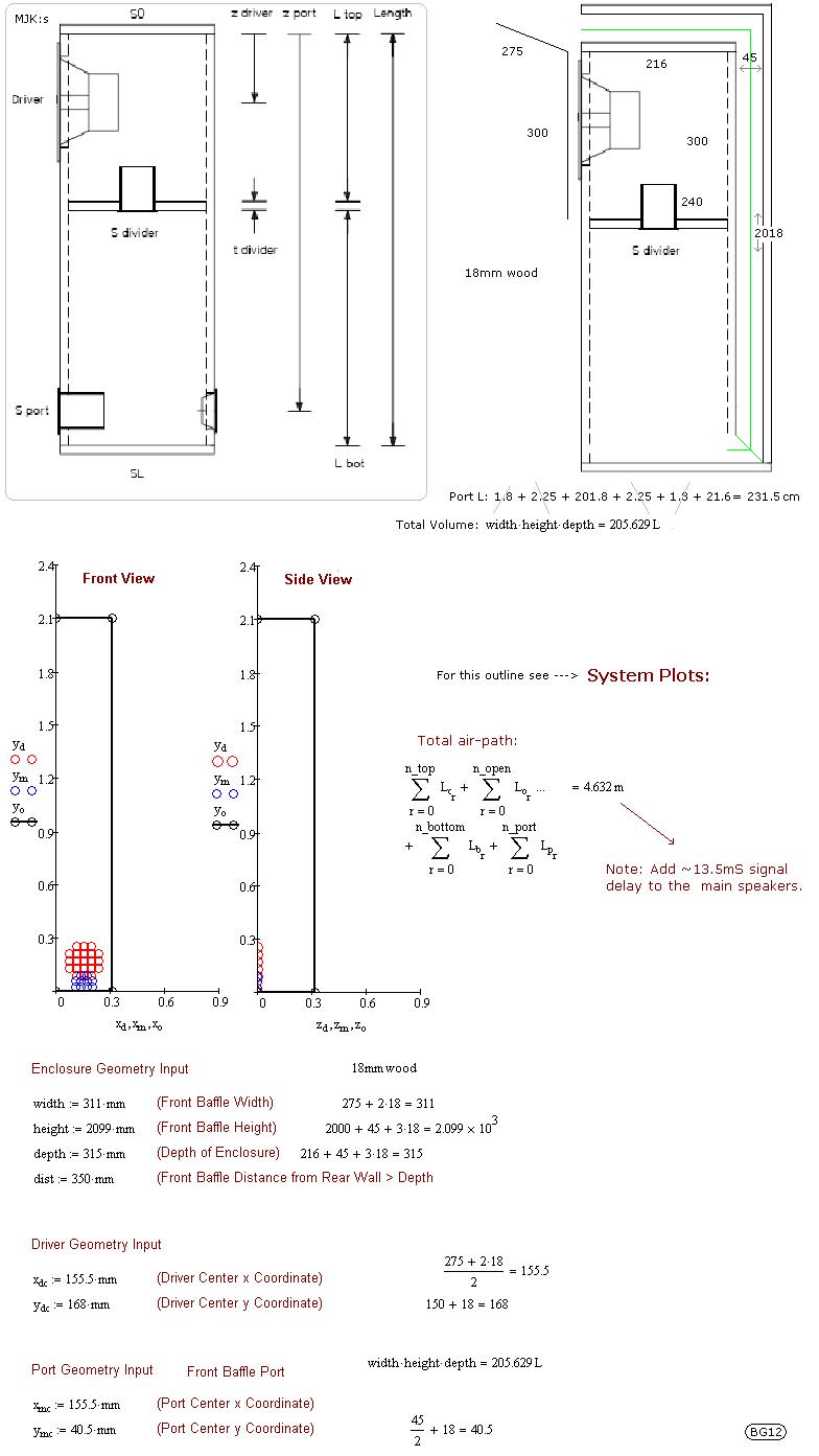

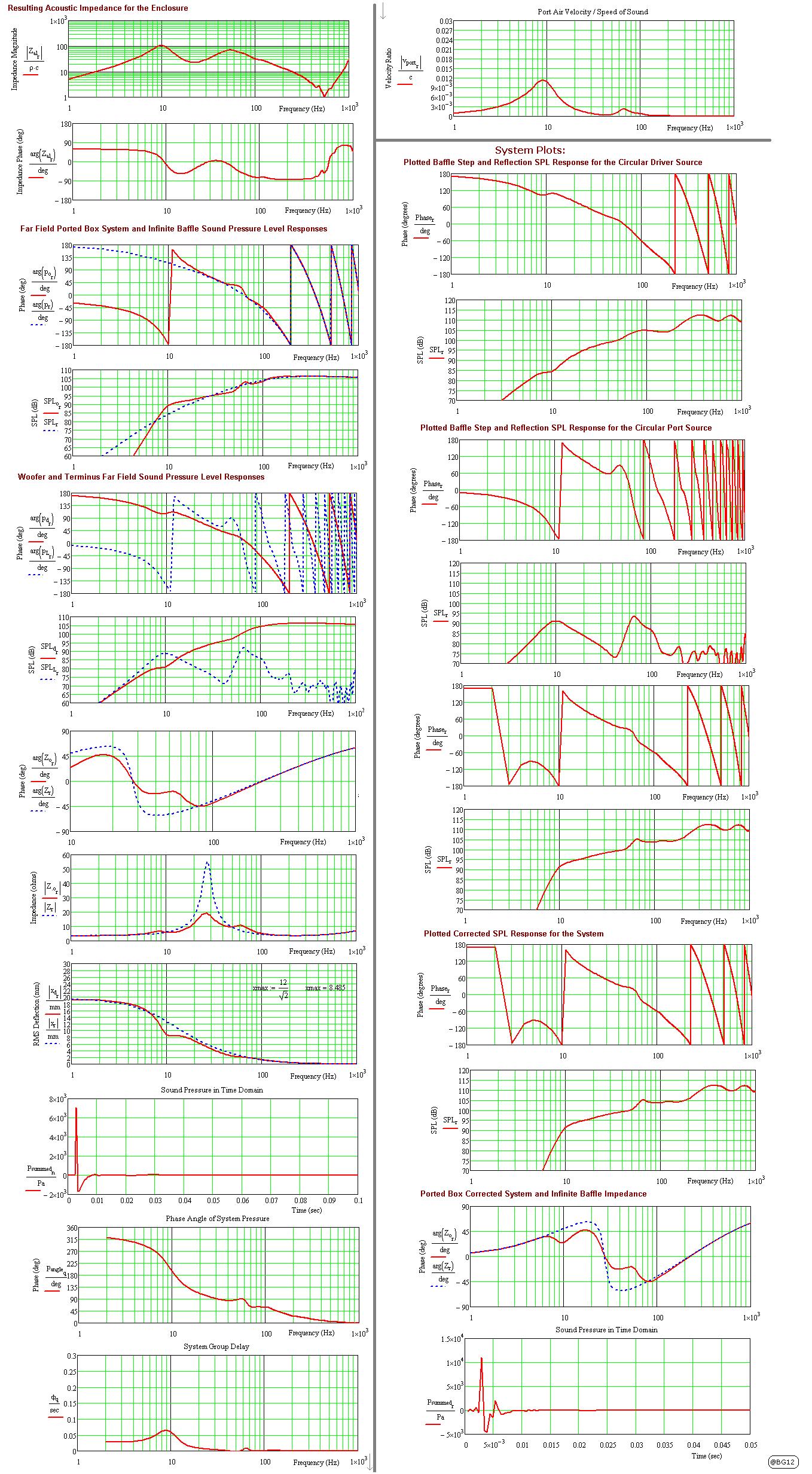

I finally found that simulation and let the program to calculate the volumes:
For the moment: See the attached picture.
b🙂

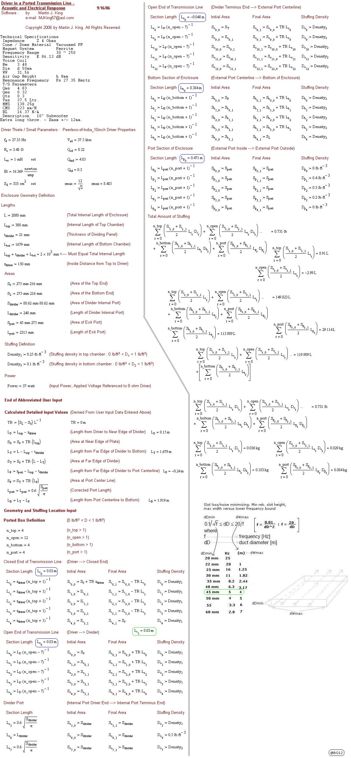

FYI: Here's a DBR simulation using the Peerless of India 10" driver.
b🙂
b🙂
b🙂
Thanks for simulation b
it means that Peerless India driver can produce 10Hz to 80Hz with your design,now i am happy ! but this time volume is only 205 Liters !!? and it looks like a TL. Though i didn't understand the dimensions completely, but this is not a huge box, yet efficient. Thanks 🙂
[book=it means that Peerless India driver can produce 10Hz to 80Hz with your design,now i am happy !]%[/book]
Yes, but you have to HPF at ~8Hz ..
Correct,the whole enclosure will be dependent on quarter-wave behavior.
To understand the dimensioning: visit MJK:s site
www.quarter-wave.com
b🙂
b🙂
[book=[book=..Yes, but you have to HPF at ~8Hz ..]%[/book]
Ops,😱 should be ~10 Hz

Hi b 🙂
just one more question ! what would be the diameter and the length of the Pvc port pipe ?
Abhi
Hi b 🙂
Abhi
The internal port is L= 24 cm, Internal diameter = 10 cm.
b🙂
b🙂

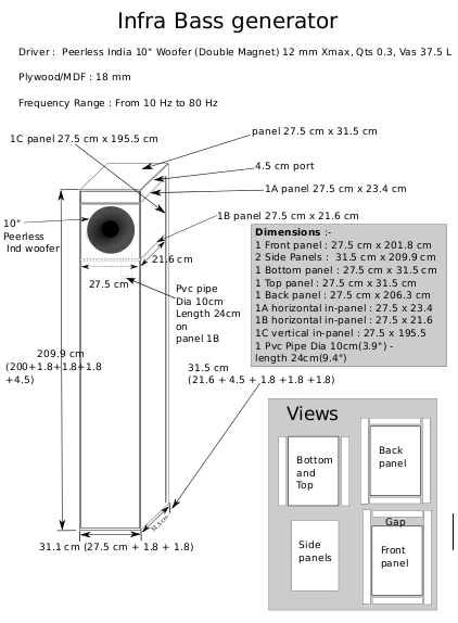

Hi b,
i am attaching the plan suggested by you.
Abhi 🙂

Hi Abhi,
Sorry, almost missed your answer...
You've got it right!
Note: The internal panel = 1B in your drawing has a thickness of 21 mm.. as I can see :If using 18 mm here too would not alter the performance of this box ..
You need also to internally brace the box ,random irregularly cross-bracing should work just fine.
I would spray-glue a~ 1/4" wool felt internally ,at least on the insides of the rear panels.. Covering all internal panels would too be a good idea as a lot of energy is transfered to the wood..
You really don't want to hear any localization cues from a sub like this one. I would definitively place this sub as close to a corner as possible.. with the driver and port preferably oriented close to the floor level.

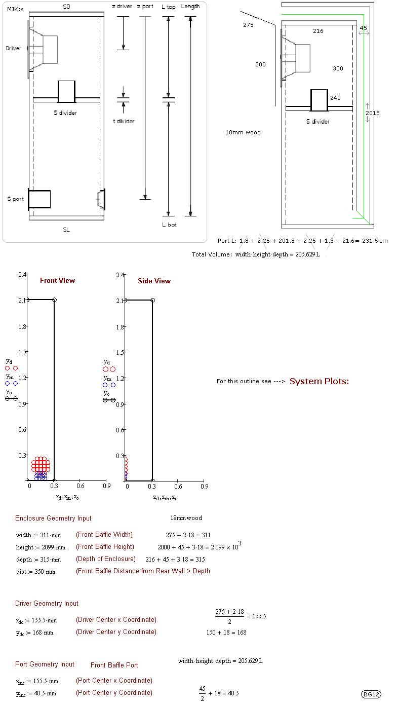

I noticed that in post #307😛icture #1 is posted by a mistake.😕
Here is the correct one:
b🙂
