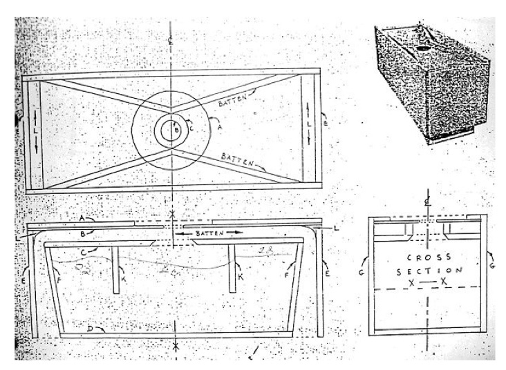

Wasn't it the Atlas drivers that were used in the original Graham Holliman? I want to say it was the Atlas 18.
Yes i also feel sure it was an RA driver, and looking once again at the Wilmslow Audio design brochure i have for it, i noticed that Ryan Reynolds from South Africa who uploaded the PDF of the WADB, missed out a photo. This shows what looks like to me having bought & used RA drivers in the past, an RA driver being used by GH.
I can't see any mention of an actual in depth parts list in the WADB though, apart from the wood sizes etc ! I guess you had to contact them directly for more details/prices etc ?
Okay, so you have the actual brochure? Can you scan it? Is there anything else it has that the PDF doesn't? And the pictures on the PDF are grainy, if by any chance you could do a better job it would be most helpful.
Another thing that worries me is that on the AVforums thread (besides the fact that the link to the zip called "PLANS" is gone) the guy says he remembers it as being about 5 feet long and about 2.5 feet wide, where as with the instructions I have from the PDF even the 18 inch size (just the 15 inch size divided by two times three) the width would only be about 2 feet. This tells me for sure that the original was large, there is no reason I couldn't make it as large as I wanted to as long as I kept the resonator and ports/horns in proportion so that the tuning was the same. I have gotten it all figured out for the relative 18 inch size, plus with double 3/4 inch layers instead of one inch, which is hard to find in anything around here. I plan on starting with MDF, because it's easier to work with (rounding, sanding, chamfering, etc), cheap, and will be smooth for the inside, which I think is important, but since MDF flexes so much a layer of 3/4 any plywood on the outside will do, then with some kind of finish. I'm not a big fan of box stuffing and carpet lining, but when do you guys find that to be an advantage over a smooth interior? Such as maybe for the resonator "tub." Obviously the ports/horns can not be lined and it's crucial that they are as smooth as possible. Maybe they should even have a finish on them. The instructions stress the importance of detail in the rounded corners and the curved fillet.

The problem i see using common tuning for this design is the driver is being used as a air pump, you could use compressed air to drive this thing and it would work. It has more in common with a pipe-organ flute than a modern subwoofer. I have a funny feeling that amplitude of the signal will have more effect on tuning than frequency. Like overblowing a flute. ref: Flute
This may be the missing pic.

Coupling etc critical !
One of the seemingly important things that the GH device relied on to work correctly, from what i gathered anyway, was close coupling of the driver plate hole to the port hole entrance of the tuned box.
Also the driver plate was designed to be Very thin.
Any deviations from his original design will naturally produce different results. These may be better or worse !
Thinking about it further now, it "appears" to me that the Flute etc comparison "might" be justified in some ways. And the tuned box along with the side ports help to amplify the effect.
What's especially interesting to me, is the GH claimed inverse of rolloff down to Very low frequencies, as apposed to other methods which lose gain.
