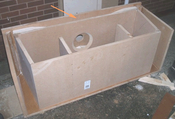

Holliman build pictures
Hi All,
Managed to get them together -
http://dl.dropbox.com/u/9601432/DSCF1953.JPG
http://dl.dropbox.com/u/9601432/DSCF1980.JPG
http://dl.dropbox.com/u/9601432/DSCF1984.JPG
http://dl.dropbox.com/u/9601432/DSCF1988.JPG
http://dl.dropbox.com/u/9601432/DSCF1991.JPG
Will give more detailed feedback on performance soon, got an Inphase driver in at the moment, needs testing on a little smaller excursion cone I reckon, but does drop very low, but very narrow sensible range

Wow! thanks paul !! i heard about this Box for many times but this is for the first time i have seen real pics of it ! many many thanks mate
GH mentioned that the hole "Y" should be made on a very thin sheet of Formica or Duralumin, and panel "K" should be fixed on panel "C" you have put it on "D". Thanks for sharing pics, i will be waiting for your feedback on performance !

Nice to see someone Actually building one
What driver are you using ?
Earlier on in this thread i posted several things about it. And that i purchased the plans way back when. I seem to recall that this gap was a lot smaller in the plans ?
Have you modified the original design ? or is my memory fading

Ouch !!!!! The standing wave inserts !!!!! Thanks for the heads up, Just had a look at it and reckon I'll plough a rebated panel out of the front and remove and re-place the guides. On the back panel, I'm going to route out the circle leaving a 1/4 inch of the MDF and see how it goes, I put the spacer on the back as a temporary measure.
Will post more pickies of the rejigged and completed box over the next week or so, weather permitting (being built on my drive)
Thank you so much for everyones feedback, much appreciated, have a graet Christmas

I worked everything on the panel sizes +/- the bevel cuts and centralized the inner box / chamber, never really thought to check the throats as assumed that they would default to being correct. I'm just looking at the drawing now and seem to remember the throats being identified as 'x' or 'y' on another drawing somewhere, the drawing I used has not got these on, but I've followed the measurements on the table, looks roughly in proportion.Its a very good point you raise though I'll have a look, I can import the drawing to cadmeasure and scale them off. I've attached the drawing I used.
On the driver, I'm using a 15" 1800w Inphase, but feel while listening that there is an optimum, most likely determined by the small throat, that is being passed the longer the extension of the cone. There has been suggestion on here that a small excursion cone is best, from what I've heard of this box, I'm more likely to go for an Eminence Kappa Pro LF 15 that I have.
Any suggestions of a more appropriate cone would be much appreciated.
Many thanks
Ultra KooL! - it will be interesting to find out what it does - it has an incredibly small "throat"
I agree, and when pushed with a long throw passes optimum, I'm wary of fundamentally changing anything to do with the design, thinking I may opt for shorter throw, then maybe drop a rebated panel in with varying throats to see what impact it has, will keep you posted.
