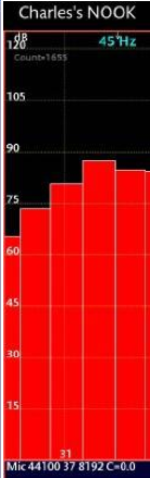

Hello Zobsky,
I used the MCM 55-2421 8" woofer. The woofer is 87db and the Holliman cab seems to be that efficient. I simply took the 10" plans and reduced the dimensions by 20% to come up with an 8" version.
In Room RTA with Pink Noise:
The scale on the RTA is 0 to 16k HZ. Charlie

Charlie,
Thanks for posting what appears to be the first actual measurement in the entire thread.
A 1/3 octave RTA does not normally have filters below 20 Hz, the screen shot below shows what appears to be the 20, 25, 31, 40, and 50 Hz bands.
Your response curve shows approximately 88 dB at 40 Hz, 65 dB at 20 Hz.
That is a 23 dB drop, considering how "jumpy" RTA readings are, reads pretty much like a classic 24 dB per octave drop below Fb.
A sealed box normally rolls off at only 12 dB per octave, if you would like more extended LF you might consider sealing the box.
Does not appear to have response remotely "infrasonic", but decent LF for an 8".
Art

No, I'm suggesting that Charlie's RTA picture shows that his cabinet rolls off at twice the rate of a sealed box, and if he is after more "Infra Bass", sealing the box would achieve that.
Of course, the sealed box extended LF would barely be audible at 20 Hz before hitting the speakers excursion limits :rolleyes:.
