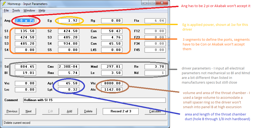

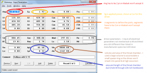

First, let me start by saying I expect people to check my work and make sure there are no mistakes. Please check to make sure I got cross sectional areas right (S1, S2, etc) and segment lengths correct (L12, L23, etc). Check my Hornresp inputs and my Akabak script. I'm going to look it over tomorrow to see if I can spot any errors but I think I captured the essence of this thing pretty well.
Ok, here we go...
First up is a picture showing how I split it up into segments and calculated the compression chamber volume for Hornresp inputs.
Next we have a picture of my Hornresp inputs. Everything is here except the details of hole c and the compression chamber. When you have to use Akabak I recommend starting with Hornresp first and importing that data into Akabak to continue, unless you are a masochist.
Starting with Hornresp gives a couple of important benefits, it generates the Akabak script for you and it allows you to view a schematic to make sure you aren't making stupid mistakes. Here's a picture of the Hornresp schematic (remember, this doesn't include hole C or the compression chamber but everything else is there).
You can see I chose to use the Stereo Integrity HT 15 inch subwoofer Stereo Integrity | HT Subwoofers since it's a fair value, has 22.5 mm xmax and 600 wrms power rating so it should do what we need it to.
Next I exported the Hornresp data, which is as simple as going to the Input screen, selecting File - Export - Akabak script and then I placed that file into the Akabak script folder.
Then I opened the file in Akabak and continued the script by adding the details of hole C and the compression chamber. Hole C is a waveguide consisting of S5, S6 and L56. The compression chamber is an enclosure with a volume of 200.4 liters and a length of 1m.

Ok, here we go...
(I will put the Akabak script in the next post.)

it is "Velocity-Coupled" 😀 ...... what about a transflex with narrowing cross-section vs a plain reflex? (down to ~20)
Hi just a guy,
Note 3 on the attached screenprint indicates that "segments have to be Con or AkAbak won't accept them".
AkAbak accepts conical, exponential and hyperbolic-exponential horn segments - see example scripts below.

Hi just a guy,

Yes, this is true and thanks for correcting that. What I should have said to be more accurate is that it won't accept PAR, which I would prefer to use if it was available.
