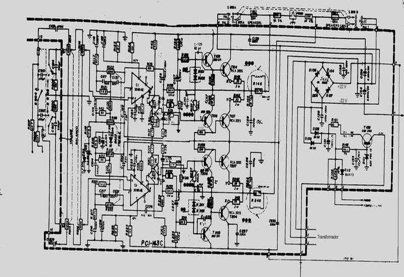

I sent a nasty scanned schemtic of Gradiente MODEL 900 to your e-mail. I noticed you were kind of desperate so I guess it should be more than enough ! 😀
Anyway, any doubt please let me know and I can help you. As soon as I find more time I will draw it in LT Spice.

Hi Carlos,

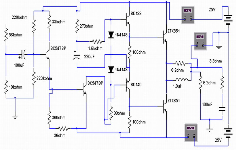

I can do it.... put it on Spice and make it clear
I will do it, remember good times...hearing it!

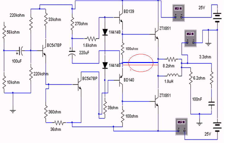

Well, schematic already in my hands, and beeing adapted to work without Op Amp.
In simulator it is working, needing capacitors, rail filters and a lot of details...this is only the basic estructure.
It is working, and will go to best sub group of constructors designer....Mr. MikeB.
This is how the Gradiente turns...and will be completelly different when finished.
Those op-amps...old ones, are noisy.....no good.
To put some TL071 or one better operational amplifier, will loose the distortions i heard in the past..when i was young...i wanna that sound again!
So, for a while will research this one, till i can find older schematics with simple supplies...less sophisticaded Gradiente Designs, as this one was JVC cooperation..... if not cooperation..hummmmm,....well..thank you all.

Do not worry. ZTX851 is just some numbers..the real model is 2N3055
The simulator will put a power transistor in its place.
regards,

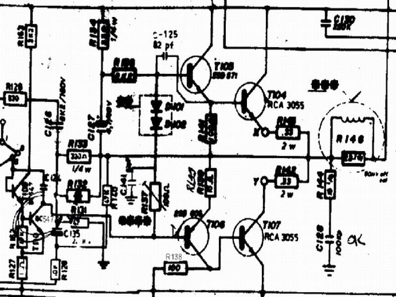

I got the datasheet of the CA3080 (Intersil) used in that Gradiente and it doesn't seem the best choice by today's standards. But maybe it was very good in the late 70's when this amp came out.
It is slow (2 Mhz) and not specific for audio (according to the datasheet). But it has good slew-rate (50 V/us) and produces a not so bad sound. In my opinion, the sound of this Gradiente amplifier is pretty good, pleasant. It produces a little of a harsh sound when at high frequencies and high volume. But in general, the sound is pleasant.

Now i am checking voltages in simulator to do calculation to use one supply that i have here.

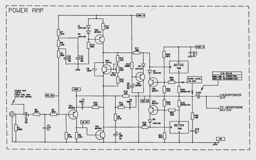

With schema, parts list, and specification. Sorry, but the text is hungarian. A lot of hungarian DIYer loves this amplifier. Some of them thinks, that this is the best sounding DIY-amp ever published in Hungary's hifi magazines.
I cannot attach the files, because they are too big.
I hope that you people from the nice Brazil, from USA, etc... will can reach the files.
(sorry for my bad english...)
http://img.tar.hu/pocsaizoltan/img/5283476.jpg
http://img.tar.hu/pocsaizoltan/img/5283477.jpg
http://img.tar.hu/pocsaizoltan/img/5283478.jpg
http://img.tar.hu/pocsaizoltan/img/5283479.jpg
http://img.tar.hu/pocsaizoltan/img/5283480.jpg

Well, I have this schematics catalogue from Gradiente and it also contains schematics for some STR (850 and 1 or 2 more). It also contains schematics for others like MODEL 1050 and etc. These are higher powered versions of MODEL 900, circuit essentially the same but some minor modifications (Vbe multiplier and etc.). I can send a complete list to you later and you can chose.
Also, I notice you are having trouble with component values. I know the scanned schematic I sent to you is pretty hard to read in numerous sections. do you want me to send values to you ?

No John, i could read values, and the values not clear i discovered them when
I put it into the Simulator.
I tried to avoid the Op Amp.... as i do not like them, normally they are noisy, those old models are hissing.
So i tried to bias that circuit without the Op amp, and i could do it, but assembled real life it was unstable (no feedback) and sounded bad too.
I am really finding something older in style, i wanna have some capacitors to couple some stages, in special the output, a very old styled circuit is wanted and searched...some return to good old days , to have a good comparison related our science developments in audio design.
