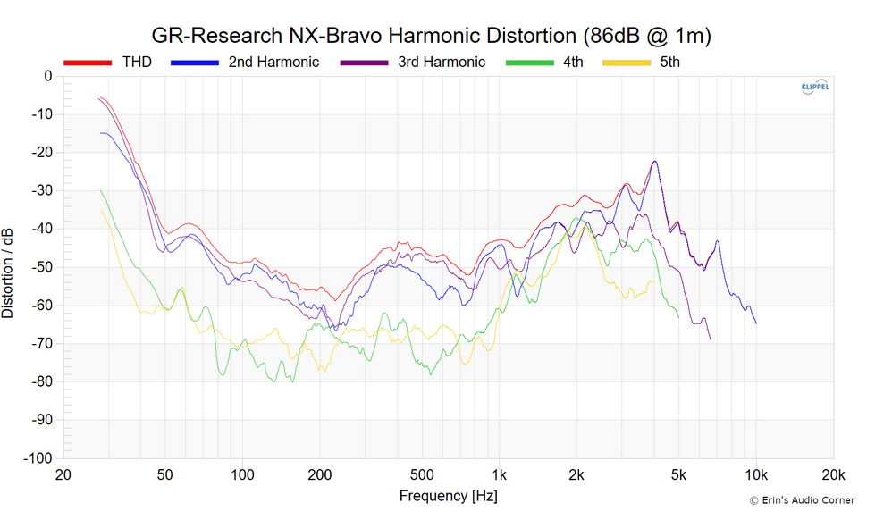

@planet10 fair enough. I'm not evaluating GR on their speaker upgrades, just on the consensus of reviews of their completed loud speakers (some of which are on this forum).
Maybe I should ask this question - what are the most highly regarded alternative builds out there? The room I use is 4m x 7m, low level listening (<60dB). My main criteria are: decent mid level tone and sound great at low volumes.
Was considering standard designs and very high efficiency as well. Space is not much of a concern.

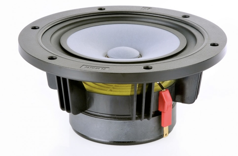

Also factoring in is your taste … at those levels most of the short comigs of my favoured FR/single driver loudspeakers would likely do the job. I suspect that a set of these Alpair 12p in Pensils (or Joan) would actually satisfy your requirements, smaller might make it easier to deal with lowest bass modes.
https://www.darcher.com.au/speaker-drivers/woofers-subwoofers/mark-audio-alpair-12p
But hold on: D’’Archer till has some of the NLA MAOP 10. And ifthe price is right a margin. These are one of the priciest MA drivers and competes with drivers that cost manytimes more. Not as sensitive, a bit less bass potential (maller cone), but more “accurate” with a more extended top-endl.
And LOTs of budget left to ensure it gets fed a very good signal. And woofers (even small ones) and better DSP could be a later addition if you feel the need. THink of them as acoustic room EQ, perhaps adding some weight, extention of the Prnsild is good … the original Super Pensil 12 (with the some 3dB less efficient metal cone driver) was designed specifically for a much larger room in NZ.
That is my taste thou, yours could well be different. Take a dozen very good loudspeakers, they can all be equally valid, but sound quite different. There are many ways to go.
Check out some of their other drivers for multi-way or woofers — you said you have 2-way standmountsyou are haoppy with? Opens up the possiiloity of just doing woofer/stands for them.
