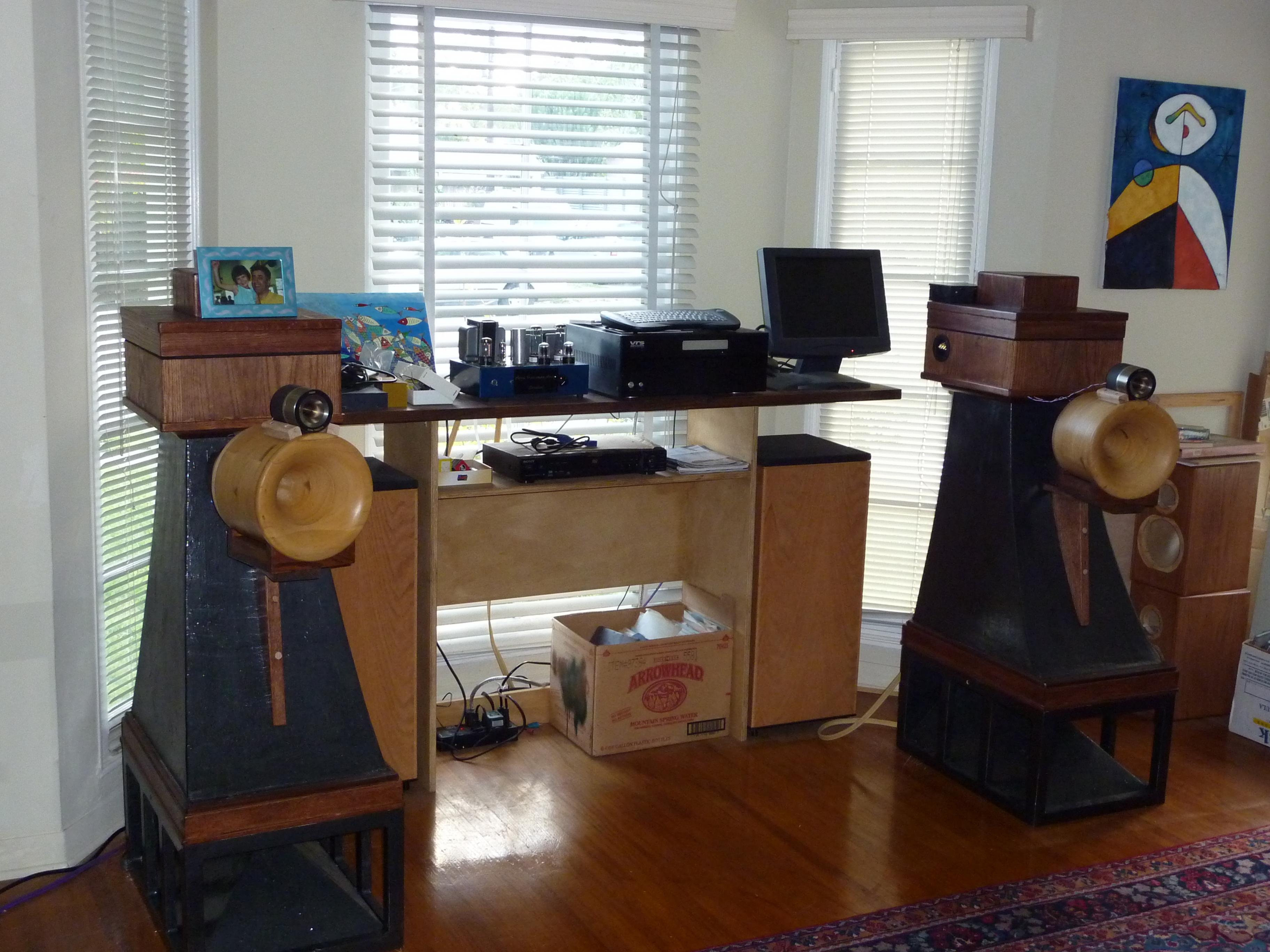

Have you ever tried having the sub horns fire into the floor - of course with enough space to create a mouth of appropriate size? I had great results with floor firing horns - subs and simply bass.
Interesting...can you show some pictures ? What is the size of mouth, length and which driver do you use ?
My post #64 shows the floor firing 35Hz sub. Here's my other system with floor firing 80Hz horn. This arrangement allows for a near-field listening environment which is particularly suitable for smaller listening rooms.
Interesting design. Space effective 🙂
My 25Hz horn is finally ready! Can't wait to try it 🙂
A labor of love...people who aren't into off-the-deep-end-audio will never understand...25Hz? Isn't it a little aaa...optimistic? I calculated the size for 1/4 size mouth for my 35Hz floor firing sub as about 1560 inch sq. 25Hz mouth would by enormous. What is it, 1/8 size?

Yes, at that time...but now I have some solution for bass. I don't understand how, but it works - 15" FC Supravox in 46hz horn:
