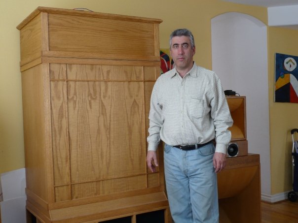

If you want the ultimate bass, there's no way around a horn sub. Alright, it won't give you 16Hz, but trust me, you won't need it. I think 35Hz is all you really need.

I've missed picture when I write my previous post, so you have something very serious for bass! Can you, please, share some details ? Length of your horn ? How you folded it ? Drivers ?
I'll happily give you all the specs if you want to build this behemoth. It is driven by one 18" JBL (2040) A friend of mine has an identical sub and he drives it with a 21" driver. I think that 18" driver resolve the detail better, though. For reference, I'm posting another photo. I'm 6". BTW, there's plenty of residual response below 35Hz.
Great, thank you! It is interesting to evaluate the possibility of using this construction for my system. Is it possibly to modify it to use with 4" throat GOTO 146LD ?
I think it is perfect idea to try to implement subBass with GOTO 146LD.

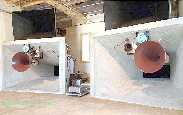

Nice SystemaMurata,
Mister Tanaka will be happy.
http://www.diyaudio.com/forums/multi-way/142723-my-diy-5-way-active-horn-system.html#post1810184
Br Walter
