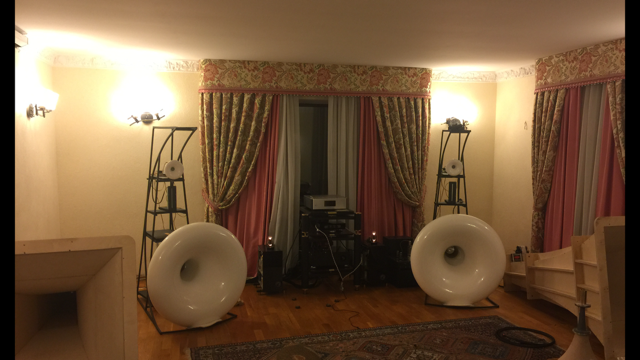

GOTO 6-way TimeAligned Horn System

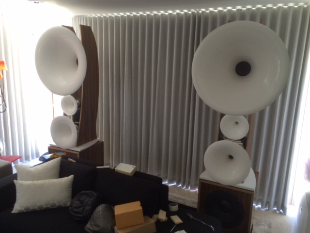

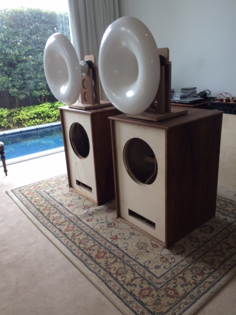

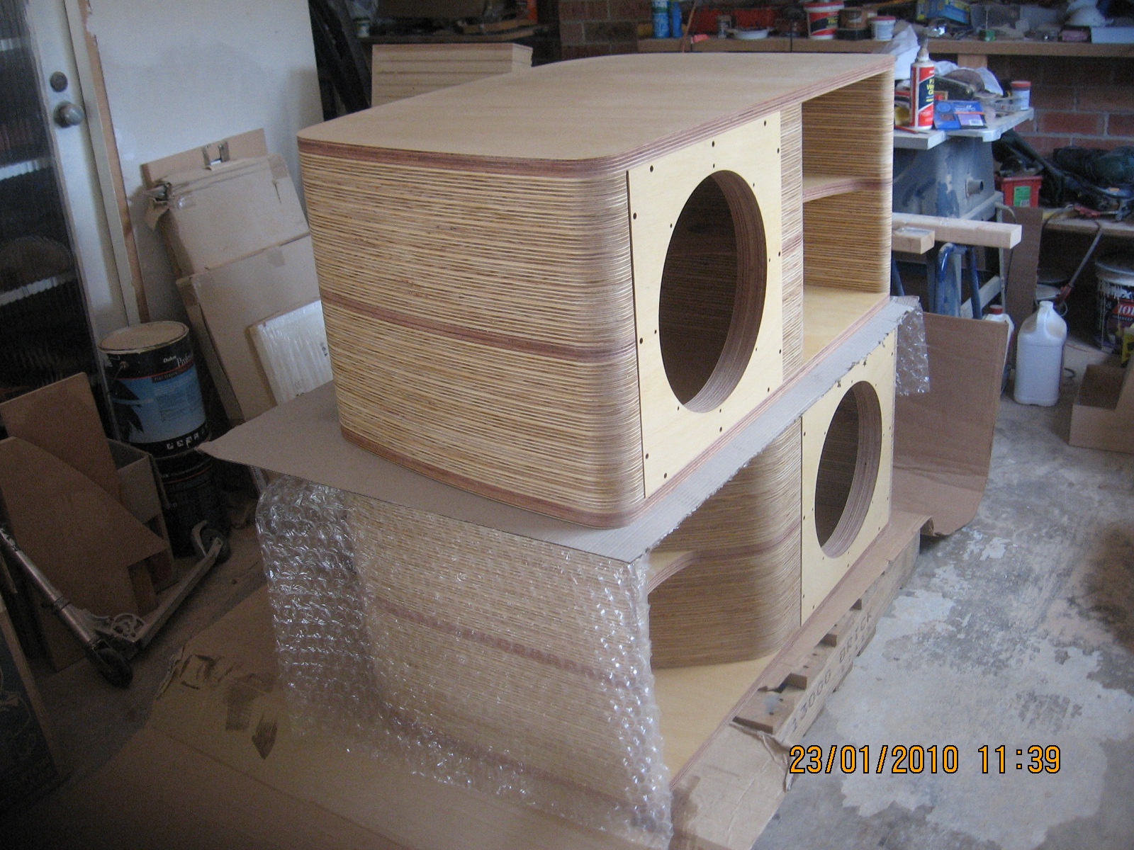

I've built a Cessaro style clone using Azura horns. Also, I've built large bass horns for US GOTO rep, Ming Su.
I used JBL 2420 drivers plus Faital Pro HF200. The bass units were 18 inch Faital Pro. Horns were 160 Azura with 8 inch Beyma, 340 Azura two inch throat, and 550 Azura for tweeter. I used 8 channel MiniDSP for xovers, and a mix a quality SET amps and SS amps (for bass).
I've also built every version of the tapepd horns from Volvotreter web site, plus a few Bill Fitzmaurice bass horns.
My current rig is Azura 340 with Faital Pro HF200 and Altec 420A 15-inch two way, passive.
Kind regards
Andrew, Sydney

The 340 LeCleach is full profile, which is why I like that model.
For the 40 and 30 Hz tapped horns, I used Tang Band 6 inch drivers..
I'm not sure about GOTO for tapped horn. In essence, with the big tapped horn, you only need 20-50Hz....so I'd lean towards a pro driver in that regards. I think you'd want to put the money into GOTO for wider ranges.

Yes, I agree completely. At this stage I'm only choosing drivers for my taste and looks like I've finally just settled. I still want to try 505 and 570 on place of 555 and 370 on place of JBL2453, but I like what I got now and ready to move to the next stage - crossovering.
Currently I'm using 4th order lowpass at 50Hz for Tapped Horns, 2nd order lowpass for midbass and upperbass big GOTOs and 1st order highpass for them and 1st order for the rest of channels.
I got very good frequency respones, I'm very happy with tonal balance and now I want to measure group delay and check what problems I have.
But I don't know how to solve them. I'm not sure that I can keep celarance of the tone with more complicated crossover. I can't even use attenuator, becase I hear how sound degrades because of it.
What do you suggest to do to carefully time align my system ?
