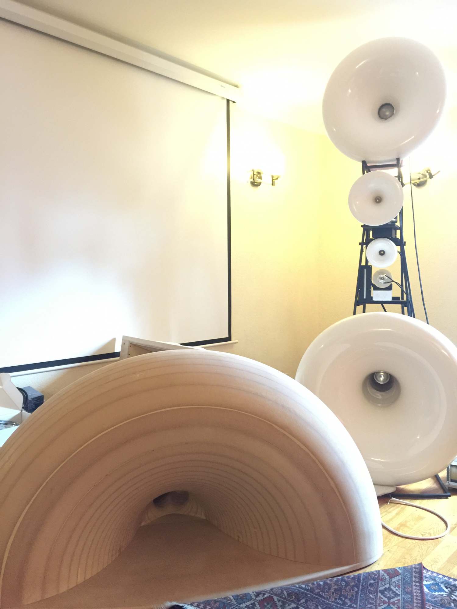

No, for this range I'm going to use 146LD. They are truly unique drivers and they deliver fantastic bass! I never ever heard so many details in bass. For orchestra and piano it is quite important.400hz JMLC is not appropiate for using down to 400hz. It can be done, but it wont be horn loading around there...
Also Supravox, is it the 480-2000? If so you would be better off using it from at least 80hz as it flattens out and responds nicely from there. Between 70-80hz to 500-600hz you can have good sound with a proper horn. It covers those 3 octaves nicely. To do this and horn load it properly, you need at least a 60hz cf horn, which would be too big and would be hard to align physically if round tractrix or JMLC... Maybe you can use these plans with your supravox drivers. (model them and have a rough idea before doing it) JBL 2240 60hz midbass horn - The Paper Horn by Inlow Sound.
Today I've measured and listened the result of 146LD in my half 2m LeCleach horn and get exactly what I've expected 70-400hz!
This is doesn't work for me. I've tried GOTO SG-505TT in 270Hz and decided that I don't like long horns. I hear coloration from second octave up. Shorter horn is better. So, now I'm using 400hz LeCleach for 400-1200hz.From above this, you can have a 200hz tractrix horn and your GOTO SG-570BL to cover from 500hz up to roughly 4000hz. I see you can have this built out of wood too.
I have 2 and ordered another 2, but than suspended my order. Now I want to be sure that they work well when TimeAligned. If not TimeAligned, I hear huge delay in bass. So now I'm using Supravox 400-2000EXC for 20-70hz. And I don't understand how I have 20hz from it, but I have it!Below 70-80hz, tapped horn will satisfy you. If you want to have less room modes in your room. Go crazy (as you already seem to be ) and build two tapped horns for your room.
TH sounds heavy and too slow...may be I'll try my 5m horn again, but when I'll be ready to timealign with second DAC delay.
After all experiments, I'm fan of LeCleach short horns, so inlowsound 60hz and 200hz horn with 1" throat sounds terrible for meSo you can cover; (these are rough estimations, not your precise xo points)

Well, to be honest, I can't see the necessity of 6 ways. And to add to that, the horn in the bass doesn't really add up to what's needed, infact you lose a lot of potential in the xo, especally if you want to go passive. You can save at least 2 ways if you go partly acitve. Furthermore, you don't use the bandwidth of any of the drivers, so you are wasing potential. To use passive xo leaves much more performance out with 6 ways than you would with i.e. 4 ways because there's absolutely no necessity to use that much ways since every of the component is capable of covering at least 1 more octave without any compromise. Thus said, you could also go easily go for 4 or 3 ways with even better results. Except you are only out for the 'fame' of building a 6-way.
I will do that, after my trip.
Got a pair of 505TT, So GOTO community is growing...
Starting with 3 ways, extending up to 8...I'm now back to 6 and for me this is optimal configuration. To add one octave to each way I'll need longer horns!
But longer horn I have - more coloration I get in higher octaves. For example, I can use 3m long horn for 146LD and use it from 50hz up to 1000hz, but 1000hz from deep 3m tube is very specific sound Even 1000hz from quite short 270hz horn was not ok for me and I was trying to shortern my horn, so till now I was using 600hz horn for 600-1200hz and just yesterday decided to extend from 400hz to 1200hz. Horn become a little longer, but still ok. So, in this regard, I have no choice. I need to keep horns short to play 2 octaves. Also I'm using sharp low-pass filters (3rd order) to be sure that higher octaves will not come out and color sound of entire system.
From another point of view, you can consider my system as 4 ways with sub and supertweeter. When I get GOTO's 15" it will be completely GOTO's idea (5way) with supertweeter. Switching off RAAL will not change the sound dramatically...it is just a little better resolution in 10khz+ range.
But I agree, that in HF one driver is actually ok to cover 1200-20khz, because 1000hz horn is very short and I don't see any problem why not to cover the whole HF range. But GOTO is offering 2 drivers for this range and their response is flat in corresponding parts of this range, so there is no way to use only one.
Last week I've visited Lukasz from Autotech, who is producing horns for DIYers and auditioned his system. I liked it very much and it is just 3 ways, but very clever!
HF works in very short 1000-2000hz horn and MF in much shorter version of 270Hz, so as a result - no coloration at all. Very clear and open sound!
Bass implementaion is very interesting - transmission line!
And it looks fantastic! I think, that I'm going to implement some of his design ideas in my system

I'm still trying to TimeAlign the whole system without digital things to allow myself to connect vinyl one day. I'm not sure that I need it, but still want to try to keep it in this way if possible. I have one idea, will post later when have some drawings to share.
So, now it is 6 way:
1. 14k+ RAAL Lazy Ribbon 9"
2. 5k-14 GOTO SG-16TT
3. 1.2k-5k GOTO SG-370DX in 1000hz LeCleach
4. 450-1.2k GOTO SG-570BL in 400hz LeCleach
5. 70-450hz 2xGOTO SG-146LD in 120hz half LeCleach
6. 20-70hx Supravox 400-2000EXC
Top of the line HF GOTOs just arrived, so next experiment will be to replace 16 with 180 and 370 with 3880. Both with beryllium diaphragms!
