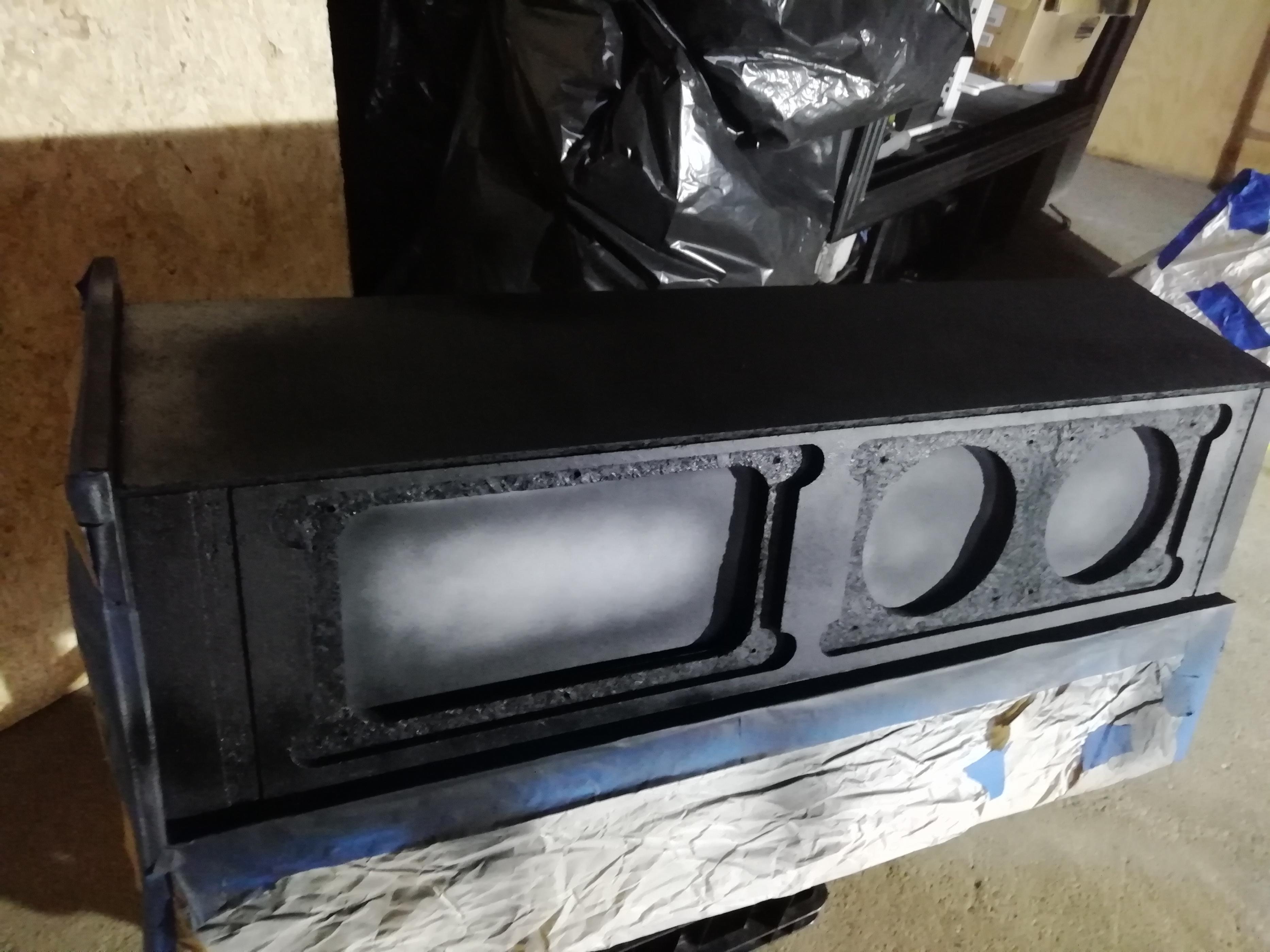

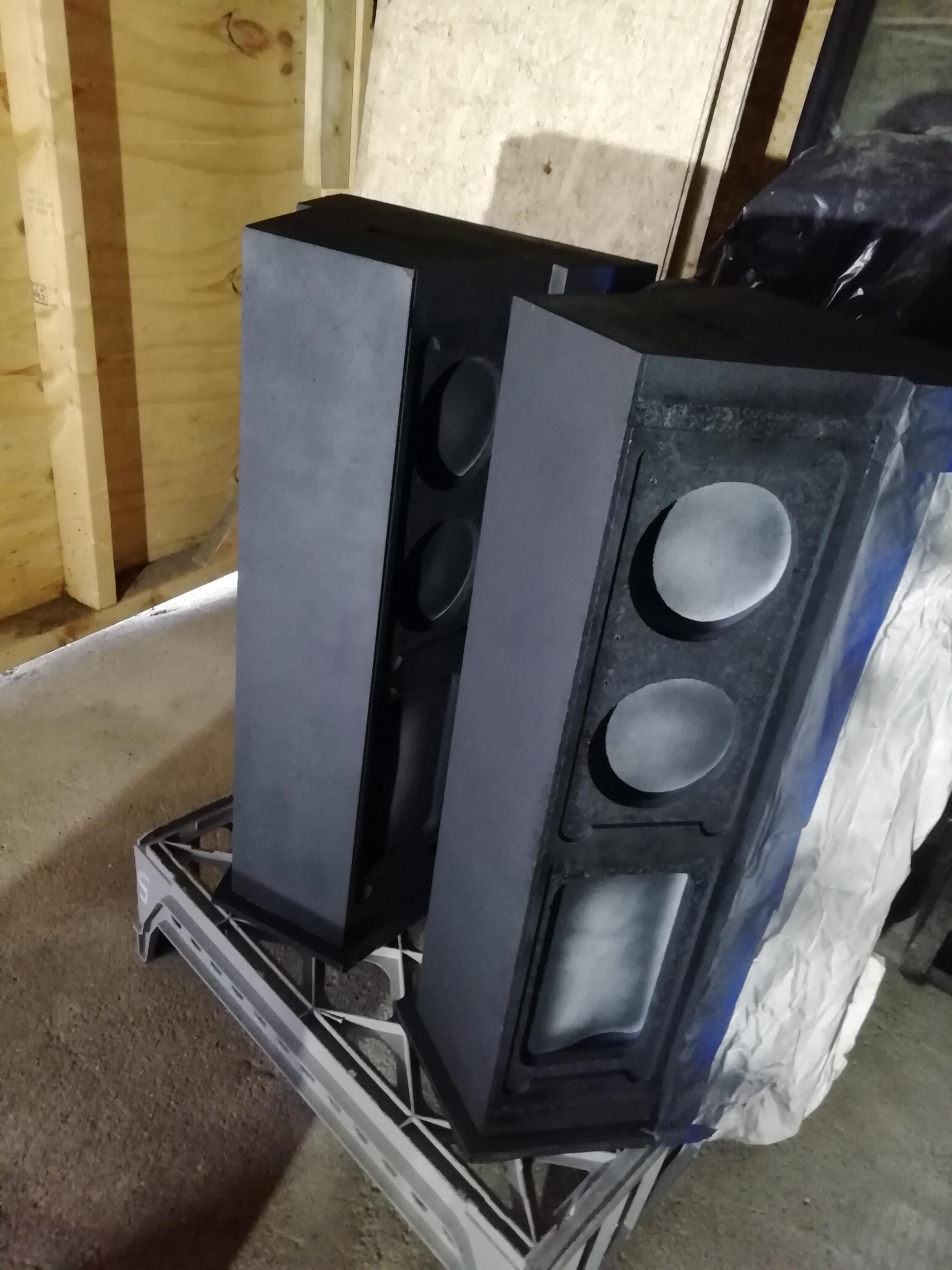

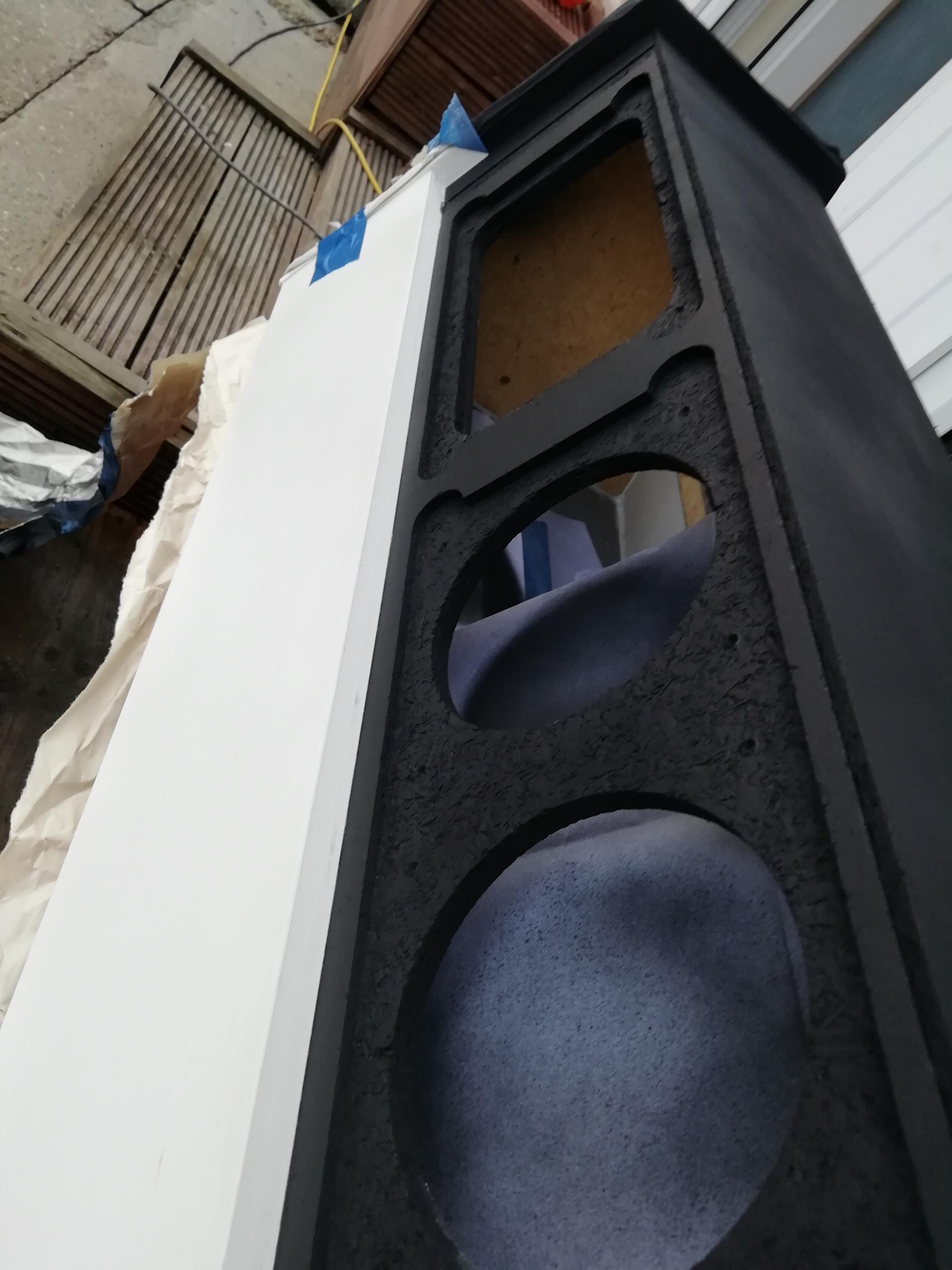

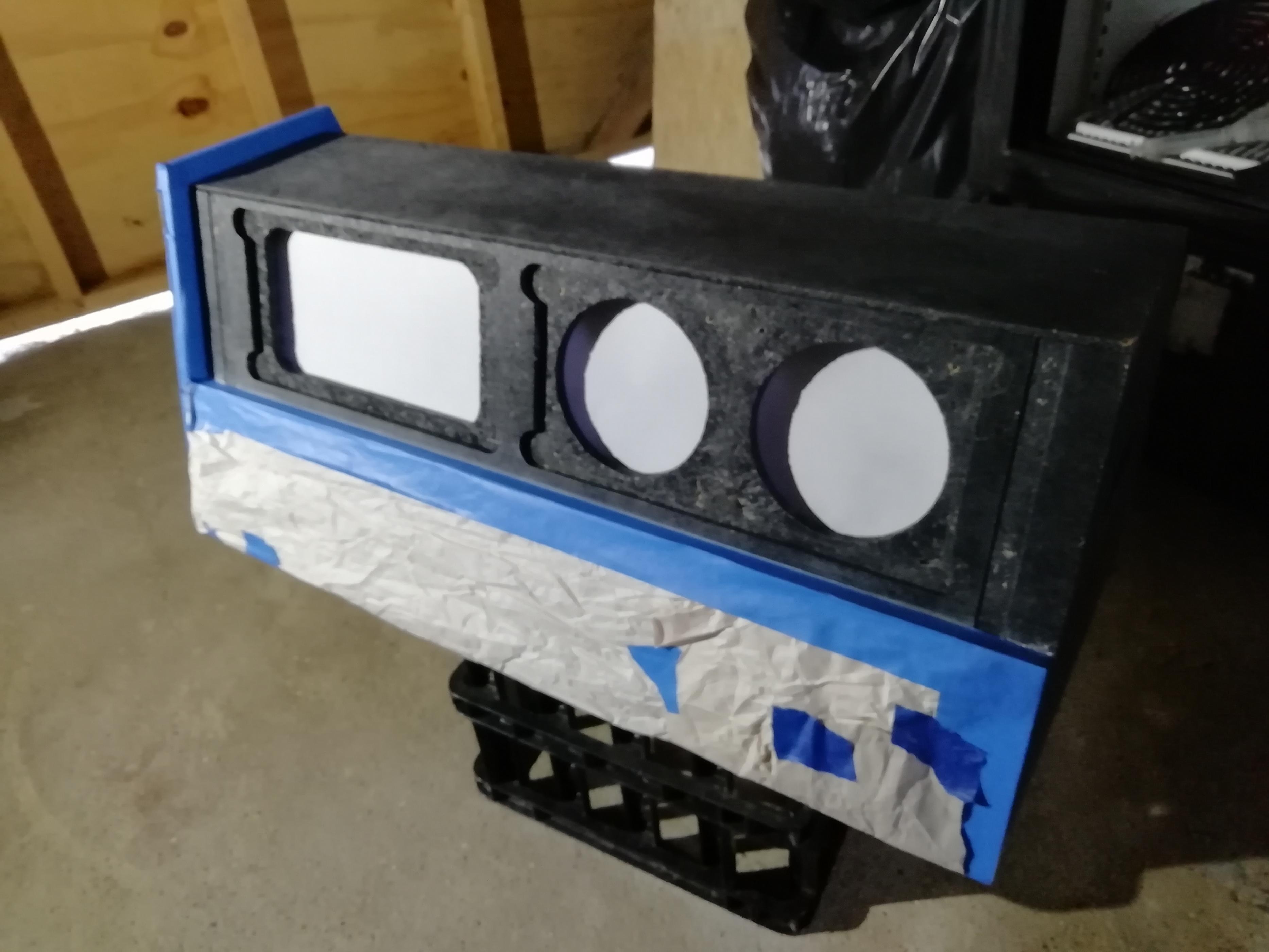

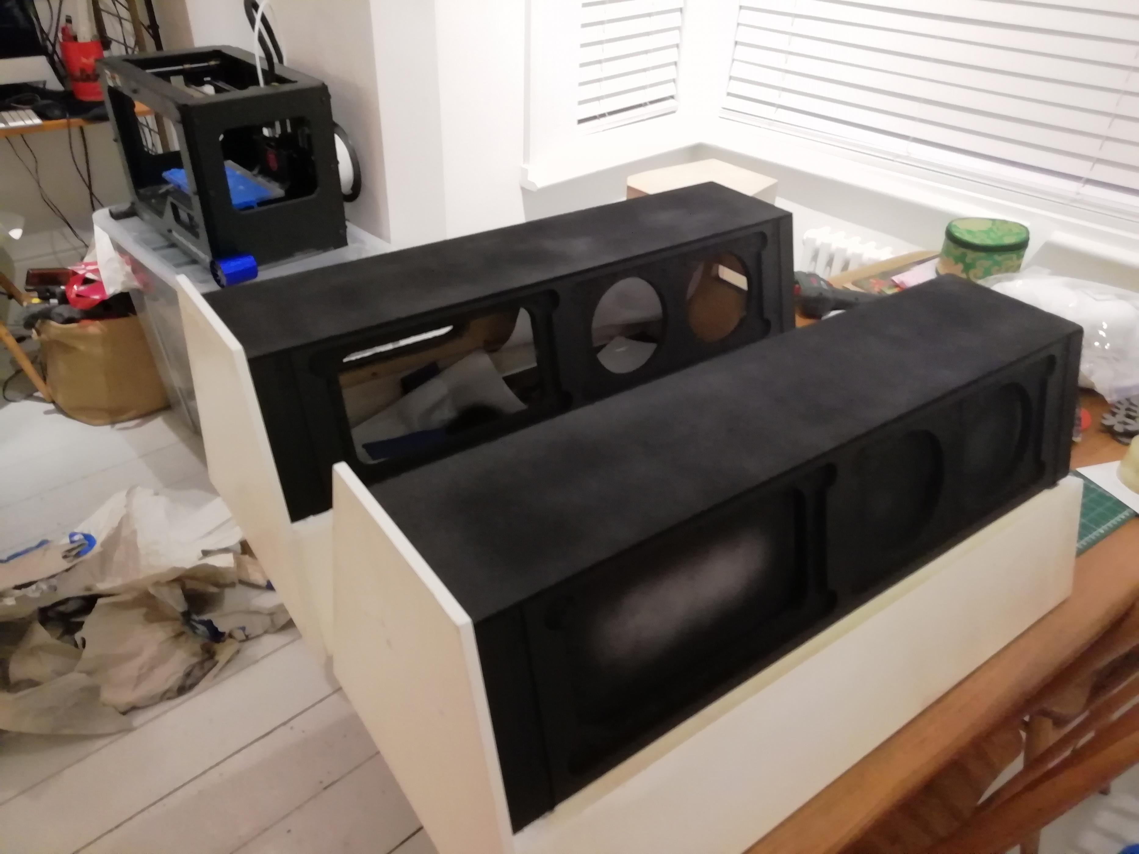

Excellent paintwork and neat wiring. You have been a busy bee!
P.S. Thanks to your extremely high resolution images, I can spot that a hair is stuck to the paint 103.5mm down and 28.5mm across from the top left hand corner in the final photograph!
Thanks all, still loads more to and the paint hasn't completely dried, nightmare to work on but had to be done while I have some limited free time.
The enclosures still need light sand, the edges all tidied up and its pretty much done.
Next is to double check the wiring, check the impedance, make sure nothing is shorting etc.
I'll send some test tones though check for any air leaks and generally get them ready to play some tuuunneeessss.
It's really time consuming and I was hoping to have these done by the new year, no such luck.

No captions on the photos, but it looks like you are doing a comparison between the old plywood base and the new MDF base. Am I correct?
Hey Galu, no time to write captions! Didn't get time to do the MDF bases so had to use original base, i resprayed them and made them look nice so i can at least test and use the speaker once they are finished.

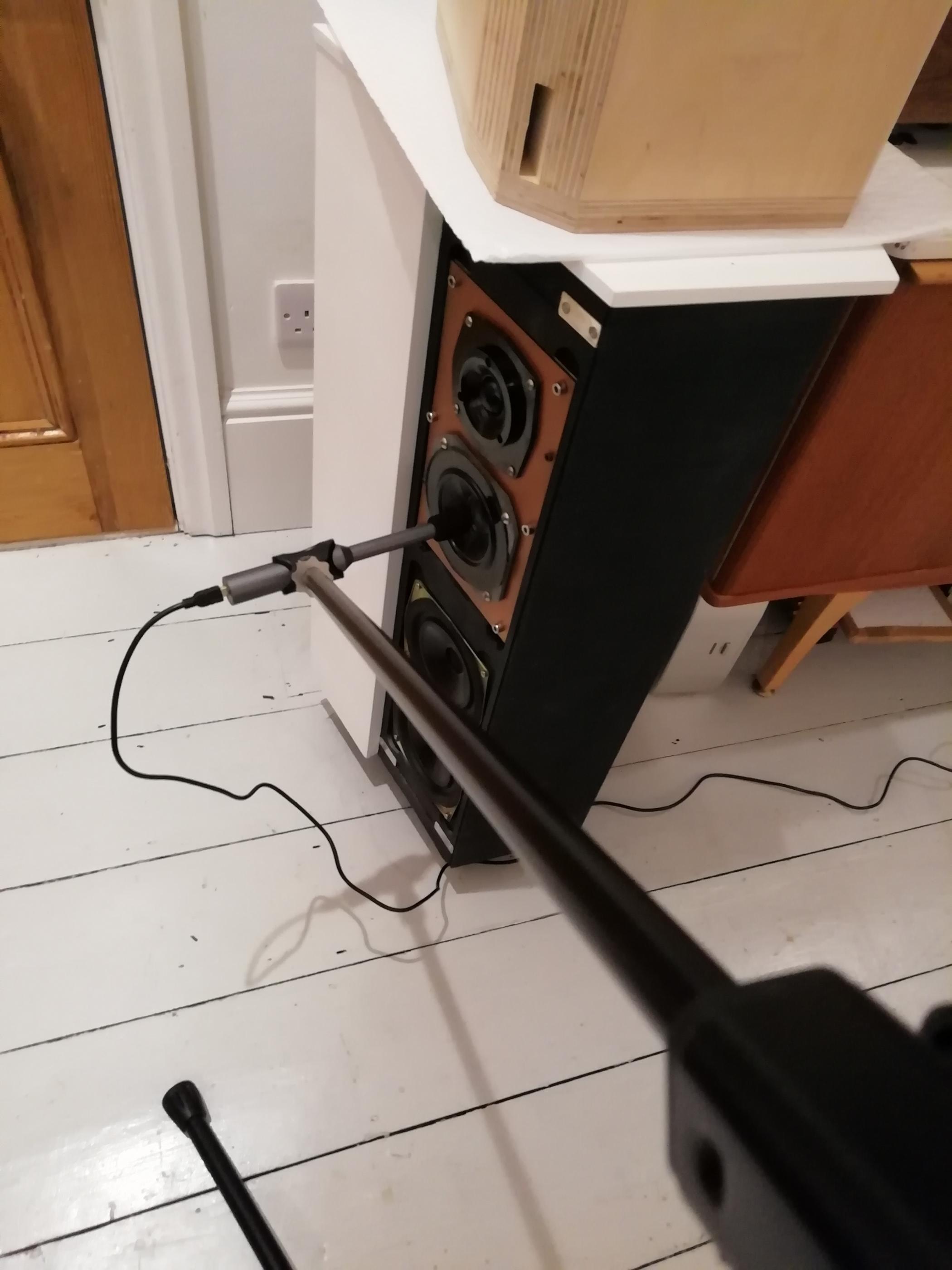

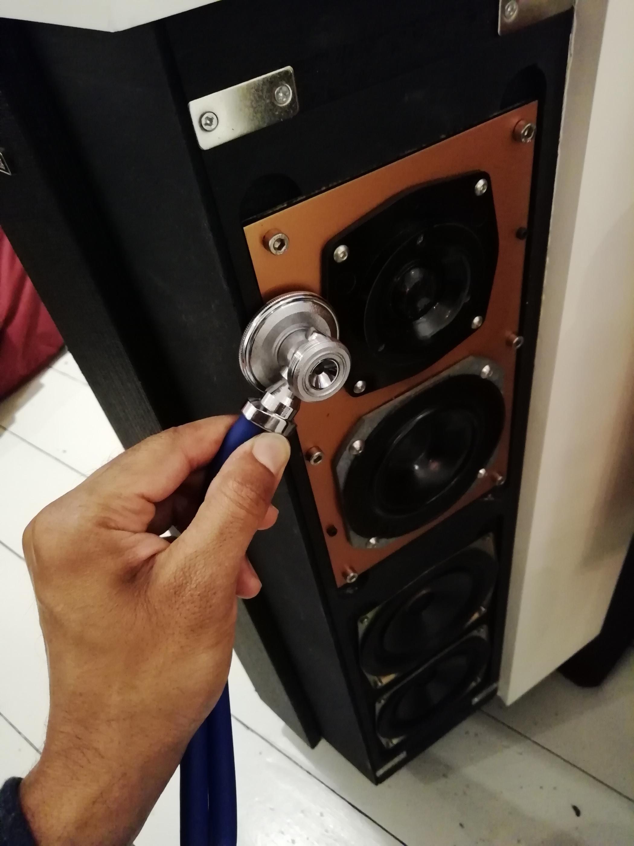

Today was about checking for air leaks and vibrations within the enclosure and some REW measurements.
Around 40 - 60 hertz there was a distinct sound of air escaping, using my trusty stethoscope I was able to locate it, the pods that house the mids and tweets need a little more work, some of the internal cabling need to be covered with sponge surround to just incase they tend to move or vibrate with the pressure from the bass drivers.
I also managed to add magnetic plates and holders for the grills which is so much easier and nicer, before they used a plastic type velcro clip.
Aside from that it's almost done, just the little things to do that will make them perfect I hope.
Once that's done finishing the second speaker will be a breeze as I know what to do and look out for.
I'll get some REW results up soon
A stethoscope? Now I know how you've been able to doctor these speakers back to health!Around 40 - 60 hertz there was a distinct sound of air escaping, using my trusty stethoscope I was able to locate it . . . finishing the second speaker will be a breeze.
A breeze? I hope there's not going to be that much air escaping from the second cabinet!
Nice touch re the magnetic fasteners. I await the REW results with interest. 🙂
Hahaha the stethoscope is a really good tool to use, when rebuilding or making speakers you're able to hear and locate issues or problems within the build, I remember reading it as a tip in one of my speaker building books.
Second cabinet is solid, it's just when replacing the speakers and the pods I have to make sure the foam seal covers every gap and screw hole, it has to be a tight seal.

A stethoscope?
Everybody who builds speakers should have a mechanics stethescope. In a pinch a doctors one like Vishalk’s will work. Makes quick work of detecting cabinet resonances.
