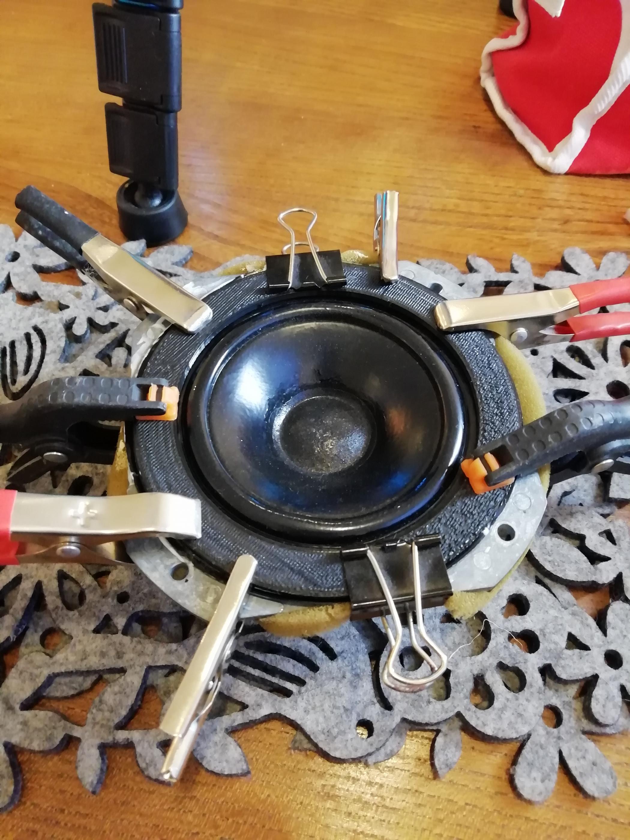

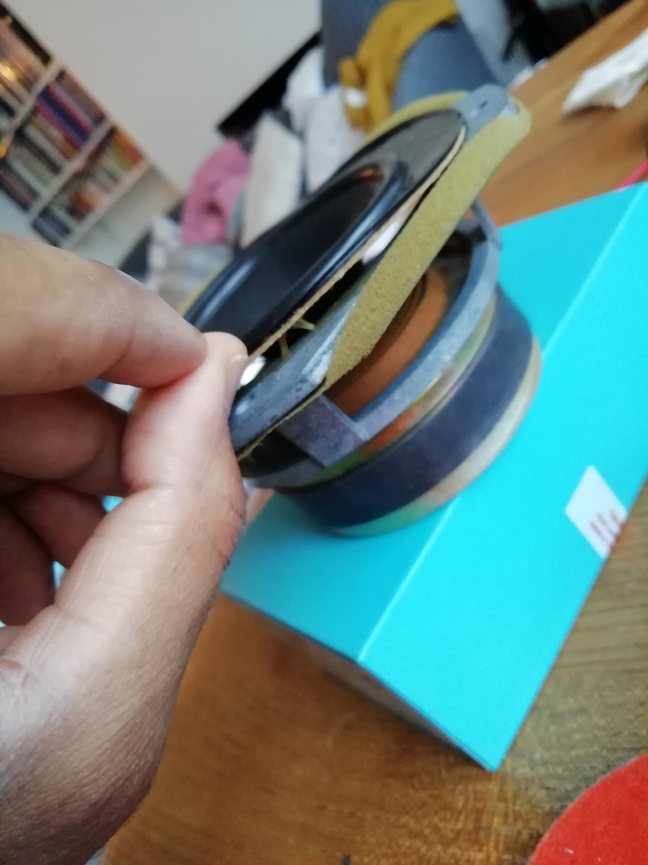

Using supplied cotten bud end tooth picks to lift and locate weak areas on surround, then I use a syringe filled with glue to force the glue into the area. Works really well.

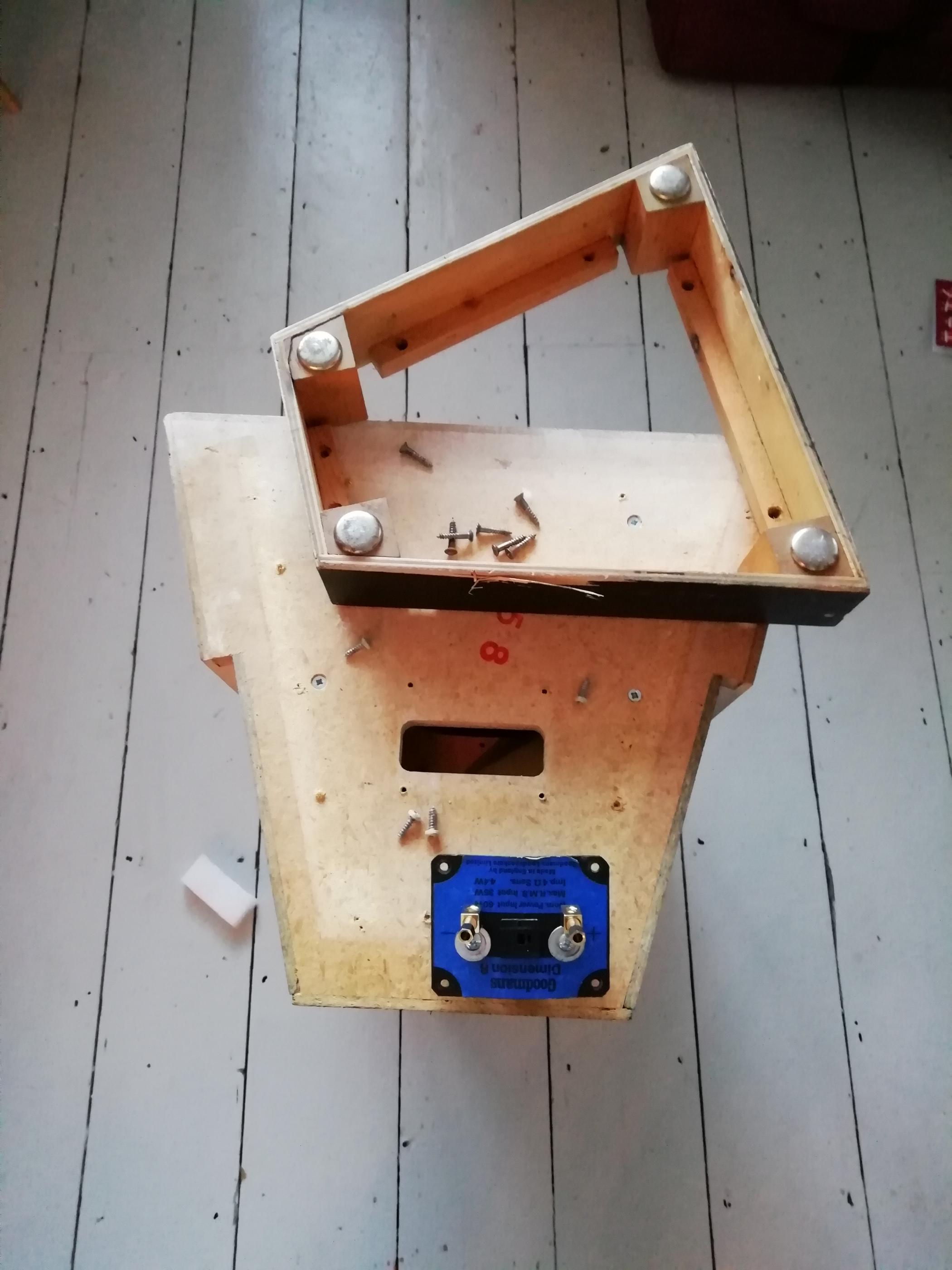

Stripping boxes down, the bottom base could be better, thinking im just going to get these remade in thicker MDF and attach speaker spikes instead.

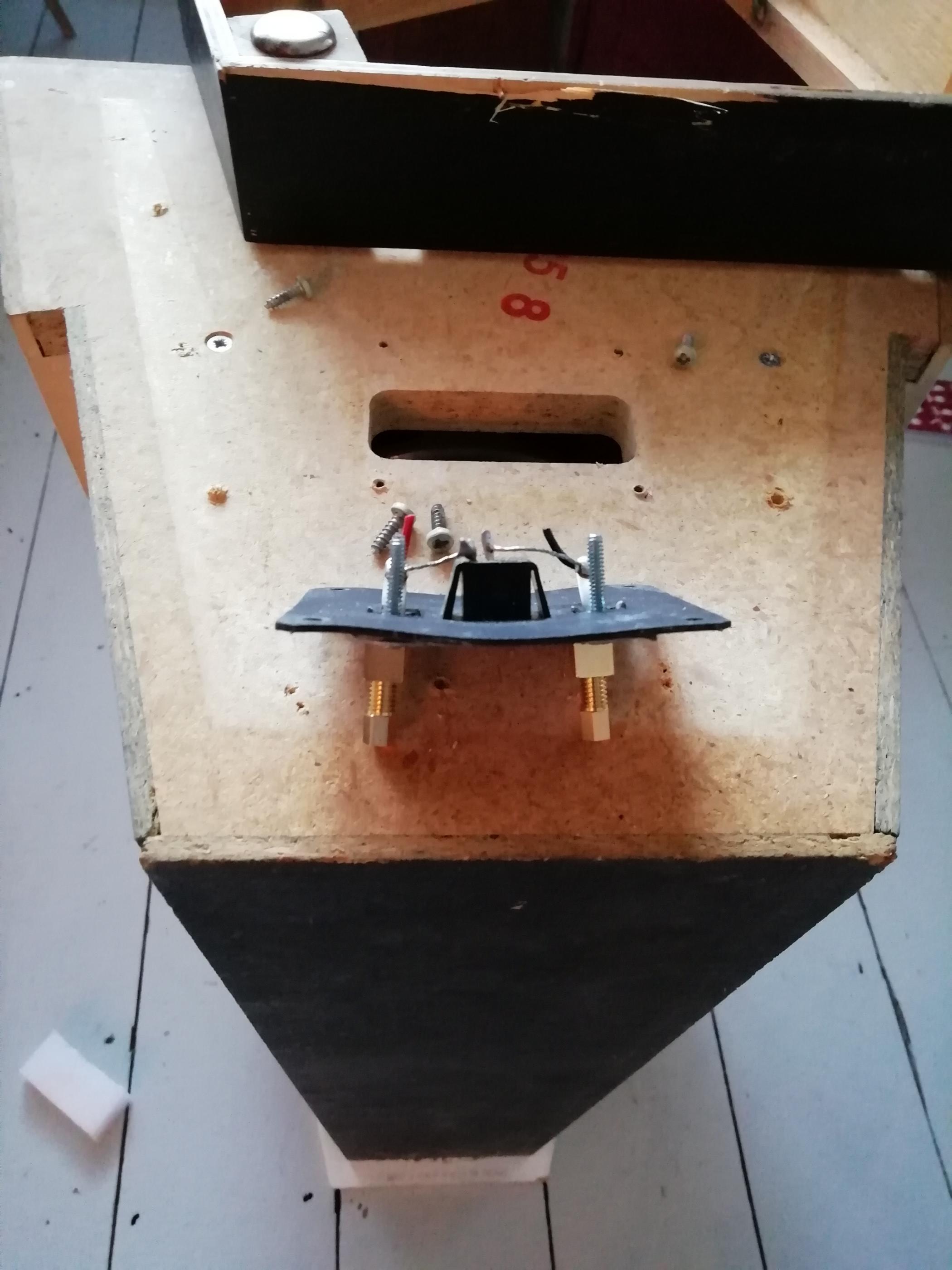

The old speaker connector have to go, warped and just allows air to leak from them.
A more solid plinth would do no harm!
Which glue/glue kit did you use on the surrounds?
Application by syringe is ideal for this purpose.

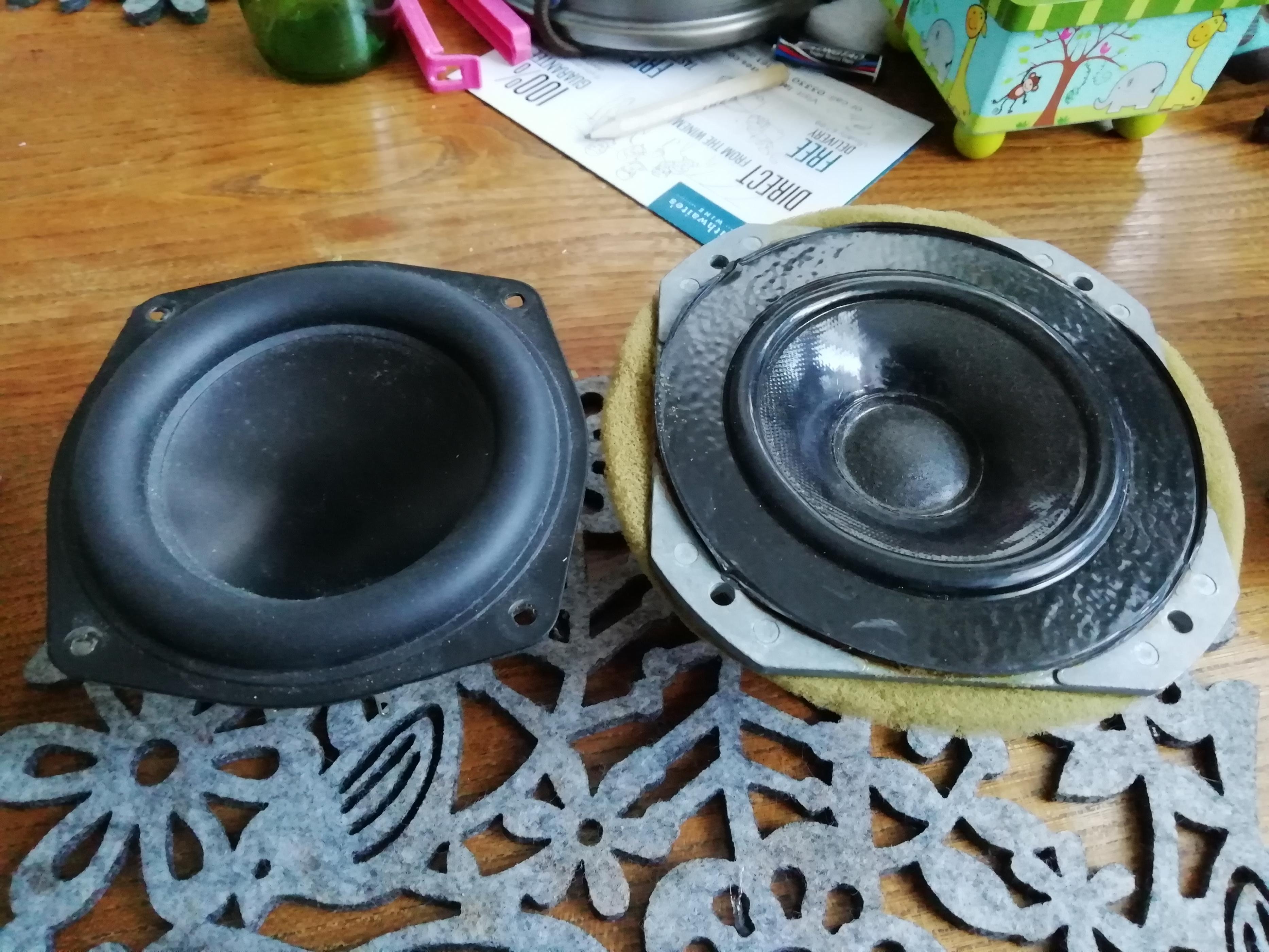

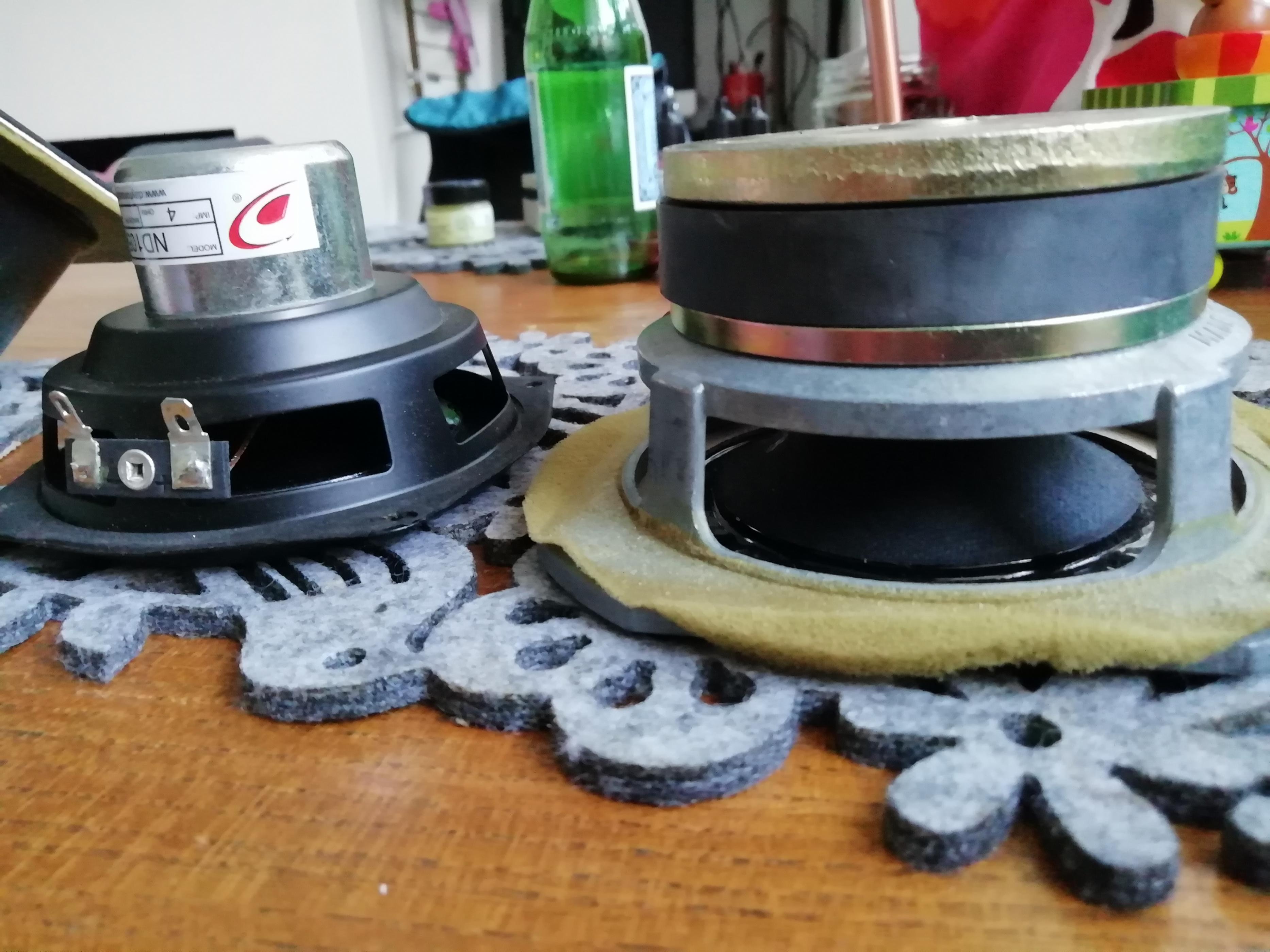

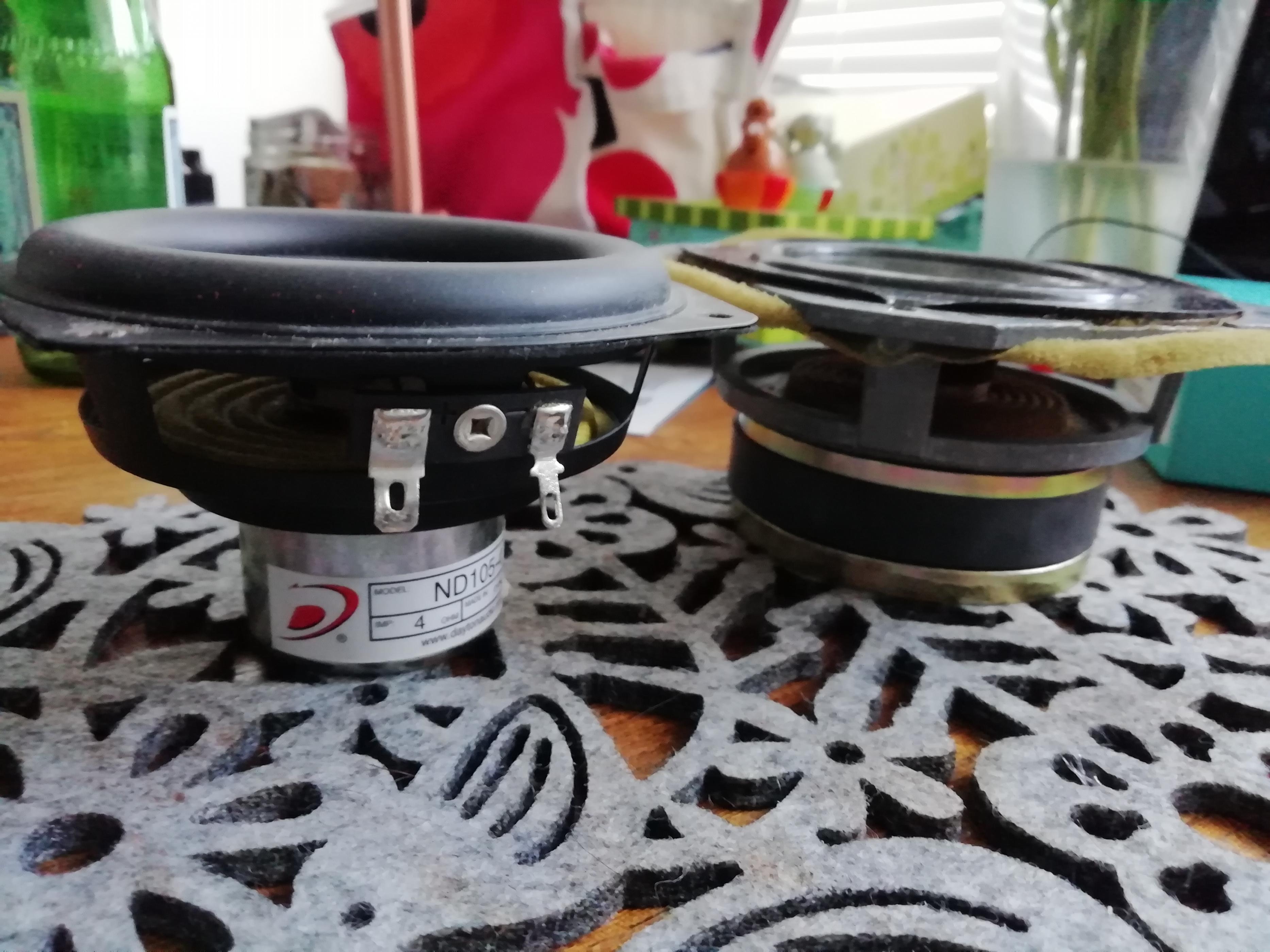

Comparing drivers, the goodmans is a cast chassis a real heavy weight, where as the dayton is pressed steel, light and cheap.

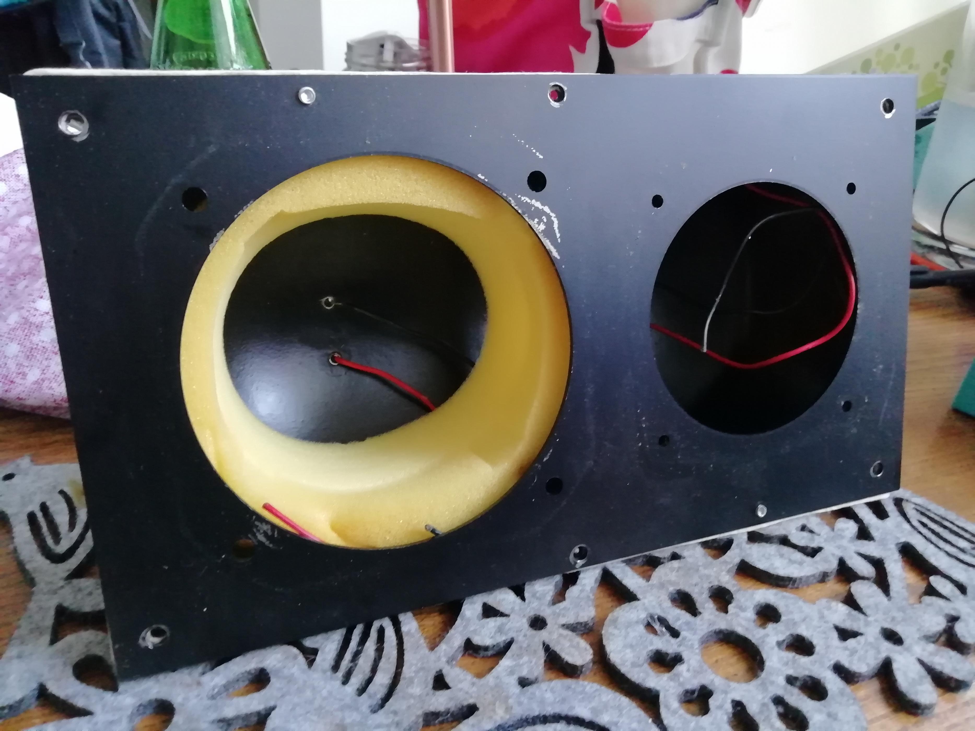

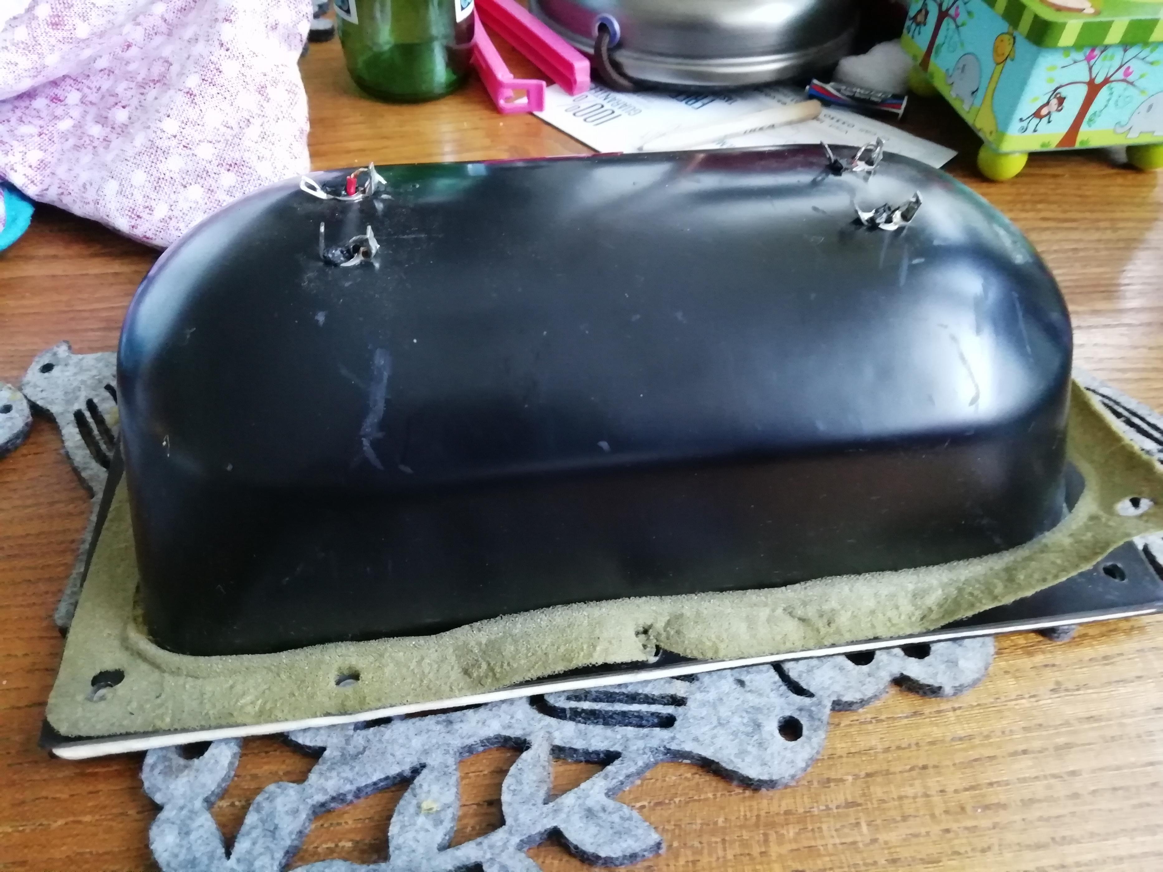

Enclosure for midrange and tweeter. Front panel is metal where as the enclosure is plastic, a foam ring acts as speaker wadding.
The plastic itself is thin and flexible, here I will use sound deadening material so it's more dense and less of a hollow feeling, think I may also pack it proper wadding instead of the foam ring.
I understand that the Dayton DATS V2 is a speaker measurement system, but where do the Dayton drivers come in? I presume you are just picturing them for comparison purposes?
Replacing the tired, old foam rings (gaskets) is a good idea, as is damping the walls of the plastic enclosure. Dedshete self-adhesive bitumen damping panels would be good for the latter purpose and foam sealing tape for the former.

Would still like to know which glue you used on the speaker surrounds.

Just comparing the drivers old vs modern,
One bottle 30ml genuine TANNOY correct speaker fixing glue, speaker repairs | eBay
Is what I used.

The Tannoy glue looks good. For reference, I've used 'Anita's Tacky PVA Glue' with good results.

I suggest damping the vibrations of the plastic midrange enclosure by applying strips of Dedshete to the outside of the enclosure.
I presume the mid enclosure contained absorbent material - was it the foam you mentioned earlier?

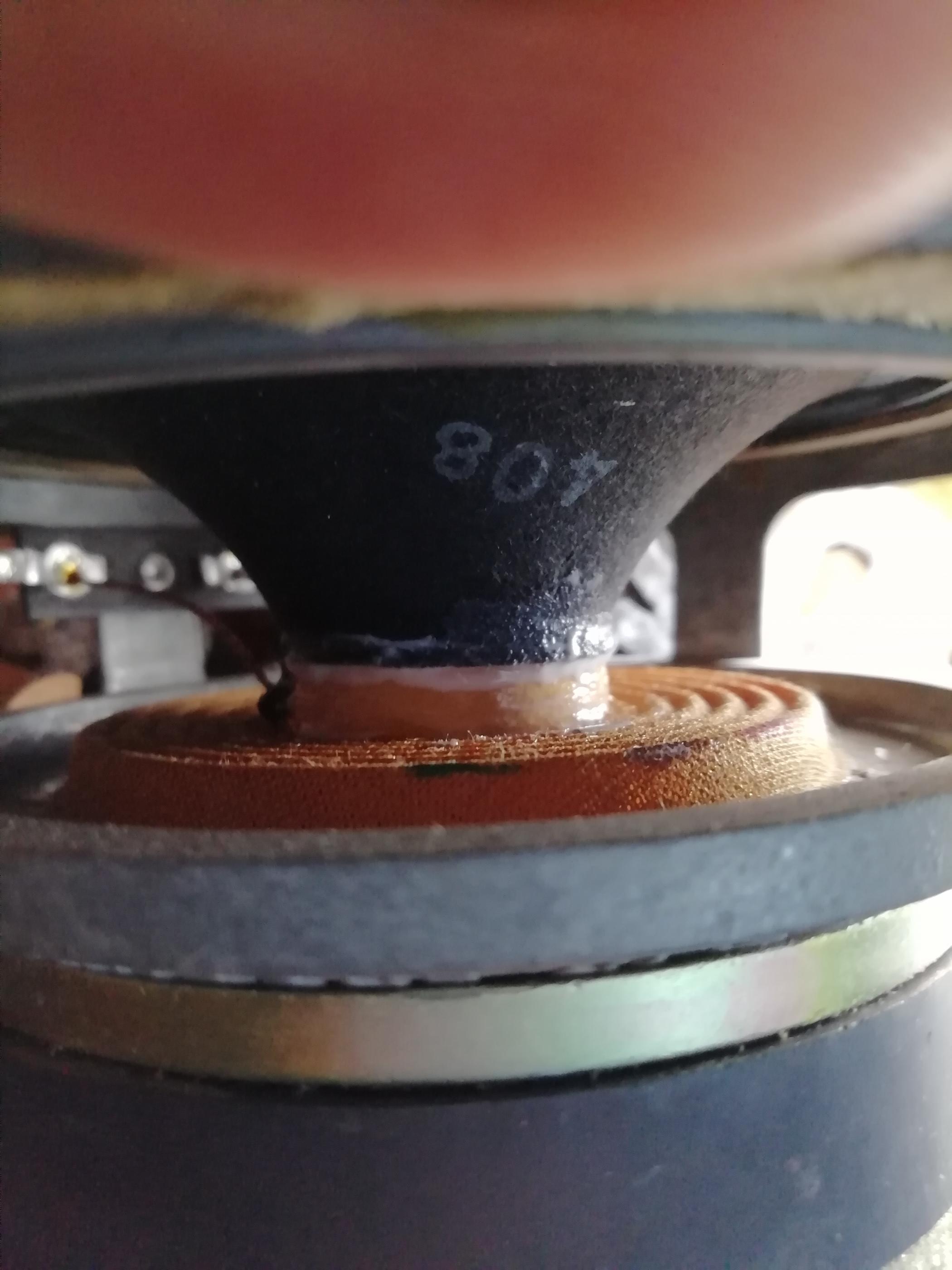

Midrange repair
View attachment InShot_20181208_203132294.mp4
Here you can see where the glue has come away and the voice coil is slipping through the cone which was noted in the spikes measured on the dayton dat, moved the cone up glued in the space then used a cotton bud to spread the glue over the cone and coil. Left to dry, good as new!
That was my plan, i have this stuff on hand:
Silent Coat 2mm 30 Sheets Pack Car Van Deadening Sound Proofing Damping Mat 702795788247 | eBay
Yes it was a foam ring which fits over the midrange, i will just remove it and fill the midrange bath shape case with some acoustic wool type material
There's a possibility that the closely coupled foam ring is intended to damp the vibration of the midrange cone rather than to act like sound absorbent.Yes it was a foam ring which fits over the midrange. . .
Such damping can be used to lower the Q of a driver and allow it to be used in a smaller enclosure.
Some experimentation should reveal whether or not this applies in your case.
One speaker I will leave original the other I will sound deaden and use different speaker wadding. I will use REW and do some tests see which one performs and sounds better.
