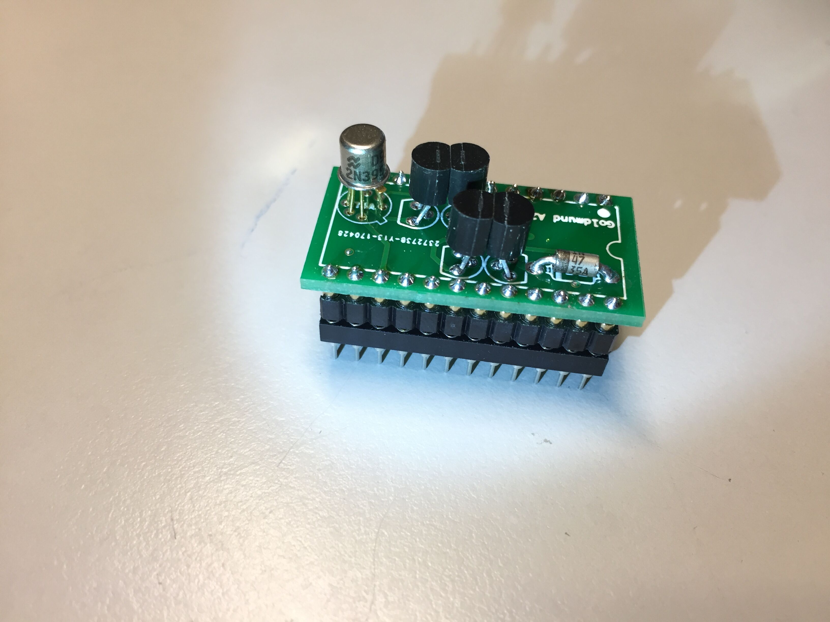

If you're making a clone then that's a reason to have all those pins and sockets and a separate module.
But if the aim is to make the best possible sound quality then the shortest copper track and least brass (pins) and least possible solder joints, etc, in the signal path makes an audible improvement.
I've done it many times over the last two decades, reducing the signal path for sonic improvement.
Just missing out 10mm of thin track and two solder joints has been audible. Simply taking a feedback resistor off a circuit board, where is may be near to an op-amp, and soldering it direct to the op-amp pins under the board usually gives an audible improvement. Assuming the system and environment (free from extraneous noise) is sufficiently revealing.
Thank you, sir. Valuable suggestions.

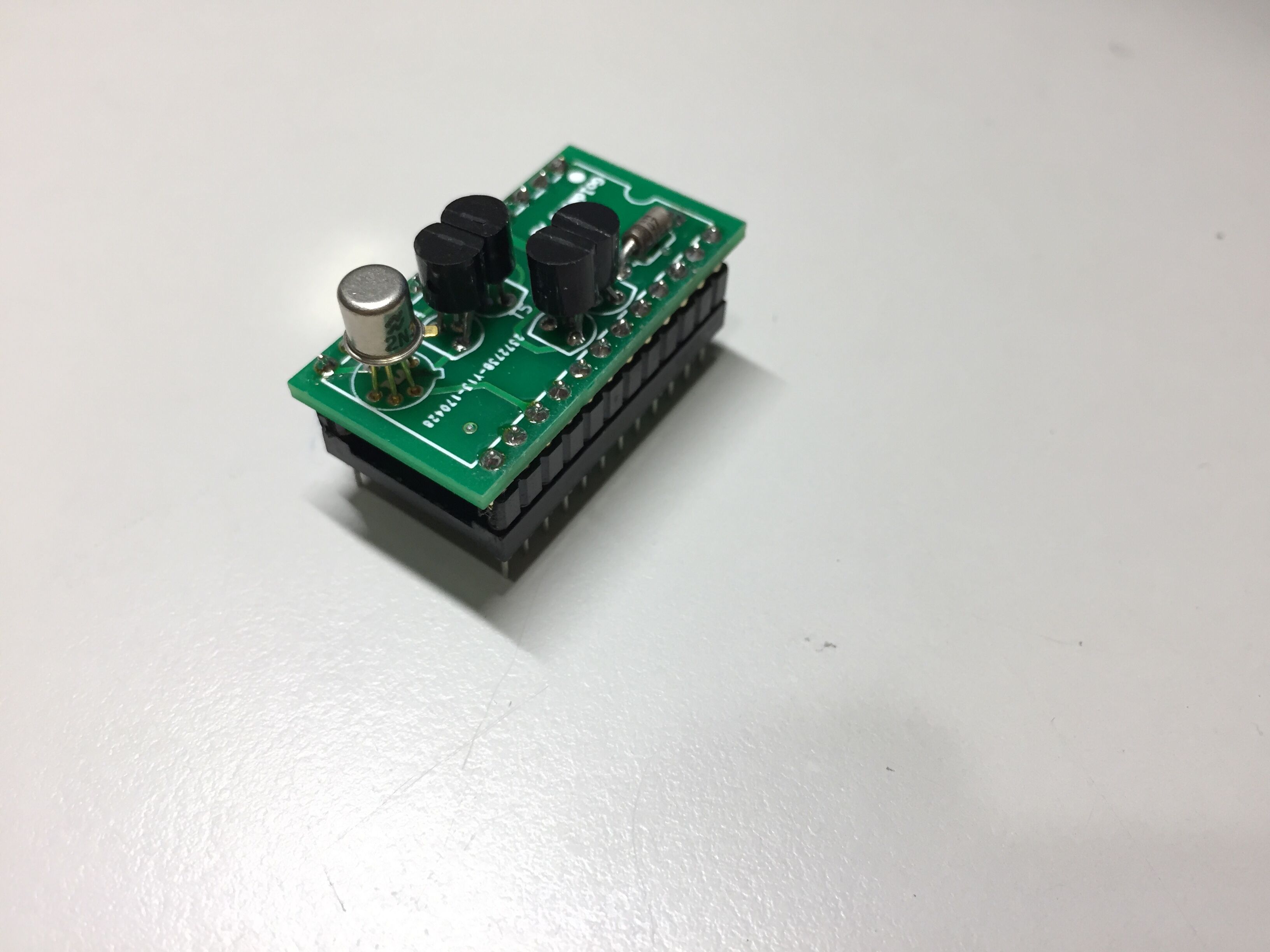

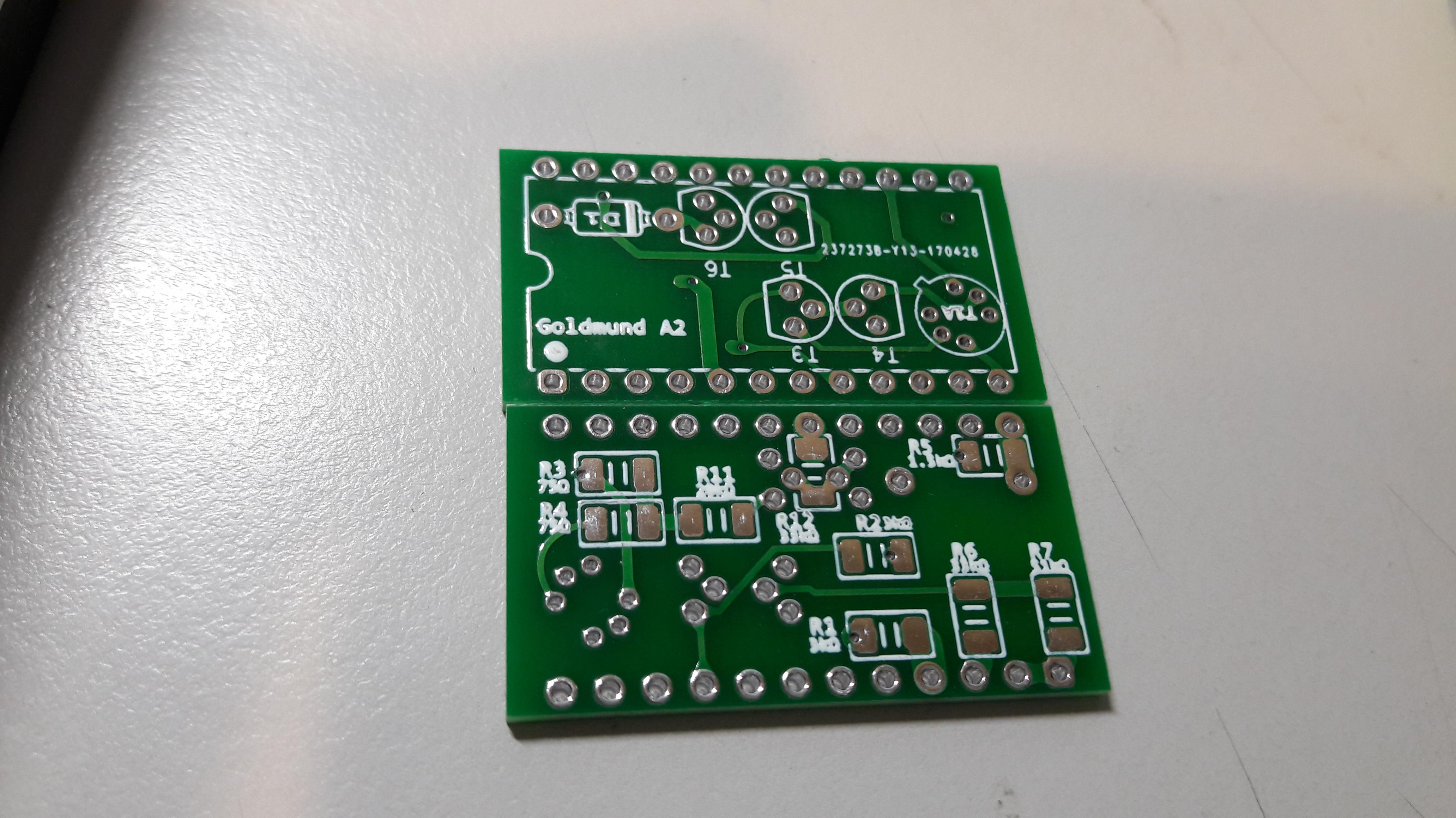

I have an idea: make everything possible. That is, the user can use a interchangeable module, or--- directly solder parts on board!
The layouts are the same, whether on the main board or a module PCB.
Let user decides! I can do this technically.
So, if the user wants the shortest path, solder parts on main board, leaving the socket alone.
If the user, like me, wants to try different module for sonic tastes, then just solder the DIP-24 socket, and make some module boards!
Will they be complete boards or just the board to make the IPS neat? I would be interested in purchasing some as I have all the parts in my closet as is.
That's all possible, I haven't decided yet. 2N5564 is hard to get, and I don't have stock. (well, I just have 2 2N5564 for the future program.).
Empty PCBs are available, surely. I've made 10 boards, and gonna send 4 to the US, so 6 remained.
for that reason I have used 2SK170 with operating current of about 70% of IDss in my Goldmund clone....

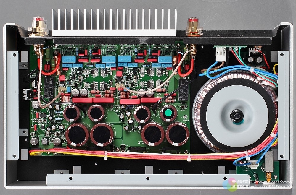

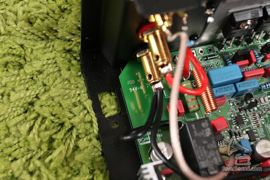

Hi all,
Recently I noticed a product called STA200 by Nuprime.
It uses Goldmund's topology, 80W+80W.
The inner looks just like Telos 390.5 or Job 225!
The IPS uses LSK389, SOIC-8. Output transistors are 2 pairs of EXICON MOSFET, TO-247.
And it sells for a very good price!
Indeed. So our goal is to make it better and more fun!

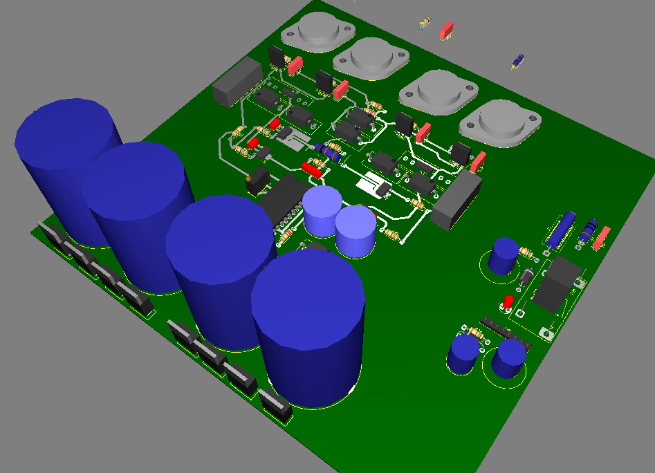

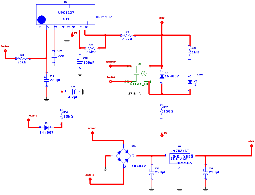

Hi all,

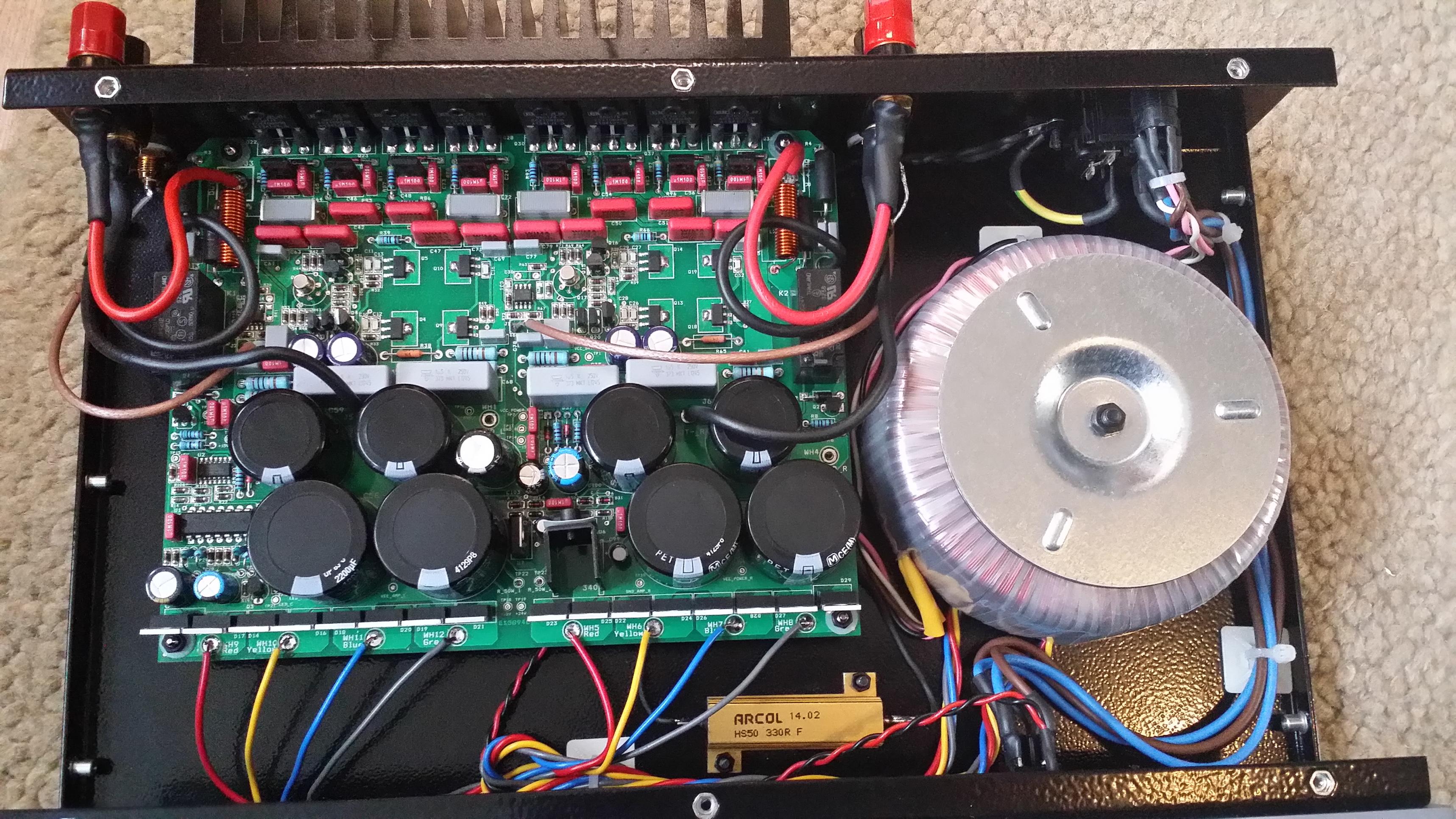

Working on this unnamed project. It looks like Telos 390.5, but uses TO-3 MOSFET and interchangeable module.
Also, a uPC1237-based protection module is integrated.
My plan is to make a stereo all-in-one board.
Any suggestions?
Any suggestions?

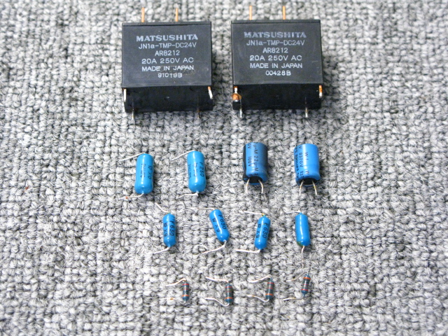

Eric: The Goldmund input boards you sent me are finally done and working perfectly. I
was able to find the correct parts online and the Goldmund Mimesis 3 is working again.
Thank You for your help and patience.
To all Diyaudio members, Eric is the man to contact if you need to fix your broken
Goldmund Amp and need the input boards to do it.
Richard Kern
Richard Kern
Richard Kern
Thank you Richard. I've also finished my own modules. Looks great.
