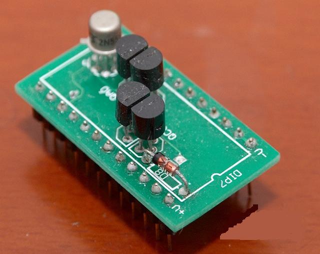

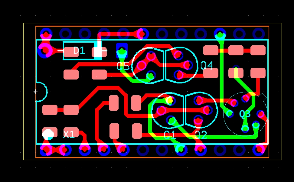

Hi all,
Some progress here. A friend who owns a genuine Goldmund sent me something about module pin definition. I redraw the PCB, very similar to the original one.
2N5564+MPSA42*4+SMD parts, DIP-24
Eric

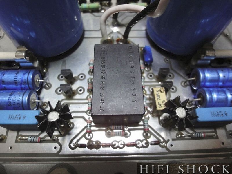

schematics
Bottom middle - is this the PSU, soft start, DC protect/sense boards?
I am guessing that the schematic is a dual voltage power supply?
Does the soft start have a 12v trigger for on/off?
Who is a good source for these boards and is there a brew your own template available?
I have a few of the 2N5564 parts. Purchased from NJSEMI who god knows where they get them from and the quality. I purchased some mpsa92s when I was there just to get them and the numbers after testing was all over the place. they bragged about selling Boss the jfets for the stomp boxes and well stomp boxes aren't exactly the same as an IPS. I believe LSK389 may actually be a replacement.
YES
YES, another MAINS-12/24V on-board transformer is needed,
I am not sure if I am allowed to post the commercial source publicly here.
Personally, I do not have plan on doing this by myself. It's for Telos600-5000, complicated and massive-sized PSU.
Though, I am planning to make a PSU-AMP combined PCB, rectifier-filters-amplifier-protection on one single board, with exchangeable input stage modules/sockets.

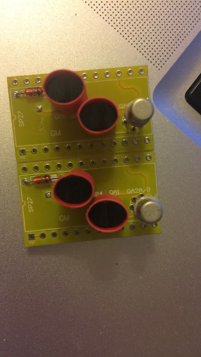

Some progress here. Thanks to Mr. Kern for kind help.
The A2 module has been submitted to manufacturer, it's a phase-1 plan. I will make a amp board with sockets. The module is fully compatible with genuine Goldmund, as Mr. Kern owns a genuine one, then share the pin definition with me.
Also, get some more teardown photos, check out the updated WIKI.

When will the boards be ready? Instead of the speced JFET, can lsk489 be used? Actually lsk389 is probably closer to the original specs but has a little more capacitance that needs to be played with and also cant handle the same amount of voltage as the 489.
If you're making a clone then that's a reason to have all those pins and sockets and a separate module.
But if the aim is to make the best possible sound quality then the shortest copper track and least brass (pins) and least possible solder joints, etc, in the signal path makes an audible improvement.
I've done it many times over the last two decades, reducing the signal path for sonic improvement.
Just missing out 10mm of thin track and two solder joints has been audible. Simply taking a feedback resistor off a circuit board, where is may be near to an op-amp, and soldering it direct to the op-amp pins under the board usually gives an audible improvement. Assuming the system and environment (free from extraneous noise) is sufficiently revealing. 🙂
