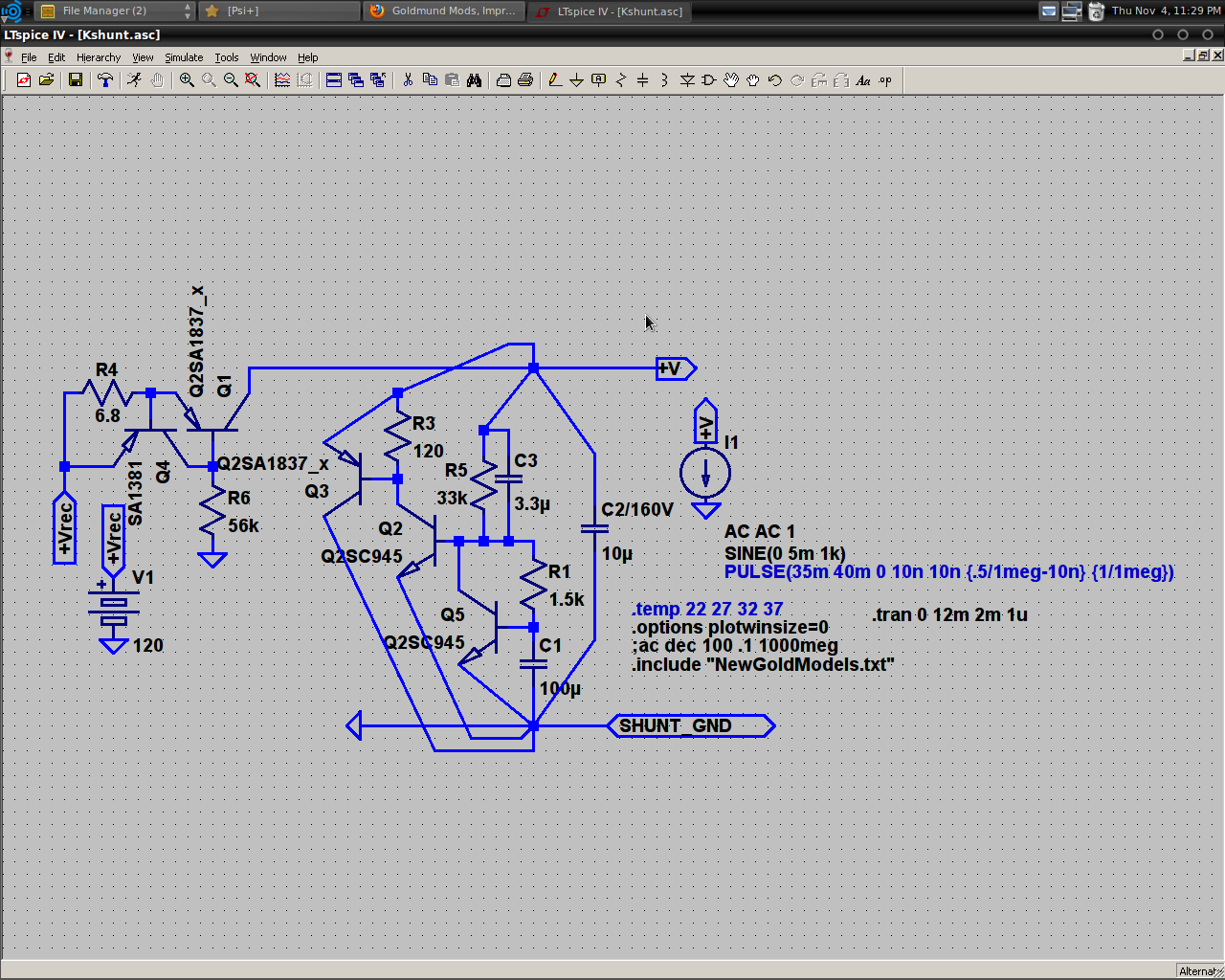

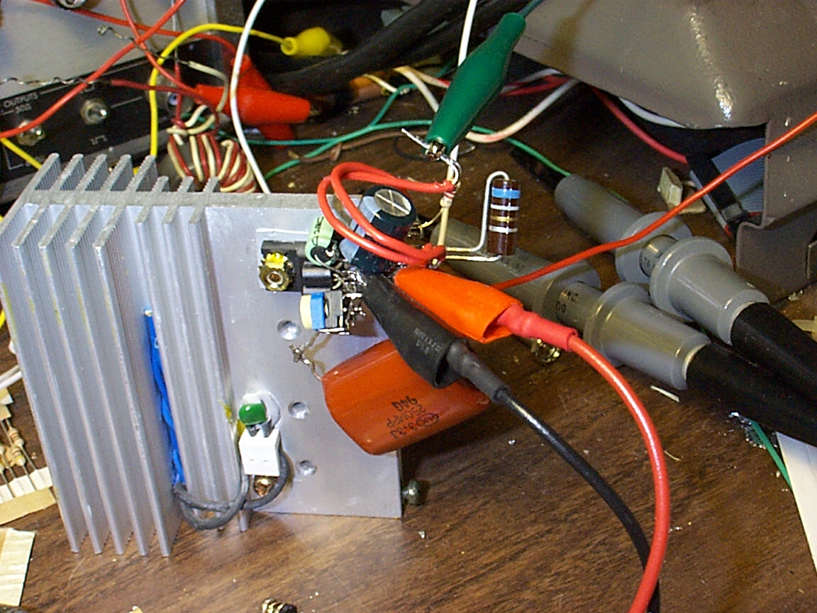

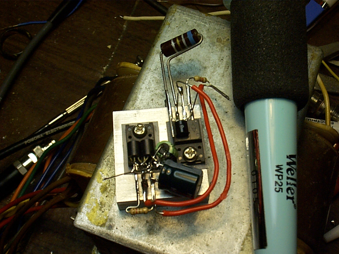

Here is some pics of how I laid it out. The only long wires are the CCS collector (Q1) and the negative power wire. I stacked the TO92's face down on the TO126's (the TO92 2SC945's have ECB pinout, which is convenient this way). Q4 can be any TO92, hopefully not something preposterous (this one had EBC pinout). At 90V Q2 should be a TO126, and should be Vbe matched with Q5. (referring to the schematic in post 816).
To adjust:
Set R5 to 10k. Adjust R1 for lowest tempco, or lowest difference between idle and startup voltages. Then increase R5 to the desired output voltage.
Salas, can you elaborate on how to choose and adjust the Jfet version?
My meter shows 4.997V, with the 5th place wandering. It has wandered +-50mV in the time I have observed it, excepting startup where it was several hundred mV higher. This means I should increase R1. I don't know how much of the wandering comes from CCS fluctuations, or from the 100uF cap doing weird things, or (quite possibly) the trimmer I'm using for R1. In any case, noise above 100Hz is below 10uV for the 5V version, and will I think be the same for the 90V version.
Noise increasing below 100Hz is predicted by the simulator, if this is due to CCS variations. I may try a MOSFET CCS to see if this is so. (at 100mA, Ib of Q1 is near 1mA, and Vce/Early effect will vary this greatly)
Attached is a schematic of how I would lay the design out optimally. If you are measuring output impedance or pulse response, measure from the top of C1 and the bottom of C3.

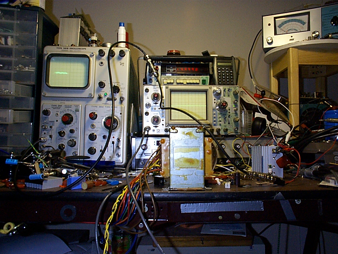

Here is a pic of the measuring rig (yes, I cleaned my bench. What a shame), just BNC coax and alligator clips.
The cable dips under the table on left and then up to the scope jack, which the camera didn't see very well.

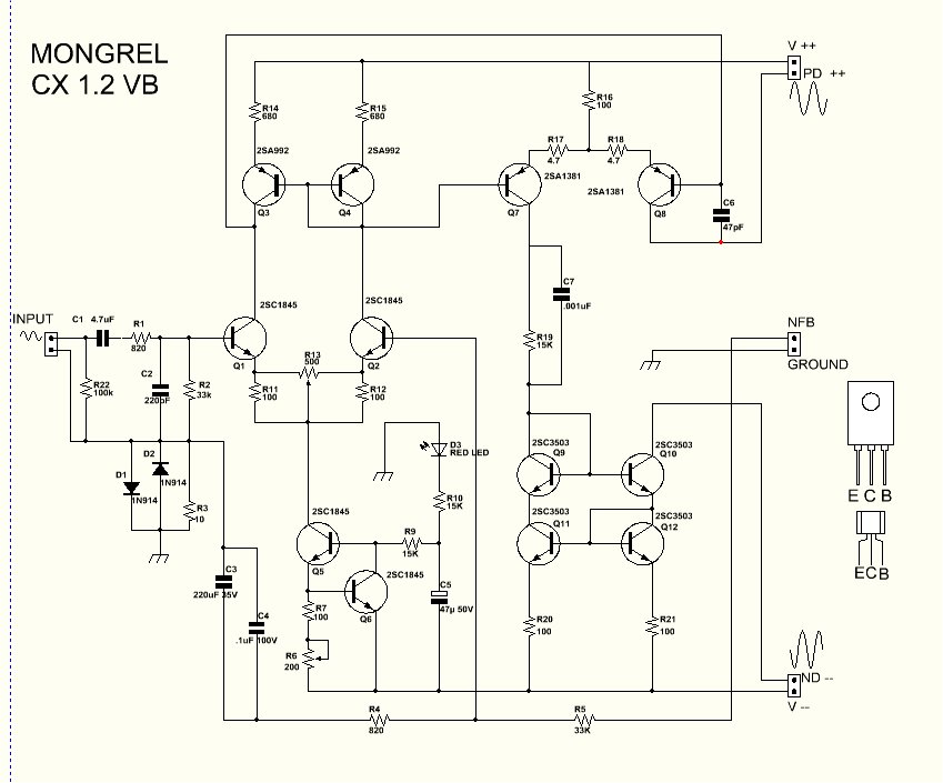

hey,guys.. I haven't been here for a while ... but , the basic circuit works really well. When the "blameless" meets "symasym" , you get a killer amp.. REALLY! (BELOW)
I just might keep this one!!
