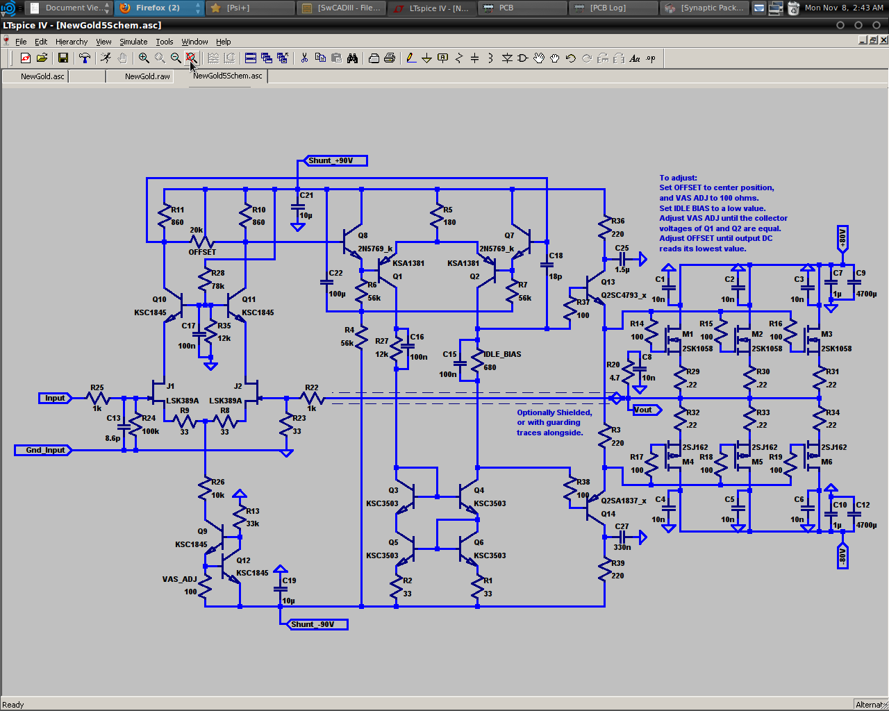

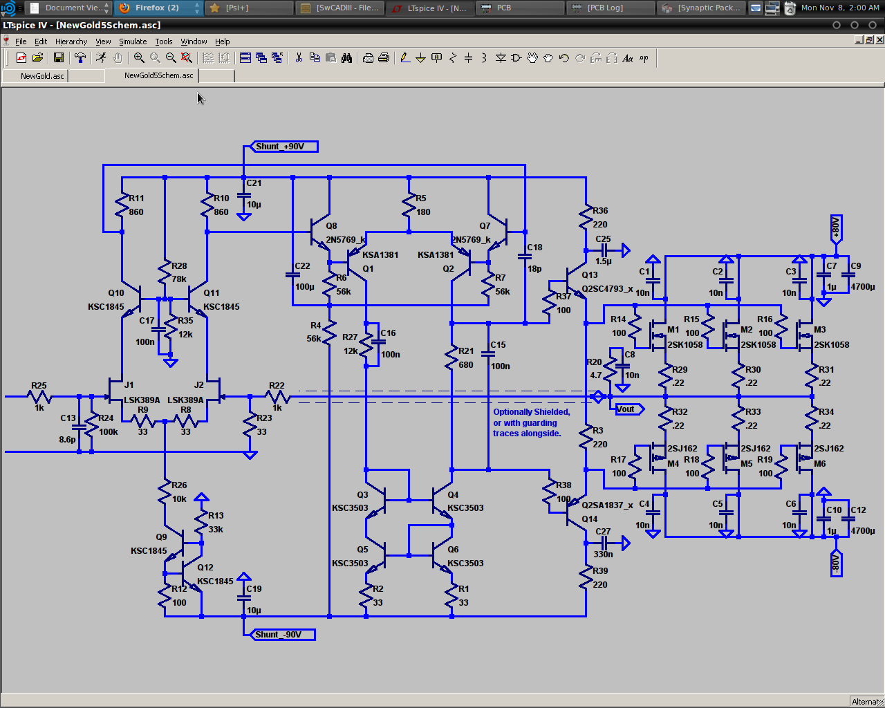

The two 100n bypass per upper rail cause a resonance with board and regulator parasitics. I knew this from the start, but I didn't know what I should do about it. What do you think is the best decoupling solution? Perhaps just a single lossy electrolytic between VAS/drivers and LTP?
Same situation applies for the driver filtering. The electrolytic and film bypass have their own resonance, and I would prefer to use a single film cap here. I think a 1uF mylar film would suffice, what do you think? I think a good strategy is to choose the bypass so the AC voltage at the driver collectors is uniform with frequency. However this means asymmetric values for driver bypass (1.5u for positive driver and 330n for negative)

Here is the schematic to my suggestions in post 865. I'm fairly sure it's superior, due to the lack of resonance, and the *d'oh* changing Q2/3 into KSC1845.
As for the regulator, testing at this stage would certainly help but it will matter most when we test it in conjunction with the amplifier itself.

Some of you may want to refresh, since I finally edited in the schematic...
The following has changed (using my schematic numbers). C25 has changed to 1.5u, C27 has changed to 330n. R27 has changed to 12k. The rails only have one bypass each, C21 and C19 which are both 10uF electrolytics. A zobel has been added as R20 and C8.

Hold tight, a more featureful and comprehensive schematic is coming.
Also, if you want output offset below 10mV, assuming all other things balanced, your Jfets will have to be matched within 300uV because of this circuit's high gain.
I'm putting the offset control at the top of the LTP, but this will cause VAS imbalance if your Jfets aren't matched well. On another vein, we could put offset controls at the Jfet degeneration. However this means the VAS (Q1,2/8,7/5,6) and the Jfets should be matched, and that's a lot of matching.

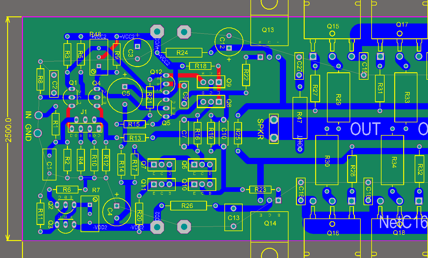

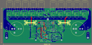

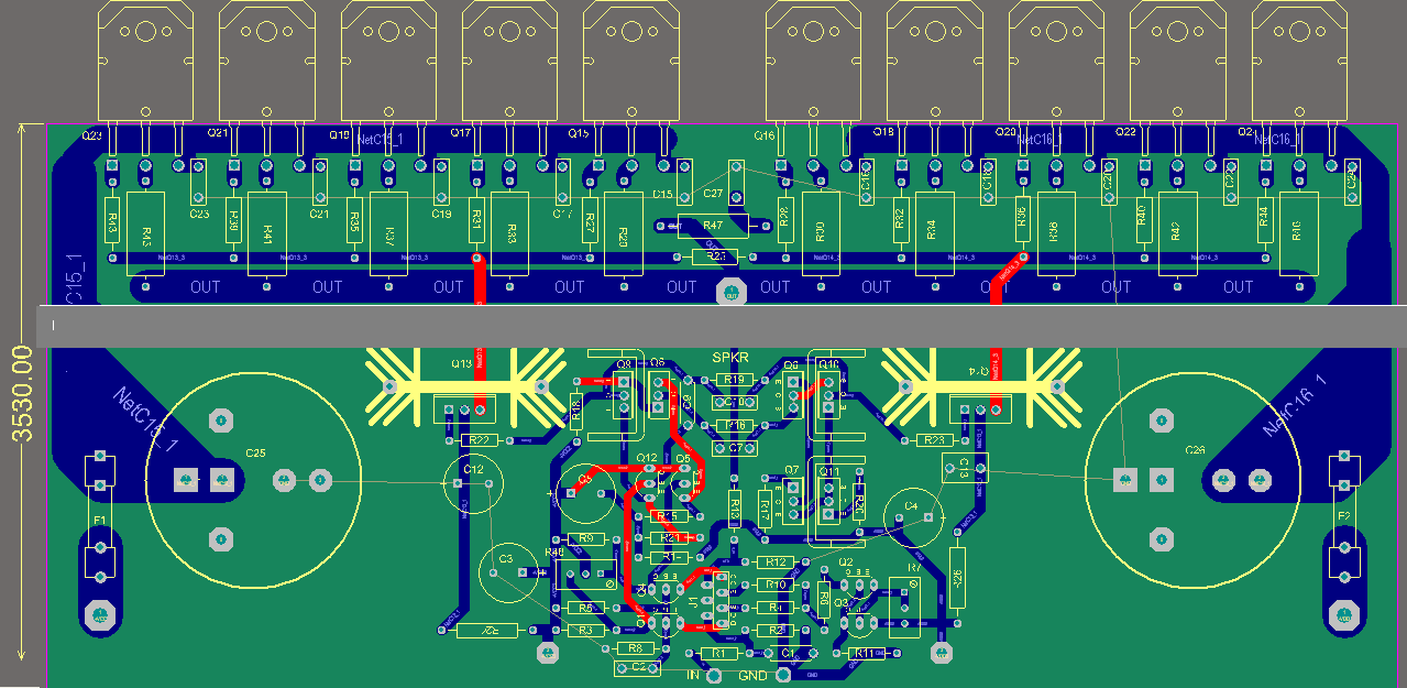

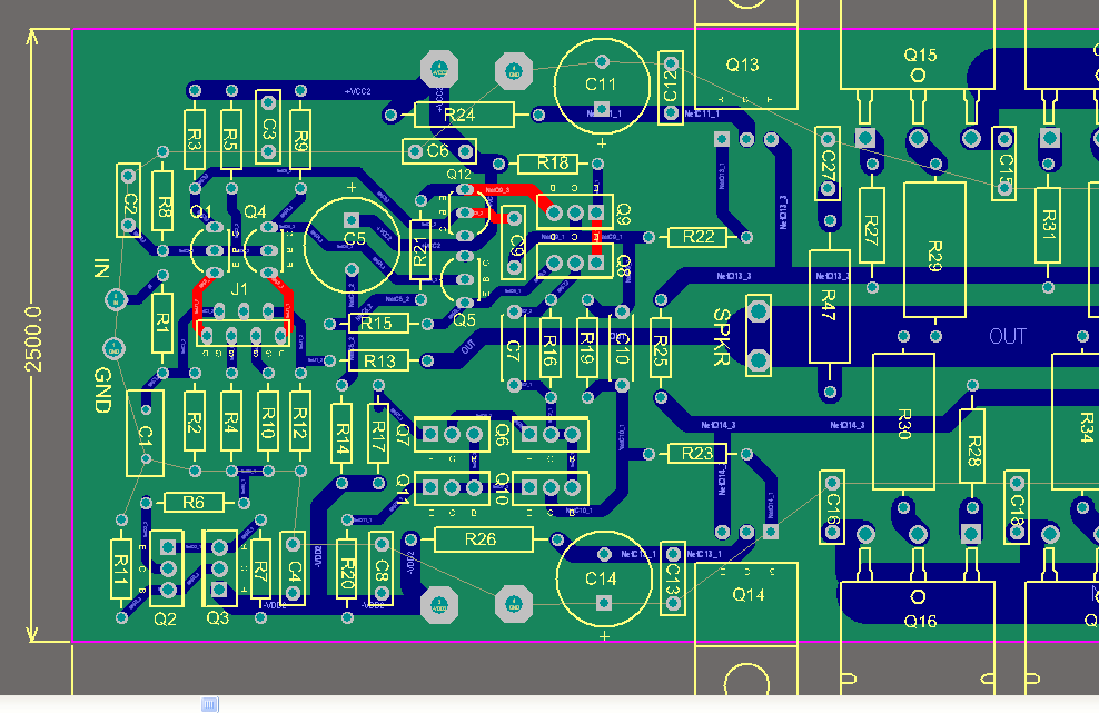

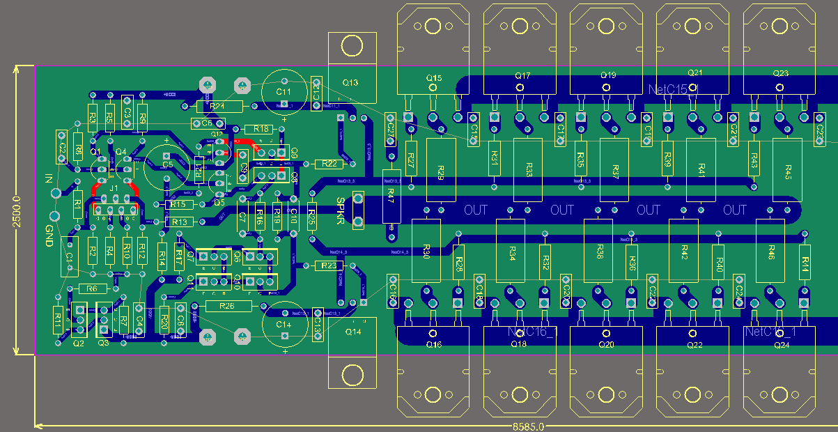

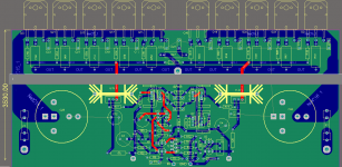

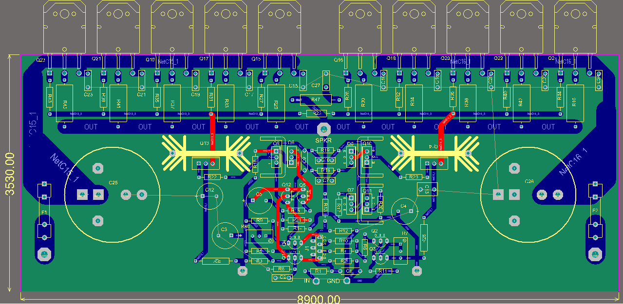

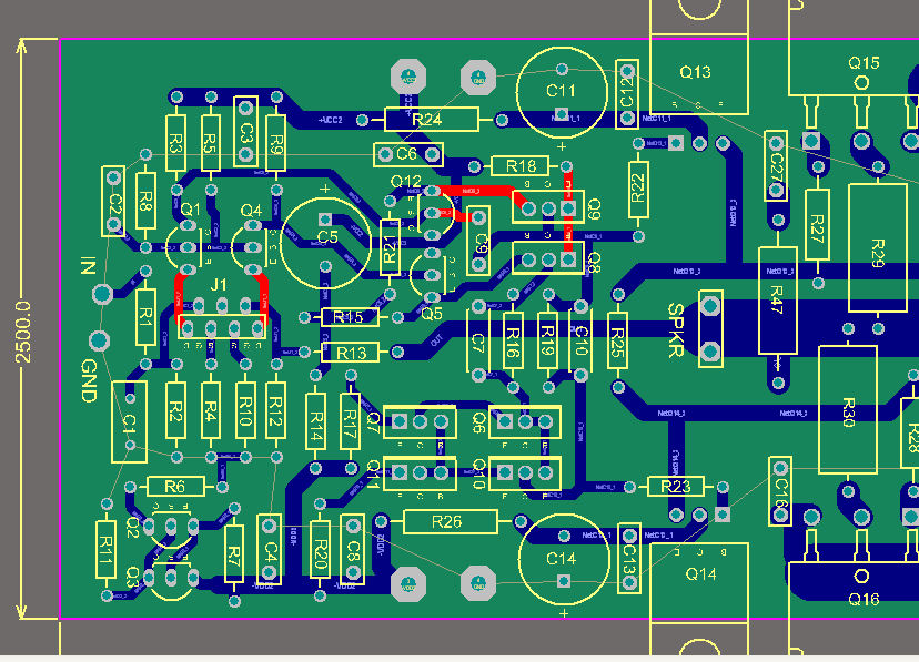

FAA, if you mount your design on a standard heatsink, half of the transistors will be at bottom of heatsink, and other half at top of heatsink
ofcourse you could use a very big custom heatsink, and mount it vertical
but then it wont fit any available box size
its nice, but old style
I suggest to have patience, and give Kean peace and time to focus on what he is doing now
no need to rush it

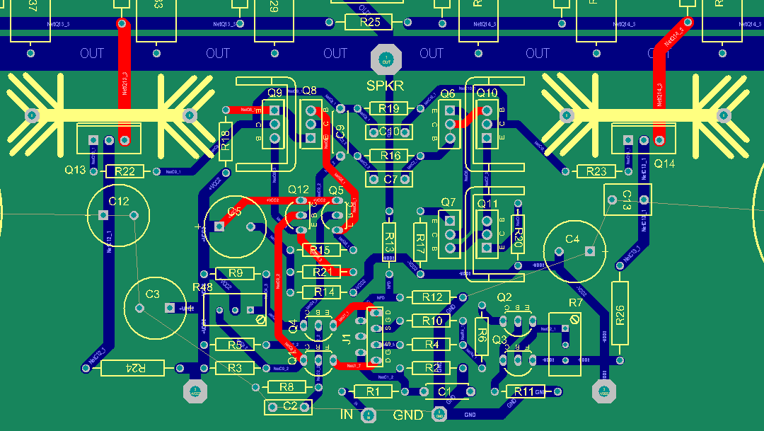

Looking good FAA! I think we should keep it the way it is, short trace lengths and feedback path......should fit on a standard profile heatsink. I would use seperate planes for power and signal and allow the two planes be connected with a small value resistor.
Jam
P.S. I also like the first layout, very similar with I used to do and has some advantages,

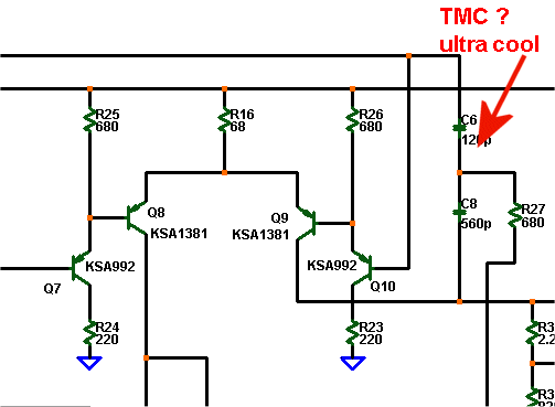

... how about optional TMC ?? ...
If you're using TMC, how about including Edmond's "magic pot" to allow cancellation of magnetically induced distortion? Either that or lay out the PCB in such a way as to minimize the effect.
Example of magic pot is here: http://www.diyaudio.com/forums/solid-state/94676-bob-cordell-interview-negative-feedback-304.html#post2357325
Explanation of problem by Edward Cherry is in attachments here: http://www.diyaudio.com/forums/solid-state/148066-new-cherry-ndfl-amp-3.html#post2104685
C12 should be a film cap like C13.
Godfrey, that is an amazing thread. Unfortunately the pot won't work unless we only use one pair of outputs.
My impression is that FAA is making a board of his own to test with. We can still make our own board.
