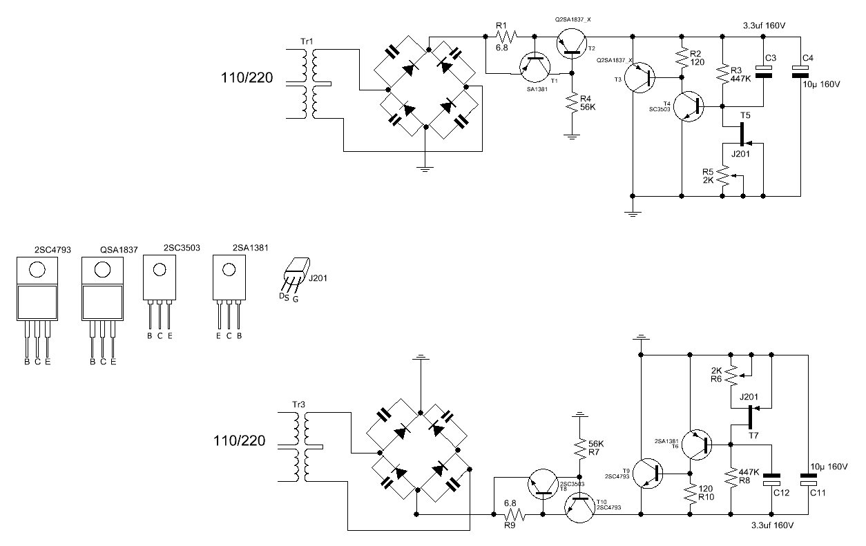

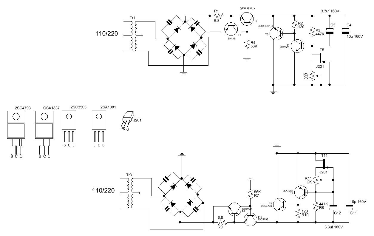

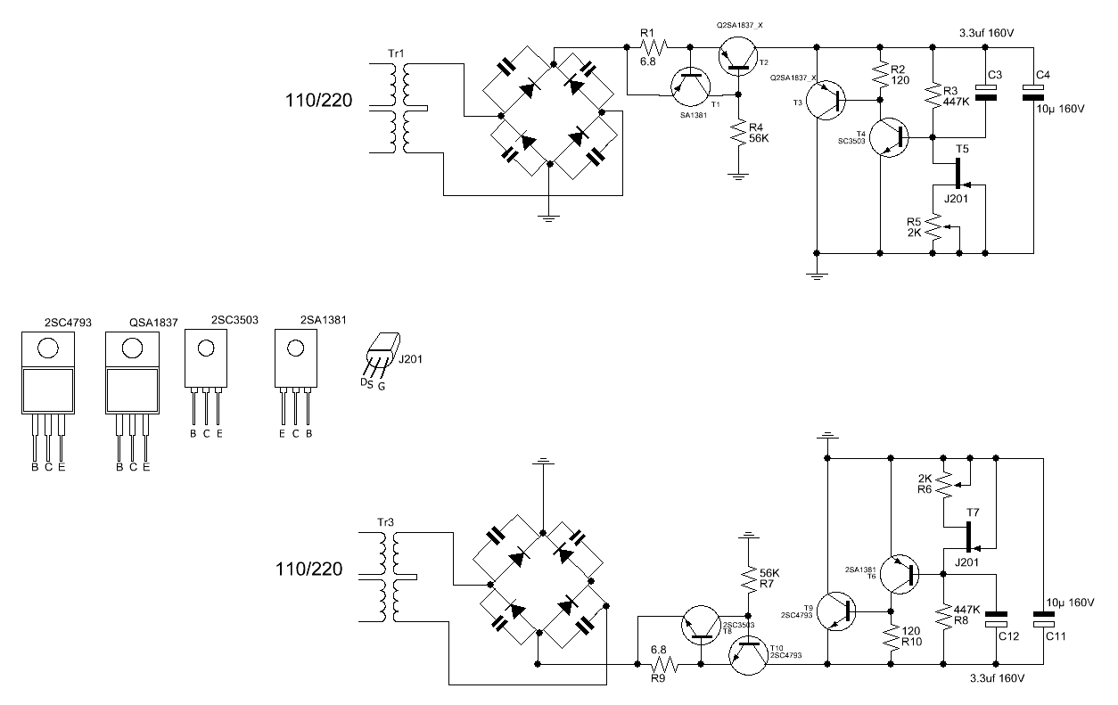

If the Zener would not need 1mF slow lytic to shut up plus would have given me the resolution of the Norton + film subjectively, why I would bother about the hard to nail rebellious Jfet kido's?😉 Slap bam Zener, off you go. Steady, no brainer. Kean chooses.
DUAL PS
OK get out your night sticks and wail away....
Krisfr, for C4 choose the closest 160V lytic between 47-10uF, and make sure it doesn't look very cool or special. Maybe use a "long lifespan" or "high reliability" part.
As for the outputs, why not make a board where you can snap off 1/3 of the end if you only want 4 outputs rather than 6?
Why not make the PSU board adaptable between Jfet and Zener ref?

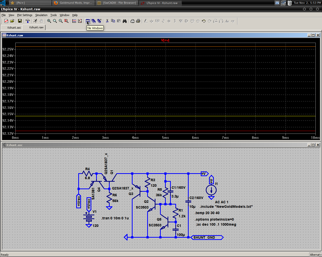

Wait, I just had... A GENIOUS MOMANT!!! Look at the schematic below. We have tempco correction, and it gets 130mV drift. Furthermore, the BJT reference acts like a very large inductor with a 1.2k parallel resistor, which boosts bass performance.
It is odd though. The Ib tempco of Q5 is introduced, and this causes a "bandgap" tempco effect. How consistent this will be in real life I don't know. You can see this in the attached simulation. The trace color follows ROYGBIV, at 20C, 30C and 40C for ROY respectively. You can see that at orange it drifts down once more after peaking at 30C.
My previous simulation can easily be modified to this version, as it already includes the device models.
- keantoken
A BJT gyrator for reference with residual anti tempco? Try that on your prototype. Interesting to see results.
BJTs-Mosfets both work to reply your question. I prefer Mosfets for my subjective reasons after I used various solutions on my stuff. Like you make a Mosfet amp here when it could be BJT sorta.
Even a cheap MKT for C3/C12 will be better than a lytic. The Ero is tops. There are many MKP/MKT in radial format cheaper to choose from also. That cap is directly influential to the final tone.
