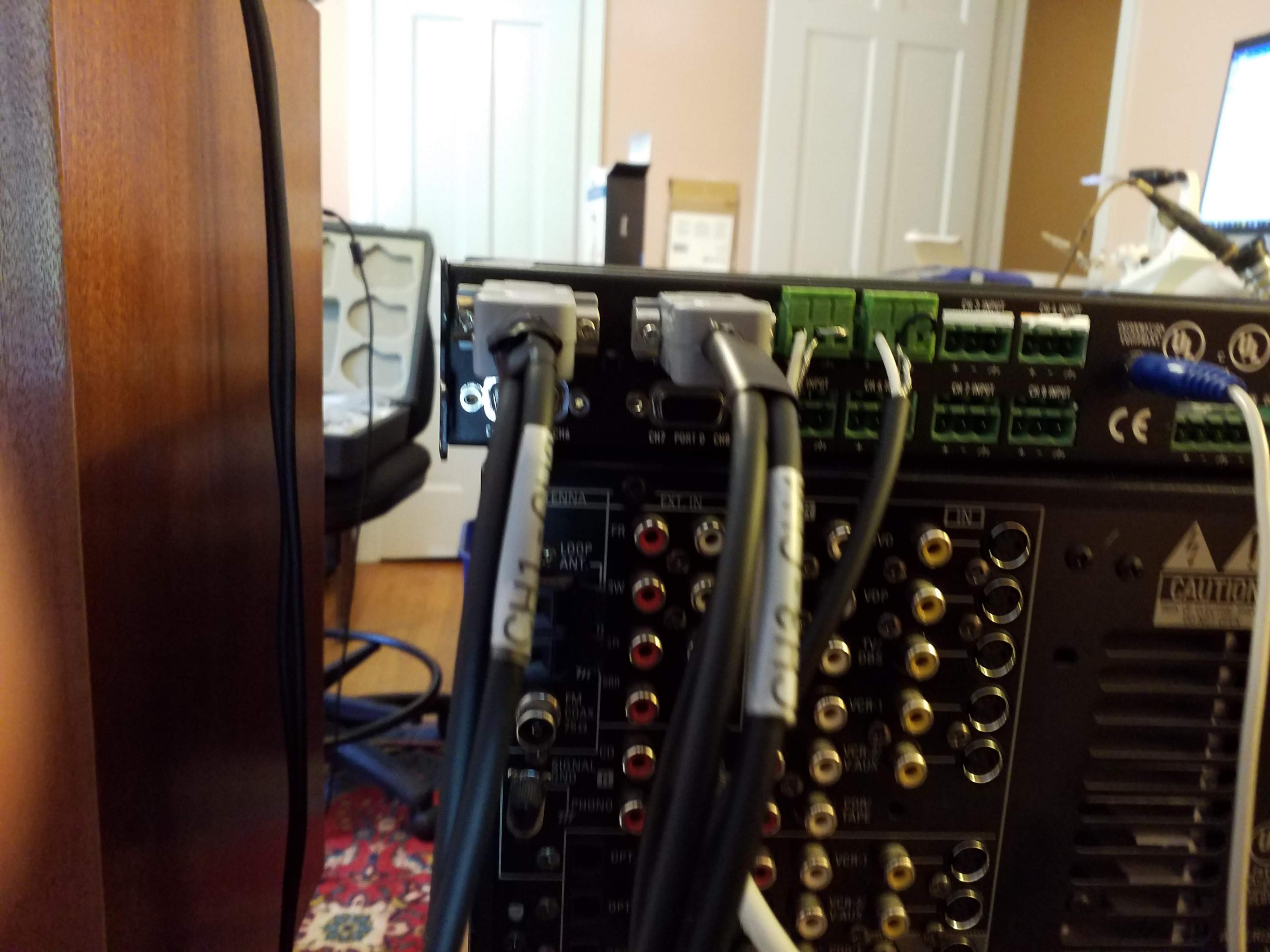

I picked up another Basis 922az on E-bay. I can confirm some of the things I mentioned in a previous post.
I stated the the subnet mask is fixed in IP settings on ControlNet, this isn't accurate, the IP stack does not support CIDR, it appears only to support classful routing.
I also tested the DataPort outputs and the new unit only outputs on the V- pins, there is no signal on the V+ Unless there is some setting I can't find then my opinion is the QSC 922az has balanced outputs, put not differential outputs.
The new unit still has the course granularity for frequency on filters and cross-overs I mentioned earlier.
Despite the issues I mentioned I'm satisfied with the product for the price. I think I prefer the sound with the active vs. the passive, but I can't say it is night and day.

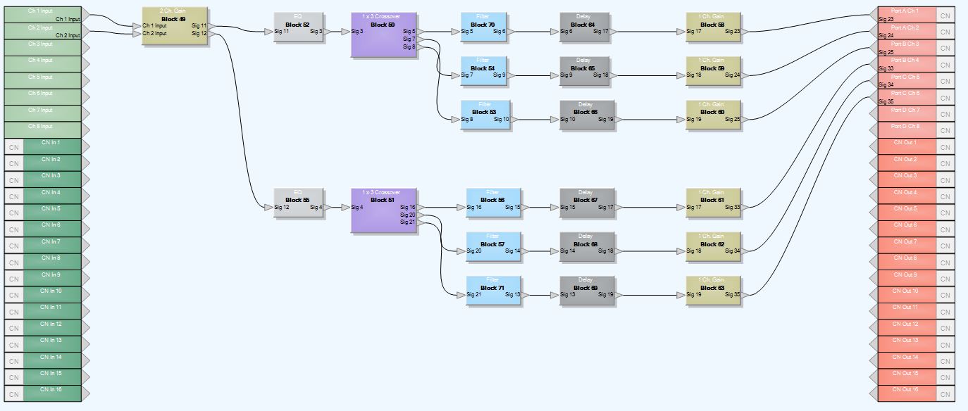

Here is a picture of the design I'm using.

They way I look at it with two of them only putting out one signal then they are not differential. As to V- only, maybe the cable diagram I found is in correct and it is actually the V+ the only way I can find out is to compare a low frequency input to the output. Hi frequency won't tell because of the delay inside the device. Maybe I will check someday.
