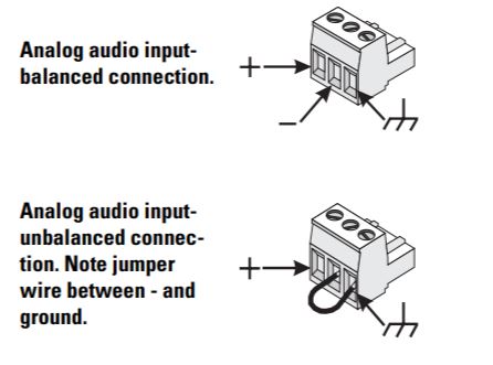

Hi mtidge,
I use Dataport amps and I/O frames under the q-sys ecosystem, a bunch.
All DE-15 dataport pinouts are the same for all products.
Link for pinouts which i guess you have..DataPort Pinout
So if L =ch1 and R =ch2: single channel L+ is pin7 , & R+ is pin 8.
Combining the standard QSC way of connecting unbalanced outputs per snip below:
L- = pin 1 jumped with pin 6 (ground)
R- = pin 11 jumped with pin 6 (ground)
Is this where you've landed? Hope so !
And hope this helped !

Maybe there something wrong with my unit, but I can only get output by using pin 6 for the shield and pin 1 for channel 1 signal and pin 11 for channel 2 signal. There is no signal on pins 7 and 8. I will check all pins for signal eventually.

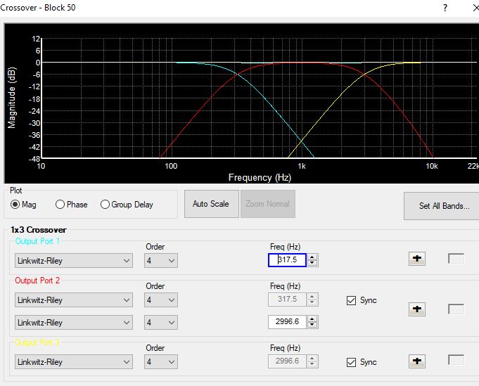

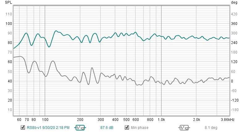

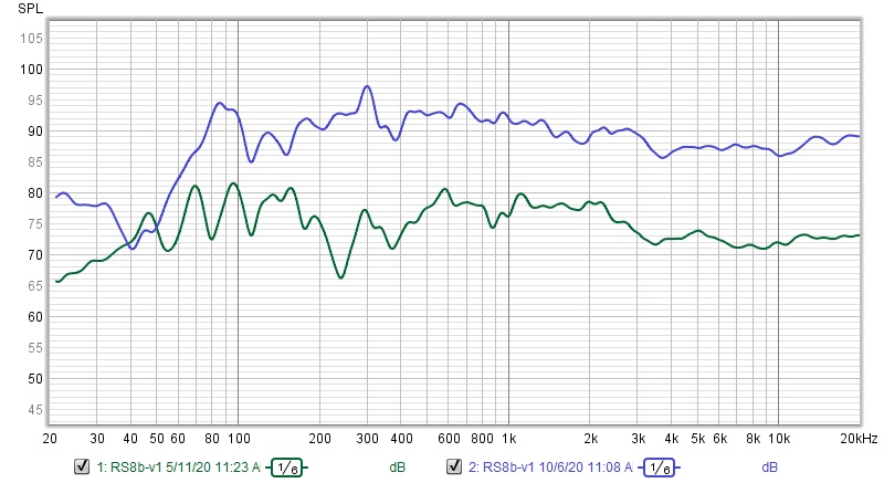

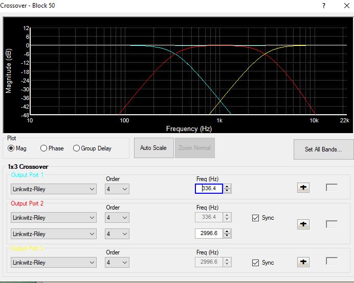

I have bypassed the passive XO in my 3 way book shelf and simply put a 20ufd cap to protect the tweeter. It took a few hours to re-work it, had to switch from a terminal cup with 5 way binding posts to two SpeakOns. I worked on the the configuration of the QSC and discovered that switching the inputs to 3v and dropping the outputs to -9 db cleaned up the sound a lot and made the master volume on the AVR more reasonable. I tried measuring the driver offsets by using LW2 crossovers and adjusting the delay to get the biggest null, what confused me is I get the null with the mid reversed. My experience has been that a 2nd order XO should make the null with the drivers in phase, am I wrong? I did a little level matching and EQ and here are the results. Green is with a passive XO measured outside on top of a 6 foot ladder, blue is the QSC connected to a Speaker Craft BB865 on a stand in my clutter 10' x 12' office.
